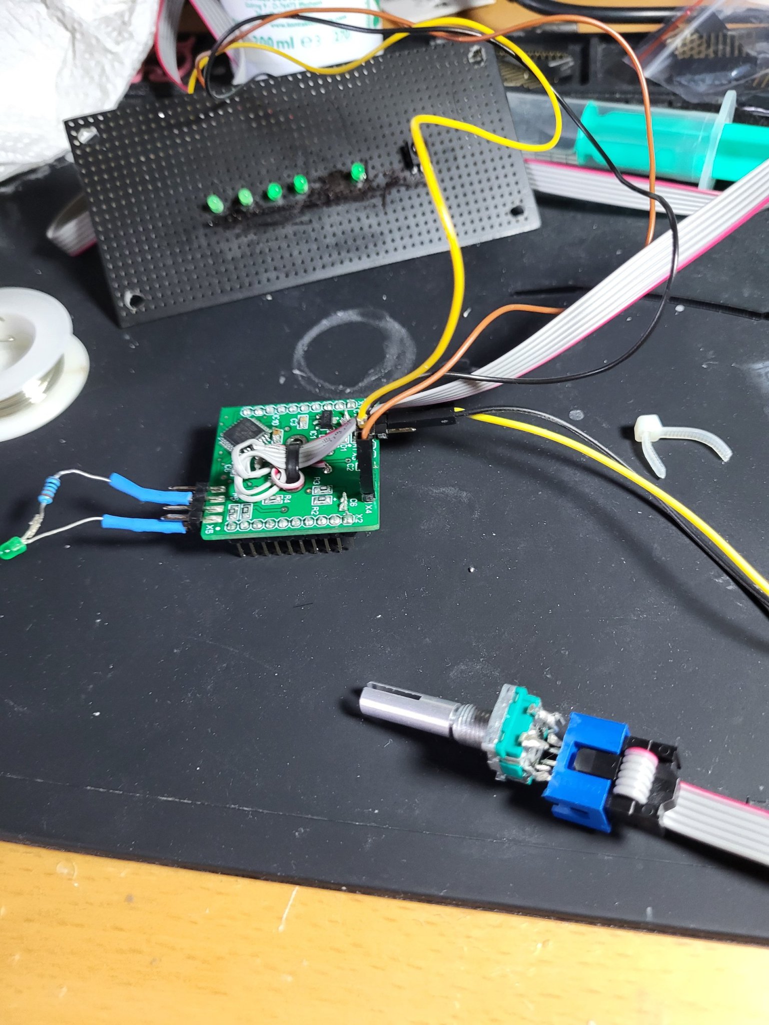

Hello,
I have completed the control board and wanted to test it,
X3 pin 1+ and 2, 15 volts supplied, output measured 3.3 volts.
Encoder and IR sensor connected, 50 cm cable each and
LED connected.
Encoder pressed then power switched on the led does not flash.
What am I doing wrong?
Ps. The circuit boards are from 07/21 from the AAA forum, unfortunately I only have time to assemble them now.
The controller has been soldered by a professional, the rest I have built.
Greetings Dirk

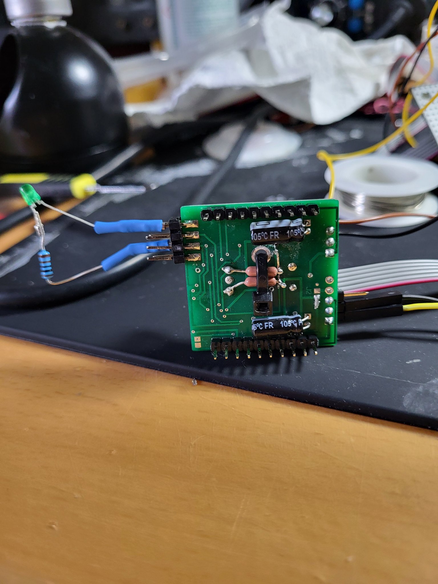

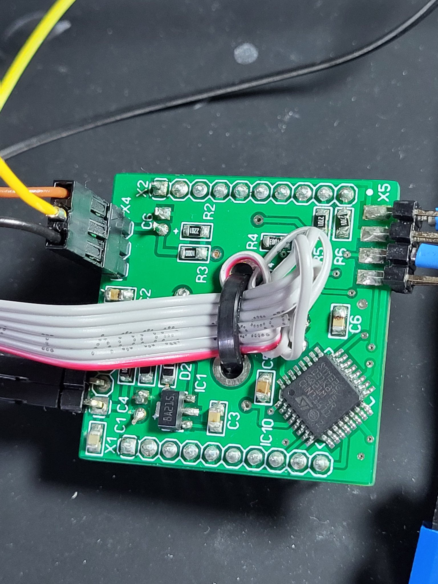

I have now soldered the encoder directly and checked the controller, no error found, no flashing of the LED.
Controller Alps STEC11B03 encoder, 15 pulses / 30 detents, vertical.
I have checked the LED, it lights up.
Can I check whether the controller is faulty?

I press and hold the button when switching on.
I haven't connected a Muse board yet, I'm still missing the 100 Ohm resistors, wrong delivery.
I won't be able to check the Muse boards for about 2 weeks, so I'll get back to you about the controller boards.
Thanks for the help
Greetings Dirk
