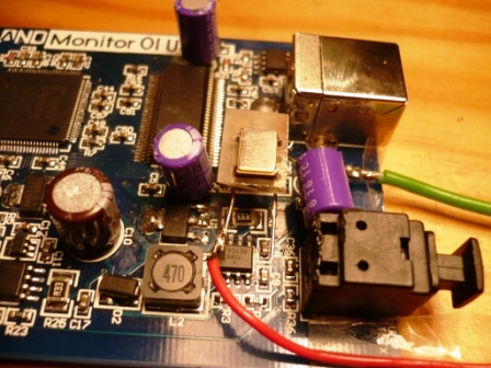

I decided to experiment with the power supplies to the board so I cut some traces to isolate sections that I could then supply separately:
- First I wanted to isolate the PS to the PCM1793 DAC
- this has two PS a 3.3V digital & 5V analog supply
- The PCM1793 DAC is at the end of a 3.3V supply that feeds the Cypress USB chip, the Xilinx FPGA - so I cut the trace just before the decoupling cap to the DAC
- The 5V supply is provided through a circuit that has a dc-dc converter chip (NCP3063) - I cut the trace feeding the USB power to this circuit
- I also lifted the + & - PS pins on the OP275 output op-amp as I was using output transformers anyway.
So now I have the complete out stages isolated & they can be powered off also.
So now my total supplies to the board are:
- external 5V through USB cable
- 3.3V to clock
- 3.3V to digital supplies of DAC
- 5V to analog supplies of DAC

- Musiland with all the output stage disconnected & red wire at the top = 3.3V dig supply for PCM1793 DAC. Red wire at bottom = 5V analog supply to PCM1793

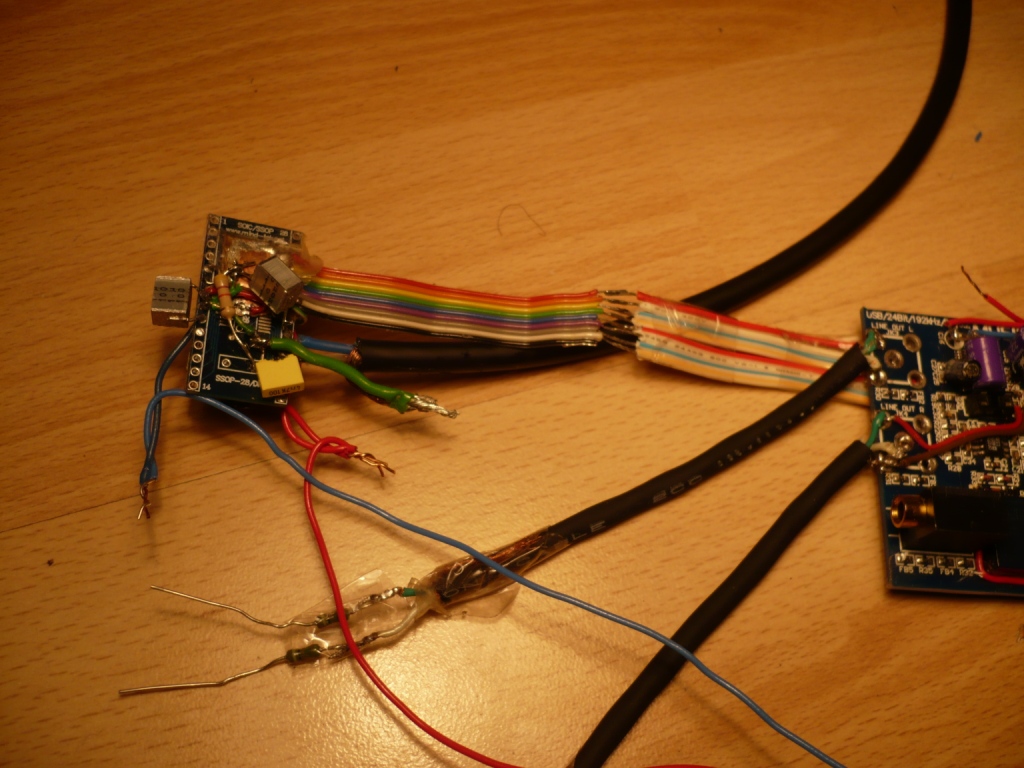

- Sabre ES9022 connected via ribbon cable to Musiland using I2S interleaved with ground so 8 wires needed. The two black wires facing down are the previous connections from the PCM1793 DAC to the transformer. The black wire curving up to the top of the picture is the connection from the Sabre to the transformers.
- IS2 connection to Musiland is by plug into a socket installed underneath board. Fine copper varnish insulated wires connect to I2S tracks leading from Xilinx to PCM1793 & run to bottom of board through vias.

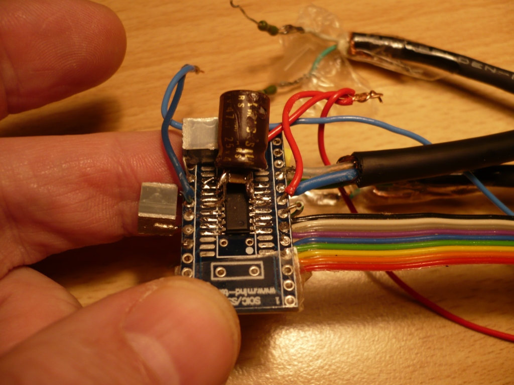

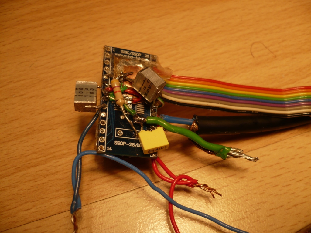

- Bottom of ES9022 Sabre on protoboard
- Top of protoboard
It's amazing this sounds so good with such lash-up wiring but it does with dead quiet background & fine sonics!

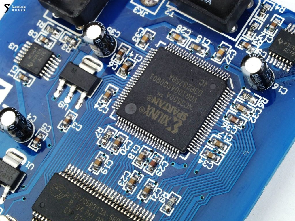

Can you provide the Xilinx pinout for I2S?

Can you tell me which are the I2S pins on the Xilinx part? Not sure if the I2S interface will be active, but since these devices all share the same driver I think its a safe bet.

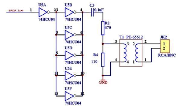

Taken from another site:
Assuming: C5 is very low Z at S/PDIF frequencies, and paralleled U5 ouputs are very low Z source, and that T1 is 1:1
Then: effective Z (ac) s/b R2||R4 or ~89R (using the schematic values of 470 & 110)
with R2=330R and R4=100R, then Zout=76R
I'm not sure what the formula for this derivation is - can anybody help?
You need to bring the Zout to 50ohms for BNC, I believe!
Check out Thevenin Equivalent Circuit
Heres a link on wikipedia: Thévenin's theorem - Wikipedia, the free encyclopedia
So the output impedance is computed by shorting all voltage sources to ground and calculating the resulting impedance, which ends up being 470ohm in parallel with 110ohm. Equation = (470 *110)/(470+110) or 89 ohms.
In this case he assumes the capacitor is very low impedance at the spdif frequency, and that the output impedance of the parallel inverters is extremely low, and that the output transformer is 1:1.
So, for true 75ohm BNC, the suggested resistor changes yield 76ohms using standard values.

Thanks Wacky, for the link. so it's just the parallel resistor calc, doh!
Oh yes 75ohm for BNC not 50ohm.
OK, so with the component values on the pcb 470 & 78 (that must be it rather than 07R) it gives 67ohm - jeez why didn't they just use 470 & 90ohm for 75ohm impedance?

Also did you trace the spdif output of the US-01 to the fpga pin? which pin is it?. Maybe the MINI can also output spdif because there is a driver for it.
Oh, yeh that's what I intended!
I've attached a pic of the Mini 01US which shows the same pins being used for I2S to the DAC as is used in the Monitor 01US. The pins used are 3,4,5,6. On the Monitor 01USD (blue pcb) pin 5 is used for SPDIF, so I'm presuming the Mini 01USD is the same.
