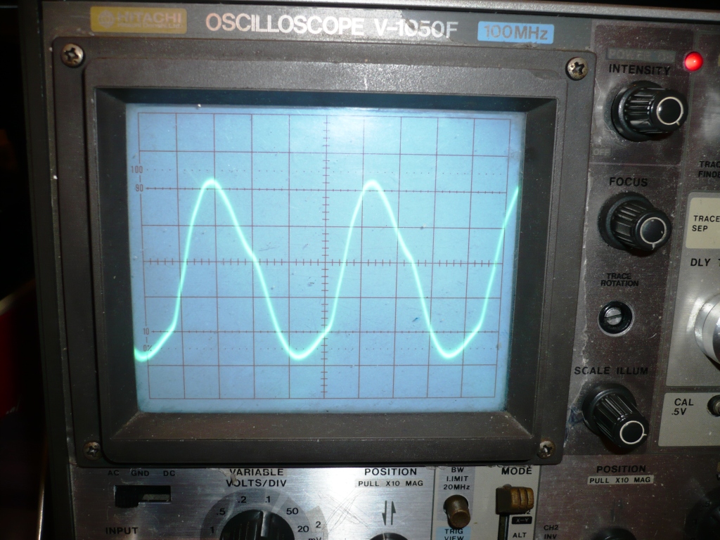

You raised a question about the Musiland outputting only 88.2Khz or 96KHz clocks over I2S no matter what the original sample rate of the audio file being played!. I did some scope shots of the I2S MCLK (system clock) line that feeds my ES9022 DAC. People will have to help me interpret these pics as I'm a newbie with a scope.
So what I did was put the red probe on the MCLK line & the Green probe on ground. The Y axis was set at 2V/Div & X axis at 20ns/div.
So here'e the shots:
- first one is with nothing playing - I make peak to through about 5 divs & so peak to peak just > 10 divs = 220nS = 44.1KHz?
- next is 44.1KHz file playing - does this look a bad shape? I don't have any R in series with the signal lines - again just > 10 divs = 220ns = 44.1KHz
- next is 88KHz - peak to peak slightly > 4 divisions = >80nS = ?KHz
This has me confused

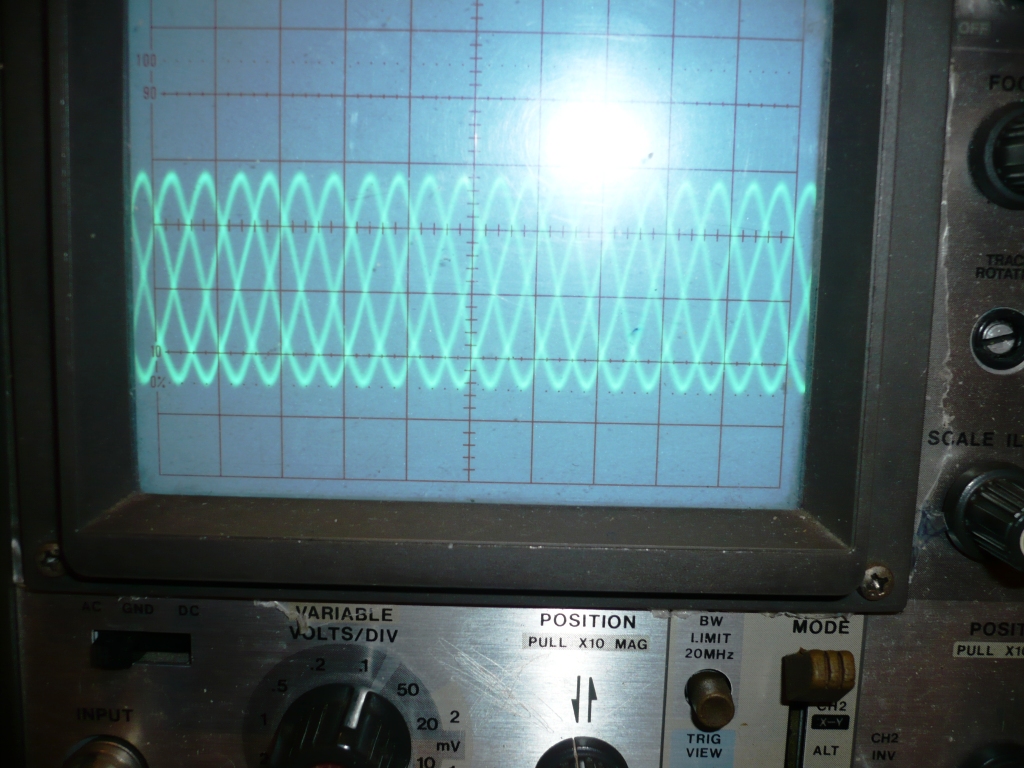

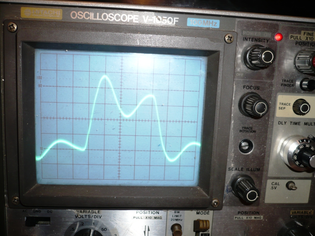

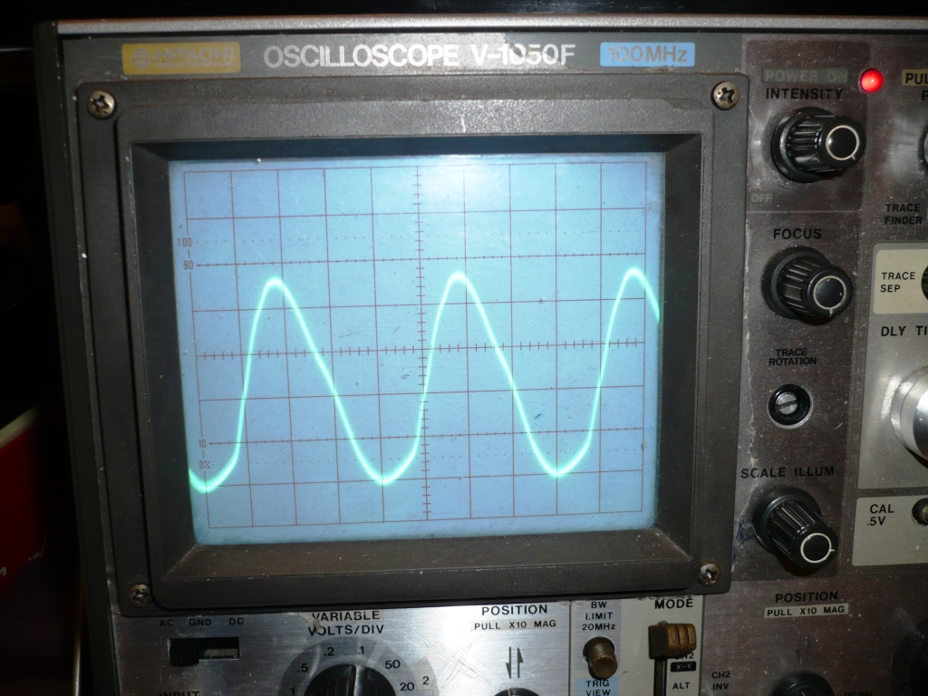

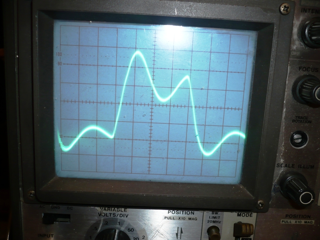

- next pic is 96KHz - peak to peak 4 divs = 80nS = ?
- next pic 176KHz - just > 1 divs = >20ns
- next 192KHz - about Div/3 = about 7ns
Is there something odd going on here or is it my understanding that's off?
For 44.1:
If you have a period of 220nsec, Frequency is 1/200nsec = 0.0045X10^9 or 4.5MHz. Assuming 24 bit data, two channels is 48 bit, data rate is 4.5/48=93750 Hz or 96K
for 96K Input, period is 80nsec, f=1/80nsec = .0125X10^9 or 12.5MHz. Assuming 24 bit data, 2 channels is 48 bit, data rate is 12.5/48= 260K... That's too much...
Try measuring the LRClock (the left-right channel clock) line. That runs much slower. Also can you force 24 bit from the player?

jkenny, last time I uses a scope was like 30 years ago!. (Thanks for doing this)
Anyways, there is still hope. According to the DAC spec (your DAC) these are the specifications for the MCK
so if we assume 128fs,
Then for 44.1 MCK is 5.6 MHz and for 96K, MCK is 12.2 MHz which is very close to your results. But to make sure, we need BCK and LRCK
![4154566274_5a5f1365b8_o.jpg](https://farm3.static.flickr.com/2598/4154566274_5a5f1365b8_o.jpg)
The wave pattern looks awful! but maybe is your scope
Yes, it may well be - what would be the best way to check this? s I said I haven't used this much & it was picked up from a college lab but I think they said this channel was fine - the other is not.The wave pattern looks awful! but maybe is your scope![]()

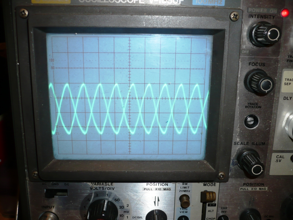

Decided to take out my state-of-the-art 40 buck scope and some measurements myself. The highest frequency I can measure is the LRCK which coincides with the sample rate.
As it turned out, the Musiland sends native sample rate.
But based on jkenny measurements of the SCK, the system clock, the frequencies are not supported by higher end DACS such as the Wolfson WM8741 according to the spec. Music comes out but maybe that is why some of the upsampling doesn't work in the Wolfson DAC
In any case, it seems matching I2S is not so trivial. One must ensure that the system clock rates are supported in order to take full advantage of the DAC. Thus maybe spdif is a better solution until a more generic I2S solution is developed.
Here are some pictures:
The little scope is pretty handy and accurate within the resolution of the device
