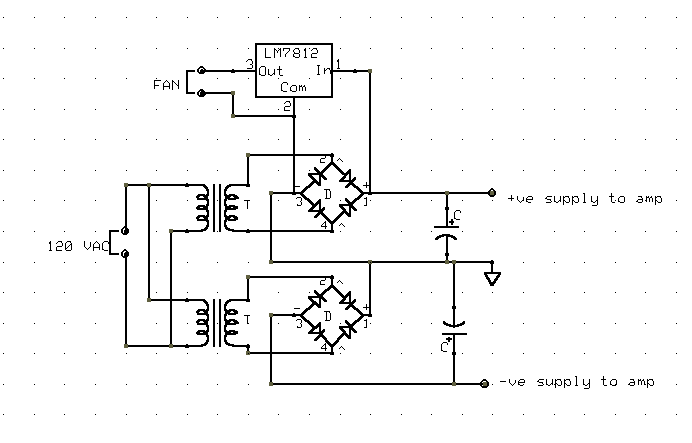

How could someone just wire in a 12V wall wart to mains to power a 60mm computer cpu fan? A computer HSF is alot more affordable than a $20.00 heat sink from some guy in Michigan.
That seems like a lot of effort to me. Why not just drop a 7812 across one of the bridges in your existing PSU, and shove the output at your fan? (Something like the quickie below. Usual caveats, especially about the untested and quickly-drawn nature apply).
Don't forget to heat sink it. A wussy heat sink will be plenty. The tab is connected to the middle pin, so either float the heatsink or use a mica pad (same as the MUR860s) to isolate it.

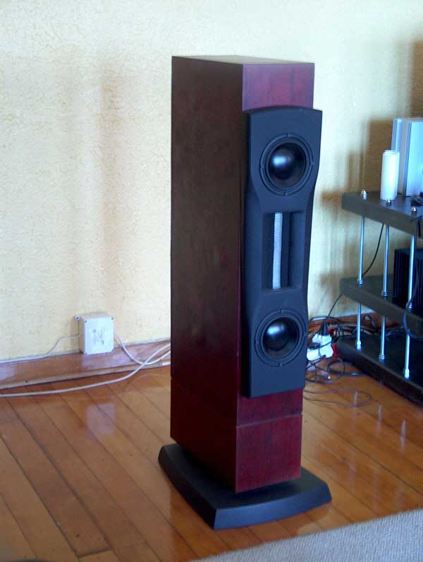

Hi Russ. I do not think it is to bright for the average guy.
my current setup is :
speakers designed by myself. using Morel 5" Mw144 (inseparate inclosures and differant cut offs. Pinsh Ribbon - 900hz - 44lhz bipolar (not well know but is one of the best i have ever heard)
Modified Rotel frontend and an DAC using PCM 63 with a Siemens CCA valve output. no pre just a passive pot (alps)
interconnect - Audioquest
i include a picture of the speakers
Very nice Rudi! I will have to see if I can find that tweeter! As I have a few RS180s which I would like to try them with to test again the BGs.rudi said:

Russ White said:
I like the BGs, but I wonder if you Pinsh are better.
Hi Russ
the tweeter is far better than the BG. first of all it acts a midrange/tweeter and super tweeter. = no cross over. being bipolar it gives a spacial sense that is hardly equaled. some designers put a tweeter at the back of the speaker to simulate this.
the not so nice side of it is that it costs $ 2300 for a pair.
But you would Love them once you have them.
Rudi
