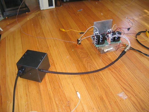

I couldn't agree more. It is one thing to theorize, and quite another to test.
Cheers!
Russ
