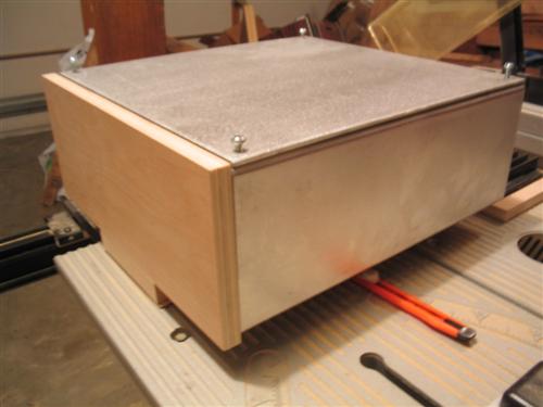

Hi Mauro,
after some days listening with my dual Rev C i want to thank you expressly for sharing this great design. By time I bought and built several amps (and some of them were really expansive), but with none of them I was nearly as happy as with my "Mauro".
So take this, painted on my amp´s chassis, as an appreciation:
Cheers, Gerd

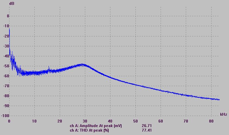

The "real" my_ref prototipe diode (AC) response FFT.
Probe like "Josef_K diode test" (2K-10nF AC probe).
Trafo: Talema 230/25+25V 225VA toroidal
The LC "Tank" (L trafo C= C5+C22 = 100nF) Generate a little Peak at 30Khz,but filter and "shaping" the HF diode spikes, and create a low pass filter over 30Khz.
NO HF overshot, (like various snubber doc. expained....)

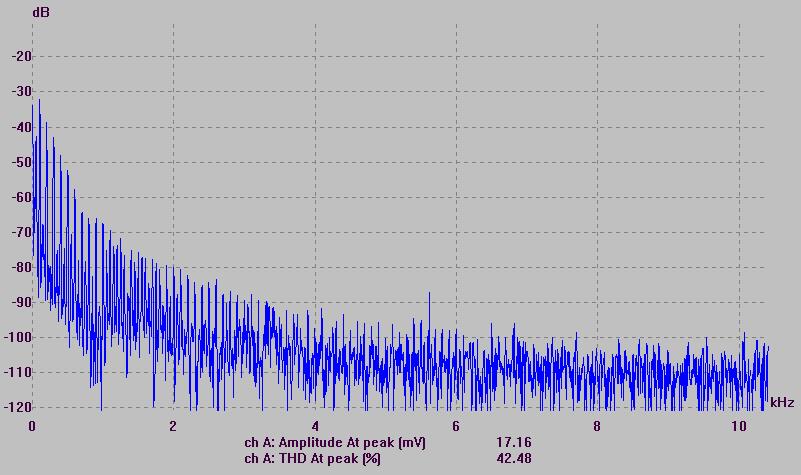

And a MY_ref prototipe DC (+35V) FFT.
The spectra it's a classical "charge ramp" FFT distribuction. The graph over 6Khz it's "noise free" too low of -100dB...
HF noise free...
No audio band "diode" noise...
No Full band "diode" noise (verified, not exposed on graph, but evident of IMD Graph free....)
Question:
where are the "spikes" that snubber has to filter ?
Where are the HF oscillations?
Where is the noise, to filter with regulators and various "snubber" net?
Please, Leave behaviour the work of layout PCB and the sizing of the PSU to anyone knows it....
Mauro

chassis
Hello all
Just started the case work for the rev. c amp. Material is 1/8" aluminum; this one will have wood front and back; heatsinks are recycled motorolla mobile radio; will be attached to the metal insides for thermal transfer.Top and sides are rotary sanded; thinking of finishing in clear lacquer.Size is 11-1/2" wide, 13" deep, 4-1/2" high; on-off switch and power chord socket will come from a comp. power supply; fuses to be inside for rails and main power.And maybe my blue l.e.d. fan mounted underneath.
cheers
doggy
Hello all
cheers
doggy
