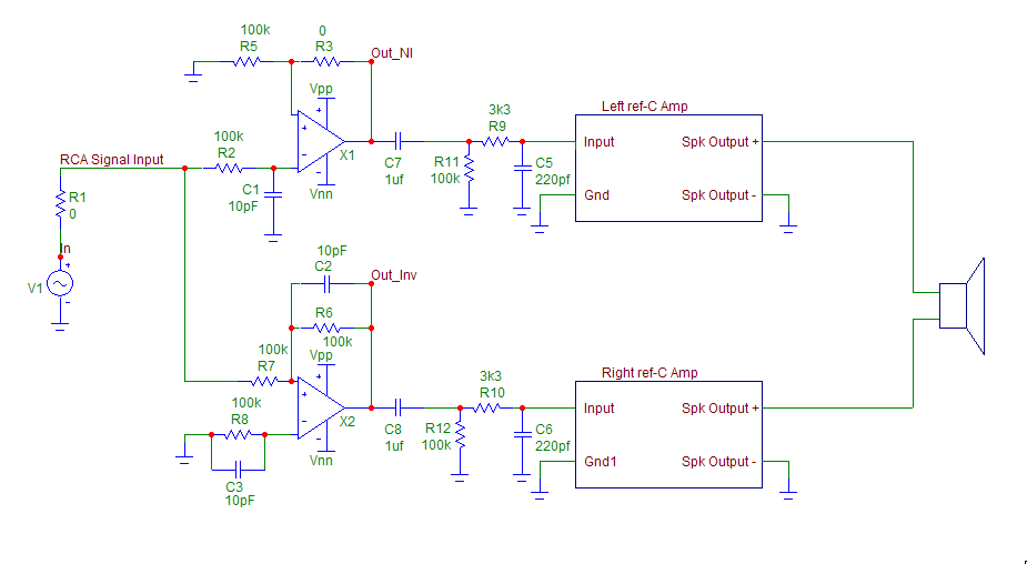

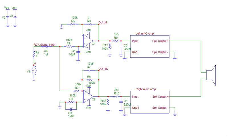

Bridge mode Ref-C
a friend of mine loved my Ref C so much but he is a bit of a power pig and wanted more power,
so i came up with this idea to bridge the Ref-C. maybe some of you have different ideas to bridge this amp
