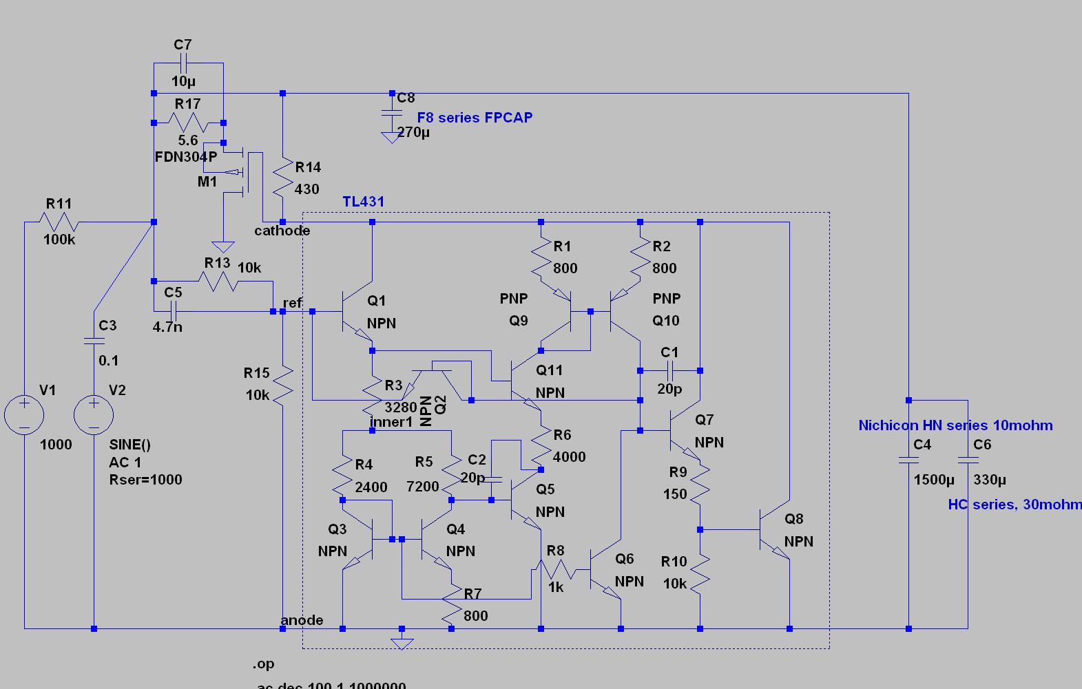

Shunt in progress
Here's the schematic for my progress so far with the 'low complexity shunt'. It achieves <10mohm output impedance from DC through 1MHz, at the expense of 3 fairly large value low ESR electrolytics across it. Test current is 10mA. Not sure how far to develop it above 1MHz. Any ideas?

ok, from the looks of it, you are buffering the output of a discrete 'TL431' (or is that actually the guts of the TL431?) with a logic-level-gate mosfet... i see no ccs, though i may be blind... :p it looks good to me. :)
unfortunately, the fairchild spice model for the fdn304p is anything but cooperating with my version of spice (3f5), so i can't seem to simulate it using a css and zener reference. (why spice3 doesn't accept poly() syntax is beyond me...)
