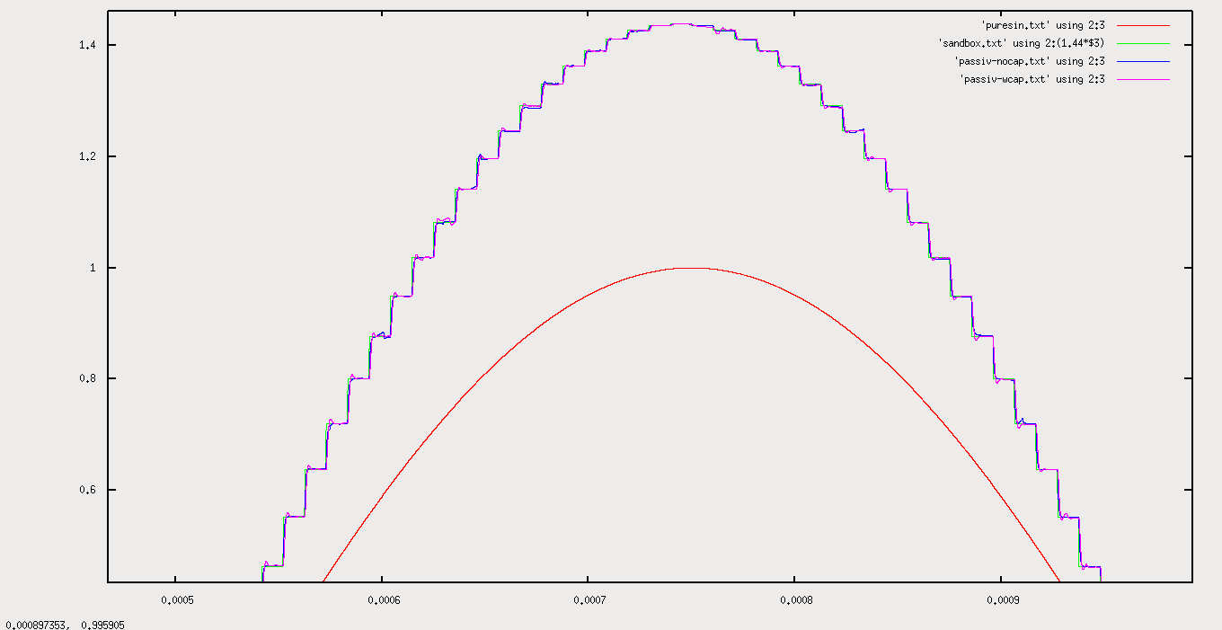

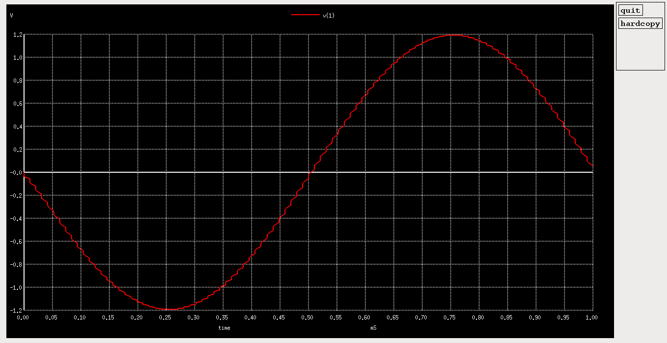

look ma, no spikes!
alright, here's progress: changing to piecewise linear functions produces much cleaner results, and it looks more accurate too, in my humble opinion...
the current problem is, the sinusoid doesn't repeat itself, so i'm hacking in a "number of periods" variable to the program so i can get, say, ten periods for analysis. after that i can look at the results when coupled to my i/v stage.
I'm guessing you can set the frequency of your test waveform to a sub-multiple of the sample rate, it looks to be what TI did on their DAC testing. Otherwise why did they choose to test at 1.1kHz - that would be about 40 samples per cycle. I agree your latest plots look far more promising:D

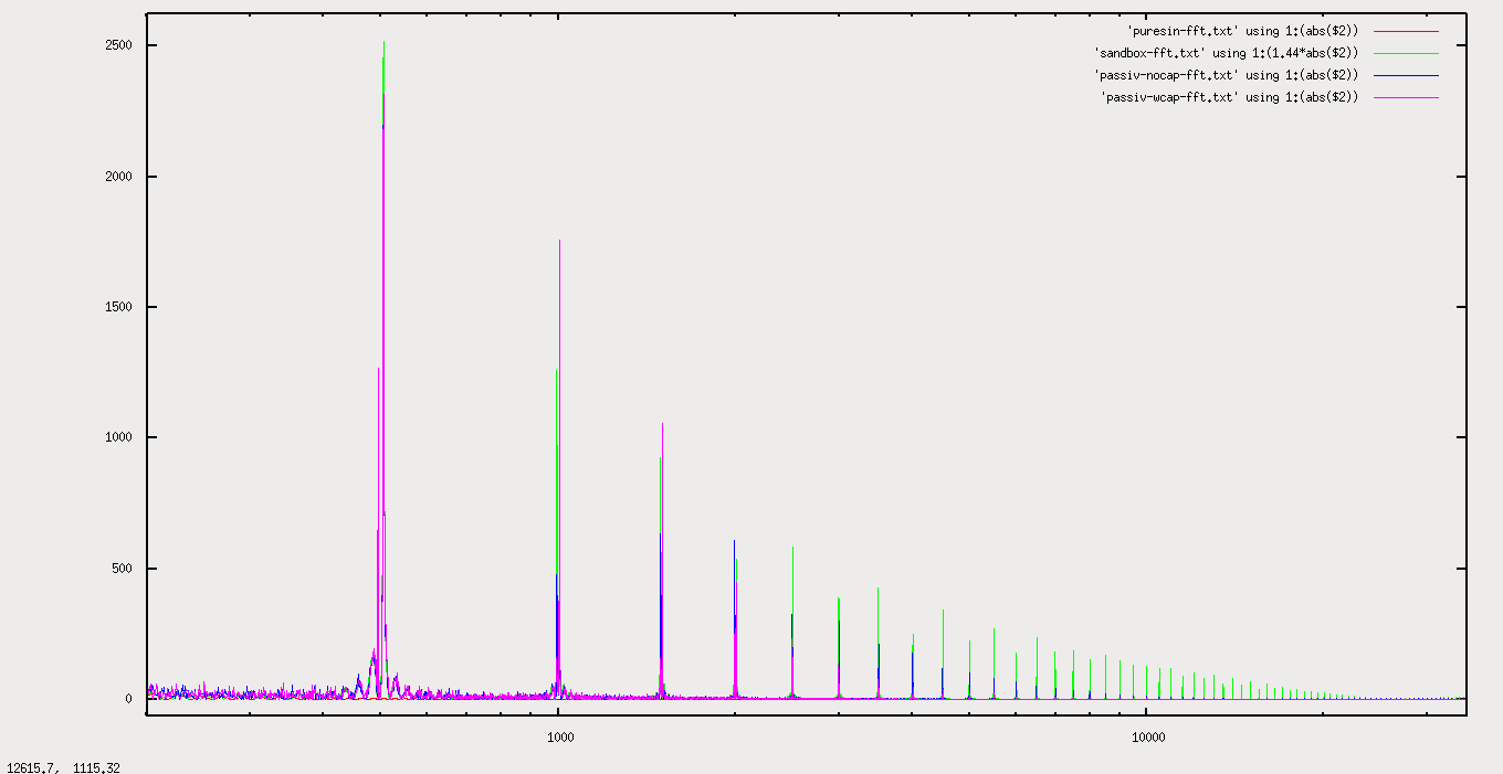

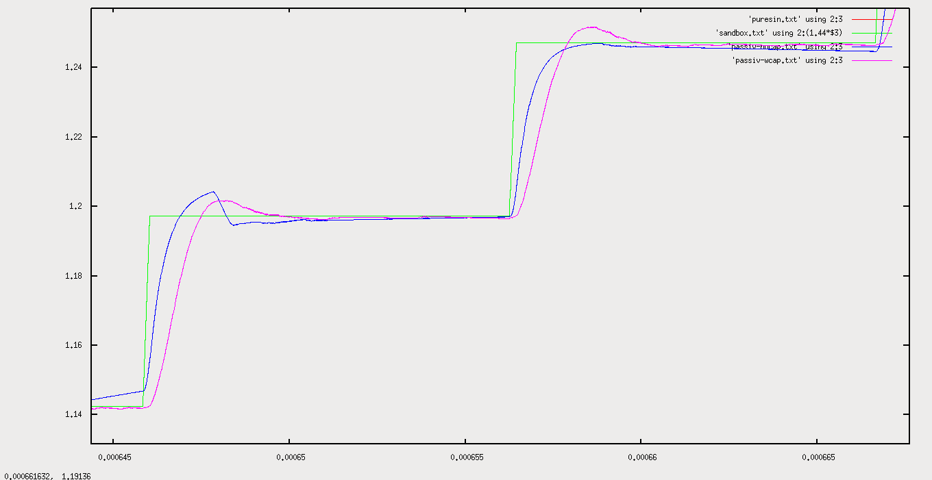

ok, this is very rough data, so bear with me... i'm still working out some kinks.
color codes:
pure sine wave in red,
raw dac output in green,
pass i/v stage w/o 10nF cap in blue,
pass i/v stage w/ 10nF cap in purple
the third attachment shows an fft of the output waveforms. x-axis values are not frequency values, but more like bucket indices. the second and third harmonics are slightly higher for the cap'ed version, but higher-order (4+) harmonics fall off much faster than without the 10nF cap.
i'll have some quantitative thd estimates to post within a week or so. (i'm using another c program to perform the fft, so it's a matter of programming more than anything else... :p )

I'd suggest caution in interpreting the FFT measurements when feeding in the quantized sinewave. That's because when we put in a repetitive signal, the quantising distortion does not get smeared out across the whole audio band, rather it becomes correlated with the signal and piles up around multiples of the input frequency. So the harmonics you've plotted may well not be harmonic distortion from your I/V converter, they'll likely be from the quantization distortion of the test waveform.
... So the harmonics you've plotted may well not be harmonic distortion from your I/V converter, they'll likely be from the quantization distortion of the test waveform.
ah, that makes more sense! :) it's starting to look like the fft i'm using needs more work or perhaps isn't suitable to analyze output distortion. i was initially trying it to confirm the unusually high THD estimates i was getting from the spice fourier analysis.

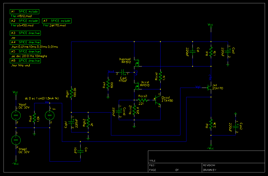

following your advice on other fets in the i/v stage, i went ahead and simulated the current design with a jfet (2sk170) device at the input. almost identical distortion figures (barely lower) and increased HF response by about half a decade. transconductance of the jfet is around the same in the circuit as that of the original mosfet. i've attached the simulation schematic. any thoughts?
~ brad.
What models are you using for the JFET and MOSFET? Would you post them up or provide links so I can have a play in LTSpice?
the 2sk170: (bl i think)
Code:
.MODEL 2SK170 NJF(
+ VTO=-5.211e-001 BETA=3.683e-002 LAMBDA=4.829e-003
+ IS=1.000e-009, RD=0.000e+000 RS=0.000e+000
+ CGS=5.647e-011 CGD=2.562e-011
+ PB=4.860e+000 FC=0.5)
the irf610:
Code:
.SUBCKT IRF610   d  g  s
LD d 1 5.000E-09
LS s 3 1.000E-08
RG g 2  240.
RGS 2 3 1.000E+08
RDS 1 3 5.000E+05
M1 1 2 3 3 IRF610    L=2.0E-06 W=1.073E-02
.MODEL IRF610   NMOS (LEVEL=1 VTO= 4.000 KP=2.071E-05
+TOX=1.000E-07 UO= 600.0 LAMBDA= .001 CBD=3.087E-10
+PB= .800 MJ= .50 IS=1.000E-15 CGSO=1.165E-08 CGDO=2.330E-09
+RS=1.000E-03 RD=1.000E-03)
.ENDS IRF610
and ztx450 for the ccs bjt:
Code:
.MODEL ZTX450 NPN(IS=3.941445E-14 BF=175 VAF=109.45
+ NF=1 IKF=.8
+ ISE=7.4025E-15 NE=1.3 BR=20.5 VAR=14.25 NR=.974 IKR=.1
+ ISC=3.157E-13 NC=1.2 RB=1.1 RE=.1259 RC=.0539 CJE=63E-12
+ TF=.75E-9 CJC=15.8E-12 TR=85E-9 VJC=.505 MJC=.39)

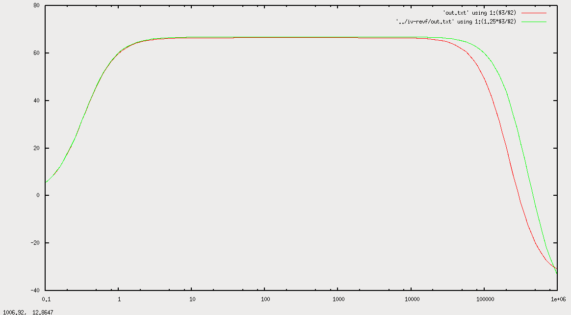

ok, i'm less on the fence about the jfet input now that i've compared the two frequency responses side-by-side. the increase in hf response gained by use of the jfet is less than i first eyeballed, and gain is decreased (hence the 1.25 multiplication factor in the second plot command). i think i'll stick with the mosfet for the time being to keep close to the original d1 design.
~ brad.

That's not a particularly accurate model for doing linear simulations, in fact its fairly close to hopeless:eek: Probably its marginally ok for high drain currents, but as far as I'm aware you're running about 30mA. Its a poor model because it knows nothing about sub-threshold conduction and that's precisely the operating area in this application. After a quick google for 'sub threshold conduction' I found an article citing Fairchild's models as handling this area more accurately. On Fairchild's site, I looked for a suitable part and perhaps the FDMA410NZ might suit you - although its in a very small SMT package, it has a reasonable power dissipation. The model's sub-threshold performance looks quite respectable - it shows a gm around 600mS at 30mA with a gate voltage of 834mV.

that's interesting about the sub-threshold conduction aspect of the spice models... how would i find an accurate irf610 to use in simulations? (if possible) i guess since it's a switching FET the guys at IR figured nobody cared about such a situation... :p

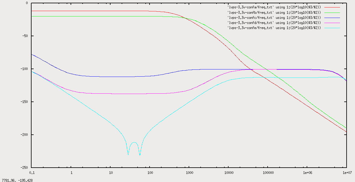

a correction must be made to the 3.3v shunt reg comparison graph. i realized i was using irf9540's in those sims instead of irfp9240's. i've added the line rejection of the irfp9240 to the new plot as a point of comparison.
~ brad.
That'd be my guess too. Even in LTSpice the MOSFET models I looked at (and there are dozens, I just sampled a couple) didn't deal with this, as LTSpice's original name is SwitcherCad. That's where most MOSFETs end up I think.
As you're using those switching MOSFET models I'd say those plots are now in doubt:p I've been thinking more generally about power supplies recently and plan to have a play (not simulate) with some chipamps as regulators to see if I can improve on the low-current performance of LM317/337s. Turns out that when feeding typical opamp type circuits those devices have appreciable output impedance.
