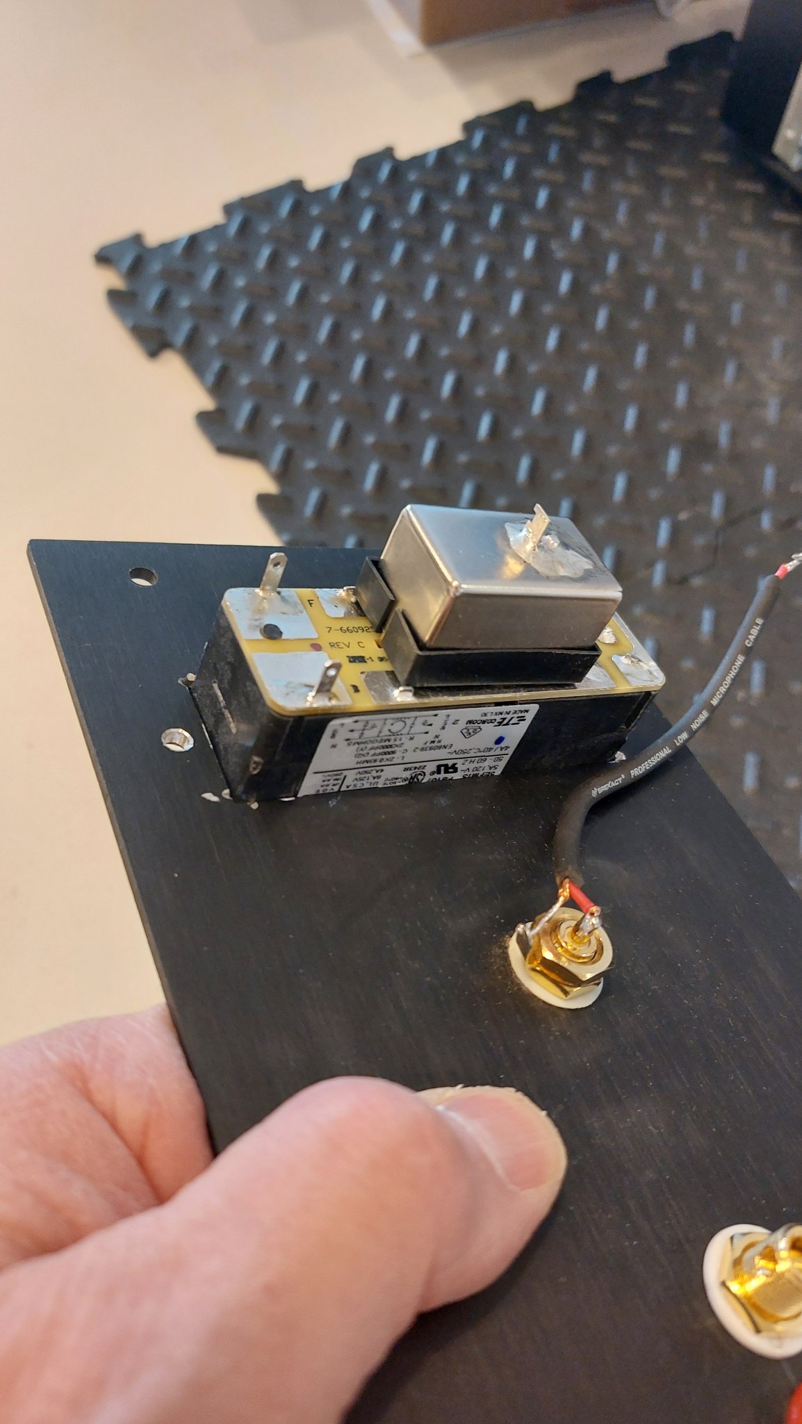

Also: Have you tried an IEC with an integrated filter?

I live in a condominium build in 2015. This kind of IEC with filter and fuses AC plug is exactly what I am using. See attached below...

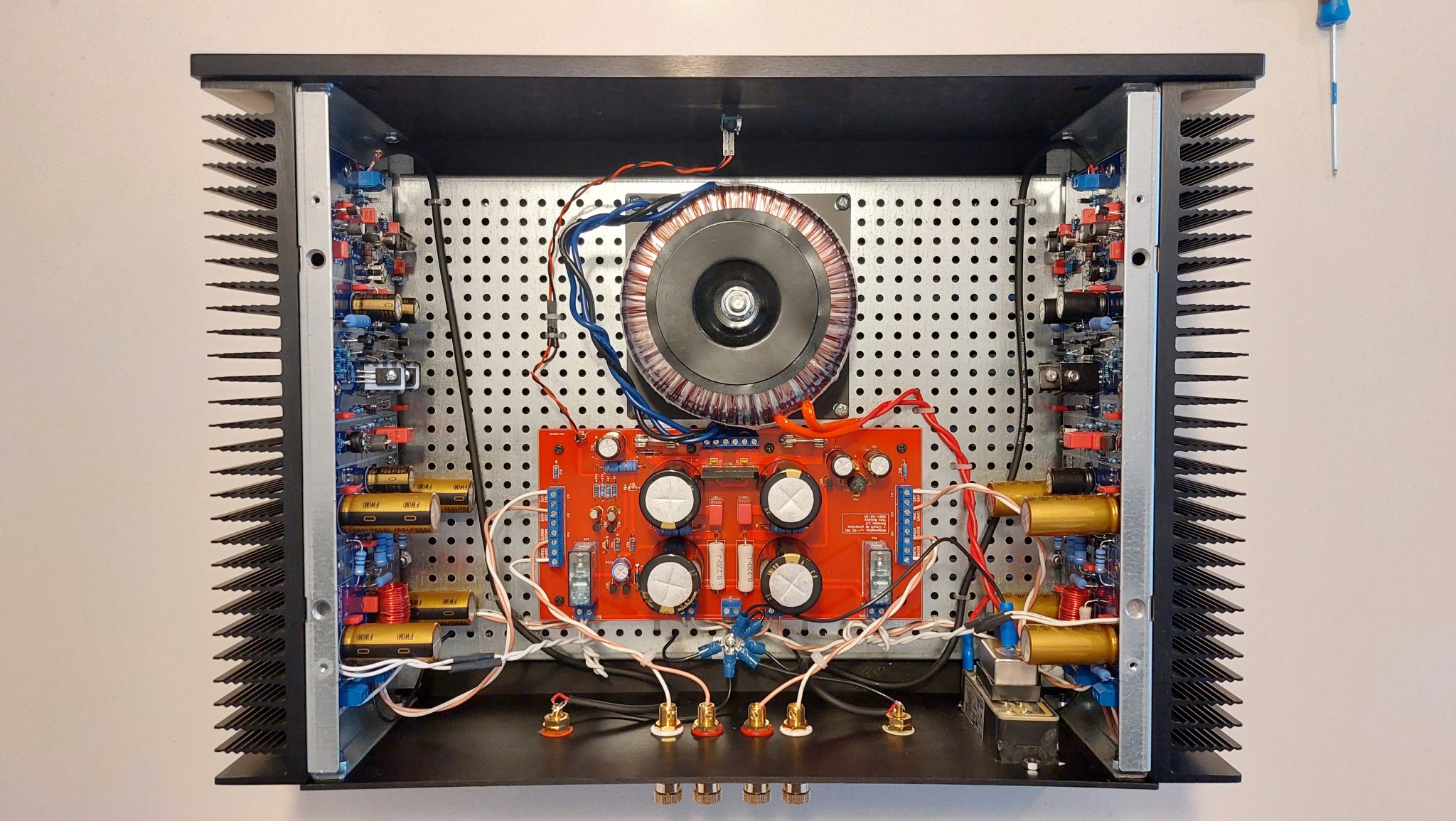

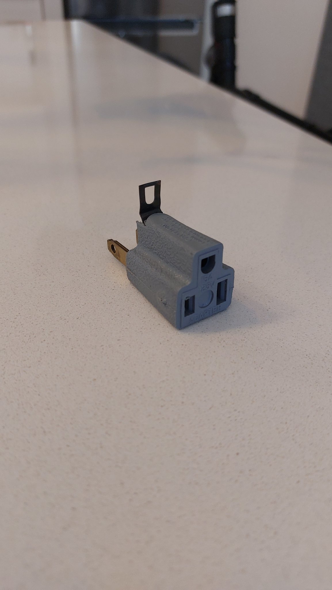

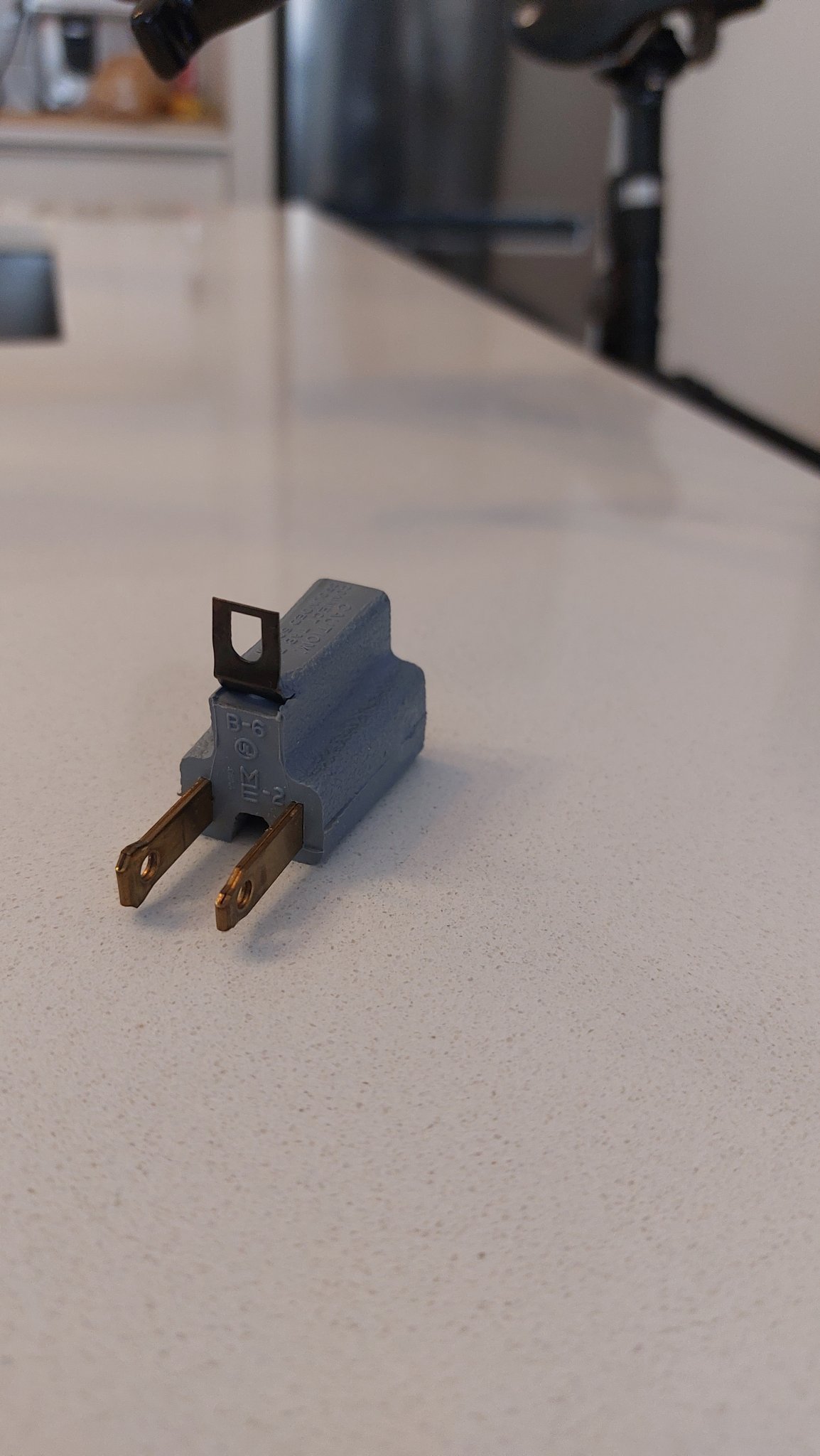

Following your suggestion, I had this plug in my stock and did the test:
The noise is still present but had improve about by half to my hears. Notice that it is already pretty low in volume without the plug. So what the bridge diode solution trick would look like? Any schematic to better picture it in my mind?

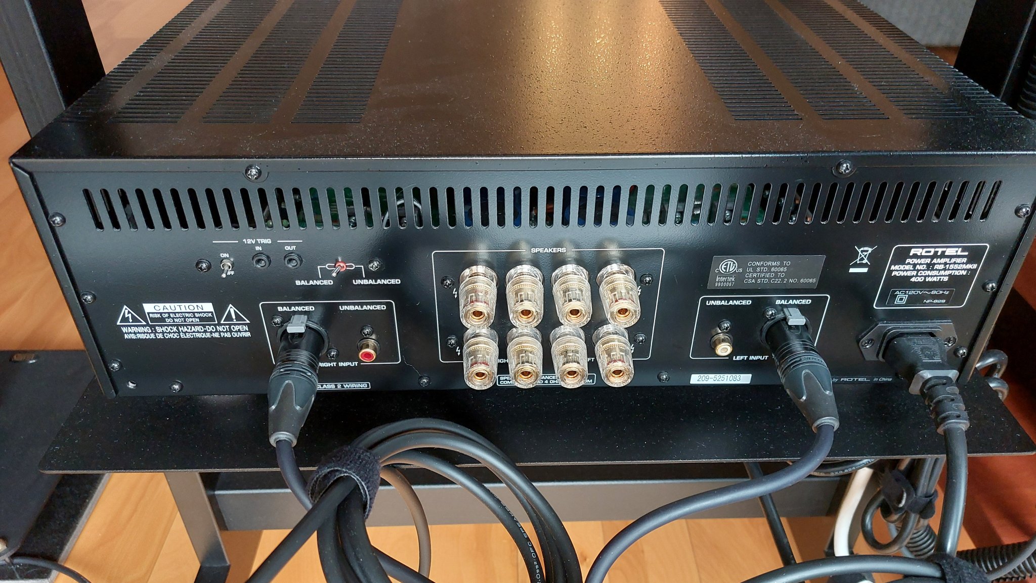

this could be the root of the problem, the layout is typical of diy amps.
the physical separation of the left / right input signal creates a loop area.
(probably made worse by having the pcb inputs at the opposite end of the chassis to the input sockets)

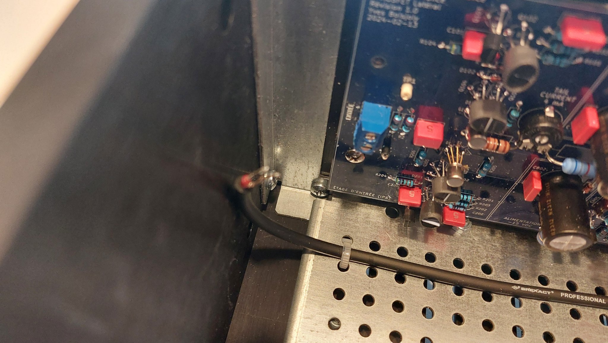

Here is one question I have in mind. If you look carefully at the picture above, my amplifier board was designed to have the HQG at one end near the +50/-50 VDC. The Input ground is at the other end of the PCB. When came the time to interconnect everything, I noticed, with the headphone over my hears, that the noise was going a lot lower if I connect the HQG of the Amplifier to the HQG of the case while connecting also the RCA input ground lug onto the case HQG. But I realized that this could make a ground loop if I connect the Input GND with a wire (in my case it is microphone shield cable) at the PCB Input ground also. But if I DON'T connect the PCB Input ground, the noise is worse.

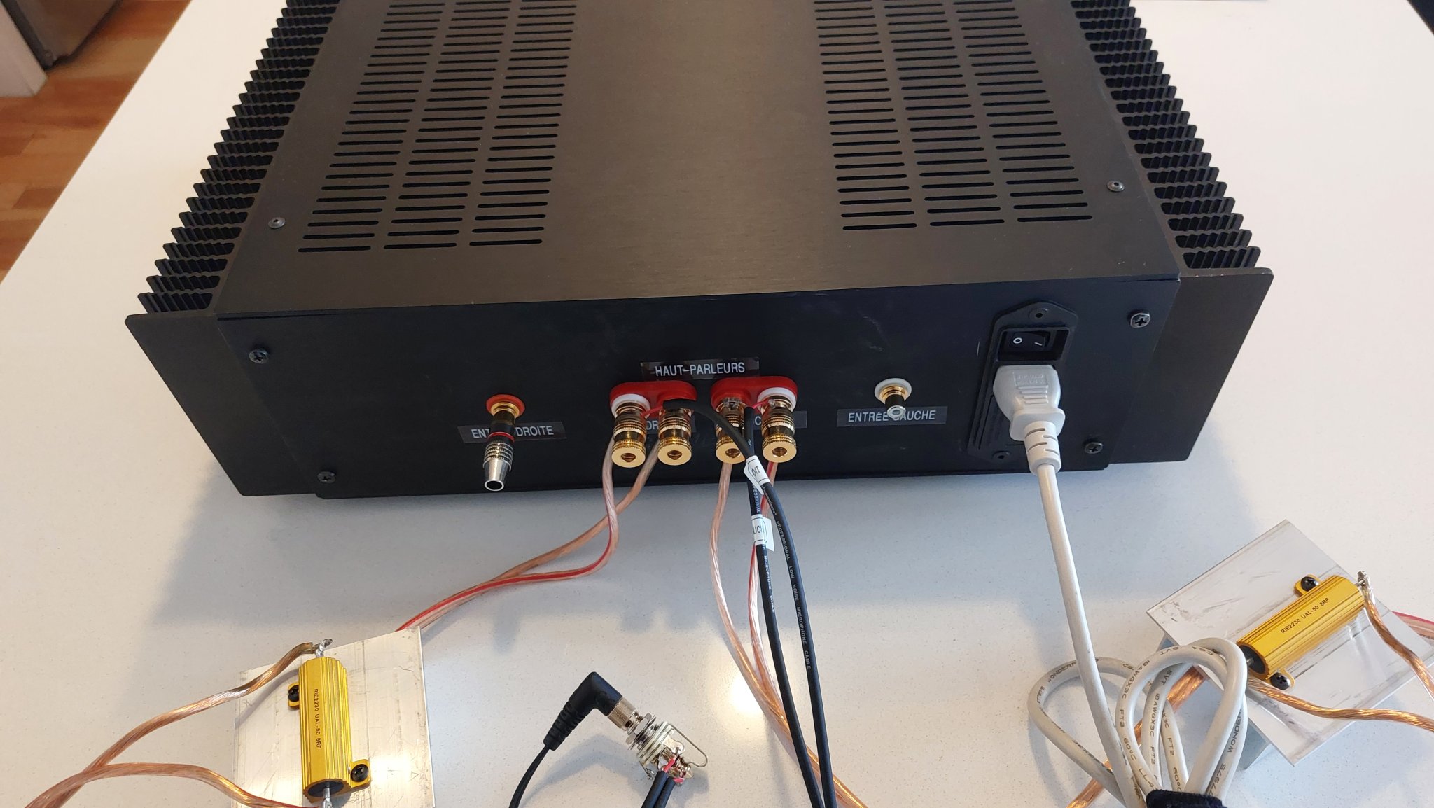

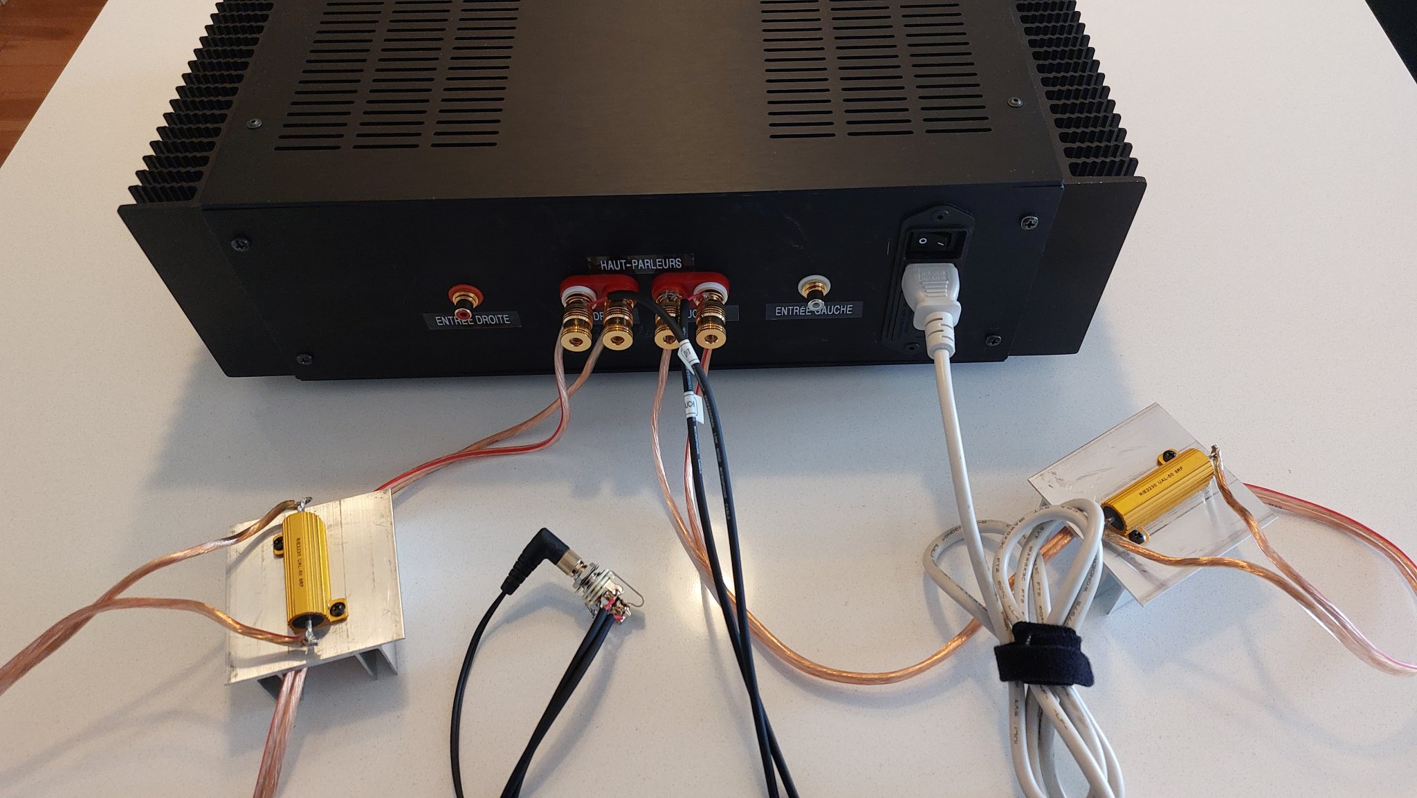

So I just tough to test this again. In the pictures attached below, I have two 8 Ohms/50Watts resistors connected to the speakers terminal and my headphone in parallel. If I don't connect the RCA Male connector with it's hot wire grounded (picture 1), there is no noise. If I connect the RCA Male connector to one channel, the noise is present on that channel (picture 2 and 3).

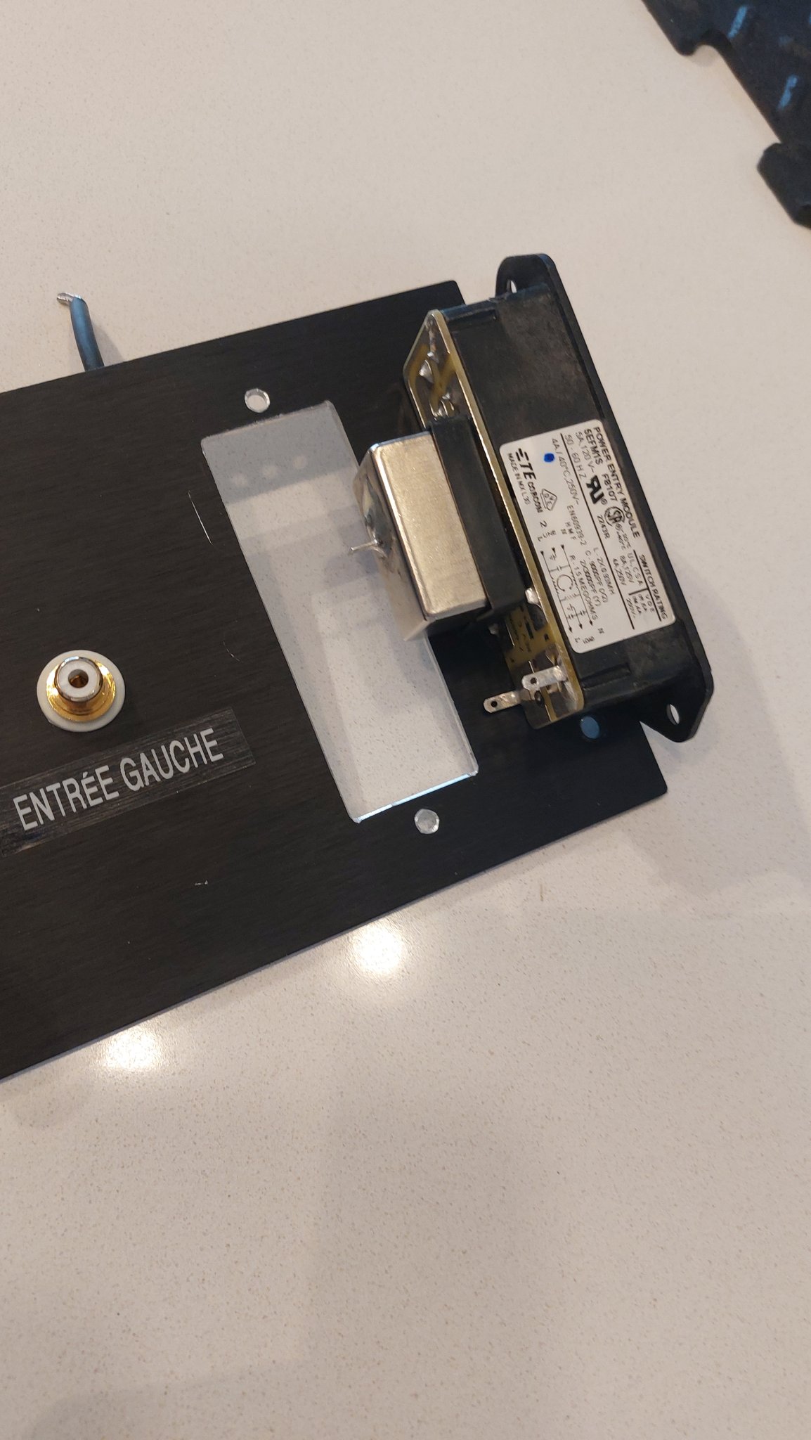

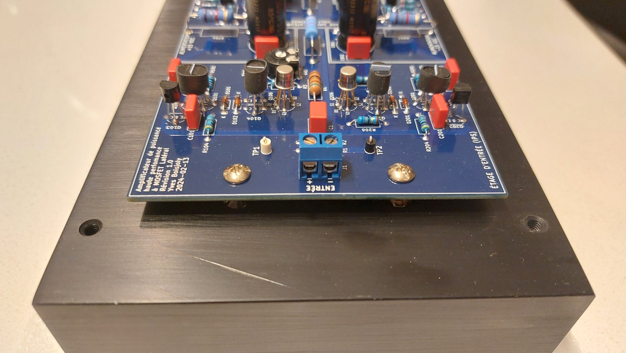

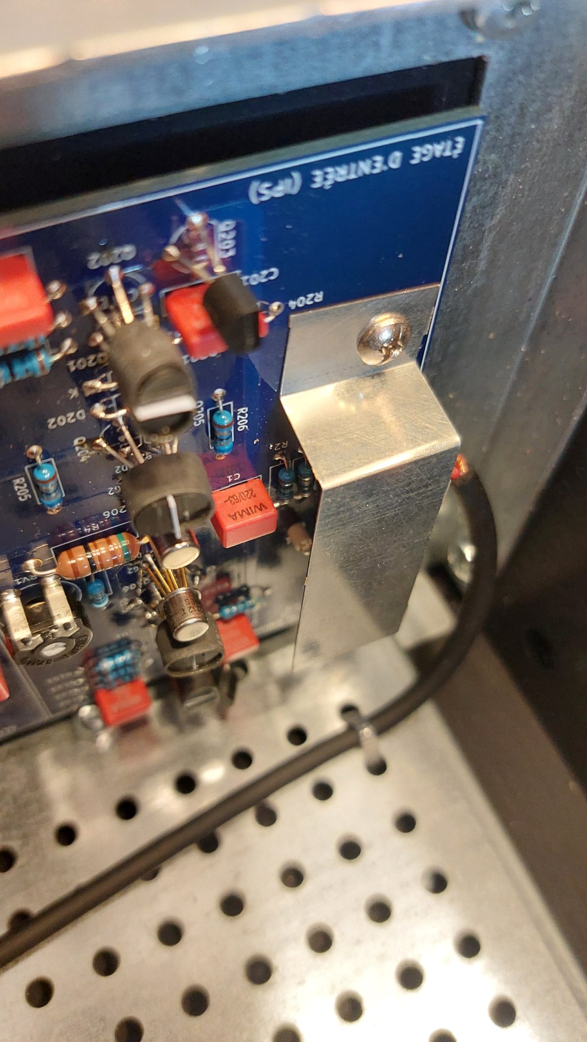

And I also noticed that my Input tests points (White TP) could be an antenna.
So I try to bring one finger around them and the noise is becoming very loud the closest I bring it. Of course I didn't touch it lol... Then I tried to invert the shield I used at the Input connector to have them cover also the test point (Picture 4). The noise doesn't go up now when I bring my finger close to the test point, even if I touch the shield. But that didn't fixed the noise when a RCA connector is plugged in.

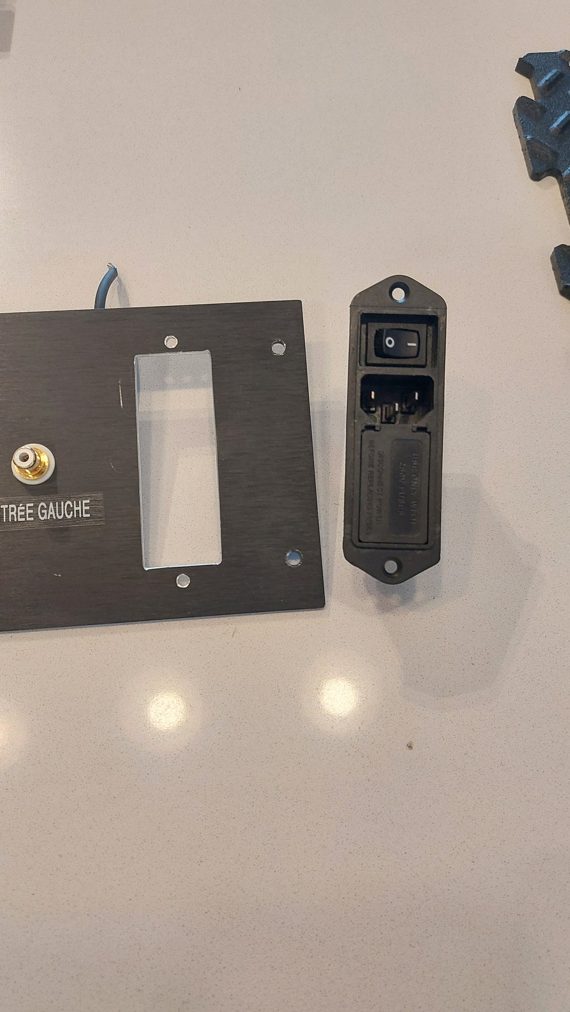

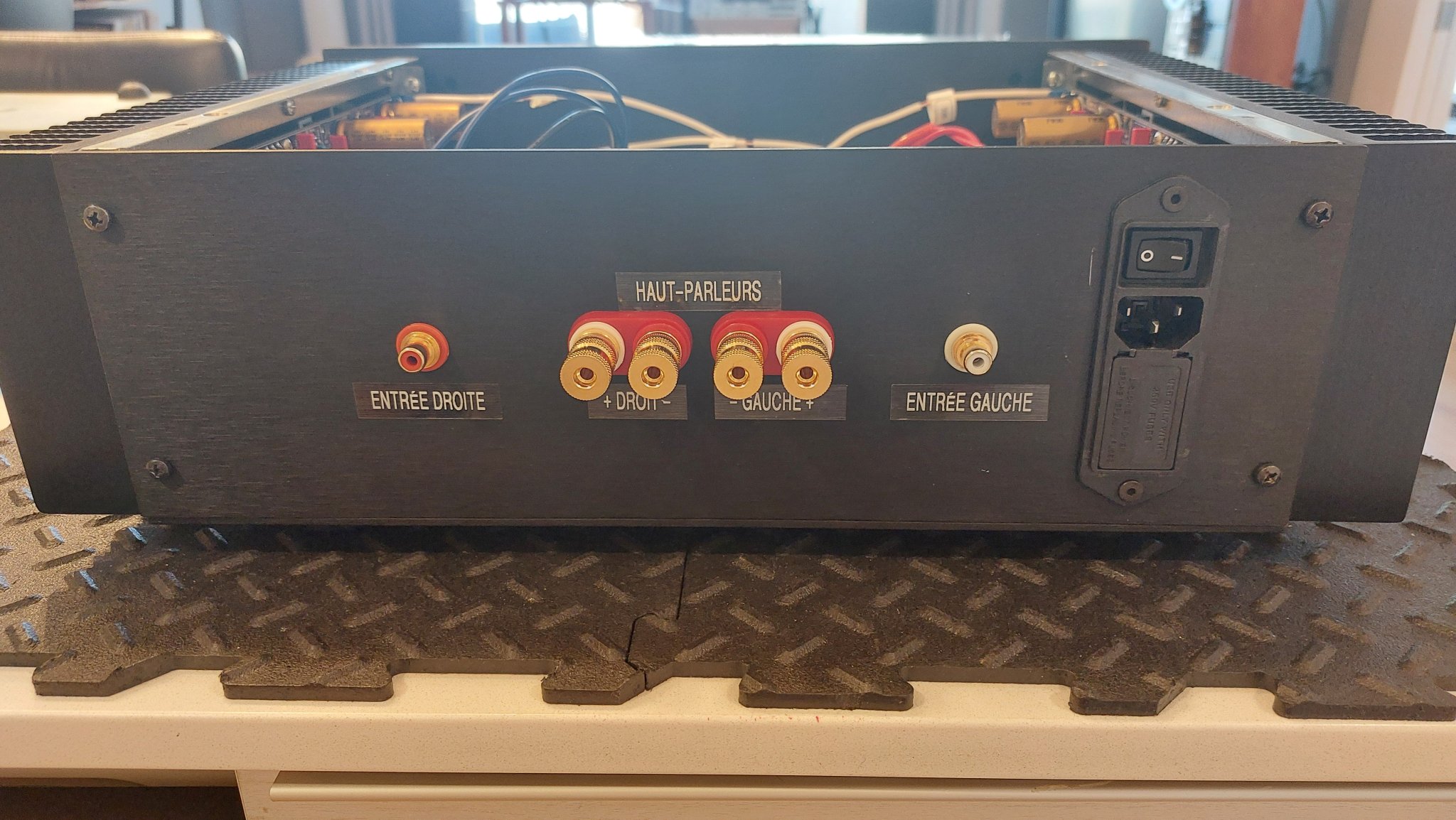

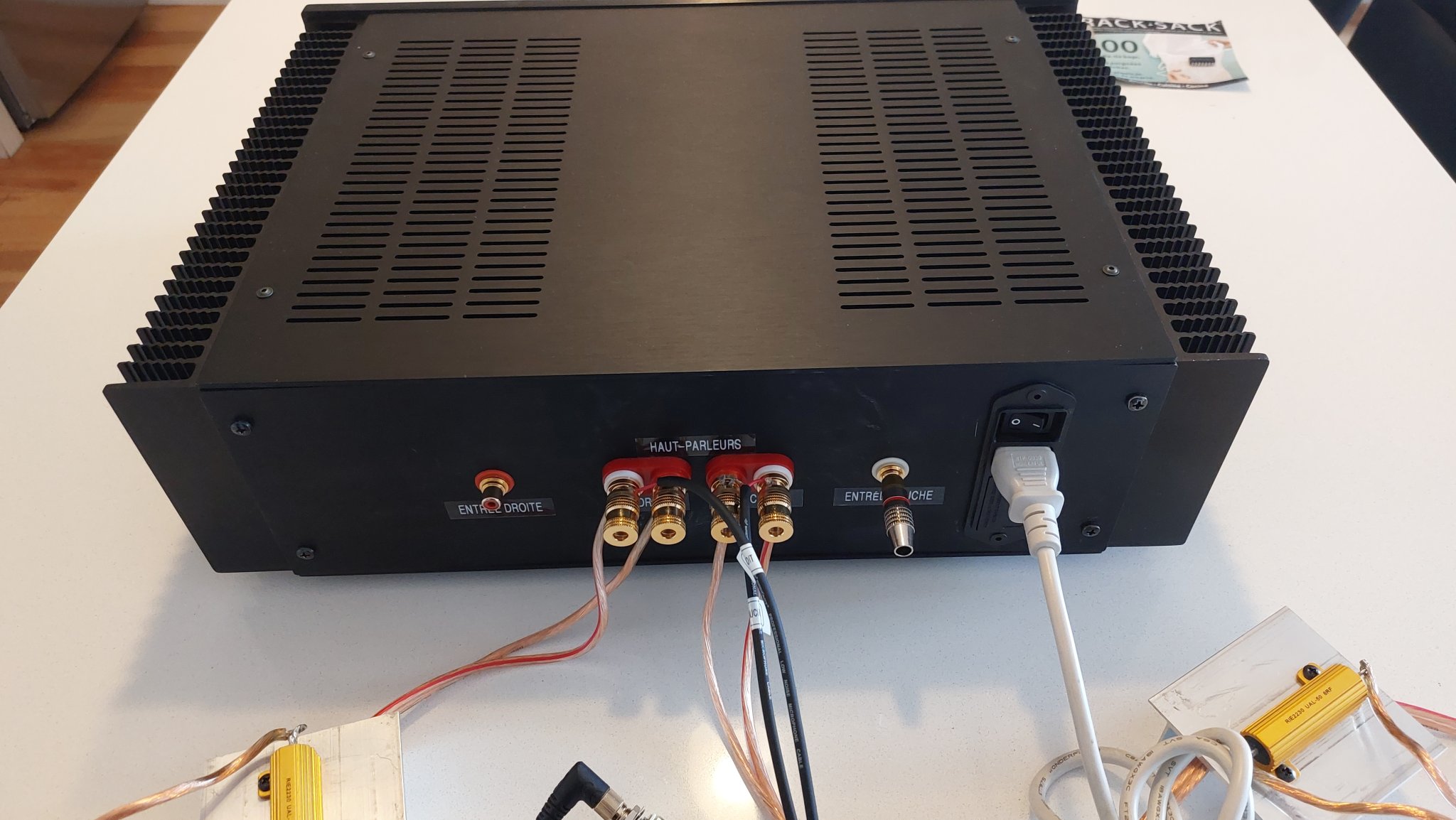

As for the position of the input RCA, I used the Rotel back panel as my inspiration... (Picture 5). The first mechanical design was effectively to have the Amplifier board inverted with the Input connectors close to the RCA connectors, but a huge hum was present because of the close distance between the left channel (ENTREE GAUCHE) and the AC IEC plug :-/

Why don’t you make a recording of the offensive noise using your phone up against the speaker and we can then take it from there?
The above poster (#31) has pointed out an important flaw in your amp layout whether it is the root cause of your problem or not.
Never place input connectors on opposite sides of the amplifier rear panel because you create a large loop area that will couple to any noise coming in.
The test for this is to plug a cable from one input to another so it forms a loop. If the amp is noisy with the cable plugged in but not when you unplug one side, you have a cross-channel ground loop.
See the presentation below for more info (I suspect you may have other issues though related to HF noise - see the section about RFI and cable screening).
https://hifisonix.com/wp-content/uploads/2019/02/Ground-Loops.pdf

See post # 20!
Hum, just did the test and it is noisy with the cable connected between both inputs. So I should move one connector closest to the other? Right? I would choose the left connector then seeing that it is close to the AC line. Moving it away, close to the right connector. Does that make sense?

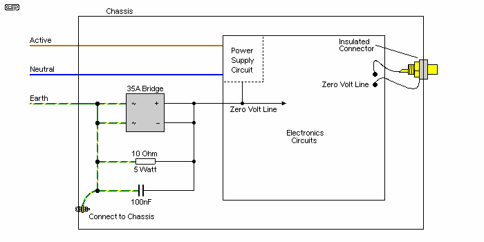

It's simply a parallel connection of a 220nF or similar (X2 maybe) capacitor and a 120Ohm resistor between signal ground and chassis/mains ground.
As this only gives a weak safety connection, a decent bridge rectifier can also be placed in parallel: using the AC of the bridge pins, with the + and - pins shorted together. This gives a robust 1.4V max difference limit, between signal and chassic ground, for the safety aspect.
Thus some hum is allowed on the earth/chassis, isolated from the signal ground.
This should IMO be soldered near the RCA inputs, as that's the amplifier providing the signal ground for the rest of the gear.

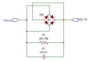

Regarding isolation of circuit ground from AC line and chassis ground, the following pic shows a common type of "hum-breaker" circuit:
Resistor value may vary in some designs, possibly to as high as 100R.
