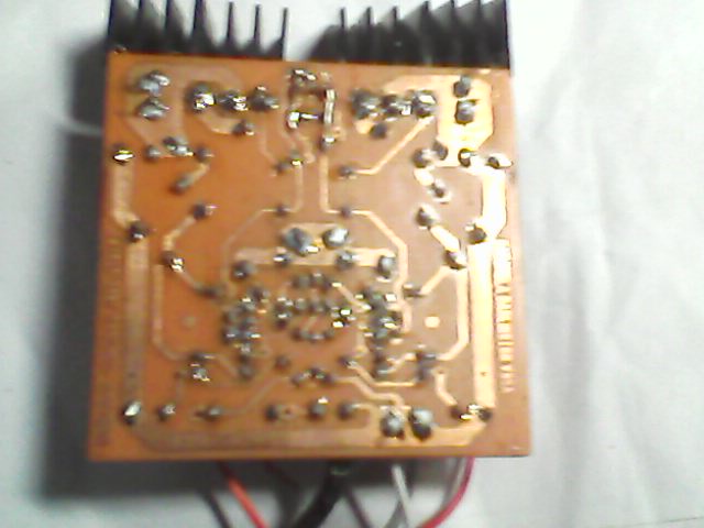

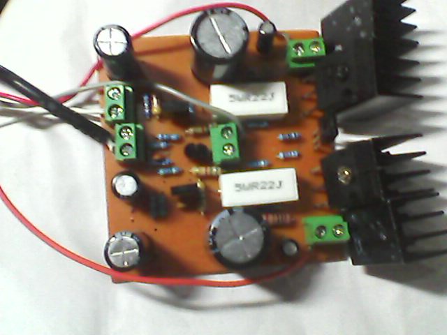

Just powered up the Bipolar assisted output stage ( LatFET).
Everything sounds the same as before but the bipolar's do get slightly warm at high volume. Without a careful listen I can't say if anything got better or worse. If anything bass is tight and deep and treble quality has not changed. I used to think that bass was slightly less damped with the LatFET alone but then I could be wrong .
I find that voice still sounds the same and has not deteriorated in any way. I need to check closely at the point when the bipolar's kick in. Problem is that it's pretty loud by that time ! Hope my neighbours don't complain.
Bottom line is that I didn't loose anything that is glaringly noticeable. So now on to the stereo version and see what we get there.
Maybe the new board should be easily switchable between LatFET and bipolar ( while assembling!). I'm targeting about +/-56V supplies.

Yeah I'm pretty much aware of the NFB caps and it's value. I didn't want to go larger as I don't have better types of that size. In any case it is good enough as it is. Bass is good right now. It won't audibly go any lower if the LF -3dB point goes any lower. Right now that is at about 1 Hz ! I do use low voltage caps ( 16 V ). This cap only sees the base emitter voltage plus the drop on the emitter resistor which adds up ,in my case, to under 1 volt.
The current heat sink seems pretty good with the LatFET's. I'm playing pretty loud and it's not getting too hot.
I don't expect the bipolar add-on version to tighten up the bass as it comes on only at higher voltage levels . So if the speakers back emf is the controlling factor , those bipolar's probably won't do anything for it.
I've always been curious about how it would sound and right now it's easy to rig it up. So before everything is stripped up again , it's time to make a test.

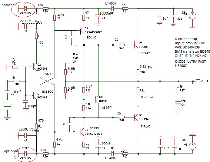

About stability. I have not used C6 and C7 as shown. I've used base collector caps of 47pF on the two drivers and everything is fine.
With the LatFET I decided to try the C6 and C7 as shown on your circuit and it oscillated badly. I've used 220 ohms at the gate.
Funny thing when I made the layout I do had the feeling we will need (Miller caps on the drivers with the LatFet) so I made room for that on my layout.
I do not own a scope so to avoid oscillation better to have them.
Good to know we may need them...

I don't think you will get any benefit out using bipolars on LatFet at least not sound wise.
It may add some fullness to the bass (not even sure about that) but please pay att. the bass not to become muddy and rounded..
Same thing when we increase the caps value on the feedback.
I don't think it will go deeper or tight up the bass just by increasing the size of the caps.
But again if the capacitors are under sized that bad to...
Probably better quality caps like Nichicon Gold 470uF would do the job.
Same true on the input caps. You have to find the right quality and right value..
Very important to do A-B test after any mode, otherwise you will get lost.
Even at A-B test the new parts can play trick on us (new parts most of the time need some burn in time)
If you have different driver transistors please test those.
You may get surprised.
That gave me a huge sound improvement. I did tested at least 7 or 8 type transistors for driver and still has some others to test them.
I read the same some other simple project like P3A the right driver transistor is a big factor according to Sakis..
Be careful when you increase the rail voltage, if you blow up the mosfet that will take your expensive speaker to.
Please keep inform us with your progress.

Hi gaborbela,
Here my current setup. If you want you can try this. Now beautifully singing even with small heatsink. Sorry for pics is not clear.

Why is D1 & 2 UF as described on schematic?
If the output pulls the supply low enough that the diode becomes reverse biased, does it matter whether it's a 1N, or UF type?
Hi AndrewT, I used UF because i dont have 1N diode.
Thank you
Some advice
BD136 and your power transistors must be mounted together in one heatsink...
Your heatsink way too small for these project, be careful you can have thermal runaway at any time and that may take out your speakers to!!
To be honest I would be afraid to connect my speaker and play music at any level like that without speakers protection.
Otherwise nice work!
Greetings G

why the noteHi AndrewT, I used UF because i dont have 1N diode.![]()
Diode: ultrafast UF4007
Thank you

Thanks for the advise G. But the heatsink is low temperature around 37-40C. I set R15 to 1.3K to make temperature low and R5.R6 47 ohms. And also feedback resistor plays important role in balance temperature both output. That is based on my observation. Any comments are welcome.
why the note
Andrew would a slow diode be better ?
I can't see it matter.
- My first DIY amplifier 20 years a go
