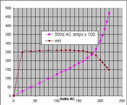

Here's a graph of choke AC voltage, current and inductance. This is the tranny with the bobbin, using the green winding only. With both windings in series the inductance is about 960mH. Here it is averaging 258mH. The maximum AC current before the onset of saturation is shown clearly by the drooping inductance and the steepening of the amps graph. I chose 2.16 amps AC as the max, the peak of which is 2.16 x 1.414 = 3.05 amps. So it will take ~3 amps DC. This is with an airgap of 0.25mm. Wider gap = lower inductance = more amps capability.

I also made my own choke for the power supply, 60-70 turns of 1,4mm wire on a EI84 core. Hope it can take 6 A DC without acting like a fuse...

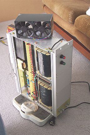

Status report:
The bottom plate has been machined and all the PSU components are in position. Only a little wiring left (most have been done) before it´s time to test run the PSU.
It´s quite heavy already and still the chokes, heatsinks and most of the chassis are missing![devil_r :devilr: :devilr:](https://files.diyaudio.com/forums/images/smilies/devil.gif)

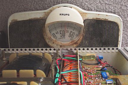

Yeah, I know all about heavy.
Mine weighed in at 51kg before it was finished. I bet the amount of work you do on your amp increases exponentially as it nears it's finish!
