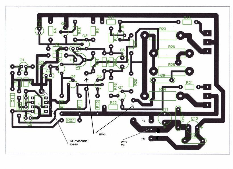

If I post a couple of sugestions on the PCB (the first one you did way back yonder 🙂) could you see what you think.
I'm thinking it might be beneficial to have the input ground and the PSU/Zobel ground as separate points that can be run back to the main PSU to avoid any channel interaction for a stereo pair on a single supply.
What do you think ?
I'm trying a rework of a layout I did some time ago based on this image that incorporates the important points of correct NFB take off point and also the ability to use two ground return leads to the PSU. Two returns keeps the signal ground separate and avoids channel interaction in a stereo pair fed from a common PSU.

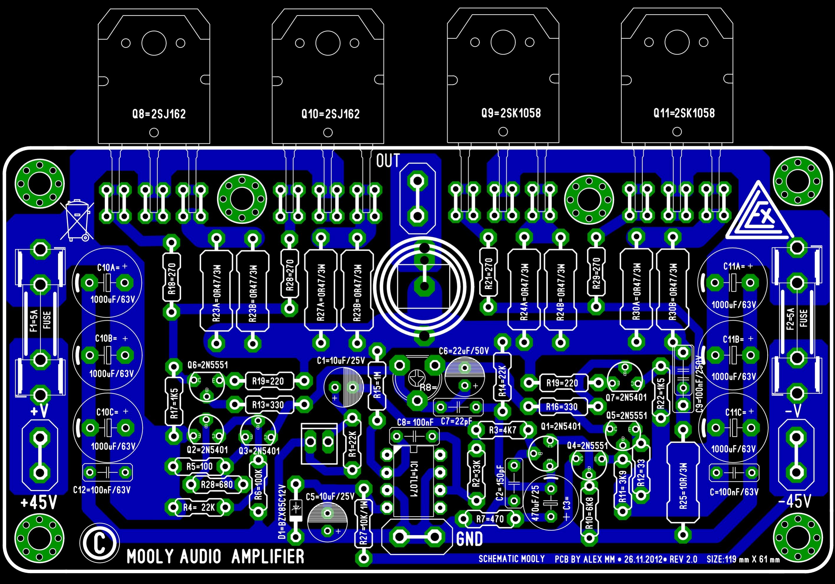

PCB REV 2.0
...... I finish, layout today rev2.0 and I hope, you like how ,it came out 😉
I will post, all needed files (gerbers, drill, black&white ), but first ,I wish someone to make Q.C . :hohoho:

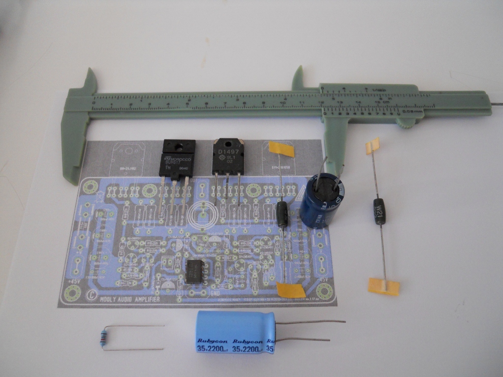

I've printed the board out to scale and find we're a bit tight on real estate. The high wattage resistors (the 0.22 ohm) and the PSU caps would be similar in size to the parts in the picture. The small resistor is a normal 0.5/0.6 watt metal film.
(I feel really terrible saying this after all the hard work Alex puts in on this because the boards are spectacular. Have I missed something here with the part sizes 🙂)
The board layout is good. All I would perhaps alter is the NFB takeoff point which can be done easily and maybe look splitting the grounds... at least to give the option. I'll look at that more.

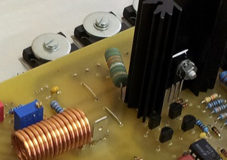

😀 Iv'e been told
the default for 1/4W resistors on my software is also 0.4 in.
but I like to give warmer resistors some room to breathe, Im novice though.
Picture is how I fitted 5W on same situation on APEX SR200 3.1 board

Wow alex, that was real nice job you did. Better let the specialists comment on the layout as thats above my head, but from a visual point its beautiful and I can see from your design it will be easy to correctly populate the board.
Looks like we are a lot closer to getting some pcb made, appreciate the effort as I am sure everyone does.
