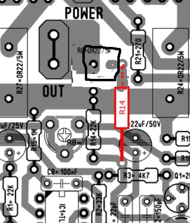

R14, the NFB upper leg resistor, can be soldered onto the Ro lead as it comes out of the output rail trace.
That ensures it reads the output voltage.
That would be ideal.

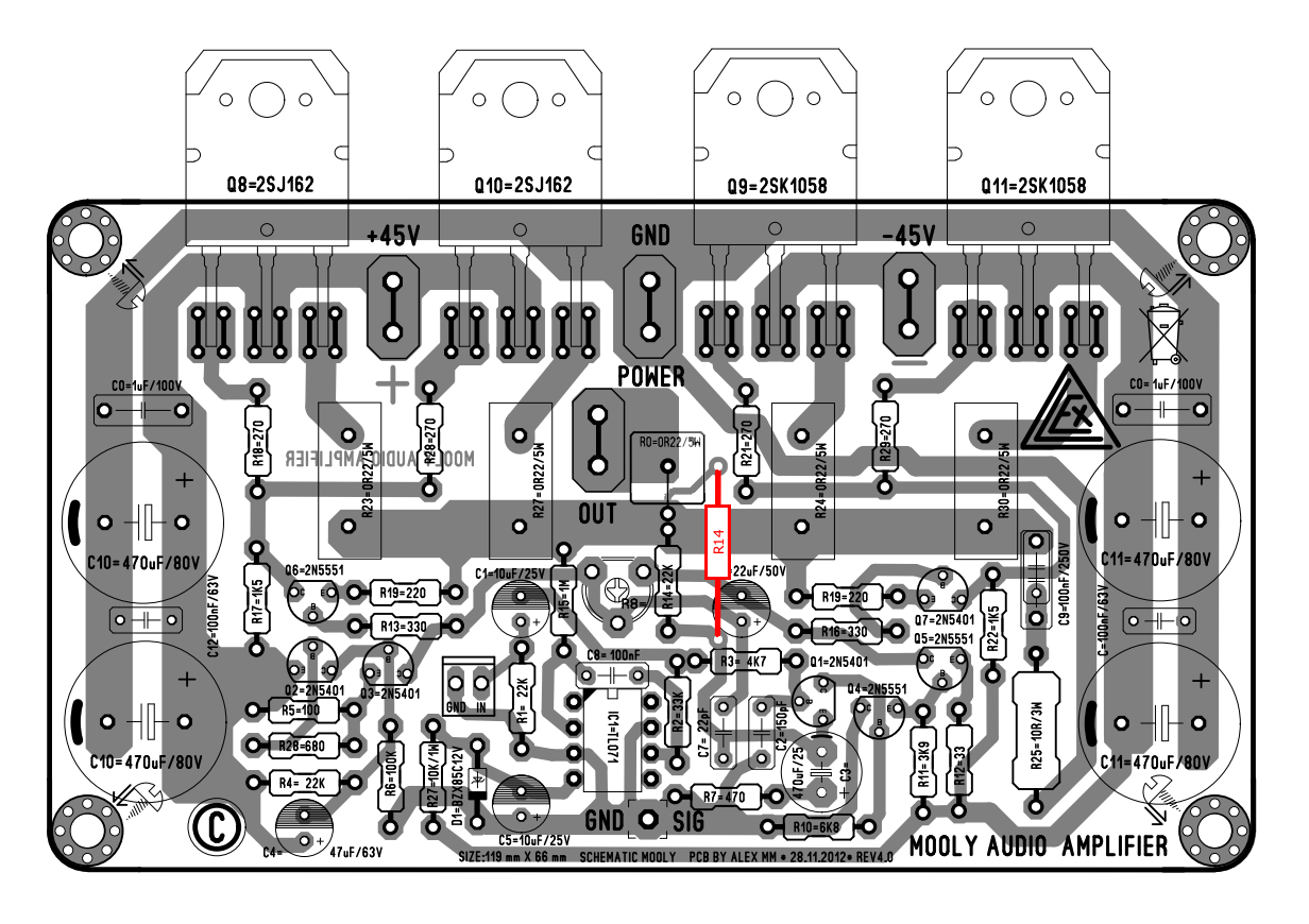

Hi Guys, I went over Alex PCB design and schematic and R10 looks like inadvertently it was put on signal ground instead of -45v. Was this a mistake?
It is an error... well spotted... and it does indeed connect to the negative rail.
If so, what value should I put for the feedback resistor as per post 385.
The feedback resistor is still 22K, its just the take off point that was open to interpretation/discussion.
Remember the exact point at which this resistor connects in regard to the physical layout, is the exact point which is used as a "reference" for the signal.
Ideally it should be on a spur like this.
