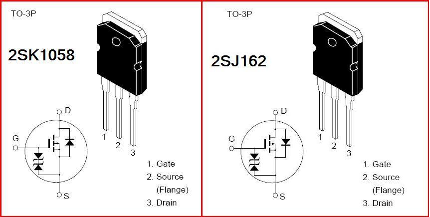

Hi mooly, hw r u?...pls check my pcbs. And give your views.....about to complete the same
The FETs are yet to be populated...have ordered them and they r on the way...just cantcan't wait to hear them play..have read about the fake FET s. Just wondering the ones i have ordered are genuine or not.
If you have any methods to test them easily for genuine pls do post the same...waiting for your reply ...regards ...

There is no easy way to test the FETs without actually putting them into a test circuit although a big giveaway would be if the Drain and Source pinouts were reversed making them like ordinary vertical FETs. So you could read across the inbuilt diodes across D-S to check that. Also if they needed a much higher gate-source voltage to turn on (meaning they could be ordinary vertical FETs).

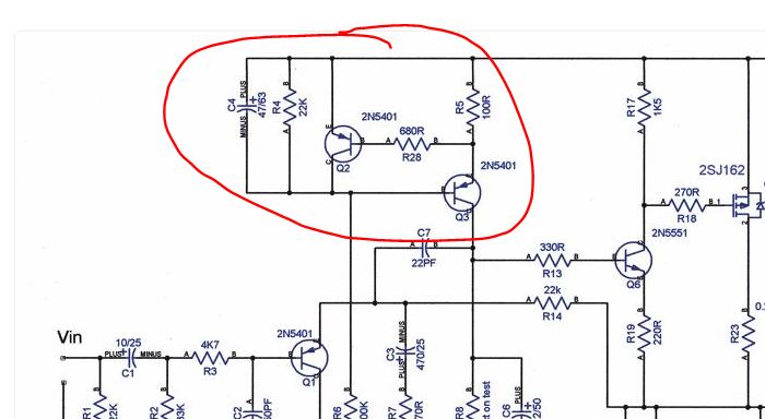

Hi Karl, just powered up the circuit without the FETs in place.
As per your instructions in thread 12 . Have checked the same step by step
Pls find the readings below.
Test Power Supply voltage 19.5 V.
Bias Pot has been kept at zero resistance between collectors.
The voltage across 100R. R5 is 8.65v
The voltage across pin 4 and 7 of opamp is 5.6v
The voltage across R17 and R22 is 11.69v each approx. ( which is higher , normal being 7 to 8 volt)
The o/p voltage is 0.26v
The issue is that Q4 and Q5 are slowly getting very very hot after 4 to 5 seconds of power on and have to switch off the power immediately..the degree of hotness gets worst when the bias pot resitance is increased....pls suggest. Have checked the boards for errors but both the boards are showing the same behaviour when powered....regards SS.

You have a problem with constant current circuit Q2 and Q3. It can only be a problem with either of the transistors or a board error.
How it works... Q3 is turned on via R6 (the 100k). Q2 has its base and emitter junction effectively across the 100 ohm. When the voltage across the 100 ohm rises above 0.6 volts Q2 turns on and limits the current flow in the 100 ohm by pulling the base of Q3 toward the emitter (the positive rail) turning it off.
The problem at this point can only be related to Q2 and Q3. Check for correct pin outs and polarity and make sure the transistors are PNP and of the correct type.
Read the edit
should have read at this point can only be related to Q2 and Q3
Fixing the current source is the first step. No matter what other problem there may or may not be, if the current source is OK there will never be more than around 0.7 volts across the 100 ohm.

Hi, Have fixed the current source and the voltage across. 100R is now 0.8v approx.
But the heating problem of Q4 and Q5 still persists. As already mentioned in above post.
When the pot is turned clockwise the Q4 gets heated and it can't be touched and vice versa with Q5when pot turned to min position anticlockwise. Have checked the transistors they are genuine...pls suggest.
Good to hear you fixed one problem. What was actually wrong out of interest ? Knowing that might help with other problems.
Q4 and Q5... again I suspect you have a problem in either construction or the parts. There is a low impedance path through Q4 (from its grounded collector) and then through the Q5 base and emitter junction to the negative rail. Are you sure Q4 and Q5 are OK ? The constant current problem could have overloaded and damaged them.
If you lift one end of R3 (4k7 at the input) then all the transistors should be off and nothing should get hot. That's a rough and ready check on whats going on. It might be worth doing.
Is the opamp a TL071 ? because that does provide the biasing for the input stage.
