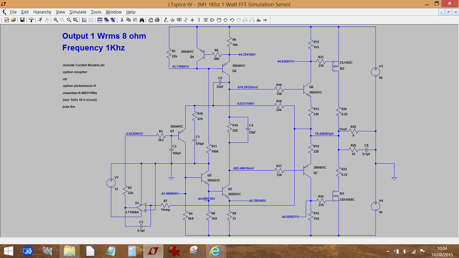

I have found one issue though I don't know why. Q3 (Q5 above) has zero vbe. Base and emitter are both 43.7V. The transistor tests fine. Q2 (Q4 above) has .5V vbe.
Both boards measure the same.
I'm attaching an asc file that I think is the same as the circuit I am using but it doesn't work either. Can you take a look and see if you can make it work?
Thanks, Terry
+Have you tried 22pf across the gate and source on the 2sk1058.s . Evette
Not yet. I need to get the voltages right first.
I added the 22p to the G-S 1058. No change. I just checked and I was wrong. Q3 ;has .658 vbe so plenty but for some reason when I measured earlier the b and e both measured the same to ground. I just took some more measurements and a couple things of note. When I first power up I see about 30mV offset at the output. it takes about 10 seconds or so for it to rise to more than a few volts. It is like a cap is loading and pulling it off.
One more thing as I am trying to learn something here. Should this circuit work without the IC in place? My understanding is that it is there to correct a small offset. If I pull the IC I have 10V offset and after a few minutes it may rise to twice that much.

Solved it!!!!!
I had to reverse C3, the 470uF cap on the NFB. The schematic and board silk have it with the + lead to ground. In an effort solve this I looked through a bunch of schematics from other amps I have built. Every one of them with this type of NFB had the - lead to ground. I figured there was so little voltage there it wouldn't hurt to try reversing it. So I reversed it so that the - lead is to ground and now all is beautiful. It has been playing music for 30 minutes or more and everything is stable. I ran some square waves through it as well and they look real nice. I'm going to let it burn in for a while on my test speakers and then I'll hook it up to the A/B setup and compare it to a few other amps.
I also discovered why I thought the gain was low. I had inadvertently switched my tone generator to sinc mode and it lowered the output to 300mV so I only thought I was inputting 1.2V. It has plenty of gain and sounds sweet.
