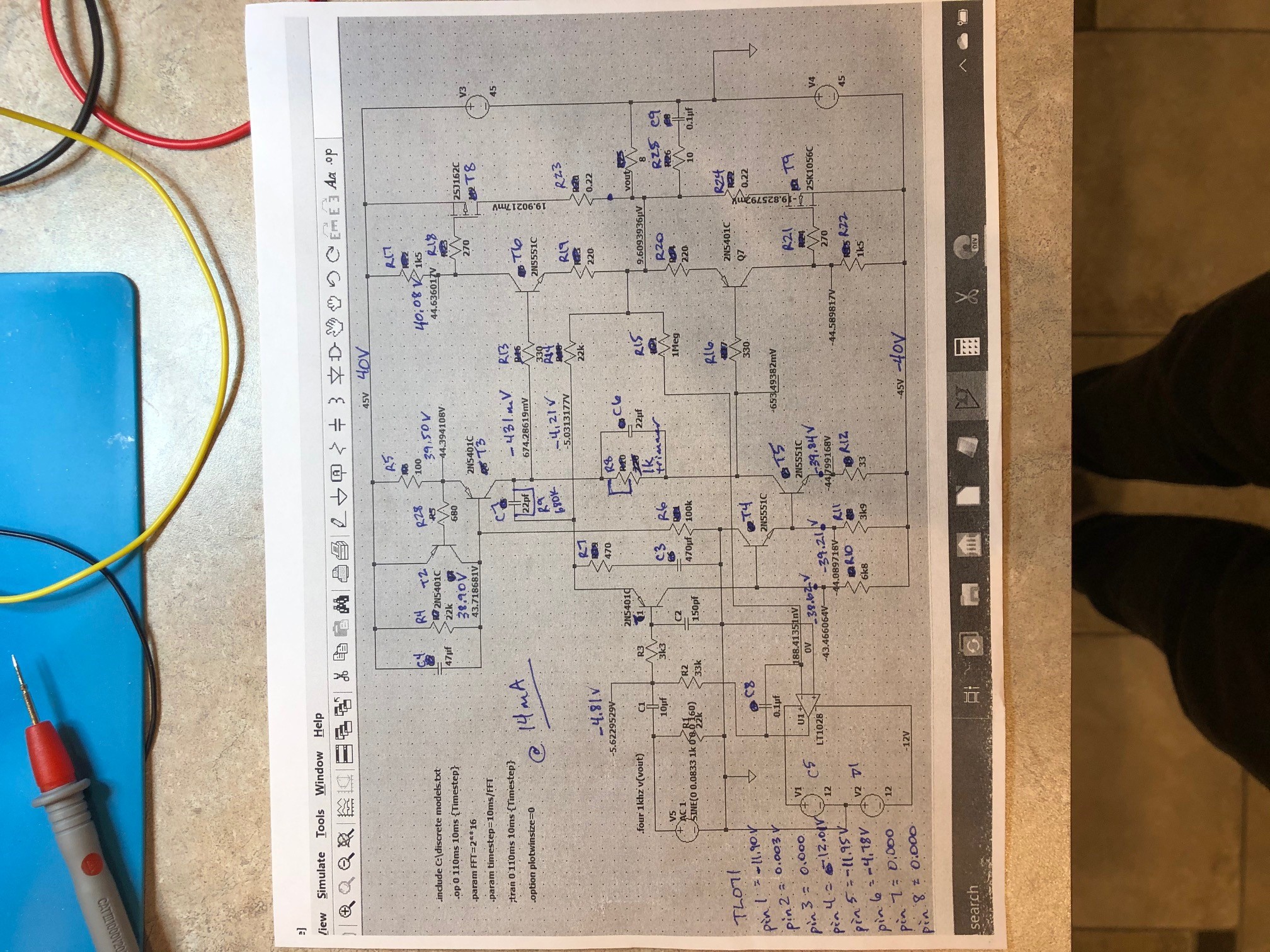

schematic with my actual voltages
I have not tried any ferrite beads before, but with no one else in this thread needing them to get their am to be stable, I don't think that is the answer.
I went through the Spice file that Mooly posted with voltages - I did update all the numbering to match my as-built schematic 2.2.1 and noted my actual voltages in BLUE.
Looks like the only voltage difference is with the TL071 pin 6. I get -4.78V and Mooly has -5.62V. Otherwise it seems to be very similar.

Thanks for replying Mooly
Testing criteria:
I have never had a load on the speaker output
I have tried it with the input shorted and not shorted (same result)
The bias is kind of surging - granted I am using a 150W DBT
- once the bias reaches close to 150mA, it will surge to 500mA, then back to 130, and just continue up and down. Generally max's out at 650mA.
DC offset is good and only varies +/-1mV
I did measure the in-line supply resistors and were 0.9r and 1.0r with a Fluke meter
One thing I tried last night, was to turn up the bias until it began to surge. Then I touched the components to see if anything was getting hot, only T7 was getting warm, all else was cold.
I tried some freeze spray and the only noticed that T1 would lower bias until it warmed up again.
Then I touched the tops of the caps to see if they were getting hot - touching either C6 or C3 would reduce the bias and taking my finger off the bias would go back up immediately. Tried this 4-5 times and the same result. High bias, touch top of C6 or C3 and bias would decrease to 15-20mA take finger off and bias would rise again.
Also took the Mosfets out and tested just the front-end. Only voltage that was off was on the 270R gate resistor (R30), it had 18.4V, but when I have the outputs in it is close to rail voltage of 40V.

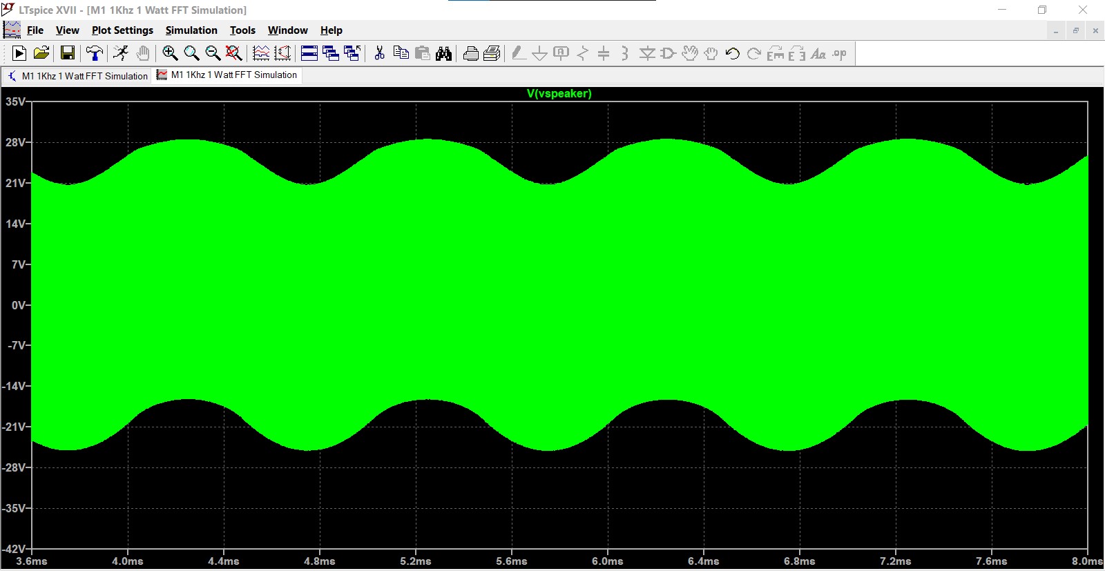

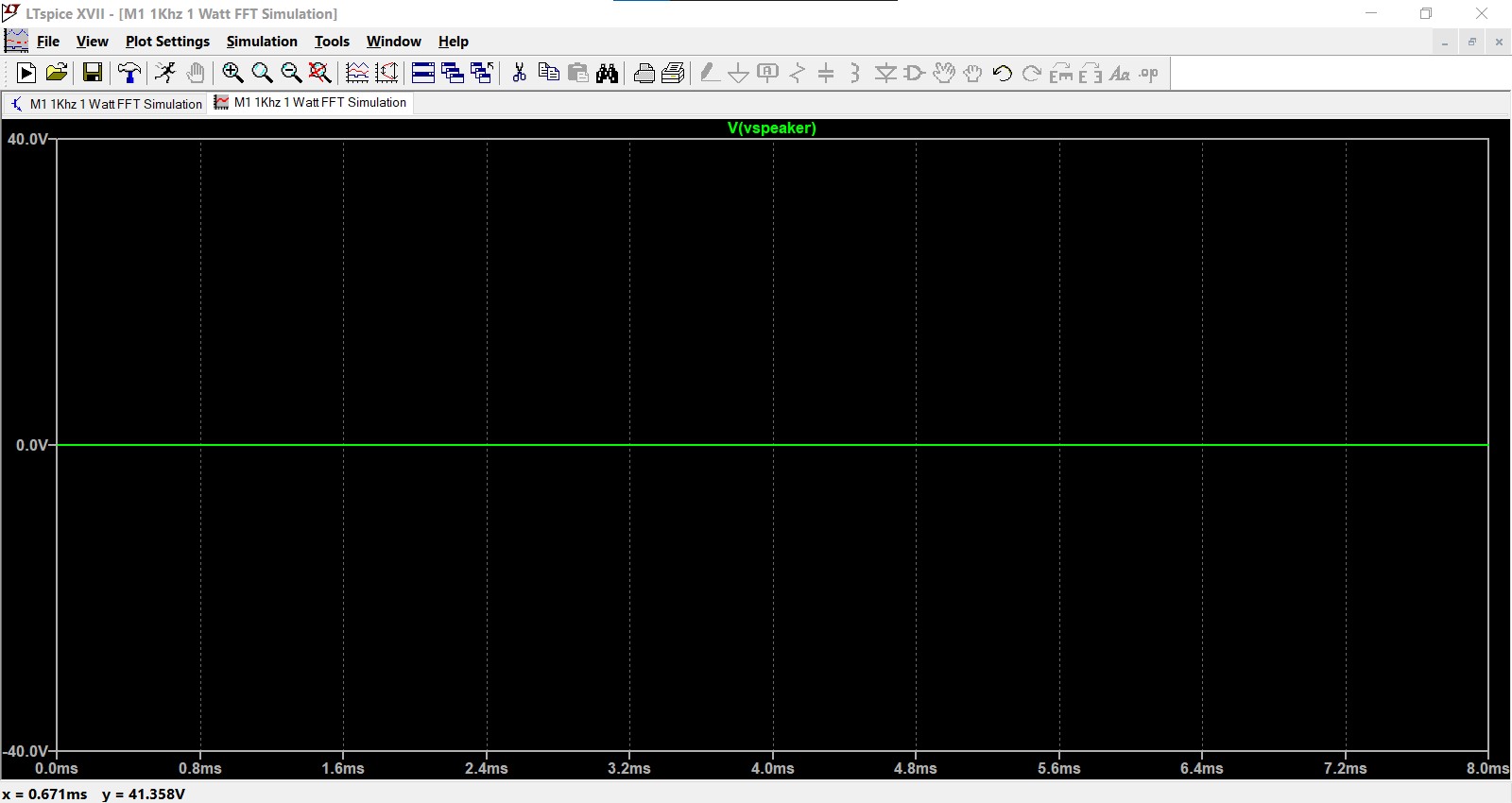

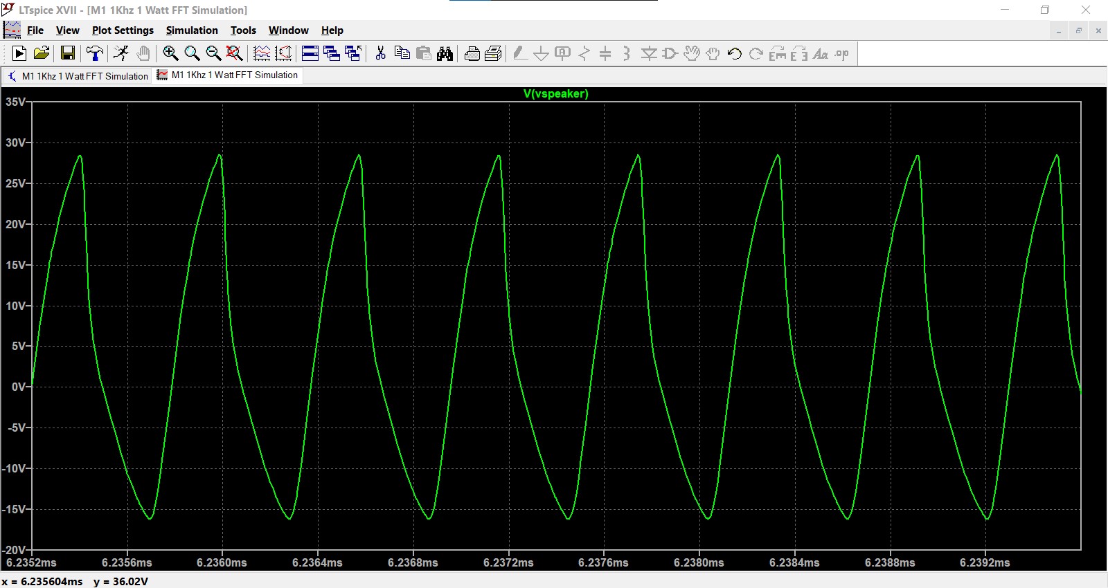

This is how oscillation could look on a scope. I've rigged the simulation of the amp be unstable.
The first image is no oscillation. The scope shows no signal present and the trace just shows a straight line.
The second image shows oscillation. The timebase speed is quite slow and so it shows as a thick blur with no detail. Look at the voltage scale at the left.
If the timebase is expanded (time per division) then we can see the signal in detail. The frequency is around 1.7 megahertz and so it depends on the scope bandwidth as to whether it will show that. The frequency could be lower or much much higher.
As a practical point, if the amplitude of any oscillation were very large then the 10 ohm in the Zobel network would be getting very hot... and I assume it is not.
