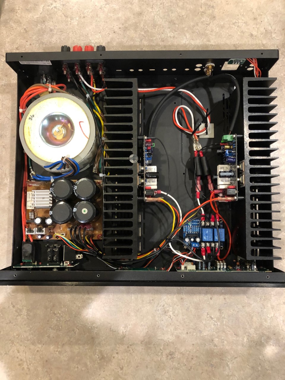

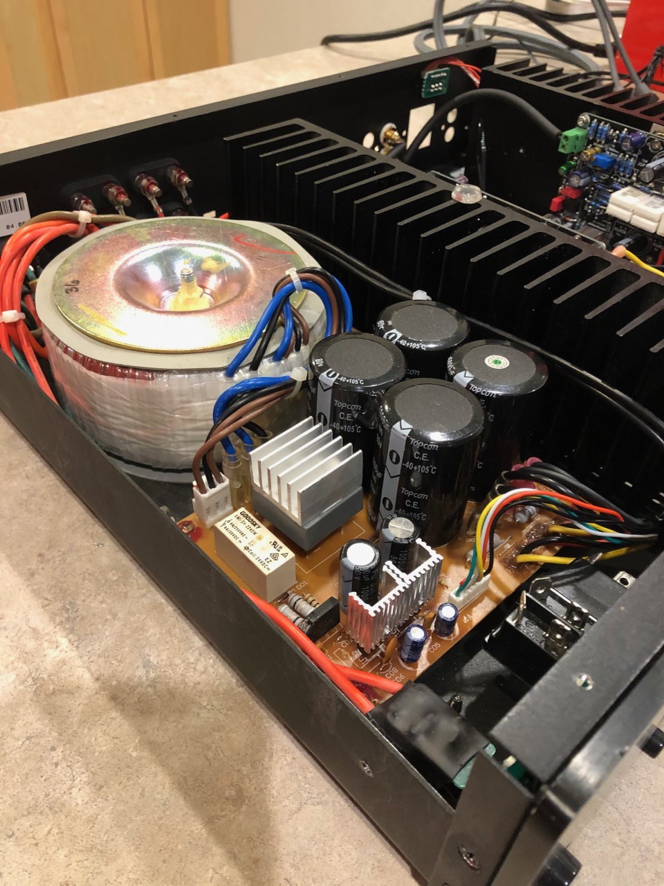

picture of the amp and psu
Couple pics below Vunce and thanks for looking.
It is a recycled Chassis & PSU, 36VAC toroidal to 4x80V 8200uF caps then going to the amp boards. The relay is out of the picture, it has a jumper to always turn on the PSU when the front switch is pushed.
I have a 5-second delay speaker protection as well, powered by +15V from the 7815 regulator on the PSU board, also used for the front panel LED. Have disconnected both speaker protection and LED and still get the same hum.
I have +/0/- from the PSU to each amp board (tightly twisted together), the "0" from the PSU goes to the GND of the speaker protection and to the negative speaker posts. Speaker positive output is straight off the board, with a 6uH inductor inline.
I will reiterate, that the hum is the same in the chassis and out of the chassis and when it is out of the chassis I use my test bench setup (28VAC toroidal with 4x1000uF caps) with alligator clips which I have used to test 5 other DIY amps and I get no hum, or very little that goes away with moving the wiring around.
This all points me to a problem/part on the board, but I have gone through both channels multiple times and find no incorrect parts of any out of spec. Also have checked all the soldering as well, even cleaned it again with alcohol to make sure flux was causing the issue.

I'm having trouble wrapping my brain around having the black binding posts connected directly to the power supply. Then the speaker protect board gets its power-ground directly from the supply board? Isn't that going to cause a ground offset at the amp-board-speaker-ground terminal?
Granted, it doesn't seem like the kind of issue that might cause your odd combination of symptoms -- 'touch C3 .. hum remains until power interrupted' -- and so forth. But might merit investigating.
When you say, 'disconnect the speaker protection', is that simply removing the power to it, or disconnecting all eight lines in and out for both channels?
Cheers
Please send us a better picture of your RCA connections. If the ground tabs of these two RCA are tied together this will create a ground loop. Try disconnecting the black wire I/P_Gnd on one of the 2 channels. If both channels produces music then the channel without the input gnd wire was already grounded from another path. If only 1 channel produce music then you will have to look elsewhere.
On your power supply pcb, you seem to have 4 black wires, is this your star ground?
Good luck
Eric
Maybe it's just me, but I don't like seeing the binding posts in the "power" section of your amp. You've made a clear division between the power section on the left of the pictures and the amplification section on the right. But then you kind of nullify that division by having the outputs way over to the left in the power section. Your problem sounds like a wiring problem, so keep the wiring as short and as organised as possible.
I would start with moving the outputs to the amplification section, therefore shortening the wires to eliminate any possibility of introducing hum on the wiring. That would also keep the ground wires of the amplification section in one part and the ground wires of the power supply in the other part of the amp. It may sound like nitpicking, but seperation is the first step to exclude both ground loops and hum pick-up.

@Rick PA Stadel - yes all grounds go back to the PSU board - amps, speaker protection negatives and LED. Correct, disconnected Protection, means I removed it completely and unhooked the LED and got the same Hum issue from amp boards.
@e_fortier - no the RCA input grounds are not connected together, each RCA has it's own Mogami shielded cable running directly to the input of the amplifier boards. used this shielded cable in many other amps without any hum issues. I have also disconnected the right channel and isolated the left - with the same Hum
@Tjrep - it is a recycled amplifier, so I didn't choose the binding post location. However, it has been used with a TDA7294 and LM3886 eBay amp boards without that causing any issues.

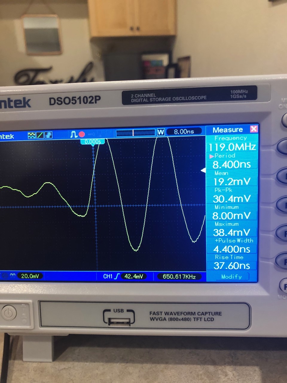

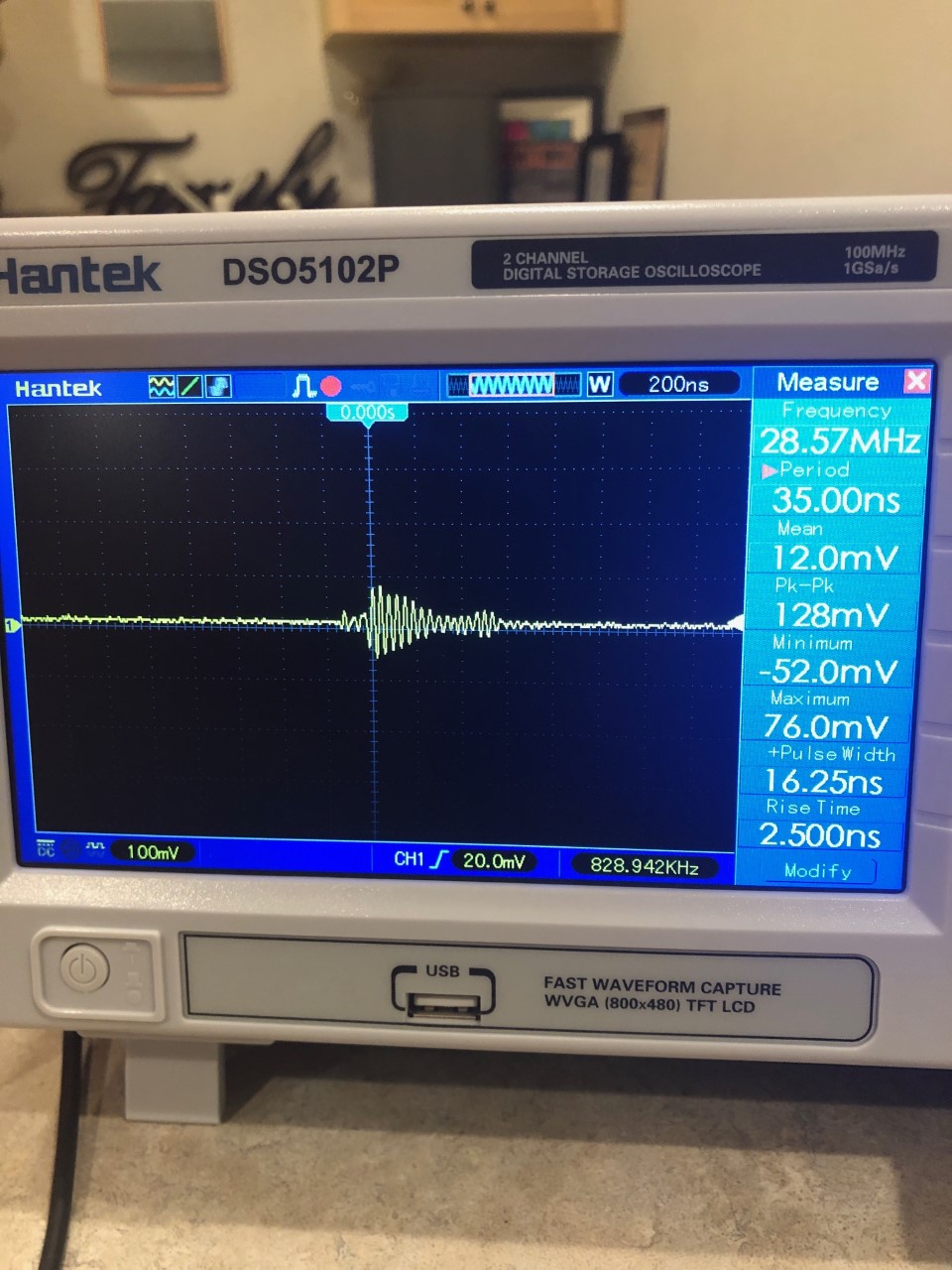

@Mooly - I tried the scope last night and I get some strange readings of 30MHz at 160mV and then touching C3 goes to 33MHz and 305mV. But I don't trust it yet, so I will try a different probe and see if I can get some pictures for you

30Mhz at the amplitudes you are seeing is instability and oscillation. Touching C3 isn't really a valid state as it could well introduce noise and hash but untouched and there should be nothing at all.

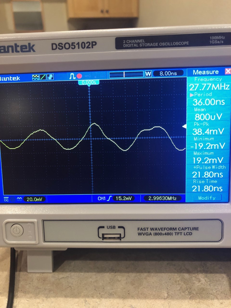

Here are scope pictures (remember I generally reset it to factory, then click on the "auto set" button to get my sine wave). I am very new to using a scope.
All pictures are with the left channel amplifier, input shorted and the output on a 8r dummy load.
#1 - is the scope noise floor, scope is connected but the amp is not powered on
#2 - amp is on, with i/p gnd routed to the GND terminal on the amp board
#3 - amp is on, with i/p gnd routed through a 10r resistor then to the GND terminal on the amp board.

Lets try and get some baselines with these measurements.
1/ Do you get a flat trace with scope probe tip and ground lead shorted together but not connected to anything else? That has to be a yes really 🙂
2/ With the amp OFF and its power supply unplugged from the mains do still get a flat trace if you connect the still shorted probe tip and ground lead to the negative speaker feed. That should be a yes as well.
3/ Now connect the scope to the speaker output as normal i.e ground and the amplifier output. You will have to take the feed from before the relay. Still a flat trace?
4/ Assuming it is you now connect the power supply to the mains but do not turn on the amp. In other words we now add the mains ground wire the the set up but with no power applied to the amp. Still flat?
YES, it is flat and shows 0mV Avg. and 120mV Pk-Pk on scope at 1.0V/div
Yes, it is flat, same as above
Yes, it is flat, avg. still 0mV but Pk-Pk shows 200mV at 1.0V/div
4/ Assuming it is you now connect the power supply to the mains but do not turn on the amp. In other words we now add the mains ground wire the the set up but with no power applied to the amp. Still flat? Yes, it is flat with same 0mV avg. and 200mV Pk-Pk at 1.0V/div.
(the 680k was something Aksa was experimenting with but it wasn't part of the original design).
Lets see where that gets us.
See my responses above in red - but everything you asked is flat on the scope. I am willing to resolder, remove, or change either the 22p C7 or 680k resistor if that might be something else to try.
