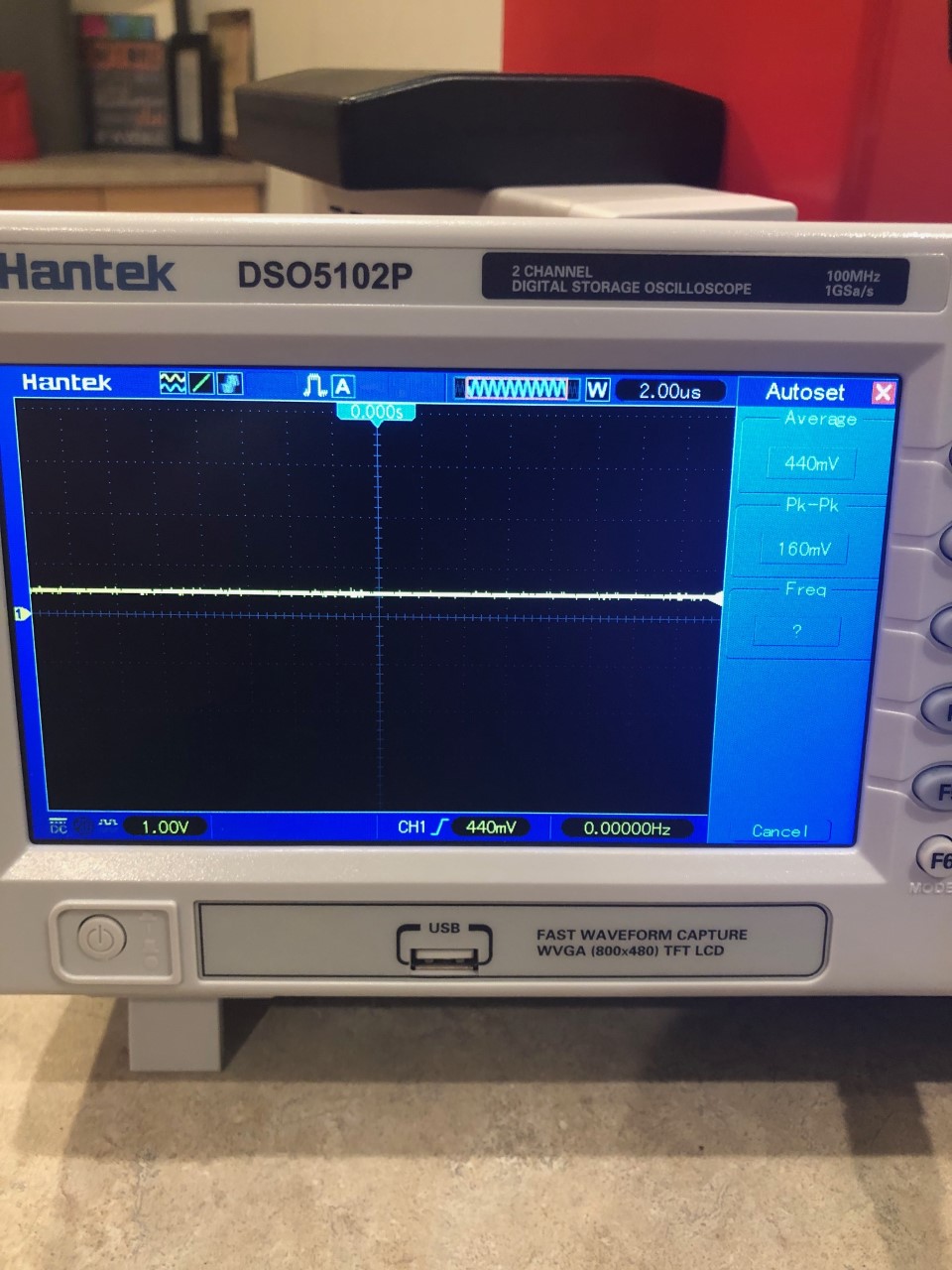

See my responses above in red - but everything you asked is flat on the scope. I am willing to resolder, remove, or change either the 22p C7 or 680k resistor if that might be something else to try.
OK, so a flat trace which is what we want. I don't quite know where the peak to peak readout is coming from... maybe the initial transient as you touch the probe tip.
So what is happening is very strange. I would say now that you apply power. That means having just the supplies and the ground return to the PSU connected together with the speaker. So that is 3 wires for the PSU and then the speaker. Nothing else.

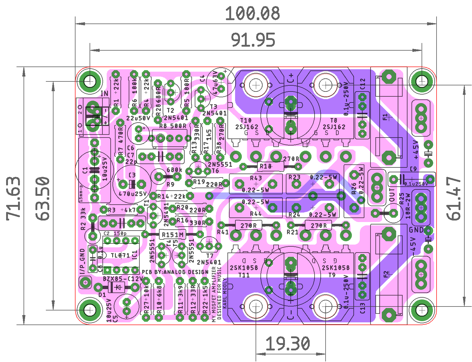

wait a second, which 10 R we are talking about?
I dont have any 10R ground lifter in my PCB.
Only that input side ground and power ground are separated.
Input side ground has a Pin called I/P_GND which should be connected via a wire to the PSU ground on the clean side.
As per APEX (in his DC servo mosfet amplifier thread) , amps with DC servo cant have 10R lifter between input and power ground.
attached is the PCB that you have in your build?

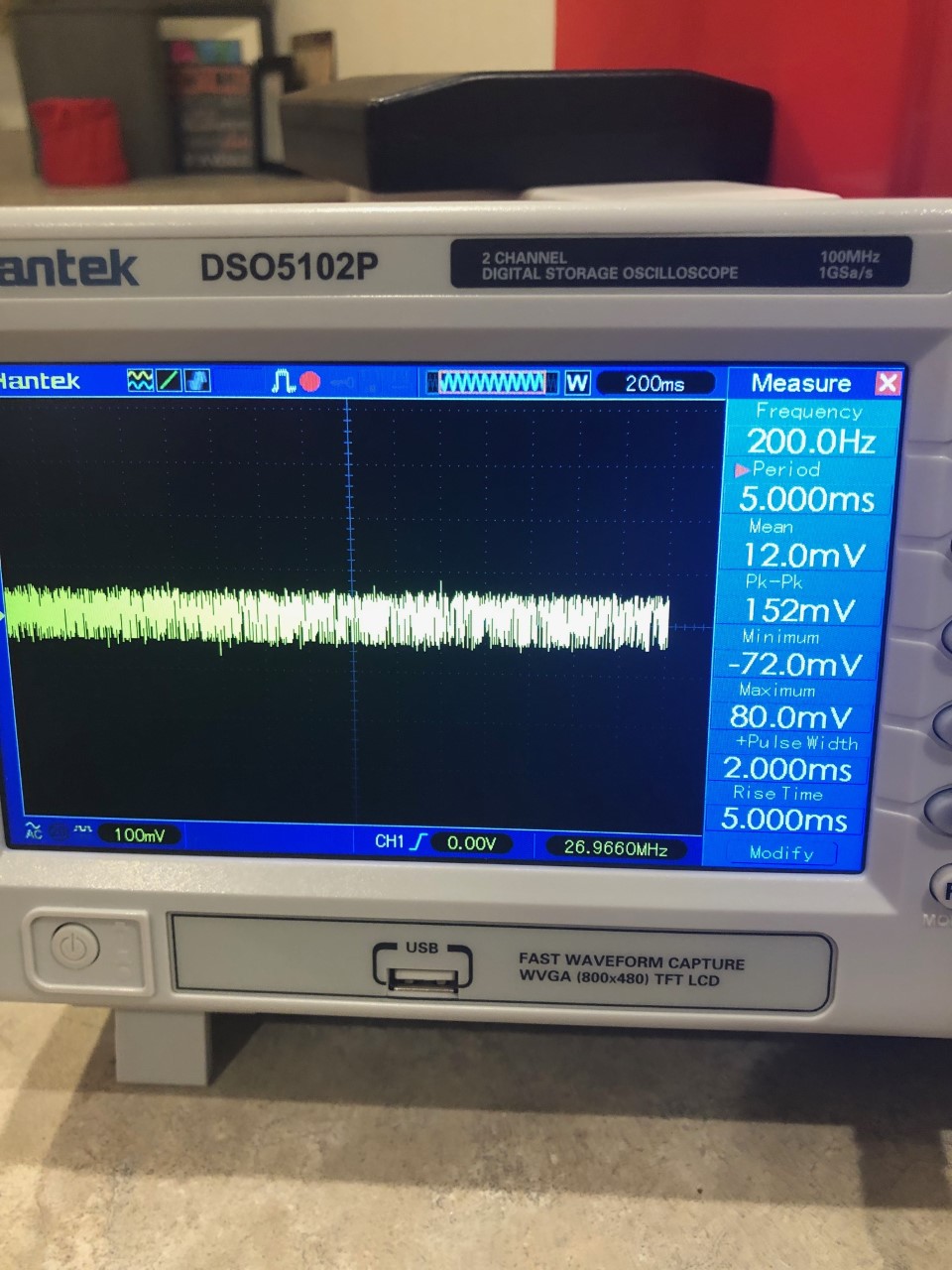

Keep in mind, not 100% sure I'm scoping it correctly. Here is the scope on the 33k resistor, junction of pin 6 of the TL071.
#1 - scope picture
#2 - zoomed in scope

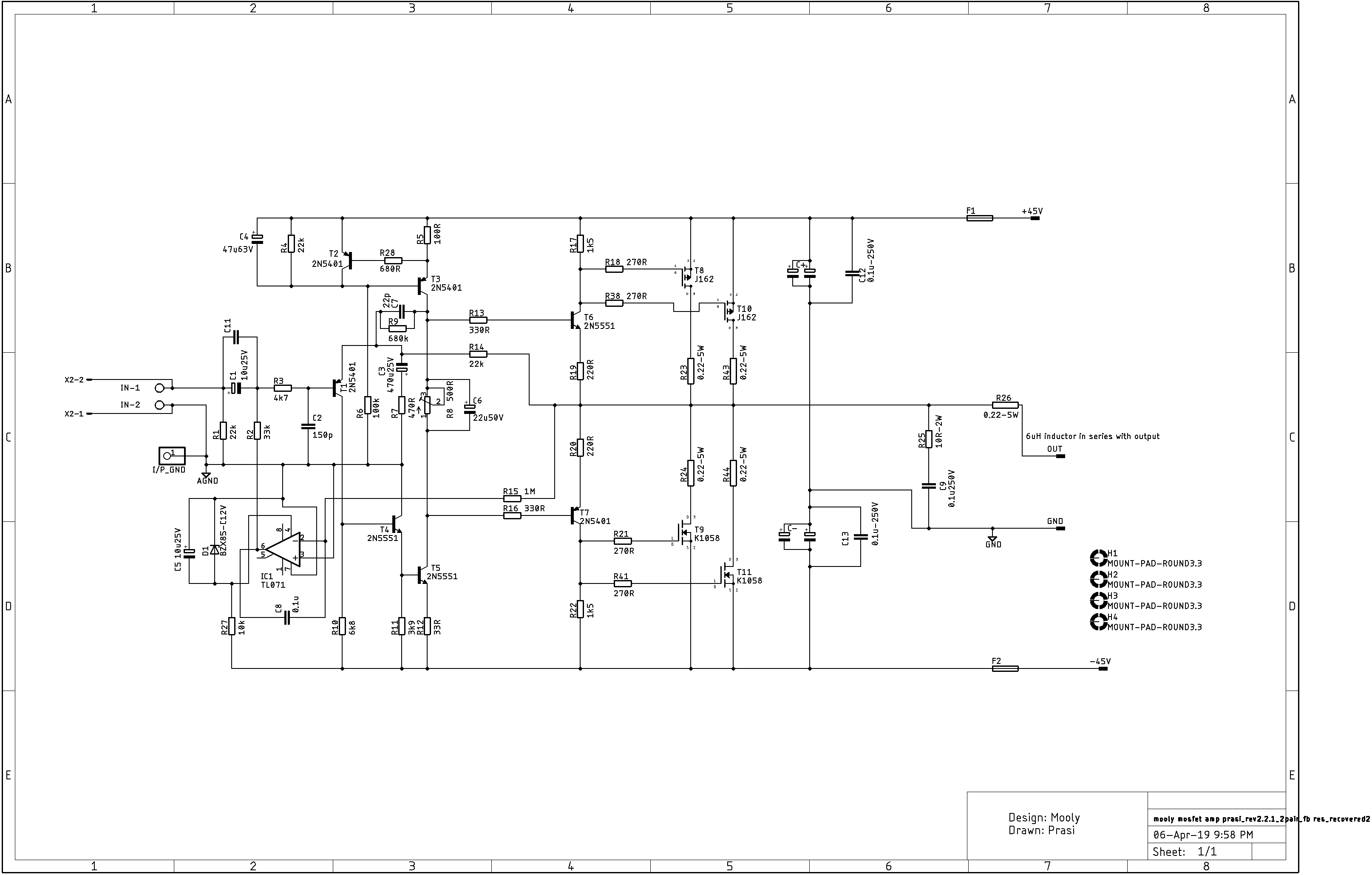

Now move from pin 6 to pin 7. Pin 7 should show absolutely no signal of any kind because it is a clean ground. Same for pin 3.
Given that the DC voltages are correct around the opamp suggests it is fine. Fakes or using something other than a TL071 were the big issues but that doesn't seem the case here.
The 0.1uF cap and the 1Meg resistor together with the opamp form an integrator and that means no signal of any kind should be visible on the opamp output. Are those two parts the correct values?
If you interpret this waveform using old fashioned methods (forget the scopes readouts) what do you make the peak to peak voltage to be? Work it out usng the volts/div setting accounting for a divider probe if used.

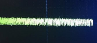

#1 - scope picture
It would be worth repeating that measurement in exactly the same way and recreate what you see in the scope shoot.
