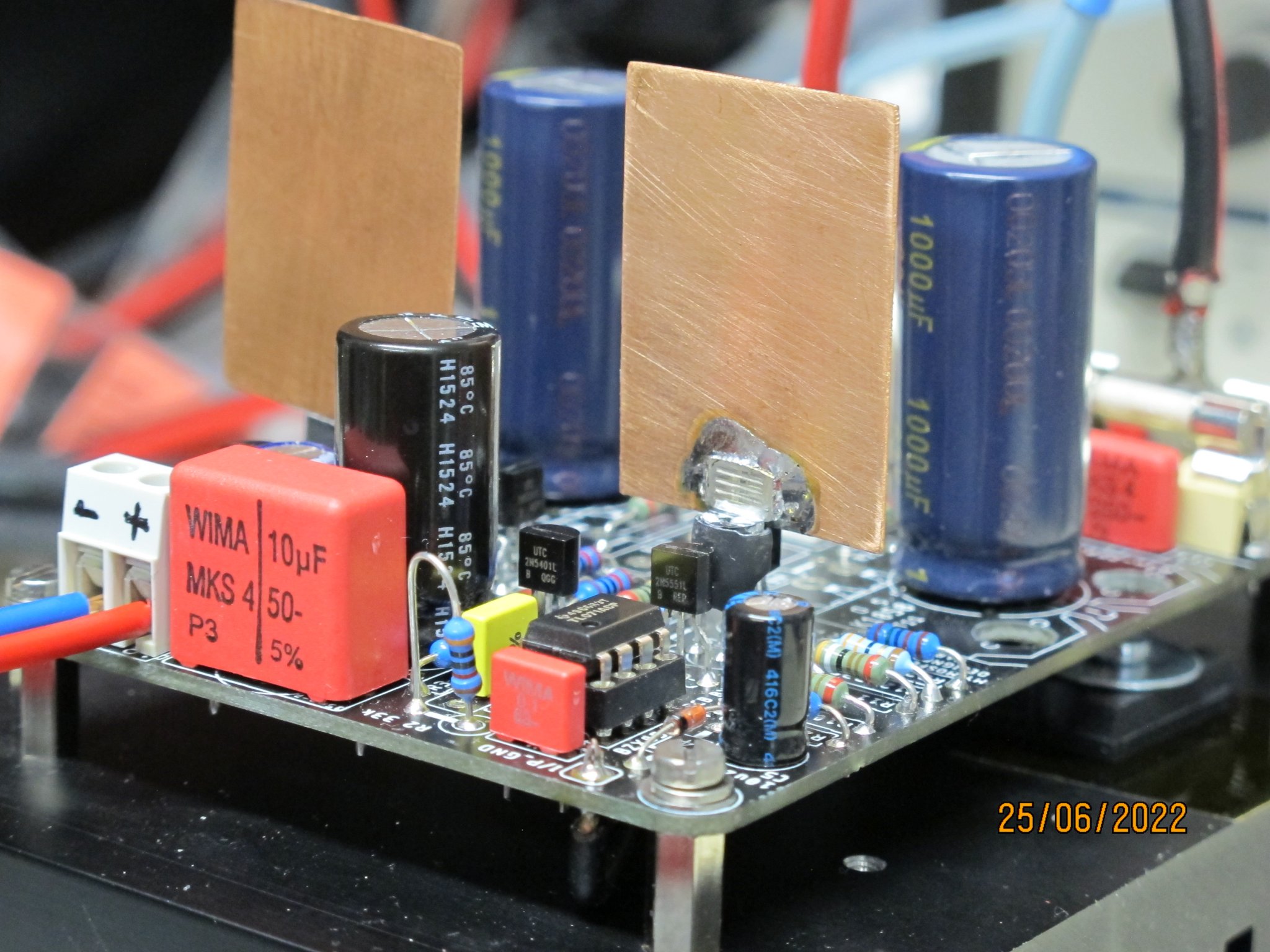

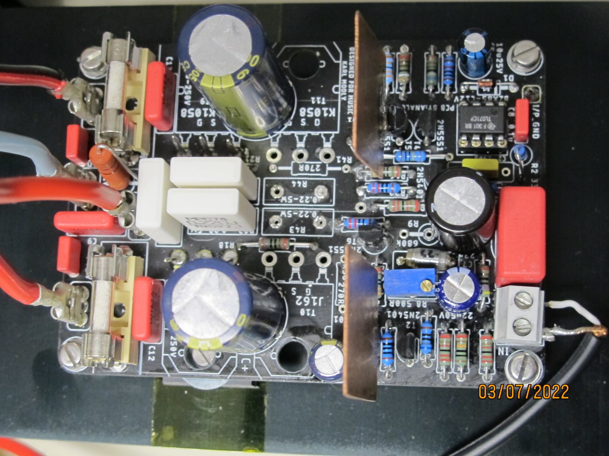

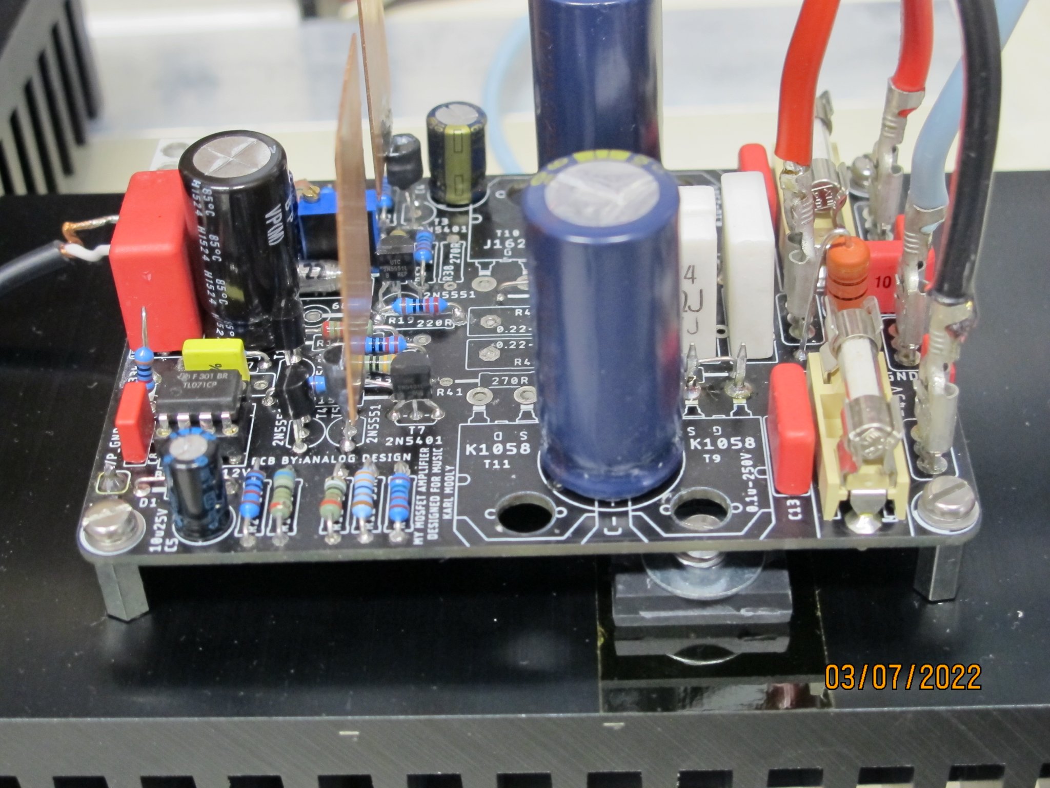

I did put a 22pF tubular polystyrene, 160Vv for C7. The C8 is a Wima 0.1uF 63V, as can be seen on the jpg. There is nothing strange here. All what I did is to follow any information I did find from Mooly. I have measured every component choosing the same values for each component in each channel. So I did get the same performing channels. That's OK. You can see the black wire under the PCB connected from the I/P connected to the GND from the power supply on the PCB. It is a 1.5mm² wire, and I did check that it was not badly connected as the PCB is not very distant from the heatsink.
I did also perform all good solders : at first I did scratch every wire of each component with a cutter in order to get good electrical contact from the wire with the solder.
I did measure some transistors, well all except the Mosfet. I did put the highest valued hFE on my circuit evaluating the HFe and the Vbe (I found the best at around 200 hFE at 10mA and at 5mA at this 5mA it is on a DCA75). I did check and checked again in order to be sure of what I did get. There is a procedure in order to compare the same transistors at the same temperature at the same day. The DCA is fast, my procedure a not so fast. DON'T TOUCH the transistors with your warm fingers ! Put the transistors you will measure on a big piece of aluminium and above it another piece of aluminium in order to get the mostly same temperature for all of them. Measure the faster you can, write the value
you find, let them cool some hours, then redo the measurements on those who look the same values ... It is a painful procedure, as I am knowing there is not any faster procedure for the diy job.

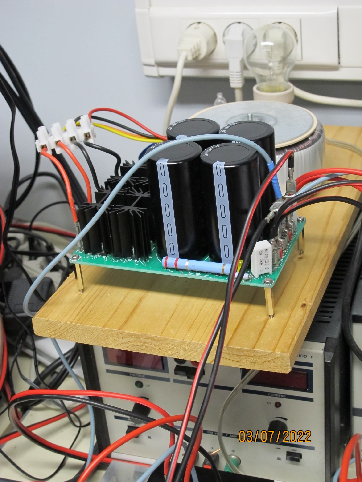

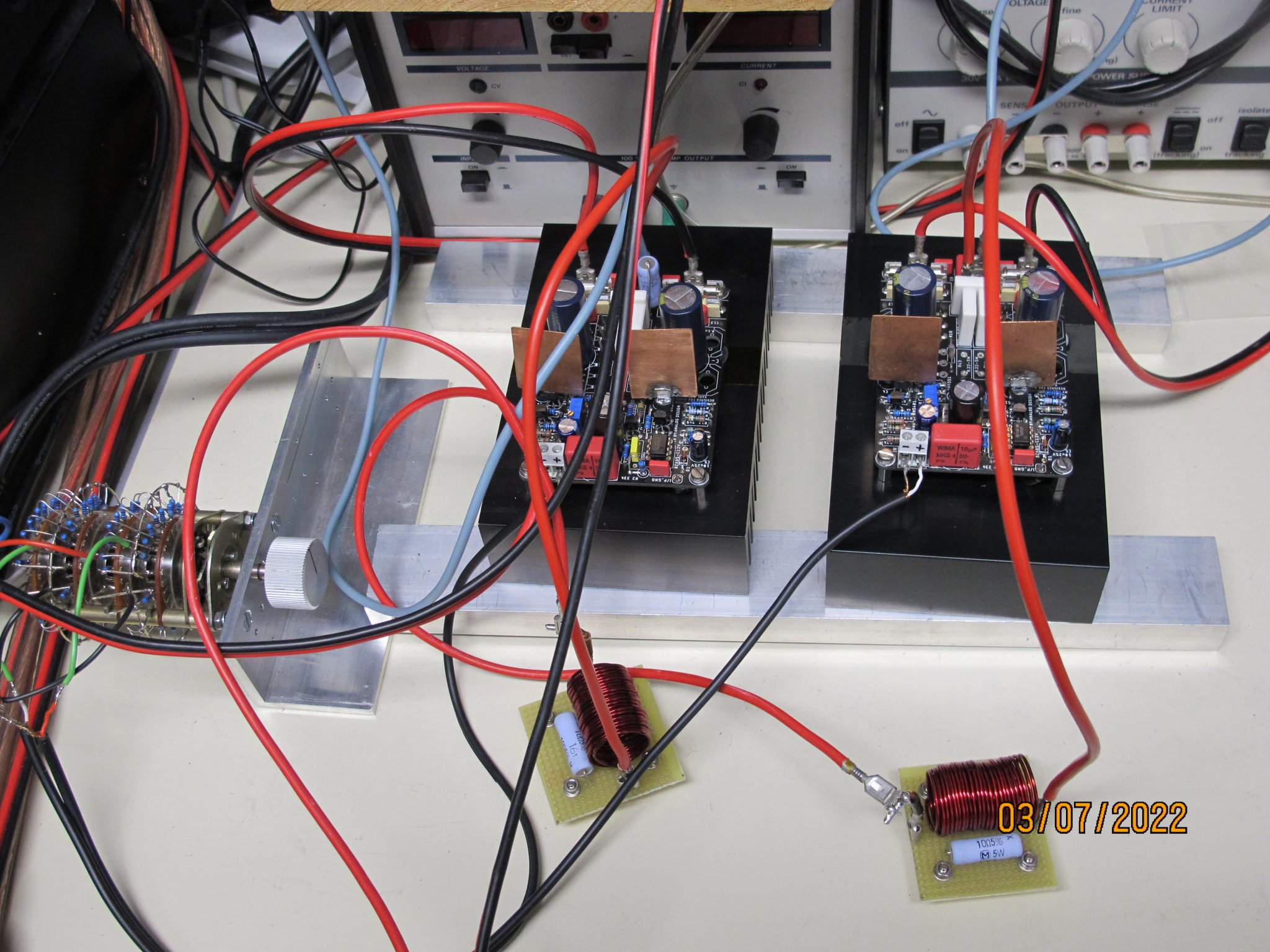

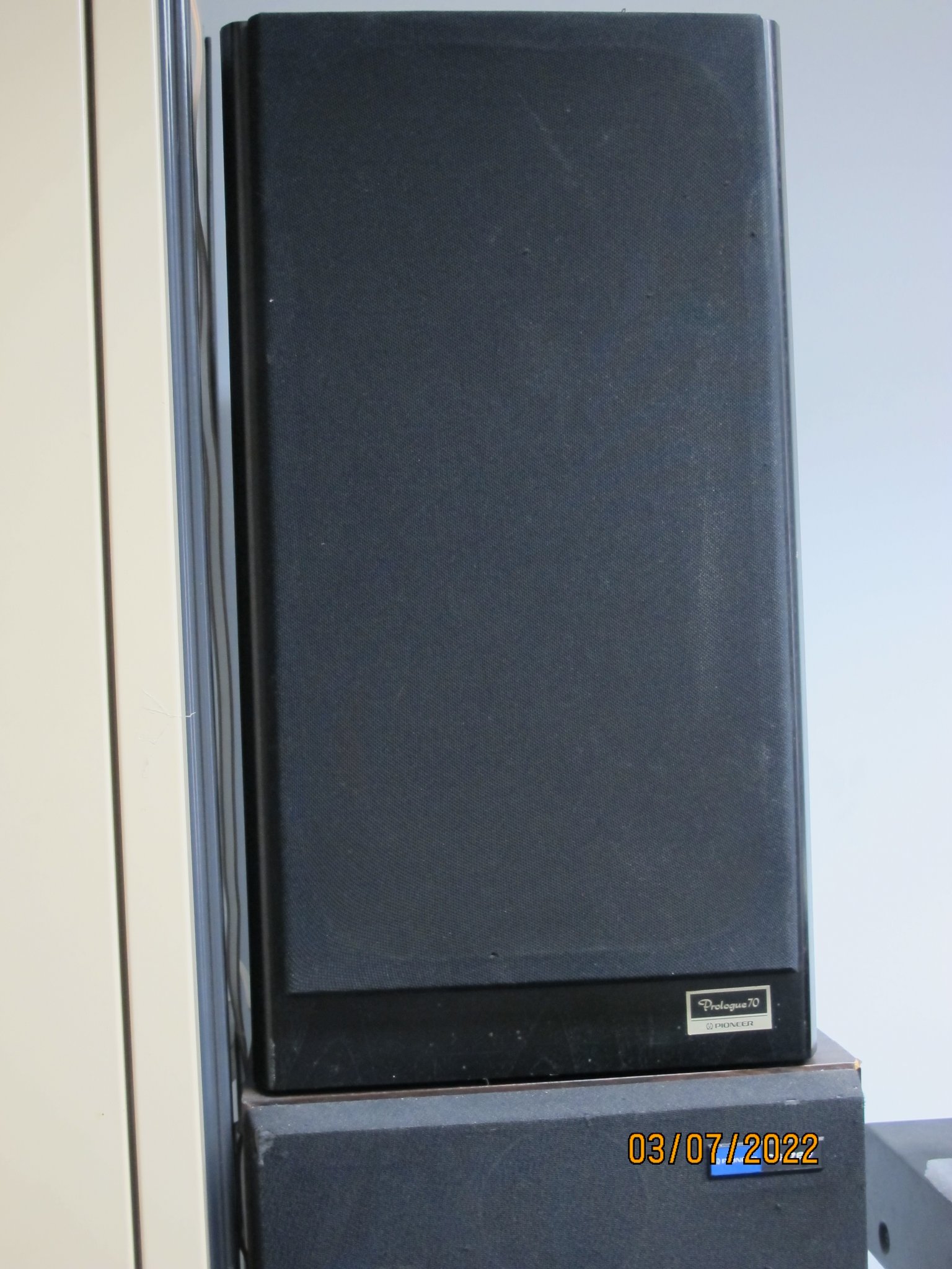

In the attached you find what you did ask to see from me and I did put a bit more.
Please, understand that I did my best to respect what did write to us Mr Mooly. The input capacitor is a 150pF polycarbonate I had around. Both the 1000uF placed at the output on the PCB are there because I had that home, and there is no other reason for this. All my components are genuine ones, the 2N5551 and the 2N5401 come from Profusion PLC as it is for the Mosfet ECW20N20and the ECW20P20. Bought long before the Brexit ...
Thanks for the detailed pictures - I have a current project I'm finishing, but looking forward to getting mine singing as good as yours. Let's hope they only need a little fine-tuning.
Nice pictures and very detailed presentation!
You have done a very good job my friend.
