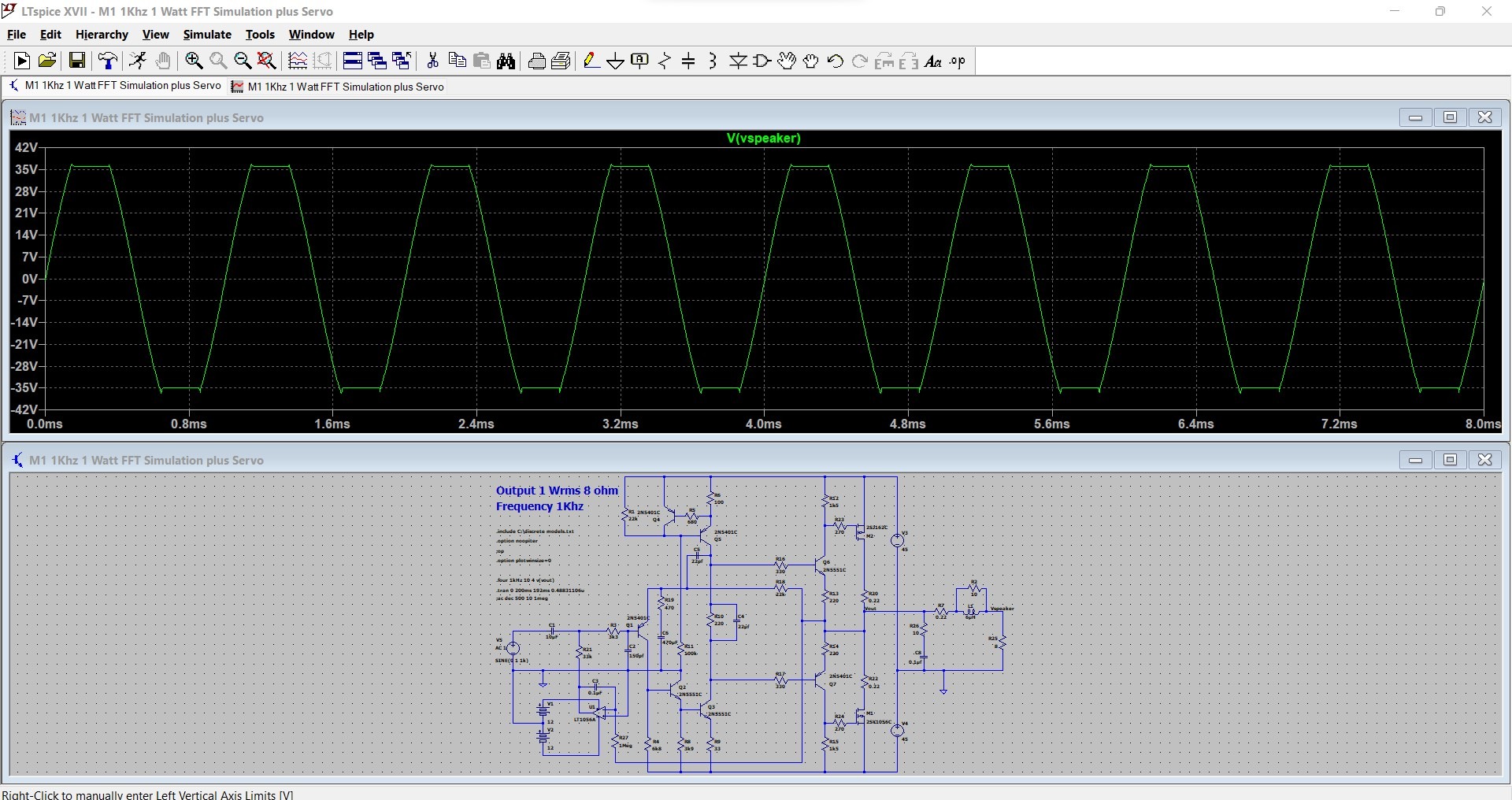

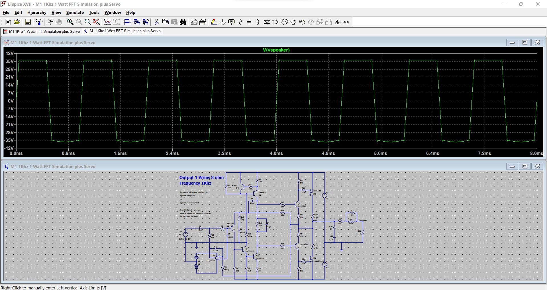

Fwiw simulation of the amp shows clipping to be well behaved.
Approx 0.8 volts peak is needed to reach clipping. This shows 1 volt peak applied and then 4 volts peak applied.

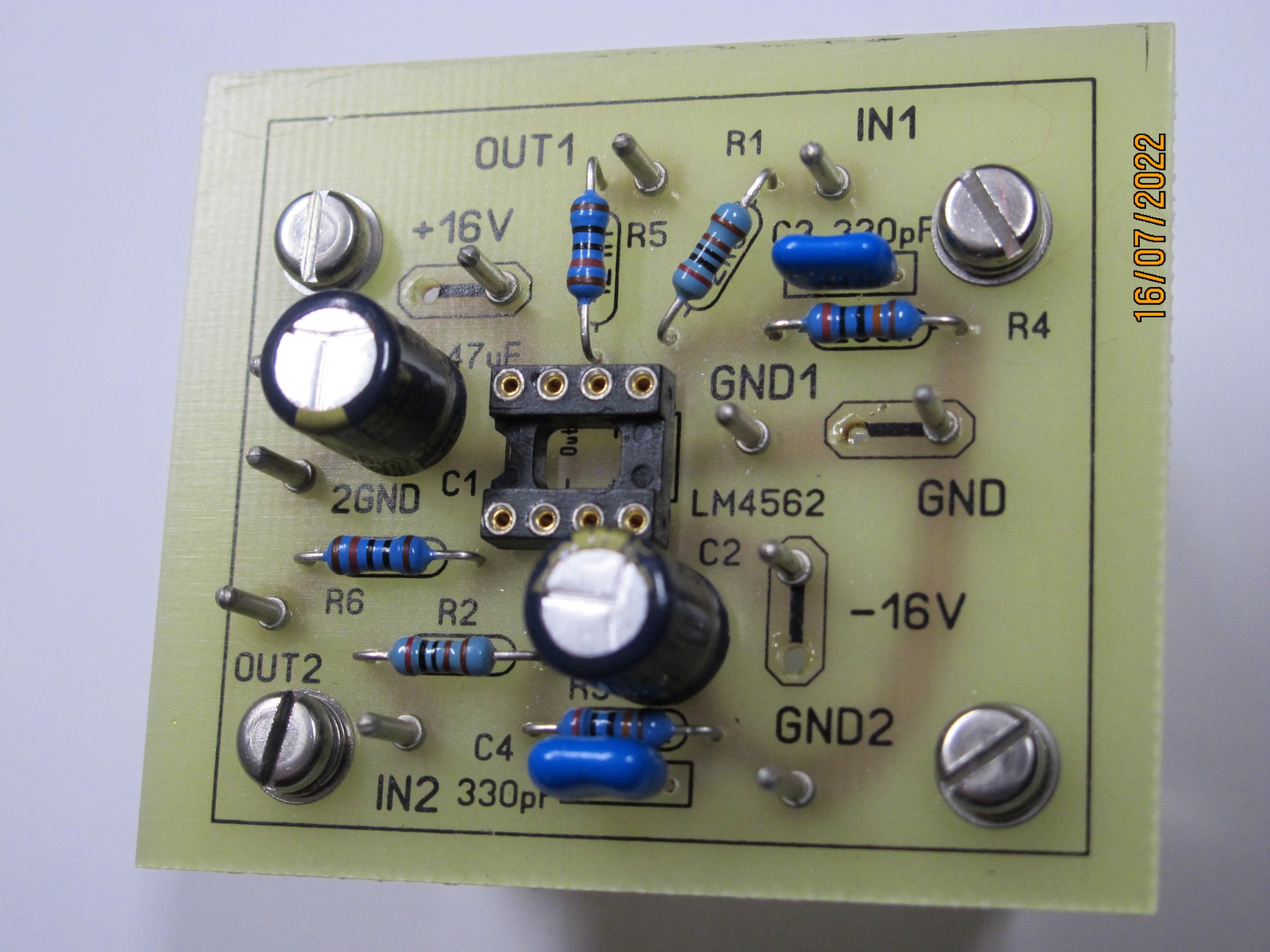

I have a very good day with your nice power amp. I made the buffer with a filter RC (2kOhm, 330pF) this limiting the input frequencies at around 240kHz.
To verify that all was OK, after having checked that the output of the buffer did what it should do with the frequency generator, and being a bit afraid to use the LM3562 (I bought a few of them at Mouser, they are expensive as you already know), I did put an TL072 instead for the first try.
The result was so bad that I thought I had killed the sound of your amplifier. I did put a CD of Decca, it is Sinfonietta from Leos Janacek. I do like this music a lot, and I know it very good.
Then I have decided to put the LM3562. What a huge difference ! The power amp was singing again as it did before with Sinfonietta from Janacek when no buffer was connected.
After that, for pleasure, I did put the violin concerto of Mendelssohn played by Maxim Vengerov, a Teldec CD. Wonderful, really wonderful ! Then for being very happy for the rest of the day I did put His Majesty's Harper (Andrew Lawrence-King) a CD of DHM (Deutsche Harmonia Mundi), He is playing right now music from Dowland, William Byrd and others. A Master ! Fantastic !
Now I have no pleasure to report that the TL072 sound bad as a buffer with your amp, but this is the truth. I don't understand why it is so. The TL072 is a good op amp.
Well I will again write to you 'Thank You Mooly' for this so good sounding power amplifier.

Well that's good Strange about the TL072 because I rate those very highly. No quick answer to that one. Any possibility of them being fakes? The TLO72 can also oscillate in some circumstances, particularly if capacitively load (so high cable capacitance) and that needs a low value series resistor from the output pin to fix that. Odd.I have a very good day with your nice power amp.
Pleased you are enjoying the amp though.
Hi Mooly
I rate very high the TL072 too. I have forgotten when I did buy these TL072 I have home, but it is a big lot of years. This TL072 was made by SGS Thomson. I have the Texas Instrument TL072 also, but I see no interest in trying one as I have now no problem. There is a 120 Ohm resistor in series at each output ...
Thr LM4562 did the job, so no problem even if I don't understand why a TL072 sounded so bad in the high frequencies.

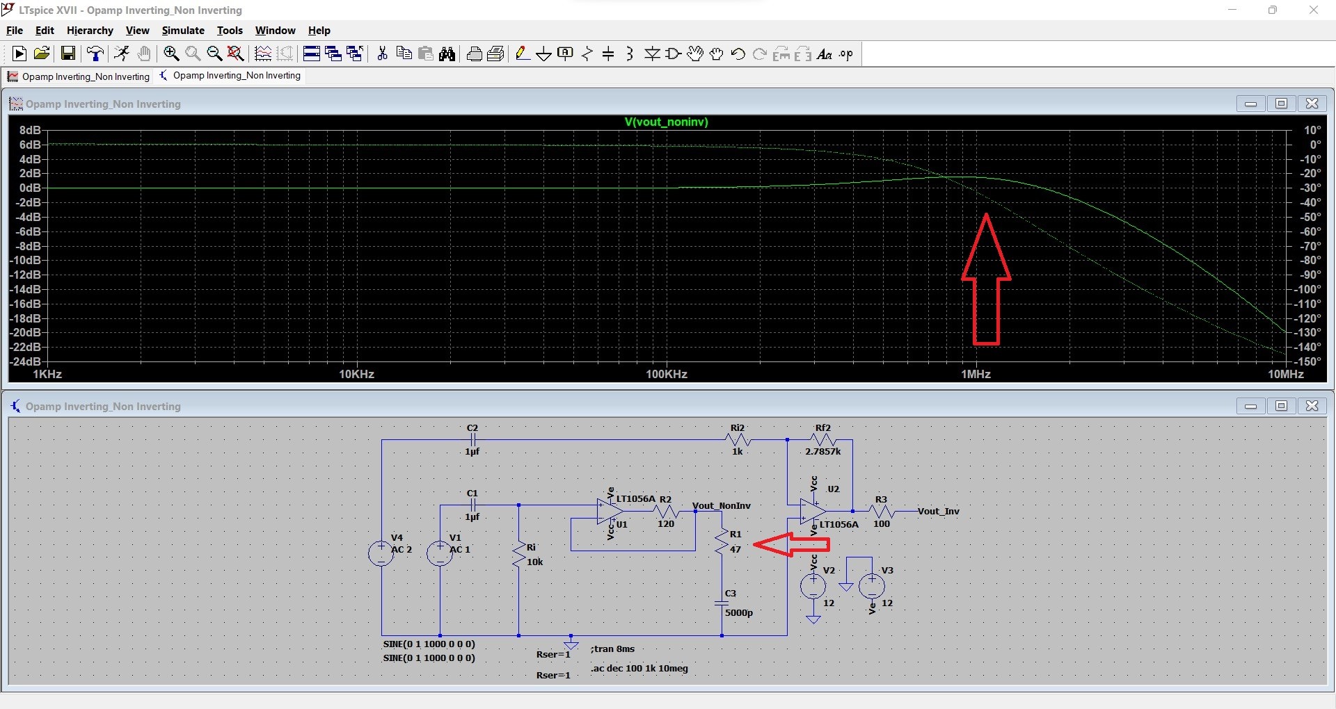

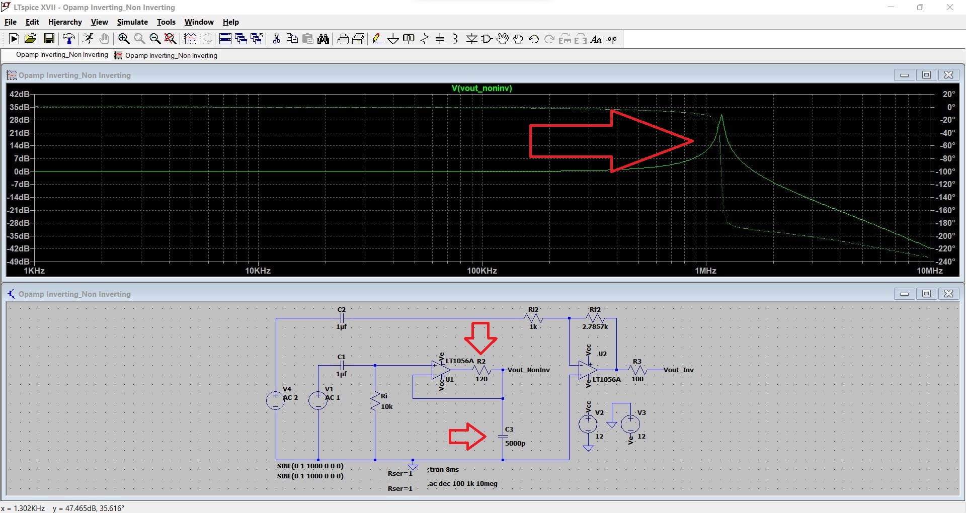

Yes indeed The 120 ohm is internal to the chip and is really the open loop output resistance of the opamp.There is a 120 Ohm resistor in series at each output ...
When we wrap feedback around the chip we automatically include that resistor in the loop and the output impedance at the chip output pin effectively becomes only a fraction of an ohm. If that wasn't the case we would see the output level drop as we load the chip but it doesn't, it holds up because the effective output impedance is so low because of where we take the feedback from. The signal level at the other end of the 120 ohm (that we can not get at) will increase as the chip is loaded.
That resistance and the effect of load capacitance can cause instability if it alters the phase margin enough although I've never actually experienced it myself with the TL0 series.
Here is an opamp buffer with 120 ohms added and then capacitively loaded. It doesn't look good. Just look at the left hand opamp... it was a circuit from something else.
Now we add just 47 ohms series resistance but crucially that 47 ohm is now 'outside' the feedback loop, however the 47 ohm and the load capacitance together do in fact modify the feedback network and now adds a 'zero' into the feedback transfer. Now the response is much tamer and stability greatly improved.
Hi Mpply
Thank you for your answer. I have on my bench very short wires connecting the buffer to the power amp input, a few cms, so 5nF eems much.
What I wrote is that I did add a physical external 120 Ohm resistor in series to the output chip. This resistor is not connected into the loop of the follower, it is outside the feedback loop. I have of course a small gain loss, I have choosen it to be around 1%. Sorry that my English is a bit weak.

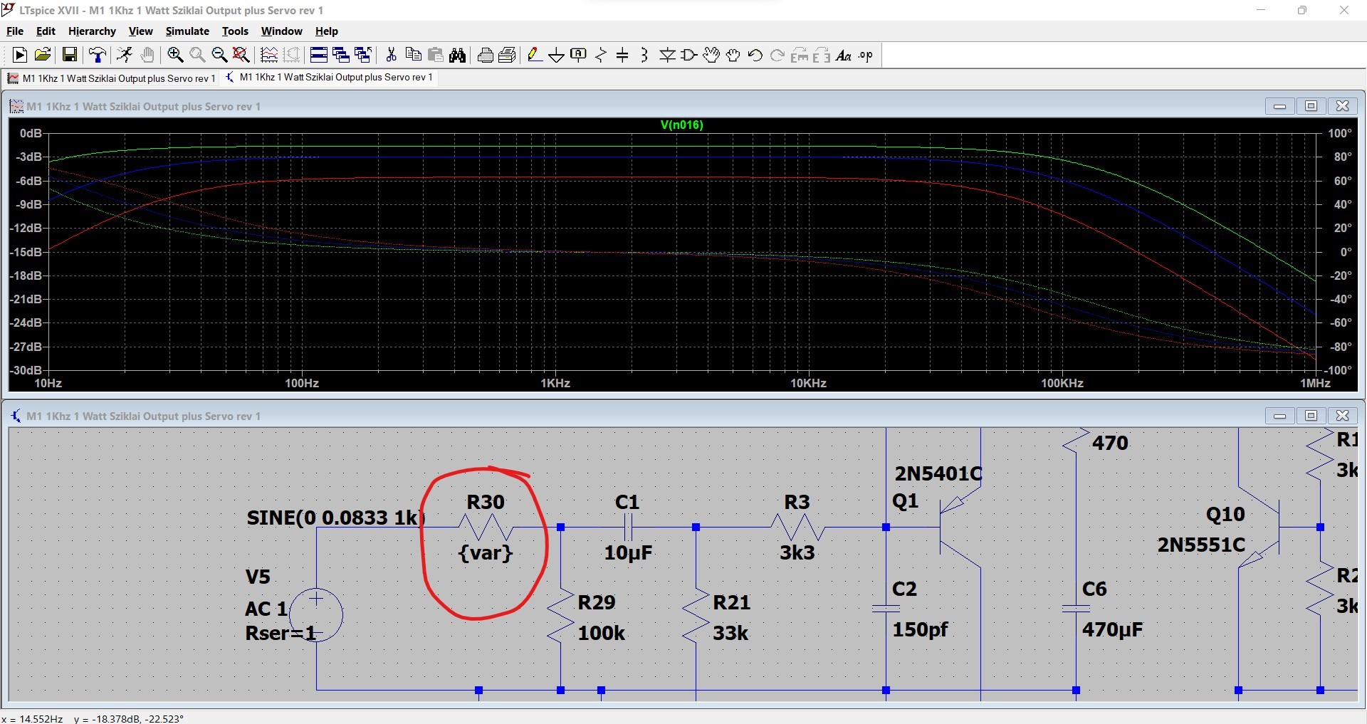

It is worth mentioning that the input impedance is determined mainly by the 33k and that is quite low in the scheme of things. If you are feeding the amp directly from a pot wiper (volume control) then you also have the effect of the 150pF cap forming a low pass filter. If the pot is high in value such as 47k or 100k then that will begin to cause some HF roll off.
I used a 10k motorised ALPS pot in mine with a very low gain 'preamp'. The main reason for me using a 'preamp' was to configure the input switching around an inverting opamp stage. This also gave the opportunity to easily set individual gains for each input so that they all sources sound at the same level subjectively.
I found the power amp was totally stable even without the 150pF cap and so at you own risk you can experiment here if required.
The image shows the response of the input filter (the 150pF) when fed from a source of 5k, 10k and then 22k impedance. As the source impedance increase the HF roll off occurs earlier. So if you are feeding the amp from say a 47k pot then you will start to get some HF rolloff.
A good question actually because the gain of the power amp is higher then most at around 34db. For most modern signal sources you shouldn't need any extra gain.Why you need a buffer?

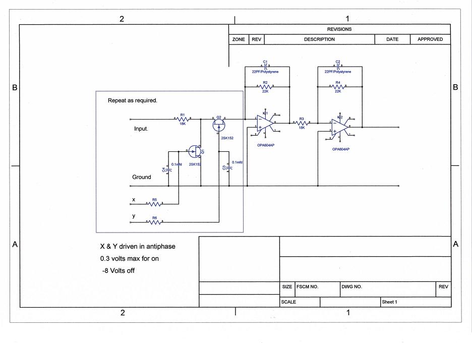

Another idea for a buffer is to use a simple discrete transistor one. It doesn't always have to be an opamp.

This is what I used. R1 selected to suit the input in question such that all input sources subjectively have the same level. The section with R1 is repeated to cover as many inputs as needed.
