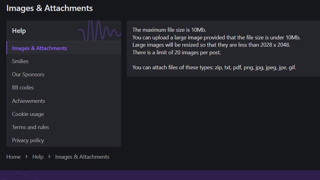

Hi MoolyThat's strangeIf you go to the bottom of the page and click on 'Terms and rules' there is a button for attachments. Zip is in there.
Well I am really pleased and happy you are enjoying it![]()
I have not had problems with the dimensions of the files to be attached : diyaudio does not accept the files done as BMP and DOCX, but they accept the DOC files ... So I had to convert them in files diyaudio accept. I did not look at all to what is written in terms and rules, there is to much to read here and there. Thank you for your help.

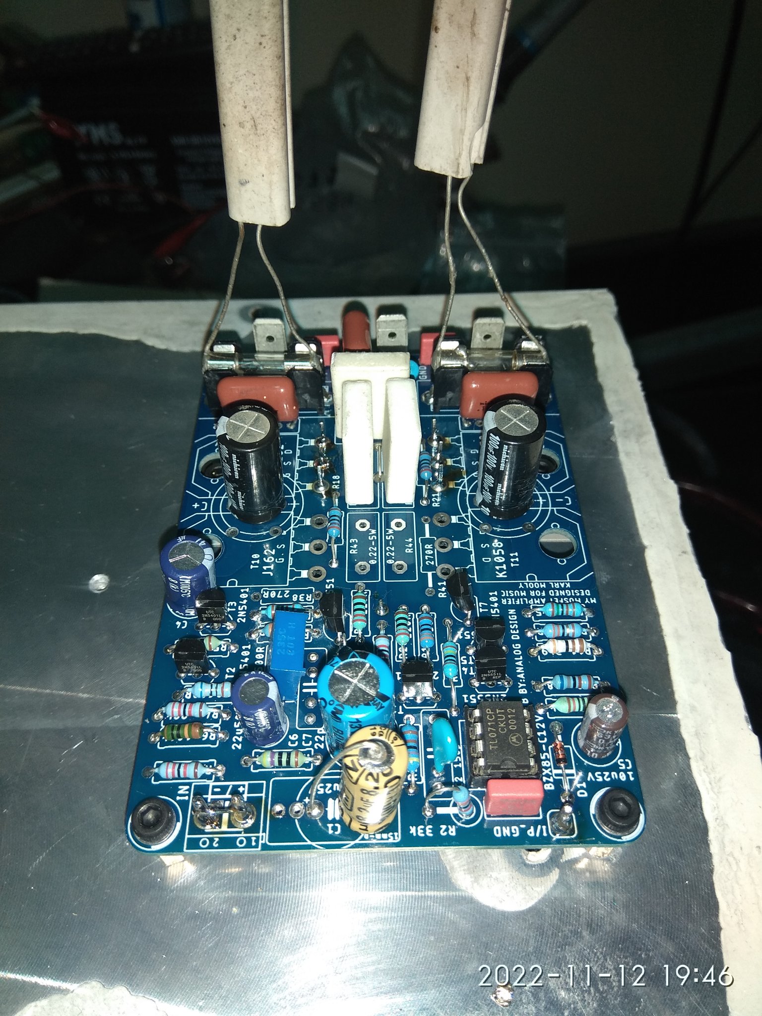

Looking good @thimios --- question, what size caps are those by the +/- and GND connectors? I didn't see those in my BOM and so I didn't populate. See pic, with the caps circled. ThanksA Swiss cheese heatsink🧀
Ignore those,100nf but not necessary.Looking good @thimios --- question, what size caps are those by the +/- and GND connectors? I didn't see those in my BOM and so I didn't populate. See pic, with the caps circled. Thanks

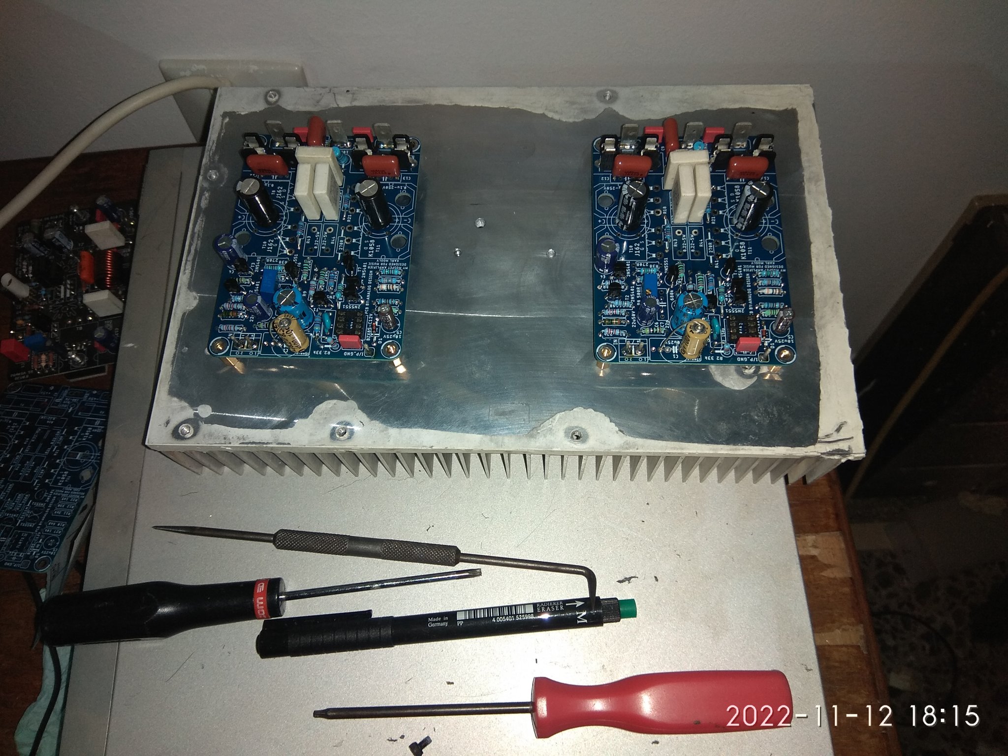

Ready for fire!
Without smoke..I hope.
Always use a bulb tester. It just saves any grief if anything should be amiss.
Let me know how it goes, have never figured out why I am getting oscillations on one of my boards and still looking for a faulty part every time I see someone else's build that works flawlessly. Good Luck and No Smoke!
Difficult to diagnose at a distance although some weird interaction caused by the wiring layout might be possible. The amp itself has always proved very stable indeed.
Yes,I will use the bulb tester plus two 18ohm 10w resistors instead of fuses.Always use a bulb tester. It just saves any grief if anything should be amiss.

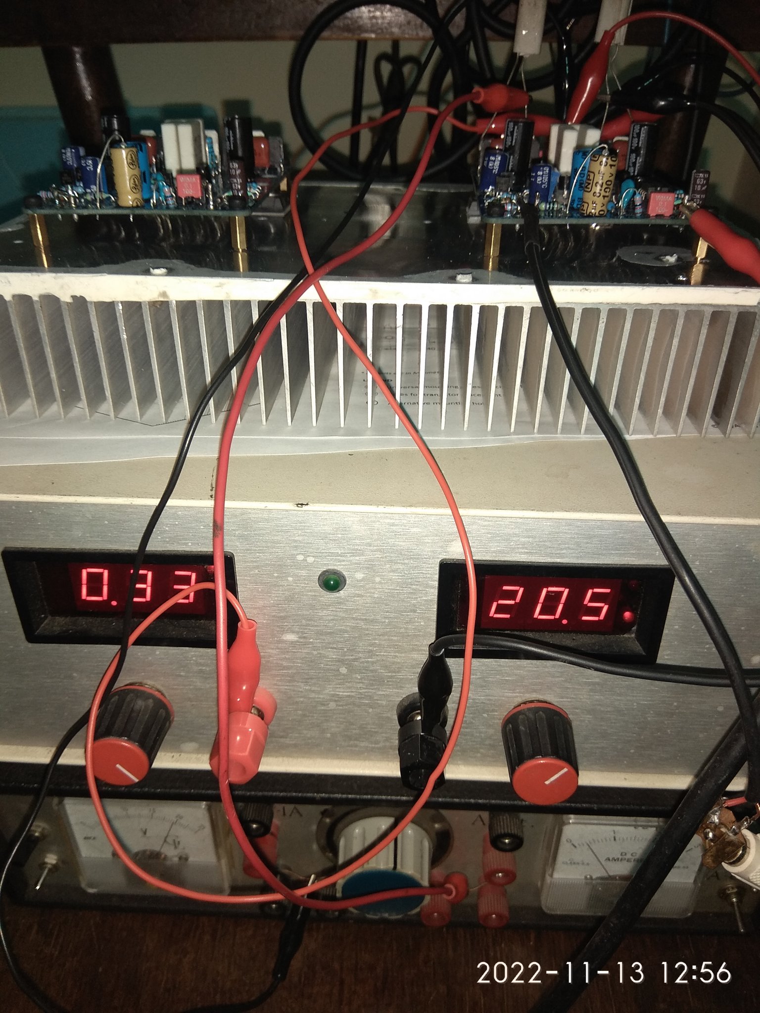

My first attempt... successful!
For this first test I use two bench power supply.
One for positive,one for negative rail.
No smoke no smell.
Next step +/- 35v and finally+/-45v.
I hope again no smoke.
