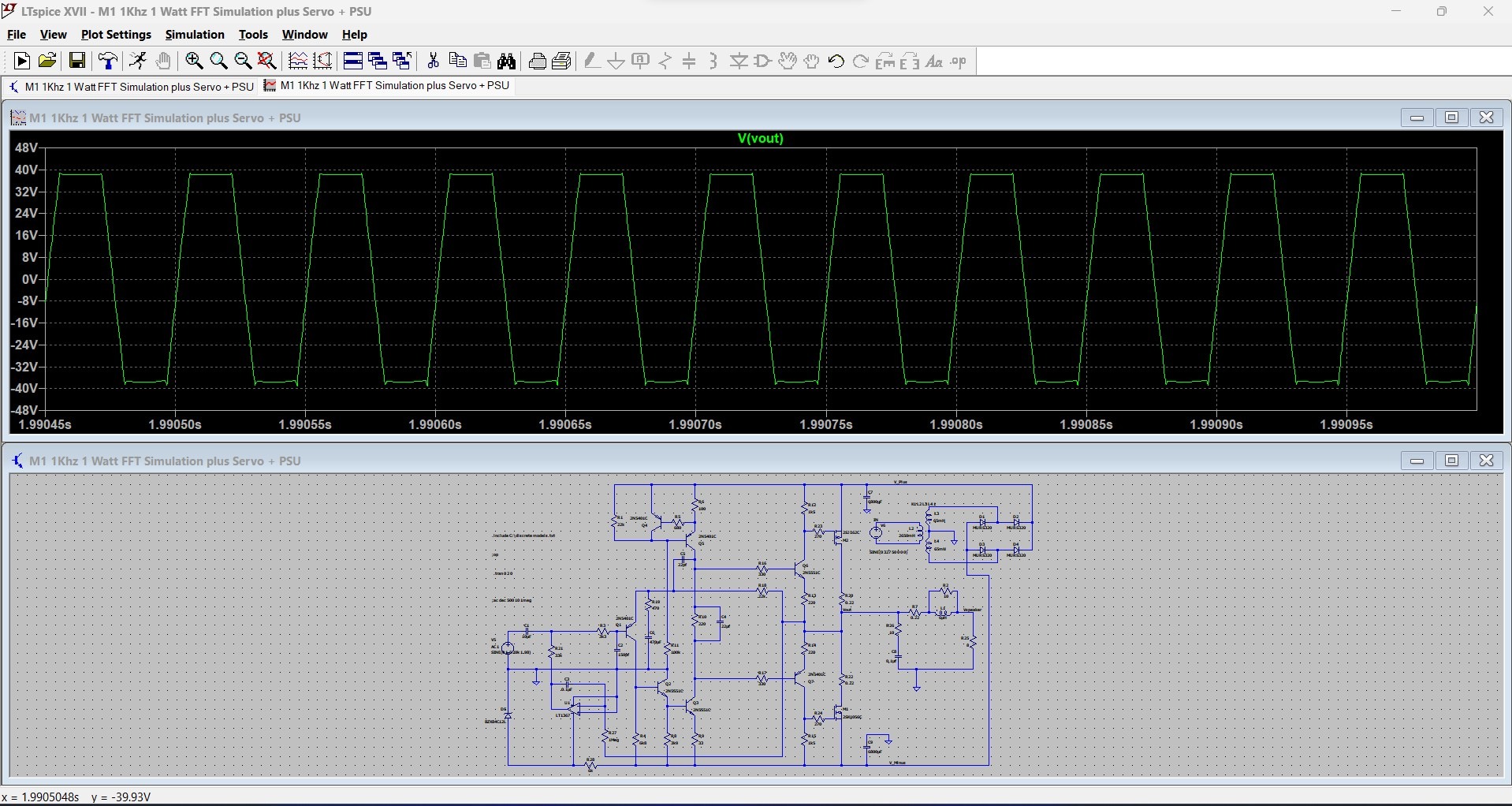

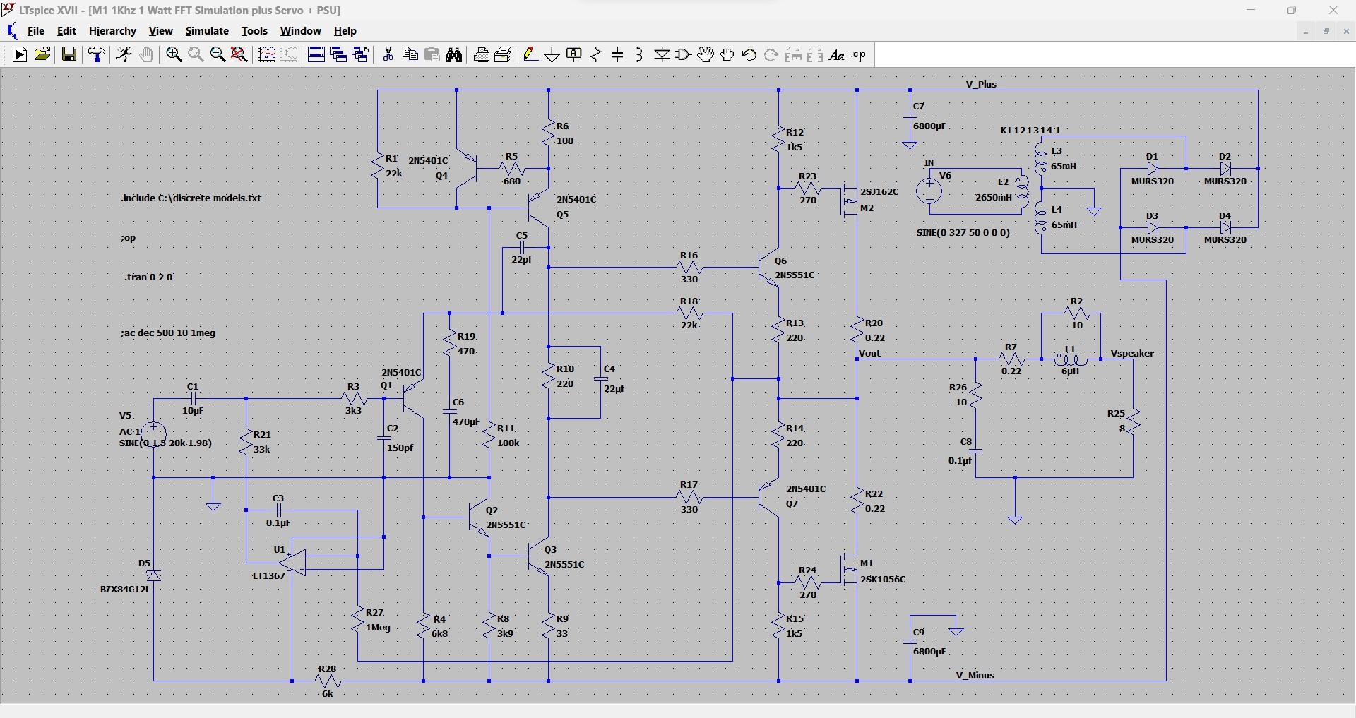

These solutions work by shorting R10 to the negative supply rail which reduces the Vbe of Q4 under extreme operating conditions.Hellow thimios.
VAS is a 6mA CC on the positive side, but the negative side is a Darlington transistor that is actively on.
In this case, saturation causes excess charge to build up in the OPS.
This can also be seen from the fact that the recovery time from saturation on the negative side is much slower than that on the positive side.
When the OPS is strongly saturated in this way, oscillations can be induced, such as by the drop in ft, when returning to the active state.
It is recommended to limit excessive driving during saturation on the negative side.
I propose three types of proposals.
from left
Adding a Baker clamp diode. A small signal Di with a withstand voltage of 100V or more is required.
There is a penalty of increased distortion due to the voltage dependence of the interelectrode capacitance of Di.
Adding three series small-signal diodes to limit the voltage on R10
Adding a small-signal transistor to limit the current in Q5
All of them are just a few extra parts, so you should be able to try them out easily.

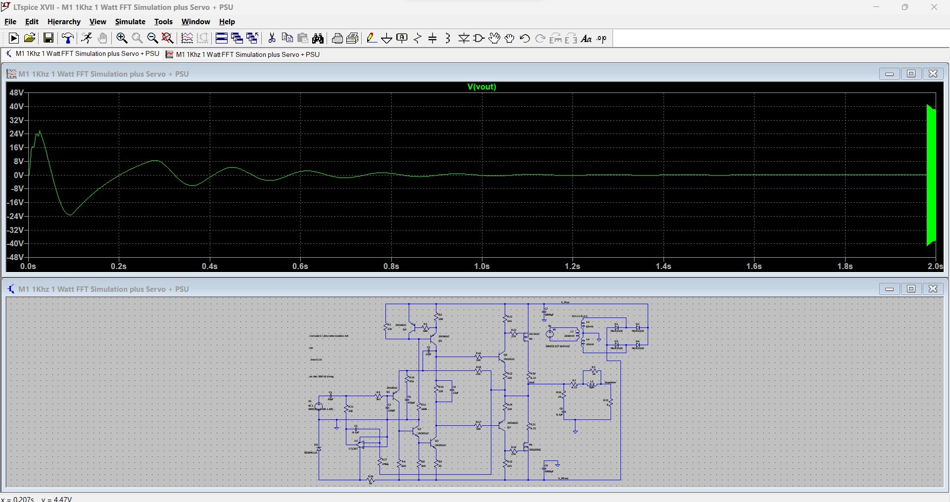

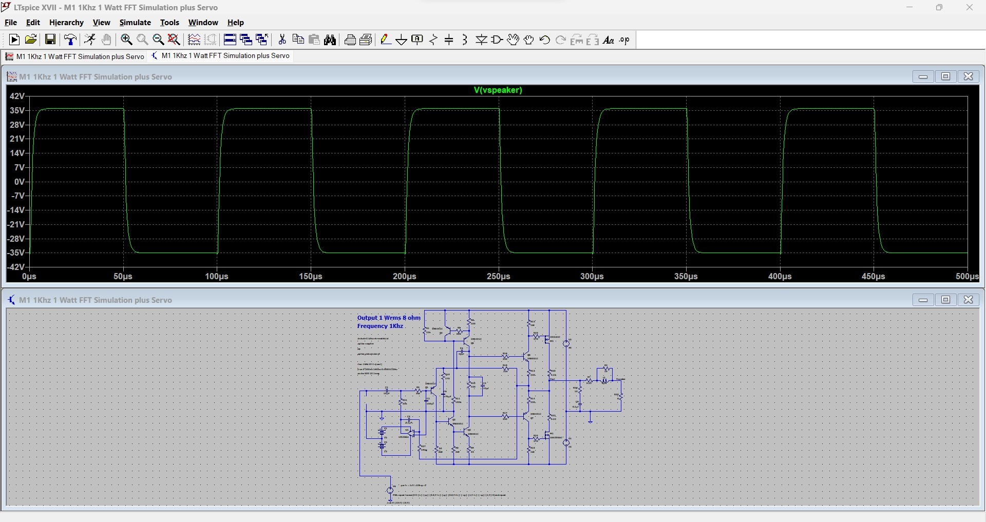

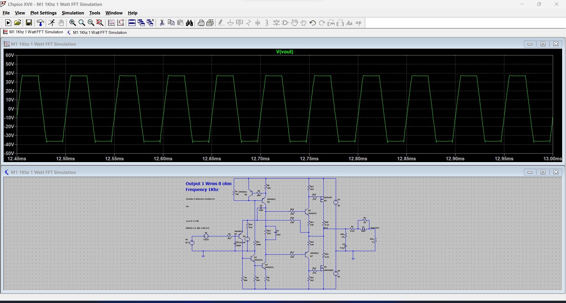

Just for interest... this is with a servo and transformer power supply. You can see the start-up behaviour and why I always mention that the speaker delay is such an important part of the amp.
It's a tough one to simulate with a power supply and a servo. The 20kHz output comes in at the end of the trace. It would take all day if it was applied at the start.
And the 20k output when massively overdriven. The 8 ohm load makes no difference apart from limiting maximum Vout.
And with no servo and fixed rails.

I have looked at this latest update and drawn up a SPICE file for square wave signal testing at 10kHz. From what I can see there should be no issues with this circuit even with a 2uF test capacitor in parallel with 8R. There could be a faulty component, something in the layout or the assembly process or the 'scope test set up. I missed a trick with the constant current set up around Q3 sorry, mea culpa, and the fact that Q7 and Q6 have some voltage gain.
Thanks @mjono. What I see in your simulation looks just like the real version to me.
Which reminded me that someone in the LT thread... and apologies to whoever it was as I can't remember the name... posted a brilliant squarewave generator that starts at zero volts. I saved the file at the time. Open both together and you can copy the generator to your file.
This is with the servo.
If anyone is interested then they can change the value of TR in the model for 2N5551C to 1US.

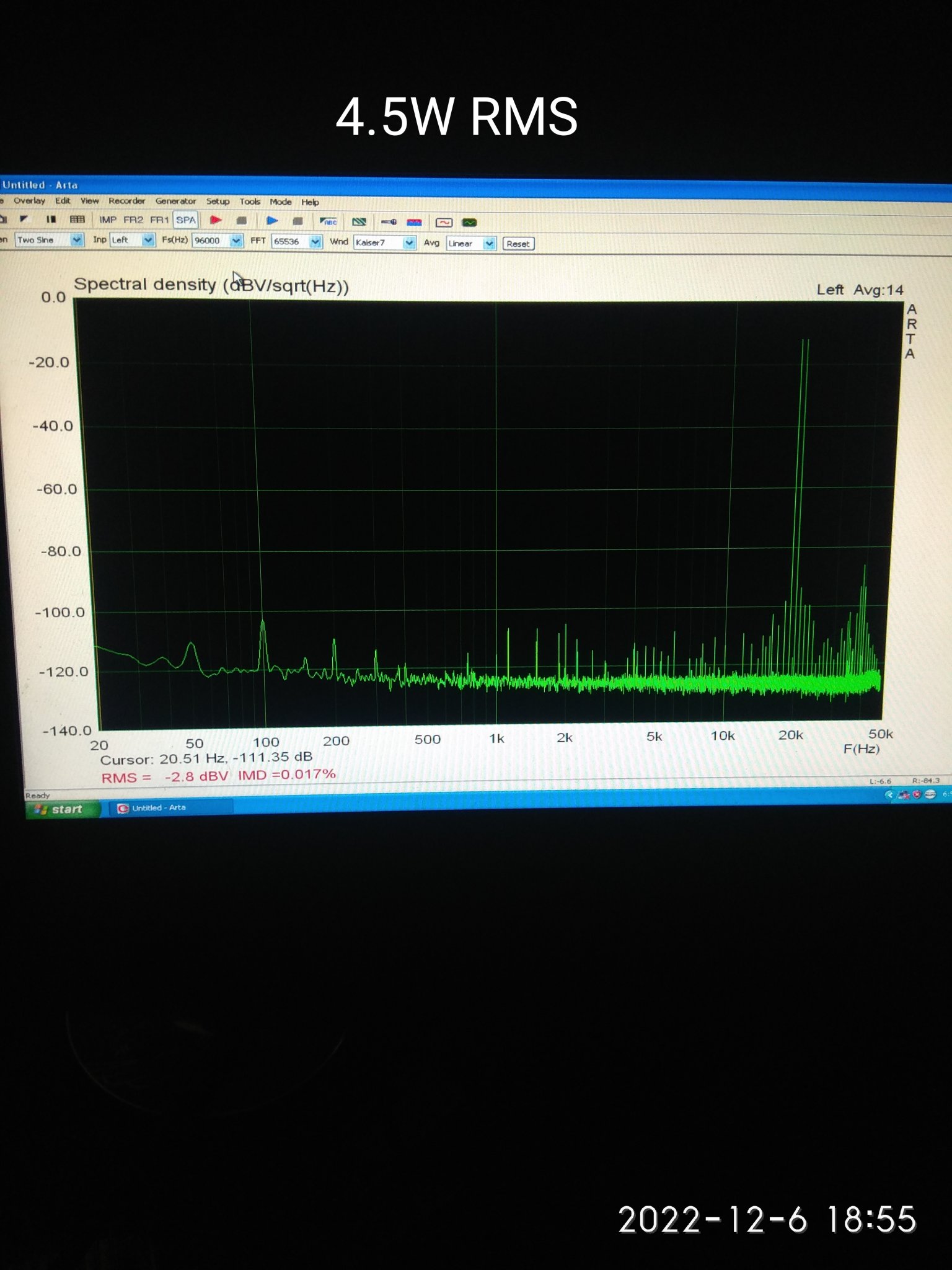

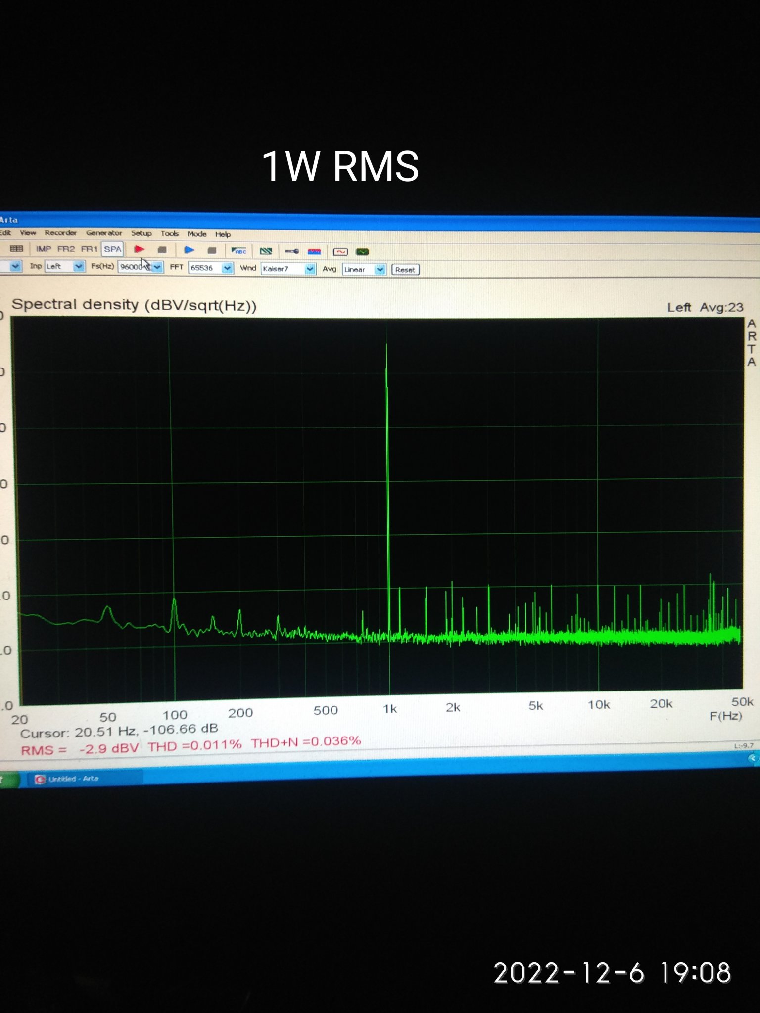

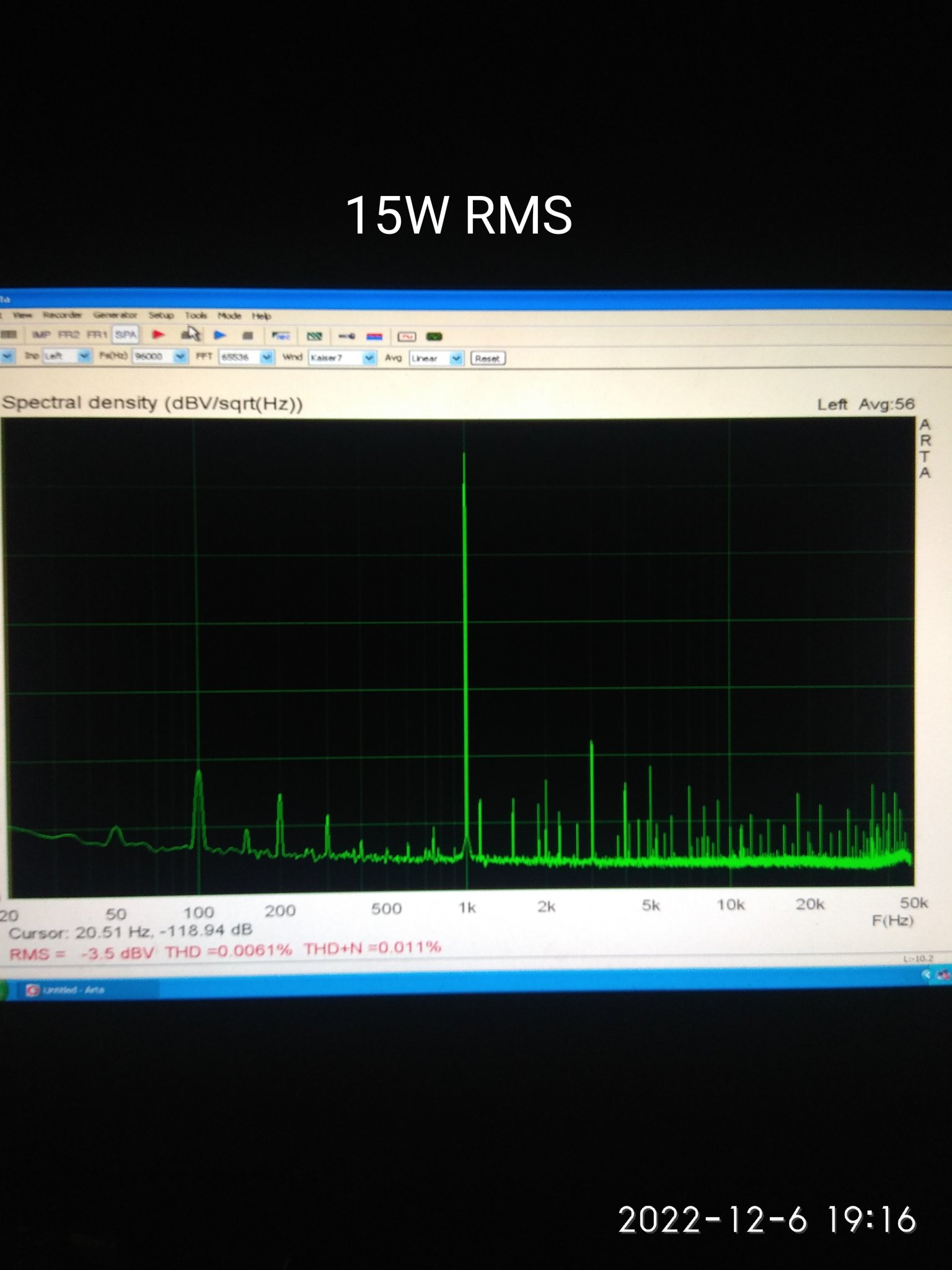

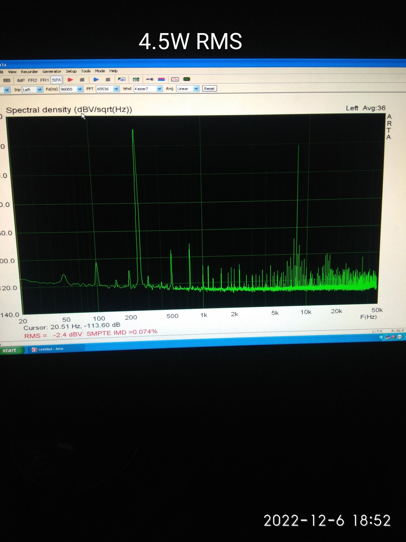

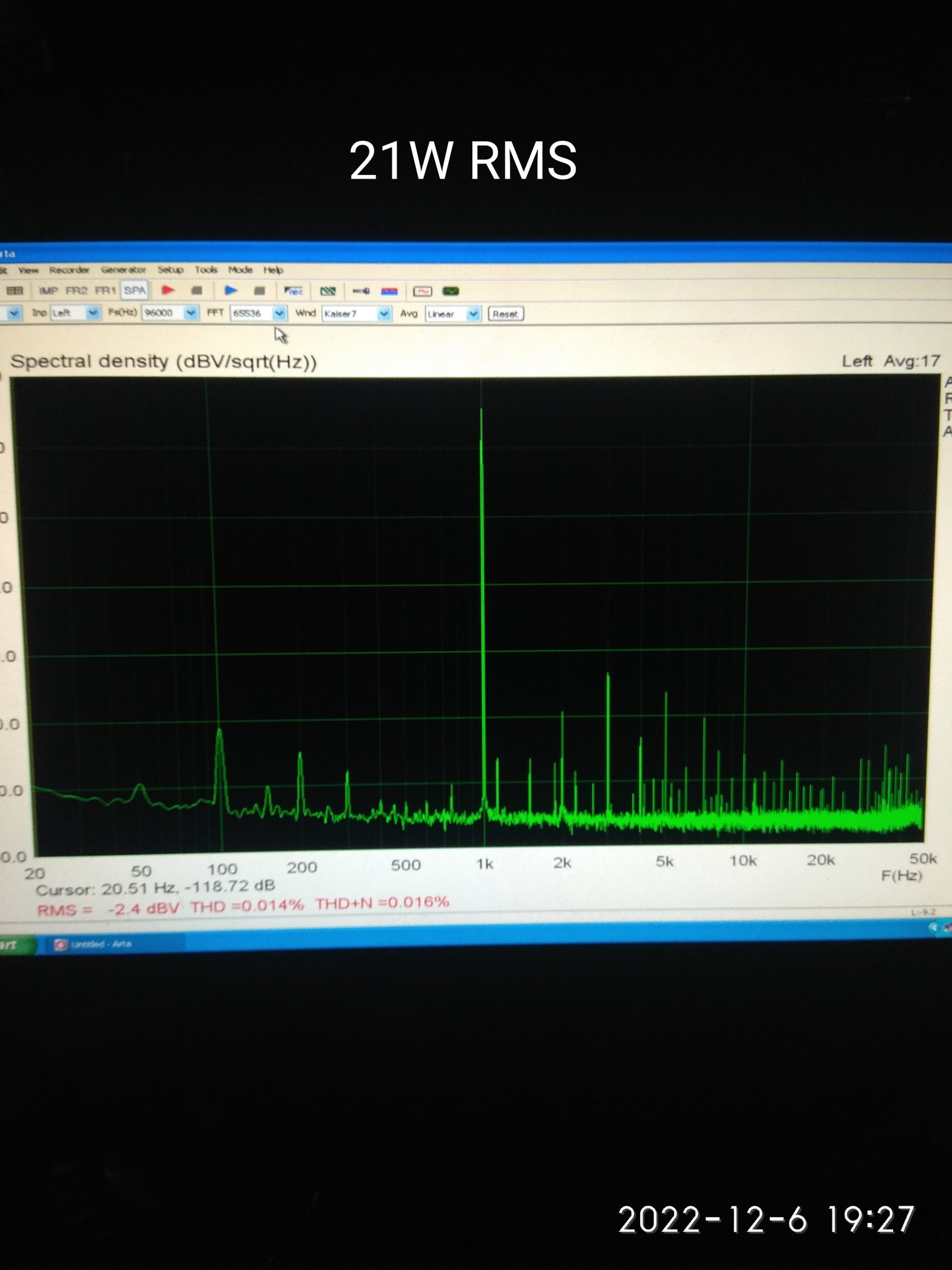

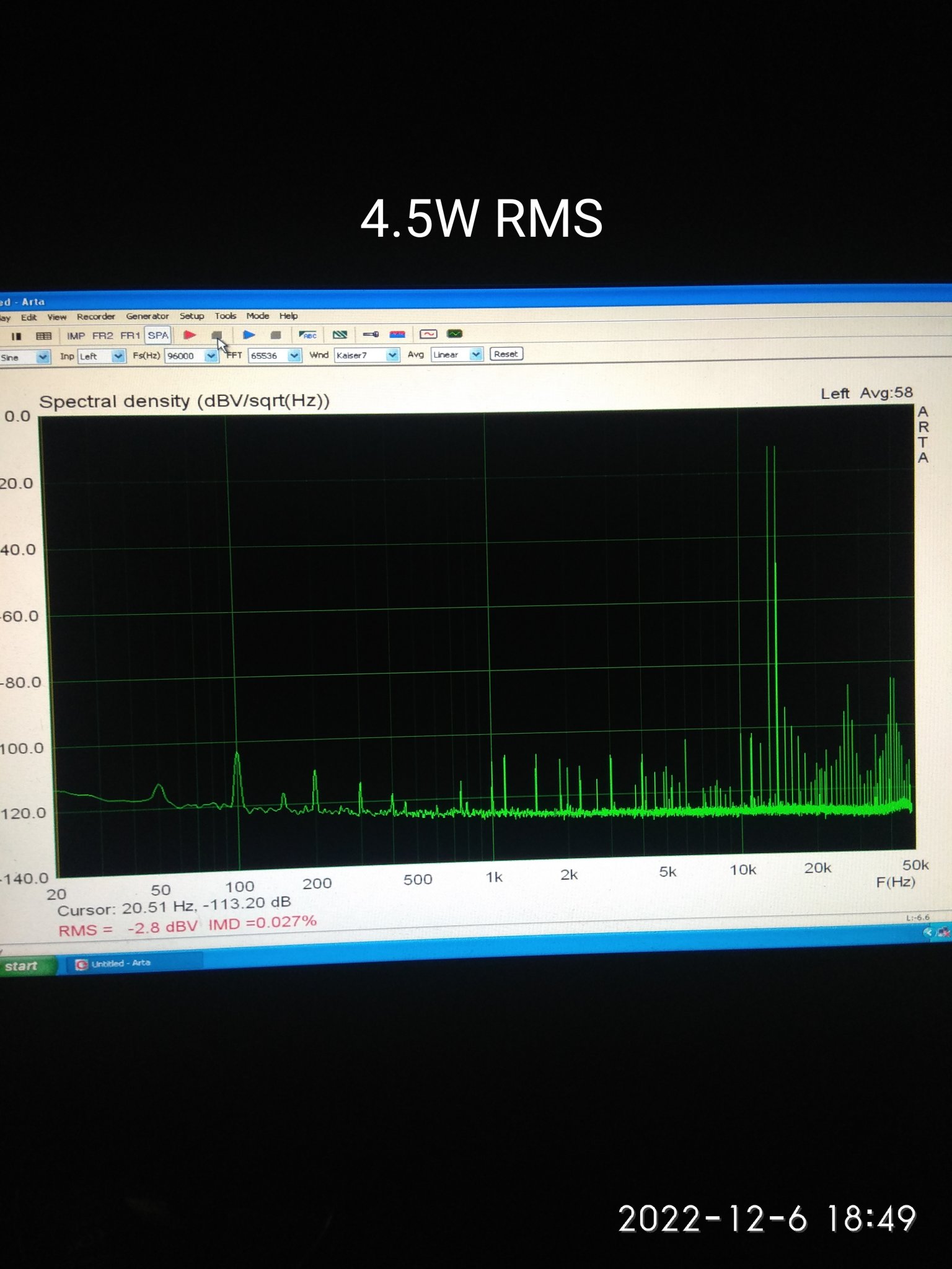

IMD test for the modified board.
Α significant improvement for the modified board ,of both Distortion and Intermodulation Distortion is discernible.
However, the measurements remain to be verified by simultaneously measuring both the original and the modified board.

Hi Mooly,you can compare numbers with the previous unmodified posted #1335 already.The raw numbers look fine to me. Strange the distortion decreases at higher output (1w vs 4.5w).
I've nothing to compare it against seeing just your numbersIt would be interesting to see other amps dropped into the identical test setup.
I do the same way to all amplifiers that I have built.
All are posted here in diyAudio.
I can post links if it is any interesting.
Distortions decrease at higher output is something common for all amplifiers that I have measure.
I don't know if it is a result of low R divider parallel to R dummy parallel to sound card line input z.
