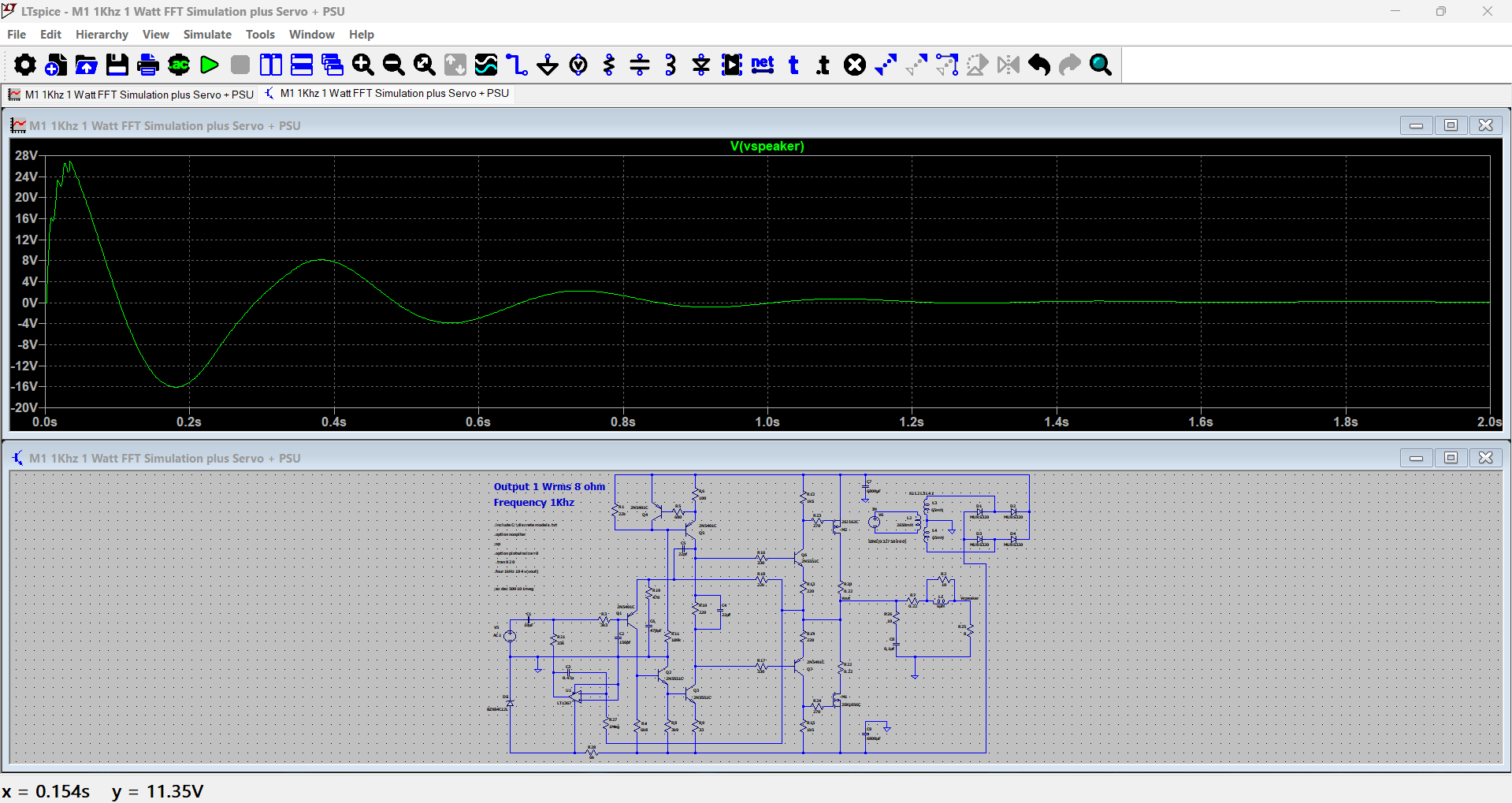

I'm noticed the same thing for the AC response. I replaced the servo with a voltage source as Mooly suggested and found that the response flattened. This leads me to believe the servo is responsible for the spike (at least in simulations). I've found that increasing the servo cap from 0.1u to 4.7u to 10u flattens the low frequency response. I don't claim to understand why though. By the math, the 0.1u should be fine. So there must be something else interacting with this that we aren't accounting for.
.. or it's a simulation issue. You'd have to build and test to see if its a real issue or a simulation artifact.
It is a real issue and not just a sim thing. I think the reason is that the servo output is used to derive the total input bias voltage needed (about -5.6 volts in the sim and in the real builds). Any AC signal voltage appearing at the servo output is added (or subtracted depending on phase) and that AC voltage increases as frequency decreases. There must also be as you say some other interaction with the various time constants in the circuit.
Years later I did a sim with a 'real' power supply to look at the switch on behaviour and increasing the servo cap value may something that could be tolerated, particularly with a longer speaker delay.
Standard values. Its instructional to run the sim also with a stop time of say 30 seconds and a start point of say 10 seconds in to see the settling time.

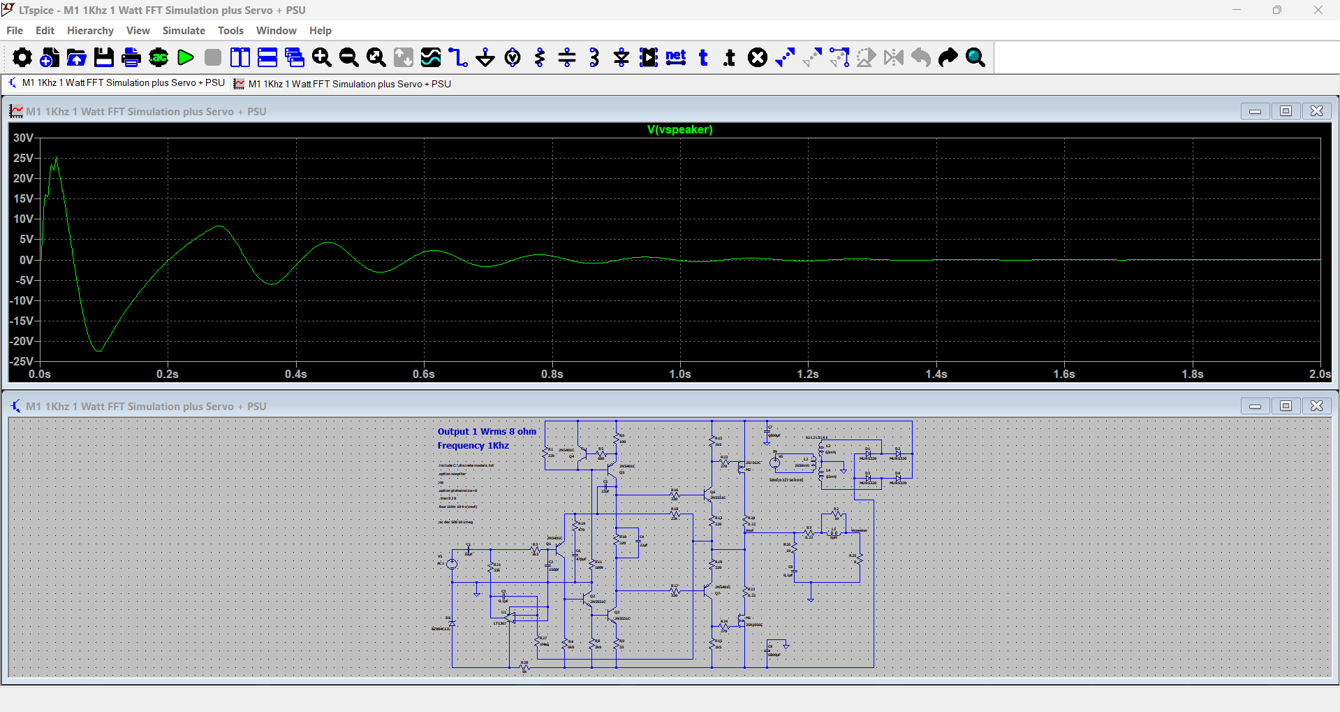

And with a 0.47u for the servo.

Its around twenty years since I put this together and there are undoubtedly things I would do differently today but what I can say is the design certainly delivers the sonics and it is possible that ironing out any perceived issues might actually work against sound quality... or not... it is an unknown.
It is interesting that the approach you're suggesting flattens the response. Does this increase the DC offset beyond the servo's authority? Or put it close to the edge if it's authority?
In many ways it is more than just a servo because as mentioned earlier, it provides the high DC bias voltage to set the operating point of the input stage. Most amps you see with a servo will operate quite happily without it as they use conventional input stages with a differential pair and if the design is good they have low DC offset anyway.
