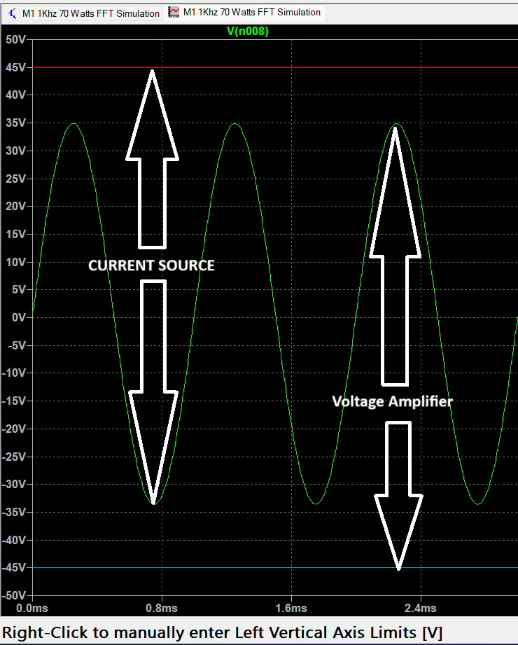

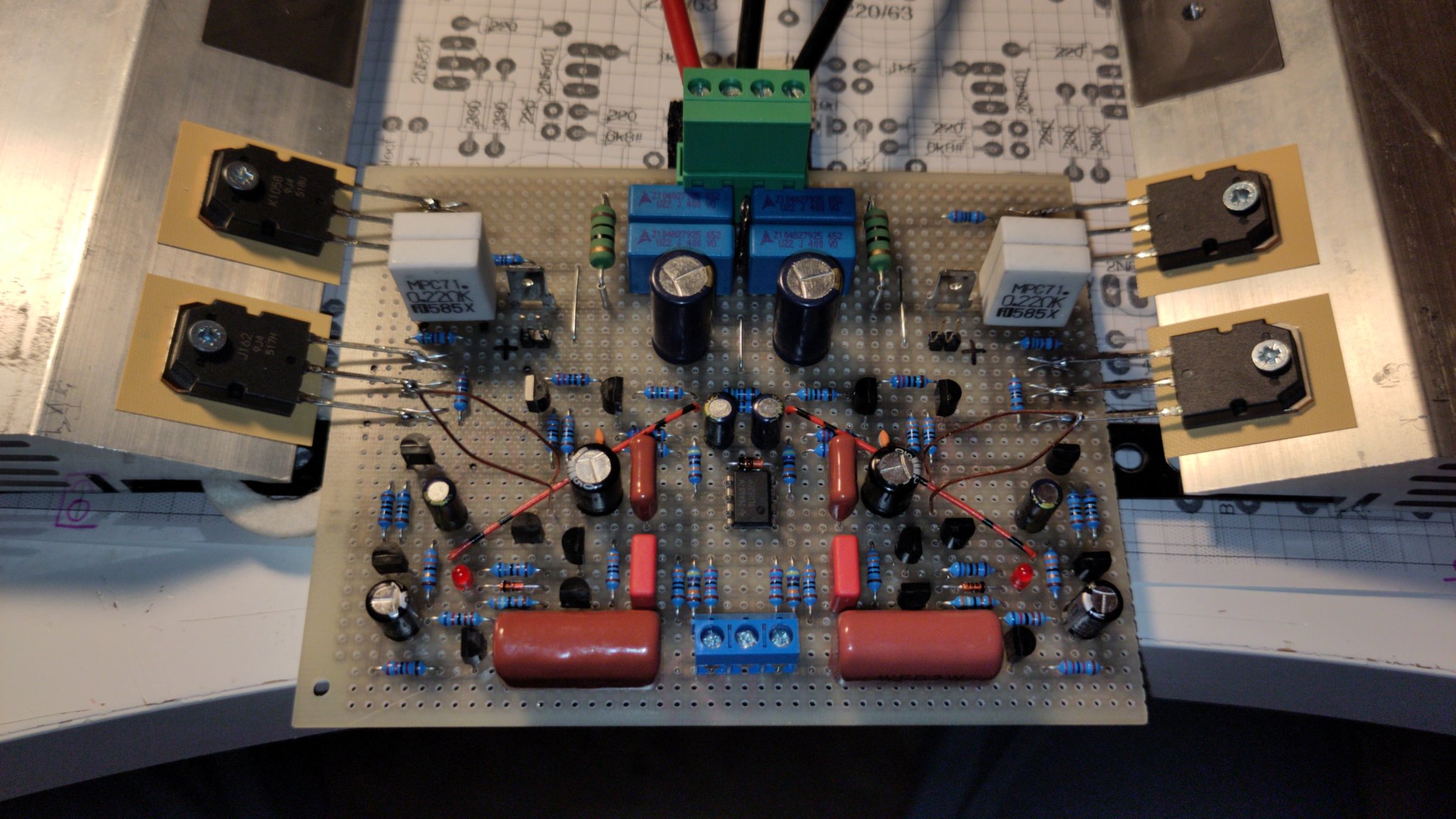

Started building yesterday. A first test today with shorted bias resistors and off of a +-19V lab supply looked promising already; no smoke, no output offset. I'll have to whip up a proper supply with +-33V (24VAC) next, before selecting the bias resistors.
It strikes me that Mooly has base and gate stoppers respectively for the output transistor drivers and FETs so there will be some two element combined curve in frequency response with the FETs no doubt well researched and proven to work. My advice is to stick to the script and don't branch out on another course.@mjona - I understand my friend, in all cases the designer knows best, I wrote saving a few pennies as a joke really, but - I have a serious amount of MPSWs bought to match perfectly for my Dynalo and Dynahi headphone amp builds and kits. I had no choice but to buy 500 pcs each from Rochester a while ago. They are obsolete. If you need any, get in touch pal
In any event they can be used - I will always ask, I could indeed use them here at some risk as dear Mooley pointed out - to be clear I will be building a 50w version with 35V rails, they could be used at a pinch, they are very decent, reliable 1W transistors.
So - yet again I will buy more transistors. I want to match as best as possible the 5551/5401 for this, so, I will have left overs. My stash, like yours most likely, is full of parts bought in excess, however I can pass them on to fellow builders here no doubt. It is very likely unnecessary to match anything for this amp, but it really makes me feel better to build to the best of my abilities and I enjoy the diligent process (the servo mitigates any imbalance in the grouping I guess? )
My transformer will be one of the last made by Terry at Canterbury Windings here in the UK, an absolute legend in the world of Toroidal Audio transformers. He will be retiring very soon and will only take orders that he can fulfil with his remaining stock of cores. I might just order another one for a future project.
The TL071 might struggle at low supply voltages unless you drop the value of the series supply feed resistor.
The resistor is adjusted accordingly (together with some other parts according to what I had available in the parts bin) and it does work fine at that low voltage already. I measured -8V at the IC, with the outputs around -2.1V each, which is correct for the lowered feedback resistor of 6k8 instead of 22k that I used. The IC is a TL052, which is the better-spec'd and lower-offset dual version of the TL071.
Here's your latest sim file, with all my part substitutions and additions incorporated. The additional RC filter for the op amp supply was just done to use up the parts that I had originally ordered for two separate boards, but is probably overkill.
That's looking goodHere's your latest sim file, with all my part substitutions and additions incorporated.
I think this is a very important point.My advice is to stick to the script and don't branch out on another course.
Whatever we might want to alter or do differently today and whatever criticisms there are of the original design, the fact is the original does work and makes great music.
Running the original amp with low global feedback was a very conscious choice... it just sounds so good,the lowered feedback resistor of 6k8 instead of 22k that I used.
