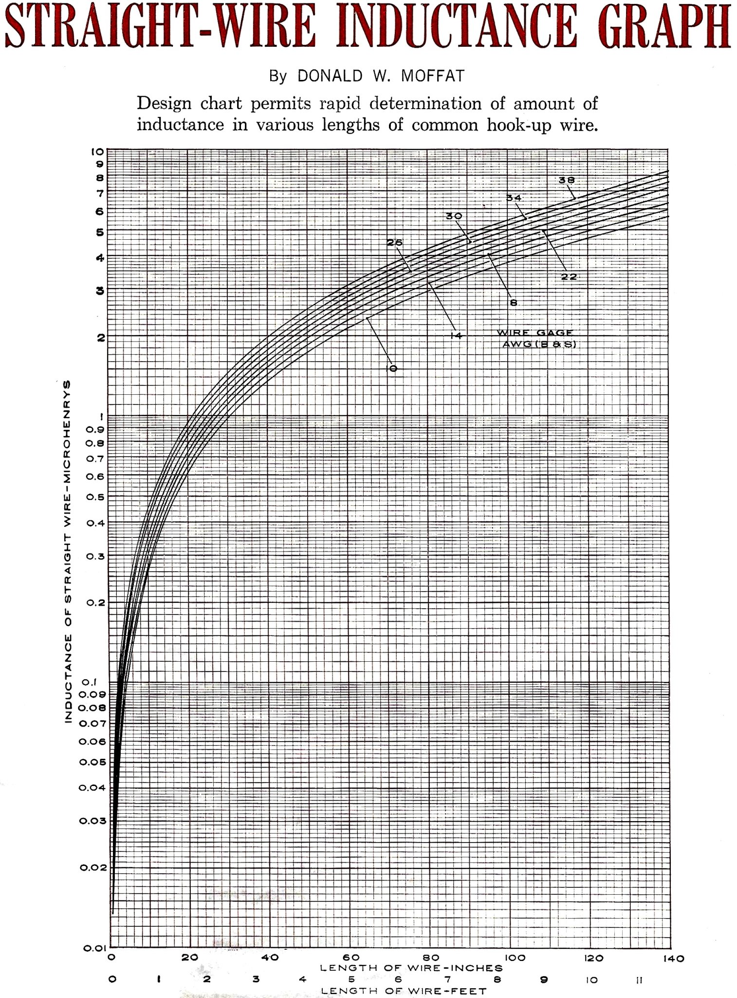

Its in uH. Here's a chart from the February 1966 edition of Electronic World. However, this is for a straight single wire. In practice, the output would be ran alongside the ground and possibly twisted which would reduce self-inductance.
There's numerous calculators online such as this one: Wire Self Inductance Calculator. The formula is fairly complex, so using a calculator makes life easier.

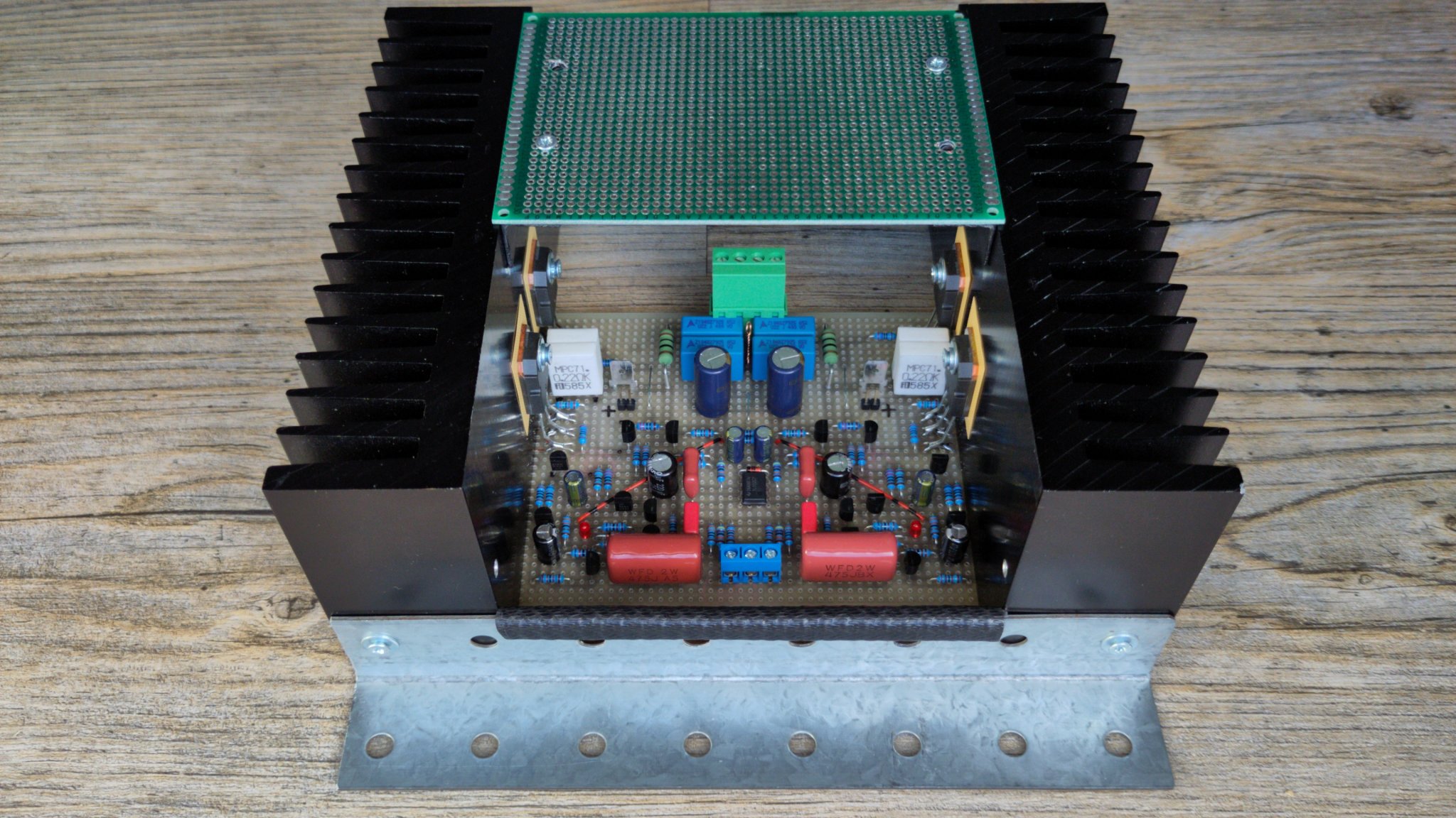

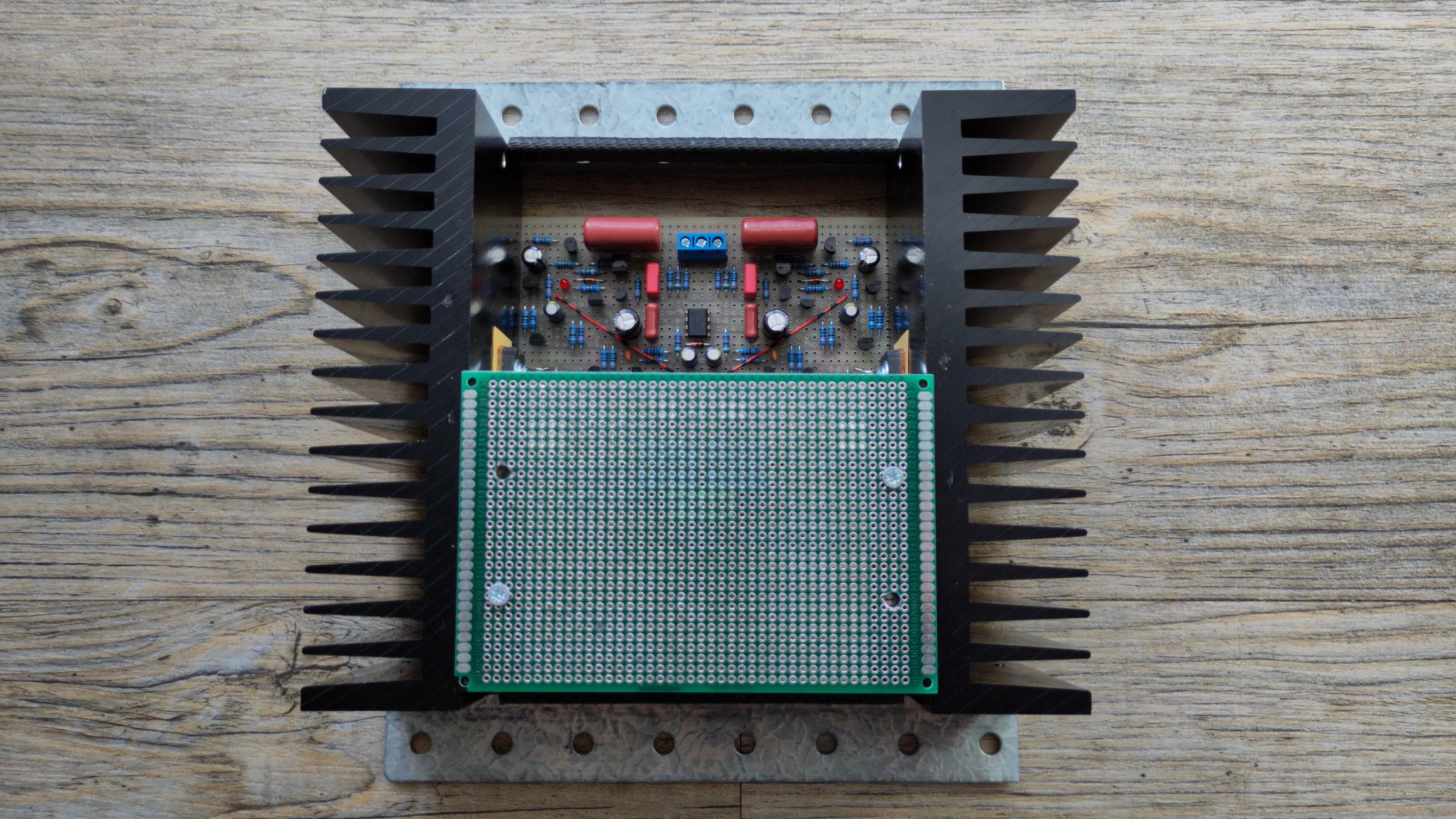

Did some drilling and tapping today, to assemble the main ''engine block''. The empty veroboard on top will be populated with the output inductors, protection circuit, and rail fuses.
Afterwards I have noticed that the remaining space in the case is somewhat tight to fit in the original PSU that I wanted to use. I think I can use some parts that were intended for another project instead.

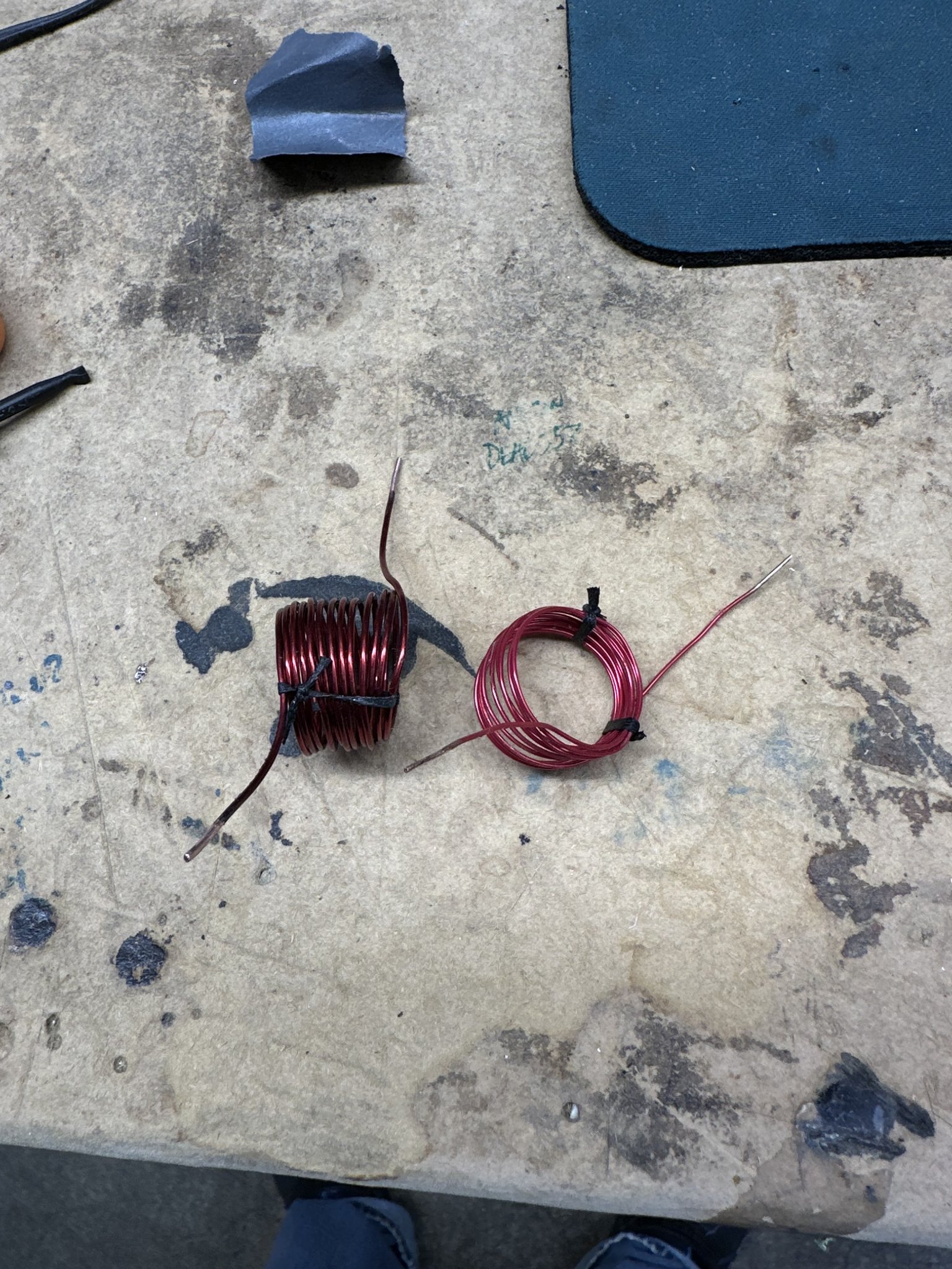

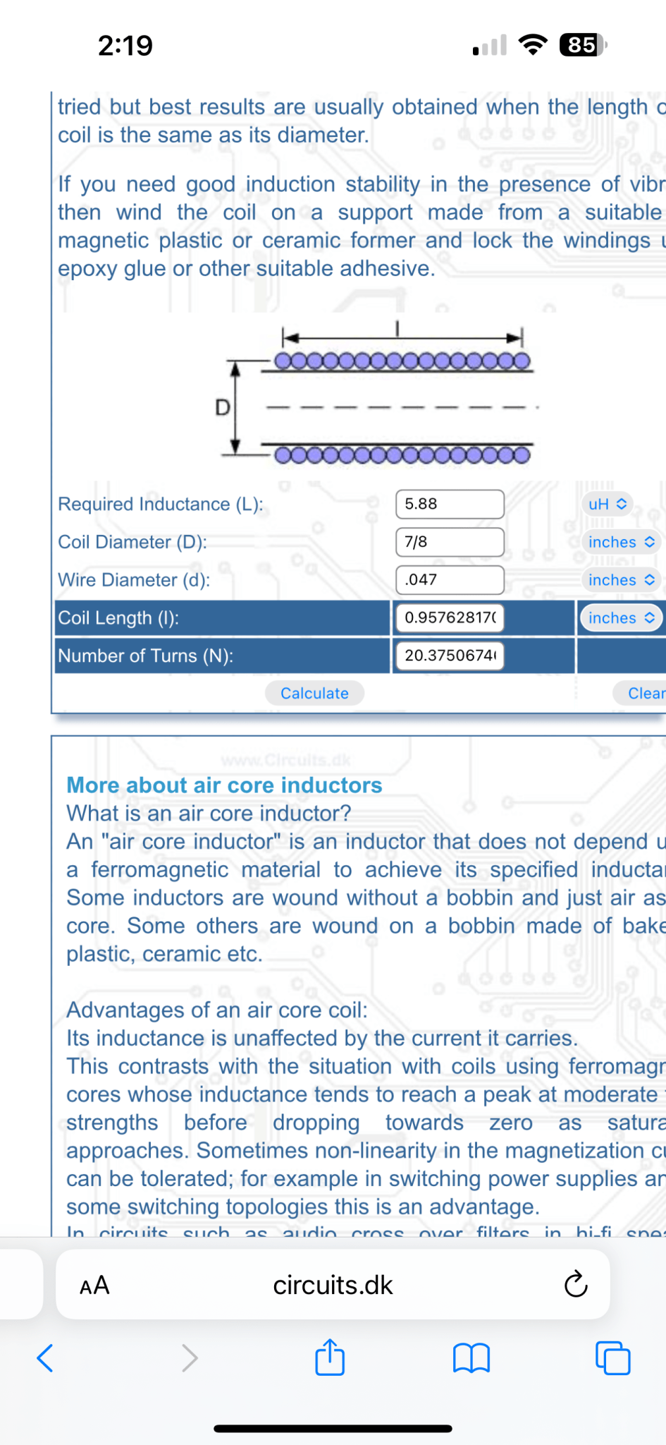

Data:
7/8” inside diameter mandrel.
Wire dia .047, 12 coils = 2.96uh, .03R
Wire dia .036, 12 coils = 3.27uh, .08R
Wire dia. .08, 12 coils = 1.92uh, .02R
Wire dia. .047, 20 coils = 5.88uh, .035R
