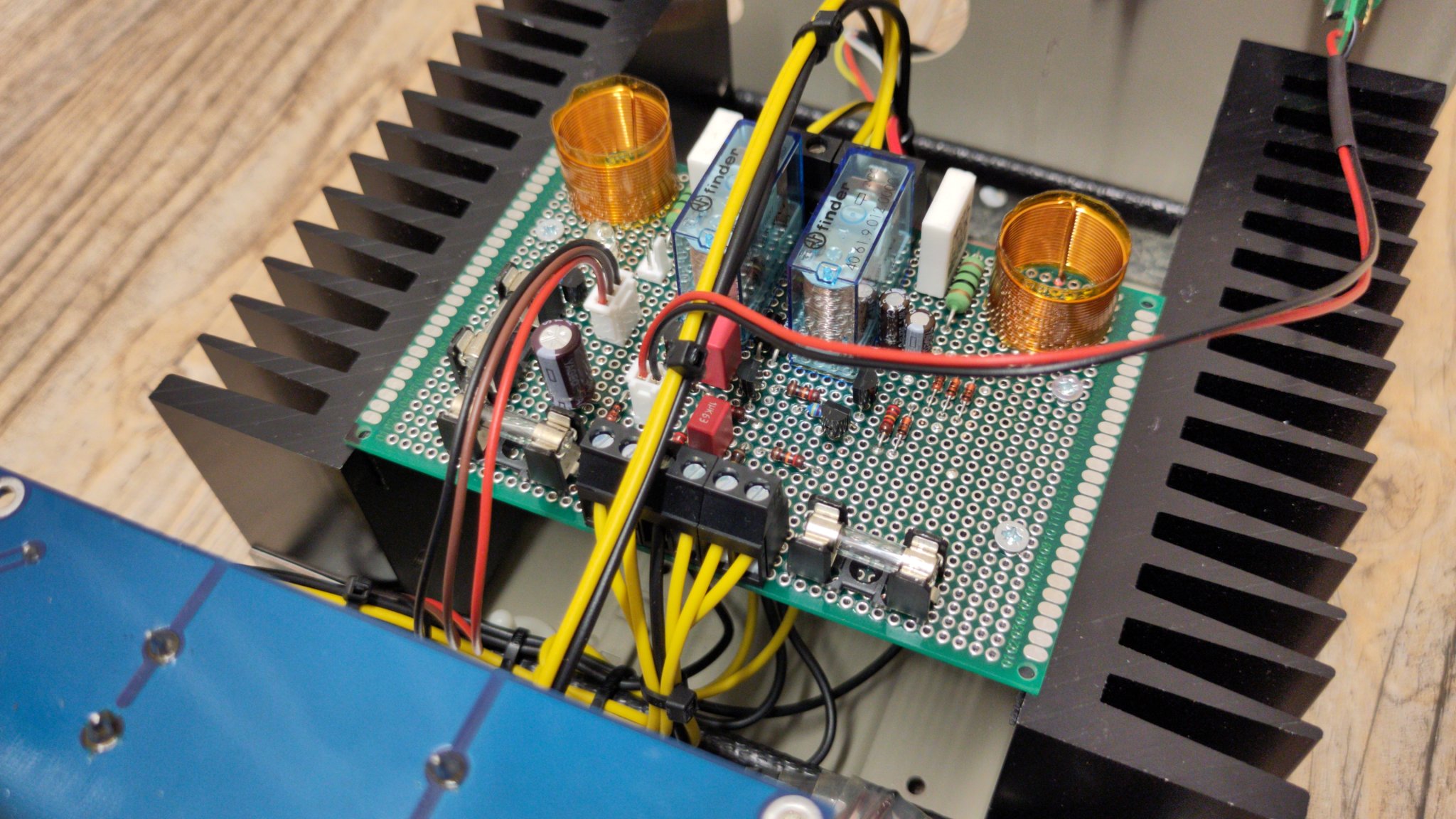

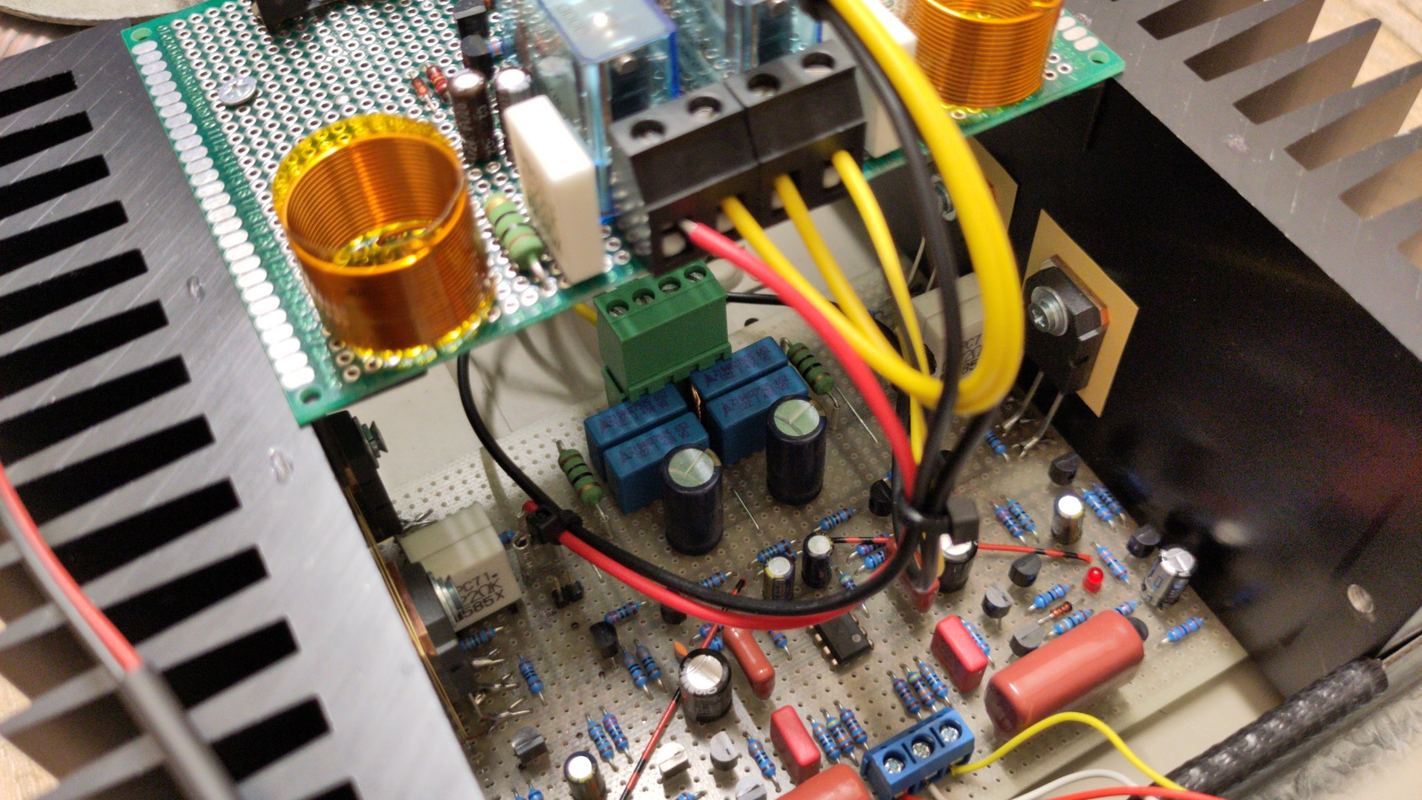

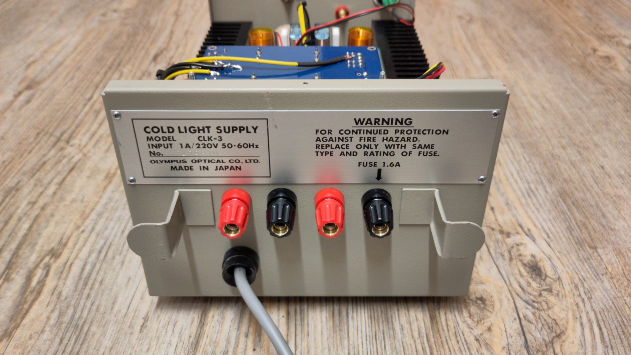

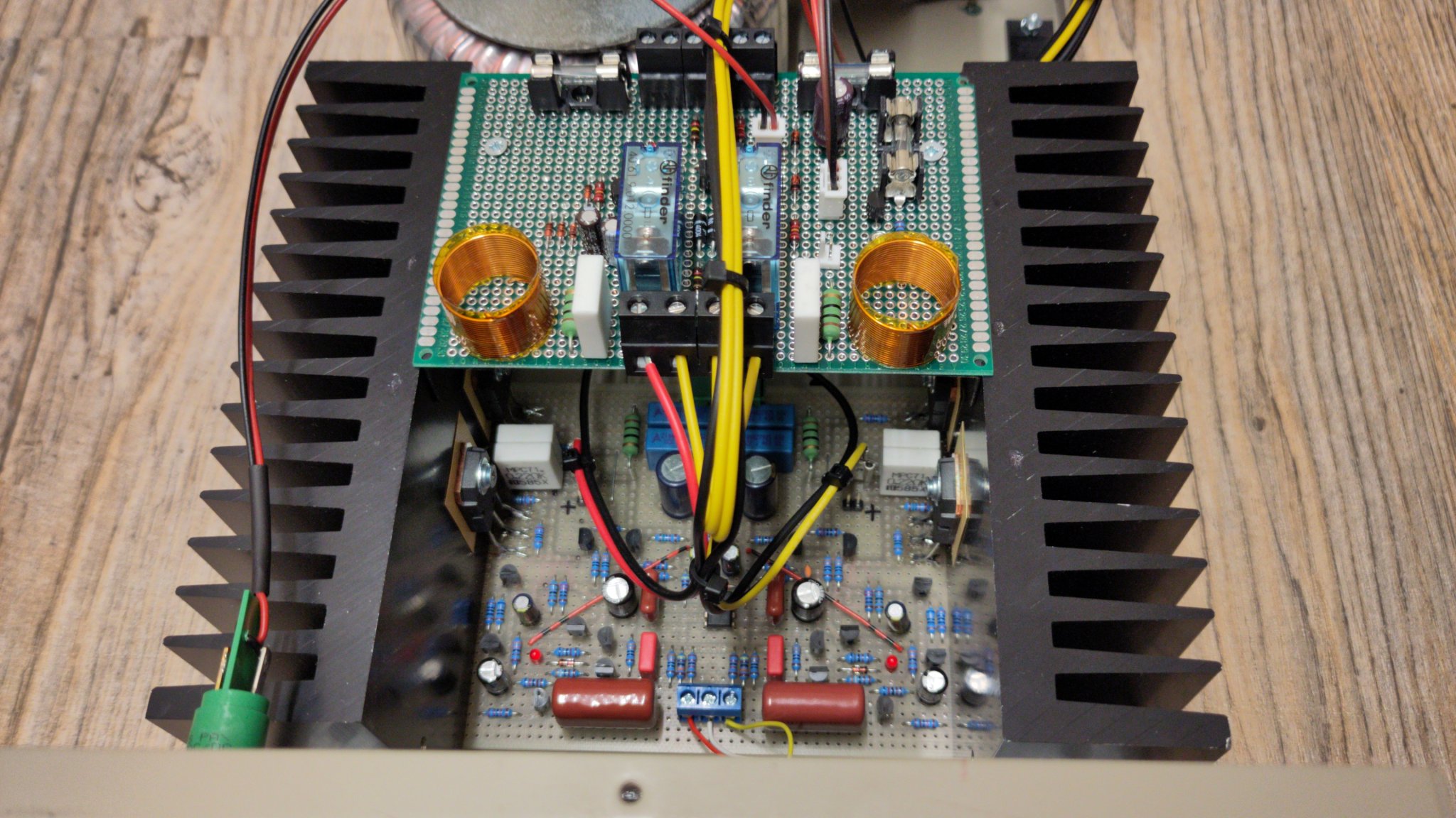

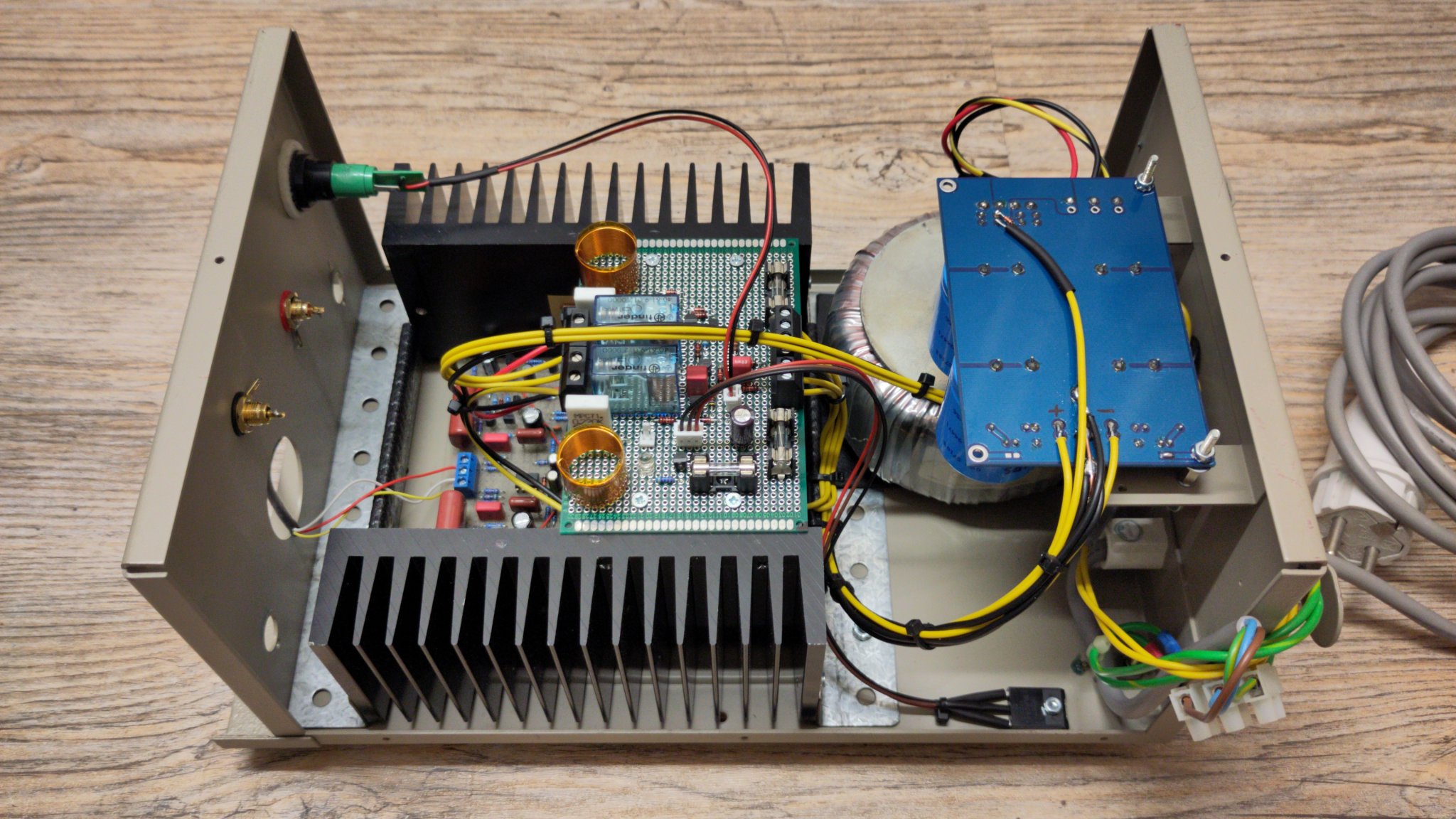

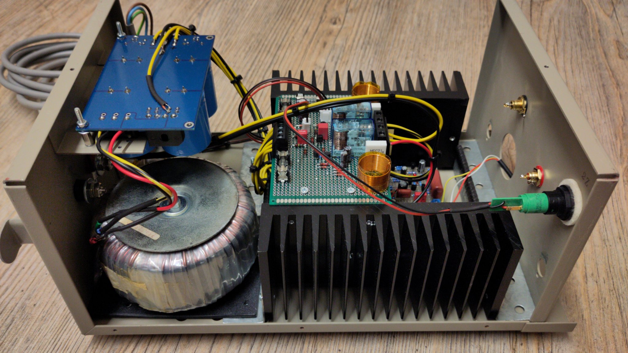

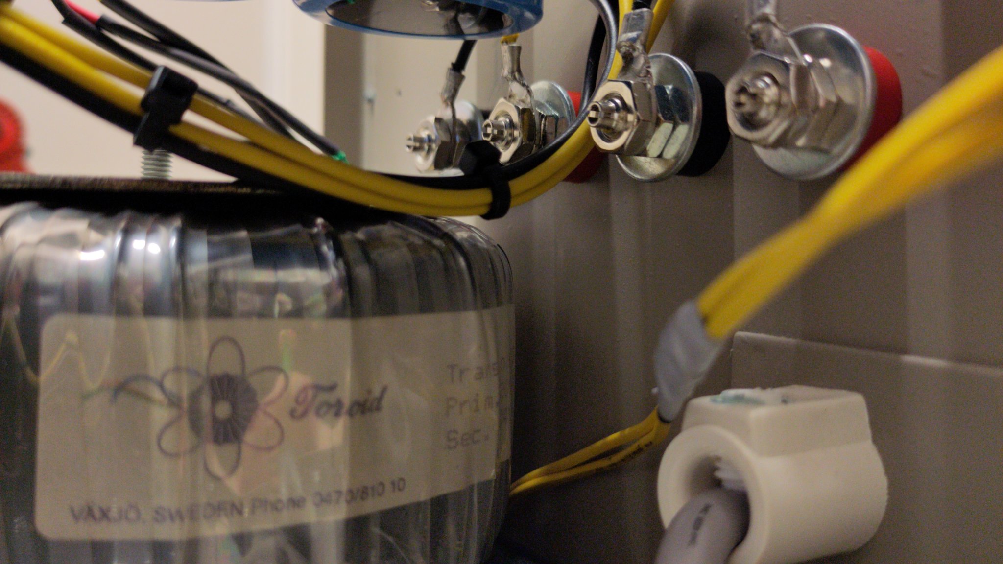

Almost finished now... it's alive and working! Need to tidy up the mains wiring, make a proper front panel and the input wiring with the RCA connectors at the right position (and not just stuck into some existing holes of the recycled case), and then it'll be time to give the amp a thorough listen.
Here's another 'scope shot for power-on. CH1 is the output of one channel, now only peaking up to 5V (nice!). CH2 is the relay voltage; turn-on delay takes 1.3 seconds with my circuit. CH3 and CH4 are the rail voltages, barely 33V with the proper PSU.
And finally some more photos:
IMG_20240327_201421.jpg IMG_20240327_201255.jpg IMG_20240327_201215.jpg IMG_20240327_201115.jpg IMG_20240327_201024.jpg IMG_20240327_200940.jpg IMG_20240327_200914.jpg

I wonder what the inductance of those coils is. They look big enough to have a reasonable value even without a core.
You can use non-air-cored inductors of course, but you'll want to make sure that the core never gets into saturation under normal circumstances. If your inductor starts to saturate at 10A you'll certainly be fine, whereas if it starts to saturate at 2A already, it will introduce distortions that might be audible. It could even be possible that the inductance drops too low for the inductor to be effective with your particular speaker setup and the amp might occasionally break into spurious oscillations.
The main advantage of using a core material at all is that you can build a physically much smaller inductor, and that it can be better shielded by fully encapsulating it into that same material. You might want to look into selecting output filter inductors for Class-D amplifiers, as the problem is exactly the same there. Here is an example for a dual inductor in a single package. They are magnetically shielded from each other, as to not introduce cross-coupling.
Meanwhile my amplifier is now set up in the living room, driving a pair of Infinity's. First impression is superb! (y)

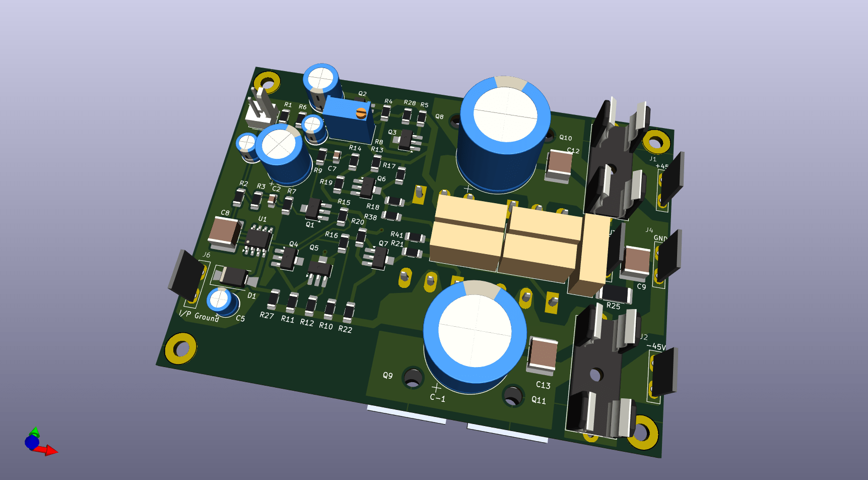

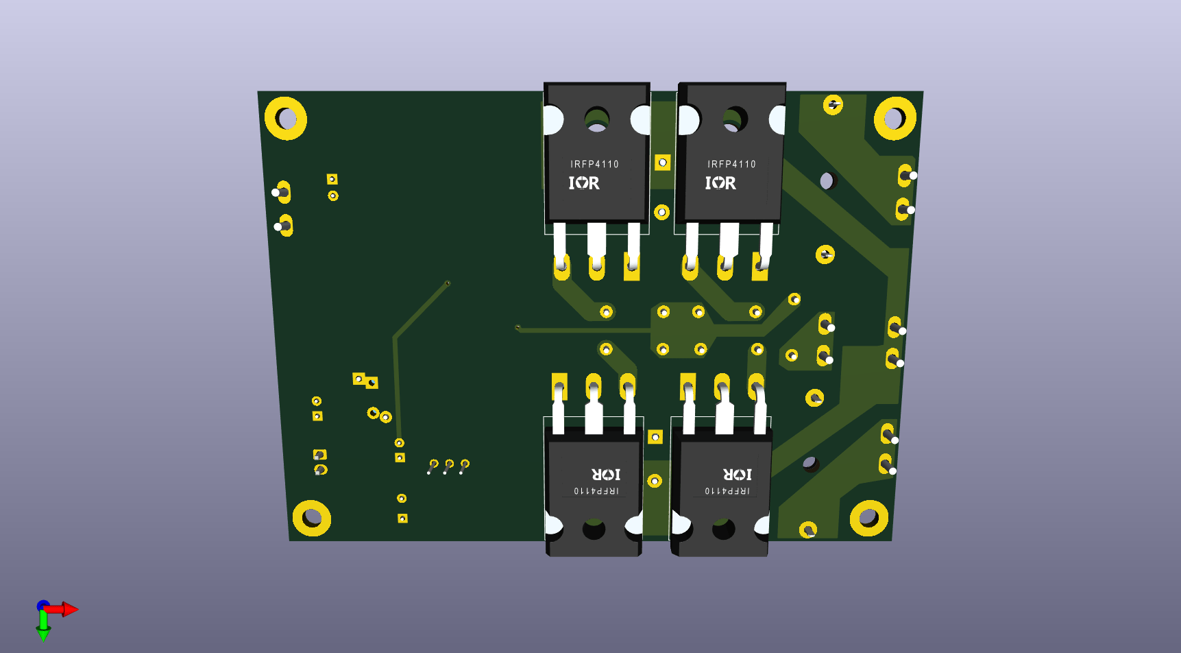

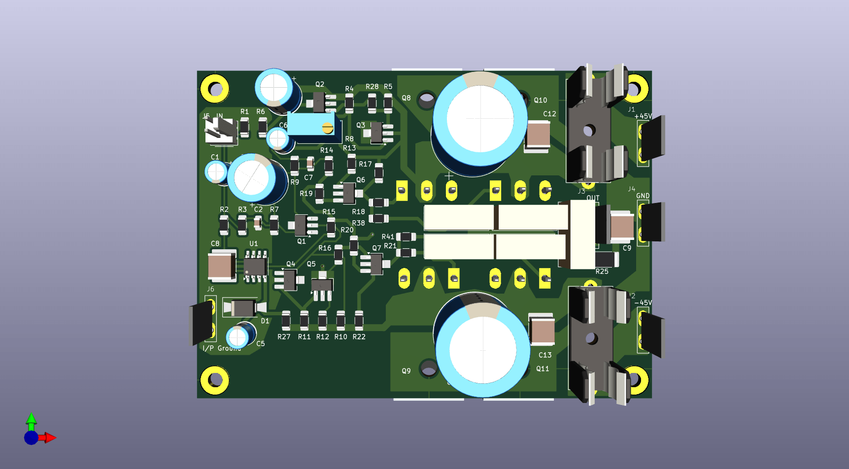

Having thought about how components are steadily becoming available in surface mount options, I took a look at doing a layout to take that into account, this excluding the highest power resistors, the MOSFETS and the electrolytics. I've taken Prasi's excellent dual pair board as the model. Attached is my first take on this and I invite comments on it. Bear in mind it's a learning curve for me with using Kicad 8 for power circuitry.

Joined 2017
I think you're going to run into thermal issues with the VAS (Q5) and CCS (Q3) transistors. Based on the simulation files Mooly provided, these dissipate 265mW each. The TO-92 package has a thermal resistance of 83.3C/W for Junction-to-Case and 200C/W for Junction-to-Ambient. This puts the junction temp at 95C. Using the derating figure of 5.0mW/C, the derated power rating is 273mW. These are running right at their thermal limits.
The SOT-23 version of these devices (MMBT5551L/MMBT5401L) has a lower power rating and higher thermal resistance (225 mW and 556 Junction-to-Ambient). Without doing any calcs, we can see that it's well beyond it's thermal capabilities. In addition, these ratings reflect a 25mm x 20mm copper area for heat dissipation, which your layout does not provide.
The other TO-92 devices are likely OK. Their dissipation is less than 20mW.
I'd suggest leaving Q5 and Q3 as TO-92 devices. You could also consider replacing these with KSC3503/KSA1381 if you want to add a bit of safety margin. These seem to work in simulation, though this would be an untested change... proceed with caution.
For the mosfet source resistors there's 5W smd resistors from vishay - https://www.vishay.com/en/product/31059/
Datasheet - https://www.vishay.com/docs/31059/wsrhighpower.pdf
There's a 3D model for kicad.
The resistors are available from Mouser, Digikey and Farnell
You should place the mosfet gate resistors as close to the mosfet gate pin as possible, to prevent oscillations.
Thanks for your feedback.
I've had a quick look at the 5W SMD resistors and their footprint appears to be JUST too big to fit in the current locations. I can move the gate resistors with no problem.
I'll take a little while longer to see what else comes back in comments then see what is worth doing.

Thanks for the feedback.
I've done the layout using SOT-89 devices, ZXTP5401ZTA which is rated at 1.2W with derating of 9.6mW/degC. and ZXT5551-13 which is rated at 750mW with derating of 166 degC/W. As you say and Mooly's simulation file agree, the VAS (Q5) and CCS (Q3) are the only ones being pushed for power. I'll run my slide rule (spreadsheet really ;)) over these two and adjust / amend as necessary.
