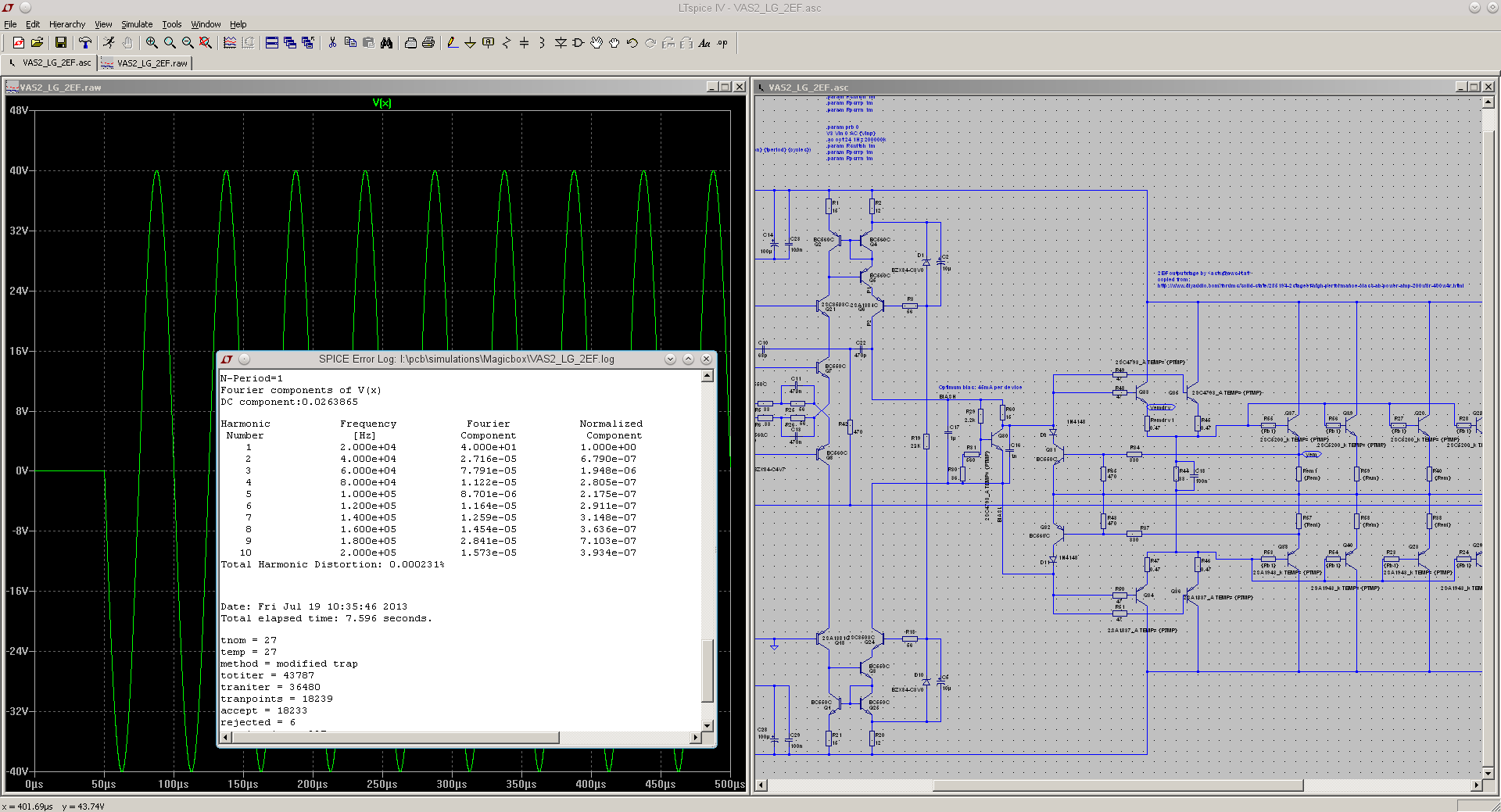

Using 2EF output stage ...
Attached your VAS with TMC compensation and my 2EF outputstage seems to be a good starting point for further optimizations.
THD20k@100W@8R:
0.0002% / PM 63 degree / GM 17 dB
BR, Toni
P.S.: SOA protection has to be recalculated!

Hi Harry,
Yeah I labeled them correctly. A side note though is that the TMC network isn't as 'strong' as you'd dimension it when used as the only form of compensation (caps and resistors are smaller in my case). Maybe that causes the slope to be more unfamiliar.

I got the diamond output to work. I grafted it onto ASTXs version. It could not compete with ASTXs output stage. With the same compensation it was had 5 times the THD.
Now playing with a different compensation method. Will report back in a day or so with results.
Meanwhile I got the diamond output to work as you gave it to me. I made some stupid mistake at first, which is why I couldn't set bias. Had to do with supply net labels.
Anyways, I have not been able to get the OPS stable in conjunction with my VAS. The OPS causes a particular gain spike at a little over ULGF, with a severe phase twist which I just couldn't remove at all, no matter the compensation efforts on both the VAS and the OPS itself. I won't say it's impossible, but with all methods I know at my disposal wasn't enough.
The main reason I think is that there are too many devices in the Cherry loop this way. From that perspective, it seems acceptable that a 2EF would perform better; it would be more direct path.
I can give the 2EF stage a try still, but I'm leaning more and more towards the Exicon MOSFETs in a simple buffered OPS. Using very low gate stoppers together with a buffer that can supply the associated peak-current without making the VAS limp is what I would say a very fast OPS.
And that's what this VAS needs. A fast output stage. But also one that doesn't perform any EC itself, as the Cherry loop already takes care of that and active EC in the OPS may turn out to be counter productive.
