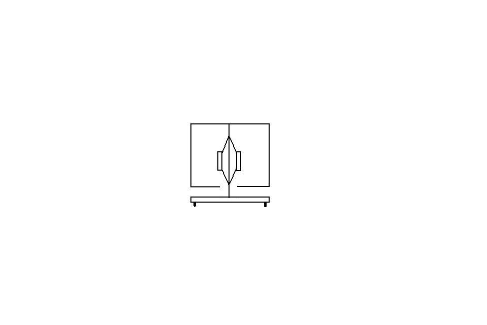

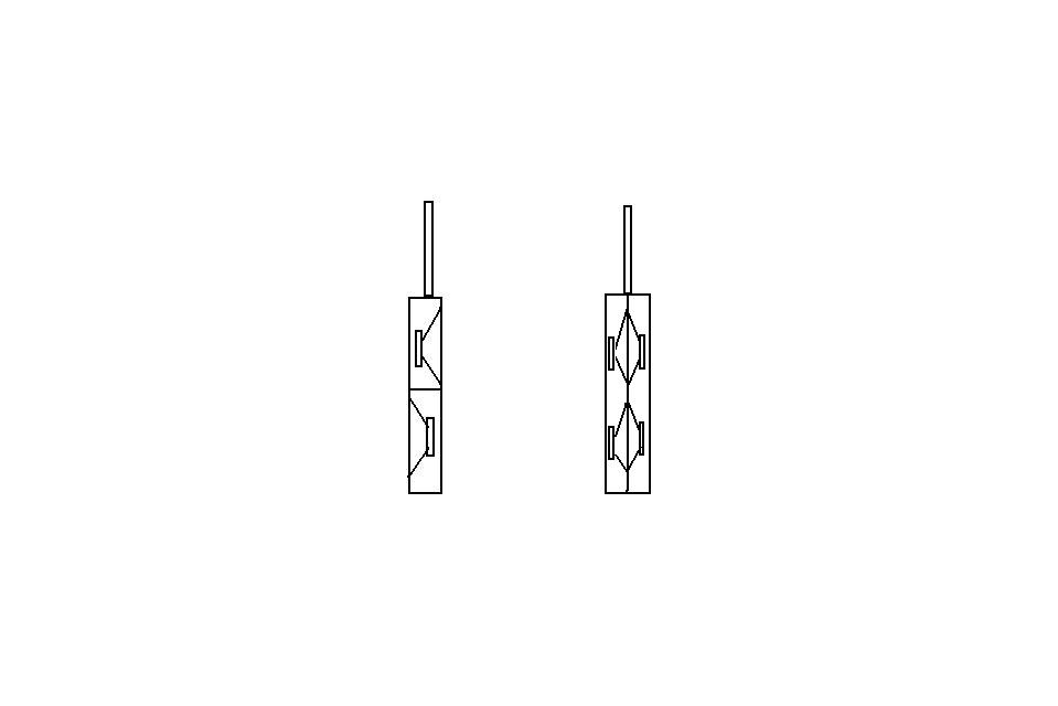

But the two pushpull woofers are shown with a clean common "output"
I would expect there would be severe phase issues between them
But I dont doubt your point about the issue, it makes perfect sense
Not really sure whether something like this one will solve anything either🙄
Another question is how important the backwave really is ?
Maybe its where a ripole has its advantage, having symmetric front and back ?

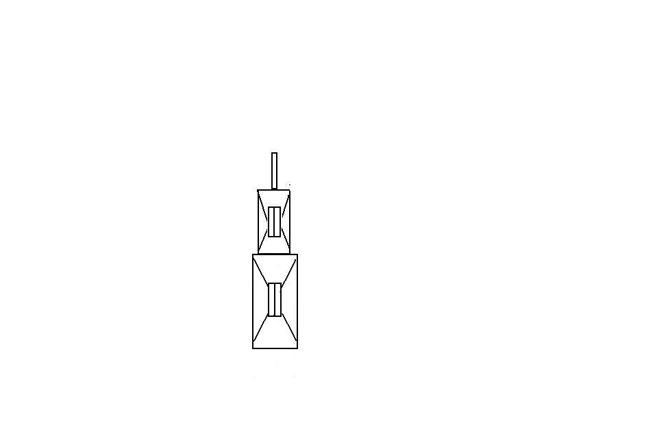

Wonder what it would do to make the top like this ?
There is a small box, yes
Well, its actually just isobaric pushpull OB
But I dont see any other way if you want a perfect symmetric front and back
