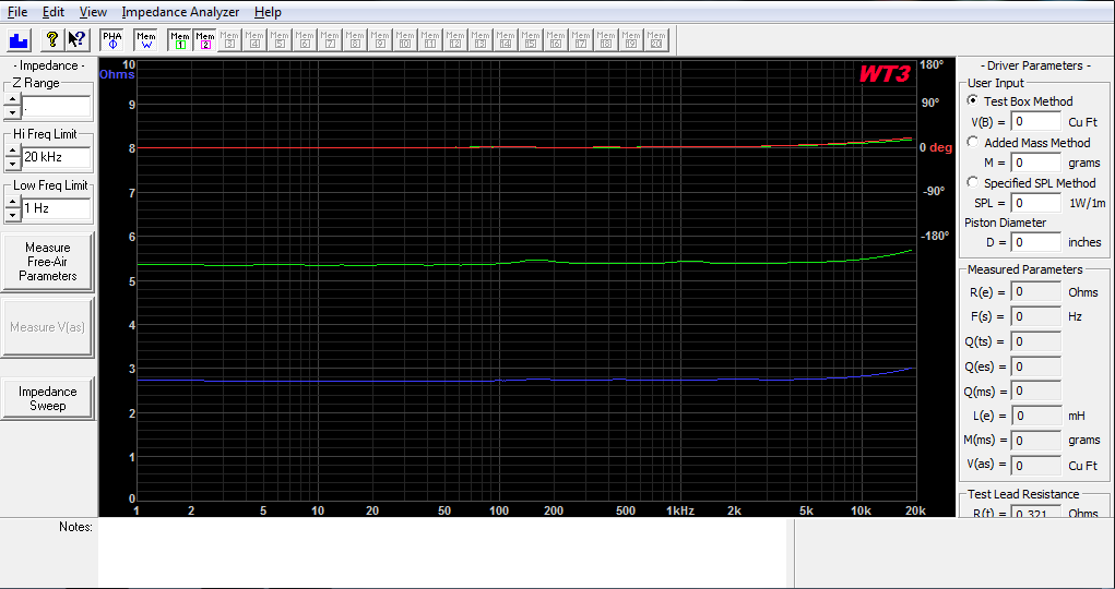

I purchased a pair of RD-75 drivers from Parts Express about a year and a half ago, and I noticed a buzzing from one of the drivers right away. I figured it was just a break-in issue, and after posting about it in another thread, I decided to wait it out and see if it would just go away. I live in Canada, and ordered the drivers to the US which is a bit of a drive, so I was hesitant to go through the process of returning the driver. This turned out to be a big mistake.
The buzzing never actually went away, it just got worse. With some music it was almost impossible to notice, but the drivers absolutely massacred anything with a piano in it.
I tried clamps, damping the metal, running the driver with and without the rear enclosure, and increasing the XO all the way up to 500Hz from the usual 200Hz. Nothing helped. Finally, I decided that an impedance plot might show me what was going on, and that's when I found that one of the two drivers was exactly half the impedance of the other. The plot is attached.
The faulty driver measured roughly 2.7 ohms where the good driver measured 5.4 ohms. I verified this with a DCR measurement using a multimeter.
The only possible cause of this is that one of the conductors was shorted back onto itself somewhere at the top or bottom of the driver. The result is that the diaphragm was being driven unequally, resulting in the buzzing sound.
Seeing as this was a painfully obvious manufacturing defect, I contacted Parts Express and they told me they only handle returns during the first 30 days, and that I would need to deal directly with B&G. At this point the driver was a little over a year old.
After contacting B&G, they told me the driver was out of warranty, and that regardless of the defect, they would not replace the driver. I insisted that it had to be a manufacturing defect and sent them my measurements. They then told me that if I shipped them the driver, they would "look into it".
I packed everything back up, drove back to the US and shipped the driver back to them which cost me $120. About a month later I got a note saying the driver was out of tension, and that no other fault was found. It also said I owed them $255 for the repair and $100 for return shipping.
I asked multiple times for an explanation on the impedance of the driver, but never got an answer. They would not let me talk to the "repair tech" or provide any verification that the driver was properly fixed.
When I got the driver back, it was a brand new unit, and thankfully did not have any buzzing issue and the impedance was correct.
Total cost to get the driver "repaired" was $560.
Overall, it was a genuinely terrible experience. I ended up paying nearly $2200 to get a properly working pair of drivers, and with a fault like the one I had, it's obvious they don't do any QA/QC at all before packing and shipping the drivers. Even a quick check with a multimeter would have caught that problem.

I just wanted to report back with a similar story to Larss, but my experience unfortunately wasn't as smooth as his.
