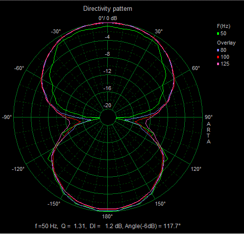

Check out the woofer directivity:
![woofer directivity.GIF woofer directivity.GIF](https://www.diyaudio.com/community/data/attachments/383/383806-95a56c033ed640281b4a3e5c12ad02f5.jpg)
That make up my mind to go for separate tweeters.
The question now is AMTs or RAAL ribbon.
Any suggestions appreciated!
