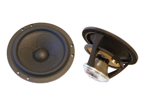

Check this out - the product of today's work: Two drivers, one an 8" RS225, the other a 6" Alpha 6a, both measured with NO baffle.
I took outdoor measurements, 3m in the air, at a distance of 1.7m, giving a resolution of 85Hz or so. In the following graphs, IGNORE below 200Hz. Each graph shows 0, 30, 45 and 60 degs. What I am looking for is an 'ideal' dipole response, which I define as down 1dB at 30degs, -3dB at 45deg, and -6dB at 60deg. Also notice that each vertical division is 3dB in the graphs below.
It is common to see 8" drivers used for OB systems between 150 and 1500Hz. At issue is the off axis response, and the irregularity caused by the width of the driver. As will be shown, 6" drivers have a much more ideal off axis response compared to 8" drivers, when used in this range. Of course, the caveat with 6" drivers is their limited output. They will be excursion limited below 350Hz or so.
Here is the RS225, the driver I'm currently using:
Two things - first, it's figure of eight pattern is narrower - each off axis measurement is consistently more attenuated that one would expect. The other thing to notice it the drop in level with increasing frequency. I like to look at 45deg. At this angle things should be down -3dB: but instead, between 300-400Hz, the level is -4dB; at 600Hz, it is -5dB; at 900Hz, it is -8dB; and at 1500Hz it is -10dB. If you were trying to have a 'constant directivity' design and maintain -3dB at 45deg, you would have missed it by 7dB at the upper end of the driver's passband. I think it is safe to assume this is audible.
Now, lets look at the 6" driver.
Notice how tight the polar pattern is - up to 1000Hz, there is almost no deviation from the ideal dipole pattern. Then at 1500Hz, you can see there is some loss of regularity - at 45deg, the level is down 7dB, which is an error of 4dB from the ideal. I would say this is a substantial improvement (and tomorrow, when the rest of the drivers come, I'll tell you how it sounds).
So - the bottom line is, if you want to maintain a very regular off axis response, it is possible. My current design is a 3 way, but is still a little compromised - at the top of the midrange driver's passband, it loses a little directivity control, and at the bottom, it will either begin distorting because of over excursion, or will start lobing due to to large a distance between drivers for a higher XO point. Before too long, this system is likely to become a 4 way, using a 5" or smaller driver for an upper mid, and a 10" driver as a lower mid. This has the potential for very constant directivity for the whole system's bandpass, high sensitivity, low distortion and high output. The main compromise will be complexity and cost.
As a final note, the Alpha 6a was a good bit more sensitive in the lower midrange (where it matters a lot), despite its much smaller cone area. It does not have as advanced a motor design as the RS 225 though.
