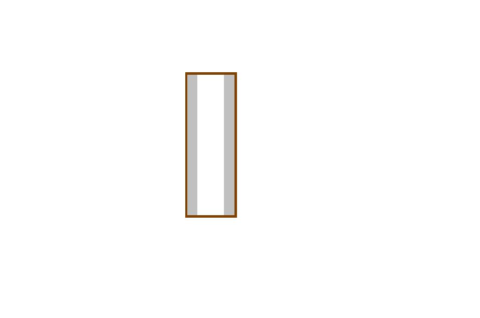

I would try with felt stripes on each side of drivers
On the drivers themselves, or on the frame posts?
I imagine the felt mounted from frame to edge of driver chassis, and just straight up
Think I see what you mean. That could have some effect around the tweeter and maybe be 5" mids, but not the 8" woofers. The 45 mm wide posts would not be acoustically visible for the woofers, since they are much smaller than the wavelength of the highest frequency played by the woofers (500 Hz -> wavelength 680 mm).
