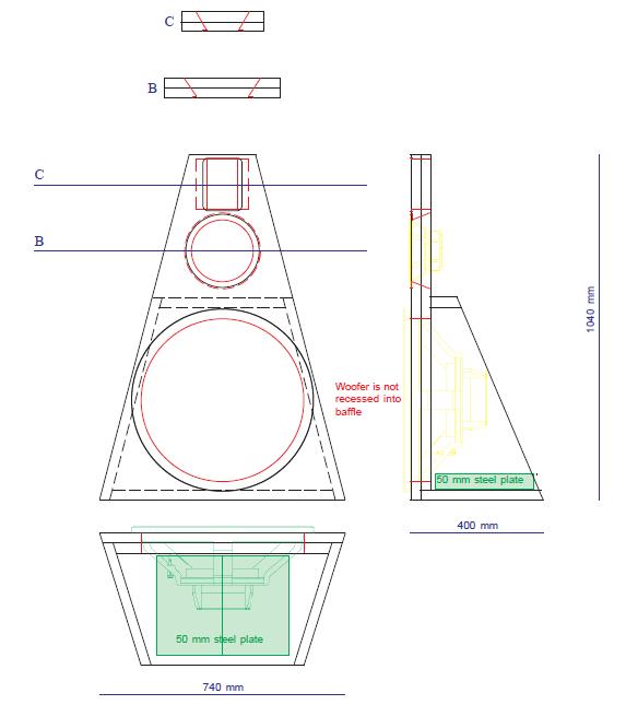

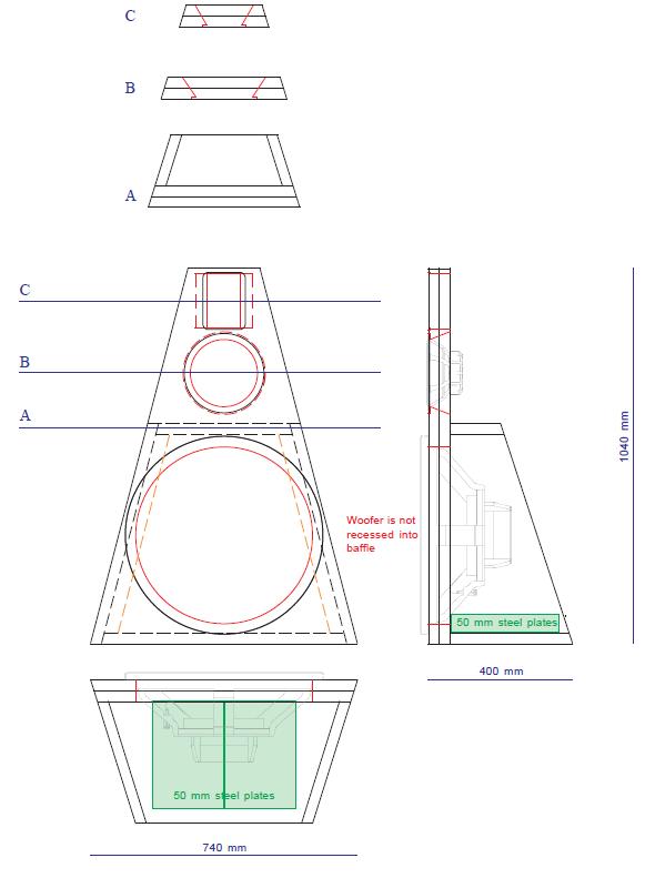

Ok... here's the latest development. I am going to build a new prototype baffle in dual-layer 30 mm MDF, as show in the attached drawing. To increase weight and stability, two 50 mm steel plates are placed at the bottom, adding approx 50 kg of weight.
We will look into adding "Orion-style" wings on the sides, if we can make it look properly.

It may look like an obvious decision to put the steel plates down to the floor. But if you think about it a bit more, the added mass should be positioned as high on the baffle as possible to keep it from rocking. Best compromise would be to integrate the steel into the cross bar above the 21" IMHO.
I´m with Michael regarding the side wings. Better try with some provisional wings, how much is really needed, before building the real thing.

The idea with the steel plates was to avoid rocking of the entire baffle. I use a 25 kg sandbag right now. Without it, the top of the baffle sways as much as 1 cm back and forth when the woofer is working hard. With the sandbag, the movement is greatly reduced. When they load a large tower crane with weight to stabilize it, they to this at the base, not far up in the air.... its the same idea here.
The "wings" are there for two things - stiffen the baffle, and creating a U-frame to increase LF sensitivity. And no - the 18" is far from enough at low frequencies, and we dont expect the 21" to be able to output much SPL below 35 Hz either. The speaker is NOT capable of playing Yello or Kraftwerk at more than background listening levels!

StigErik said:The idea with the steel plates was to avoid rocking of the entire baffle. I use a 25 kg sandbag right now. Without it, the top of the baffle sways as much as 1 cm back and forth when the woofer is working hard. With the sandbag, the movement is greatly reduced. When they load a large tower crane with weight to stabilize it, they to this at the base, not far up in the air.... its the same idea here.
There is a distinct difference between balancing static forces (as for the crane example) and balancing dynamic forces (as for vibrations / rocking / movement).
The aim is different as well as I have tried to outline.
A sandbag *will* help - as will the steel plate in your case – but more efficient with respect to more predictable movement of the upper part of your OB would be the position in between of the woofer and the mid.
Think of the OB as of being a weak part - bending at several modes – than it becomes more clear that you would like to place a "calming" down reaction mass at the point between the drivers.
Stiffening by side wings is good but otherwise it would be better (though not so practical I admit)...
Though – anything goes ...
