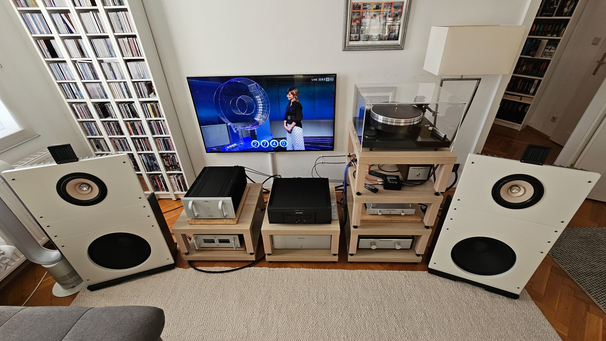

How would you rate your current OB against the Manzanita you recently built?
Regards Richard
Honestly, I can't remember how the Manzie sounds, I haven't used them recently (where recently about 1 year means...). But you've given me an idea, I'll try to do a comparison at the weekend and then report back.

Well, sub... as I wrote I'm really satisfied with the bass, it fills the room (about 35 square meters) without being boomy.
So I don't "need" it, but maybe I'll try it later, just out of couriosity - an active one, strictly without dsp.

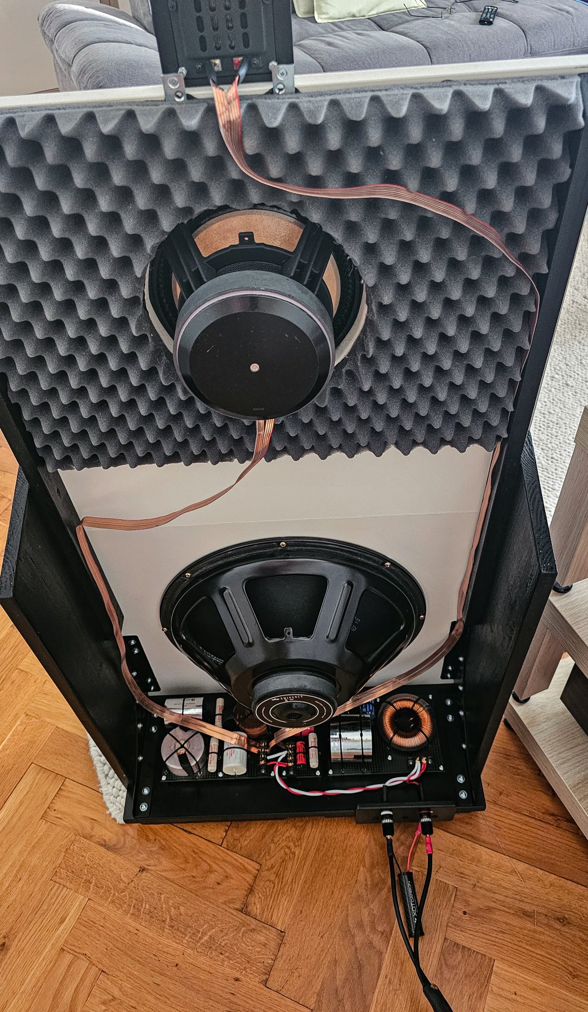

It seems the 2145 might play well as OB. I do have concerns of the GW-1558 rising response towards 200Hz and see that you have a sizeable bump in that particular area. I also see you cut that bump with basic XO changes by 2/3rds. Again, that is inspiring. I don't expect Goldwood to have the most authentic plots, but......

I DO want to use (4) of the 15's for woofer, rather than a pair.

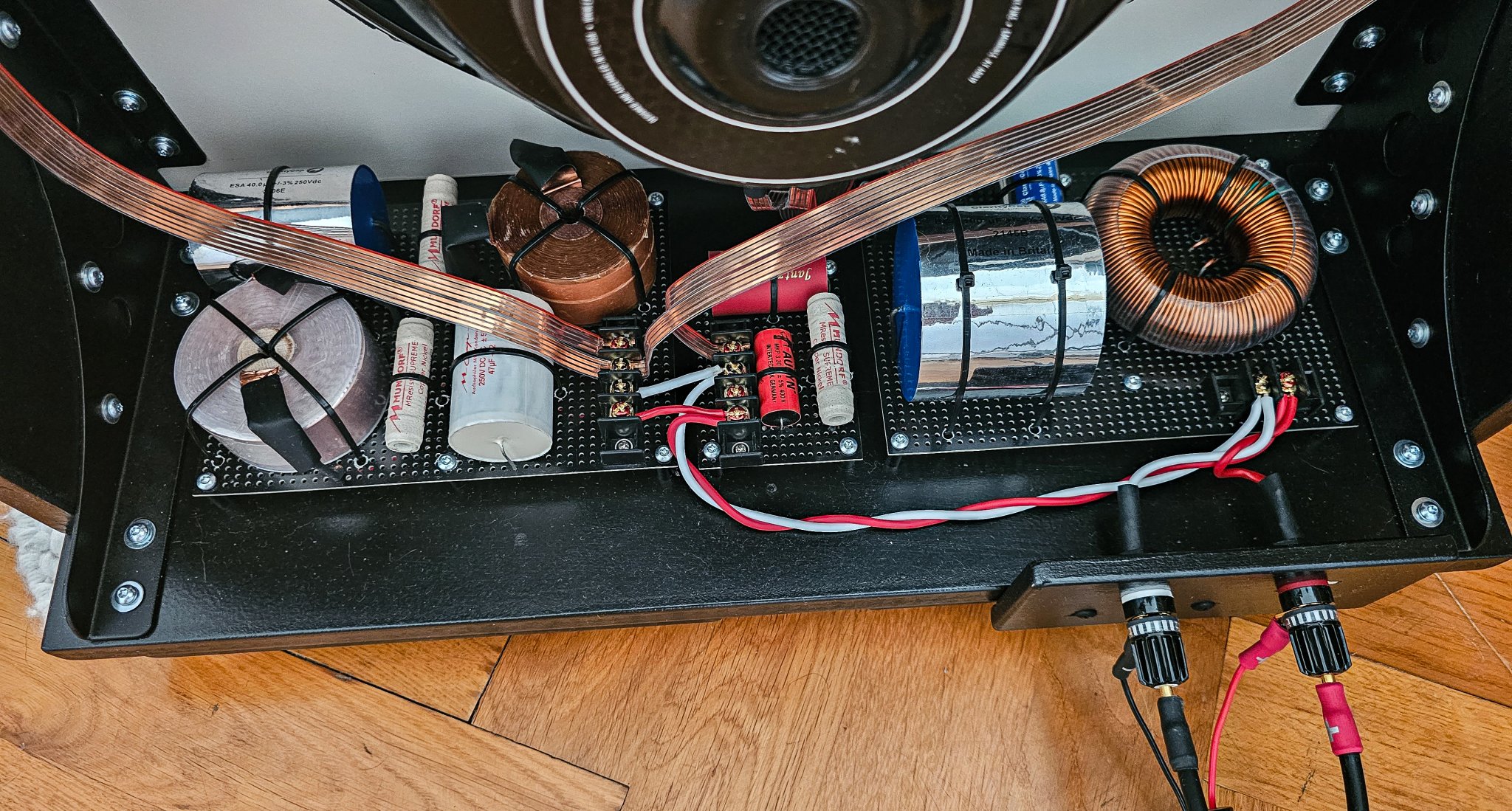

I was hoping that if I had an active XO and bi-amped it might be easier to define the needed passive XO response (ideal not real) and I would be able to have a bit more low cost/time saving flexibility for manipulating real freq Response. Inductor are not cheap! Id ratehr measure twice, cut once sort of speak.

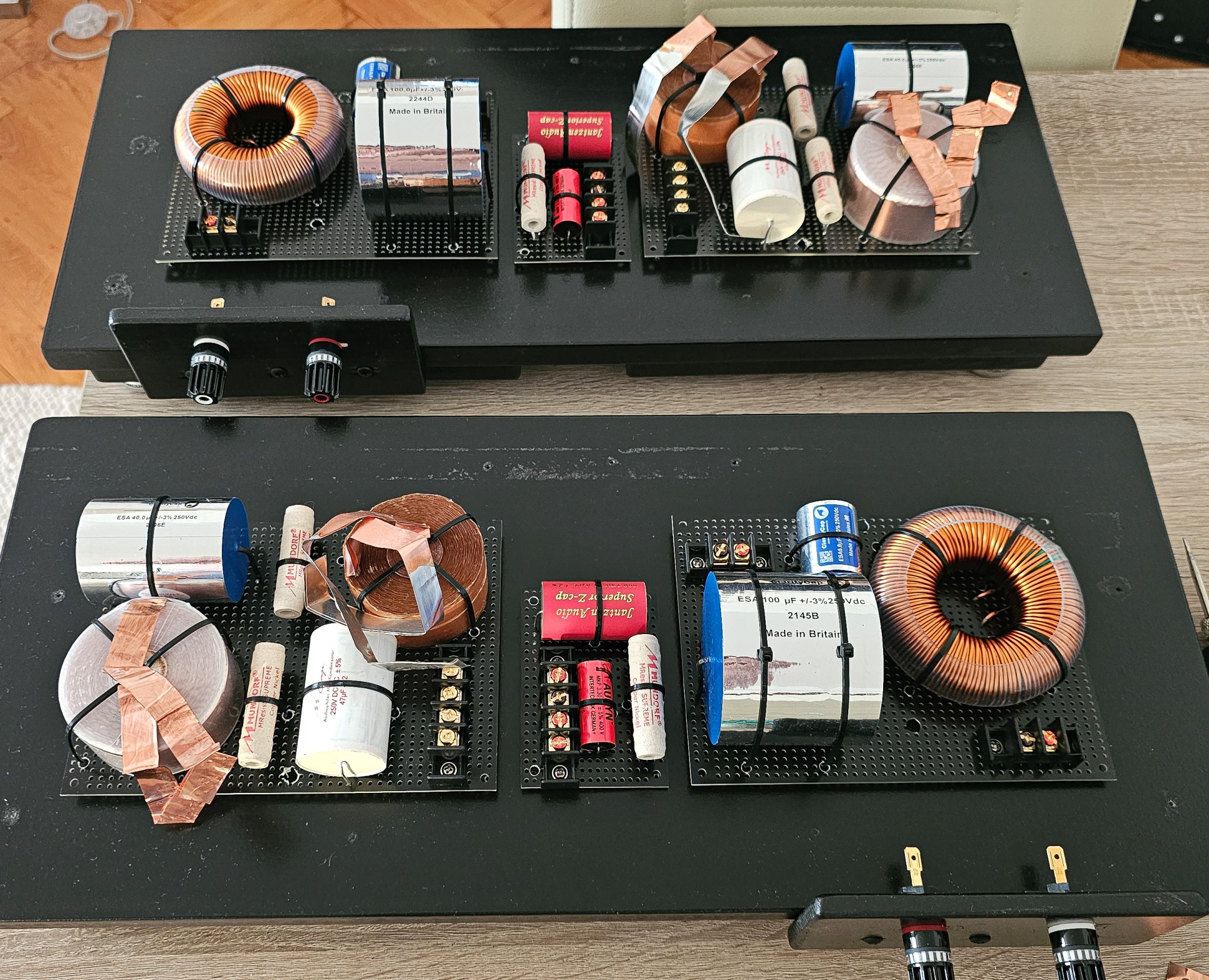

To your project: Don't believe the factory graphs, they are only of limited use. Measure your drivers in your baffle and listening position to see how they behave in reality and then combine this with the original graphs; in fact, after taking my measurements, I simulated 2 xo's in parallel and that's how I came to my result. I wish you good luck with your project!

I hope you decide to post up your final iteration X-over design, which final drivers, and perhaps a little dimensioned drawing of your latest baffle accomplishments?
