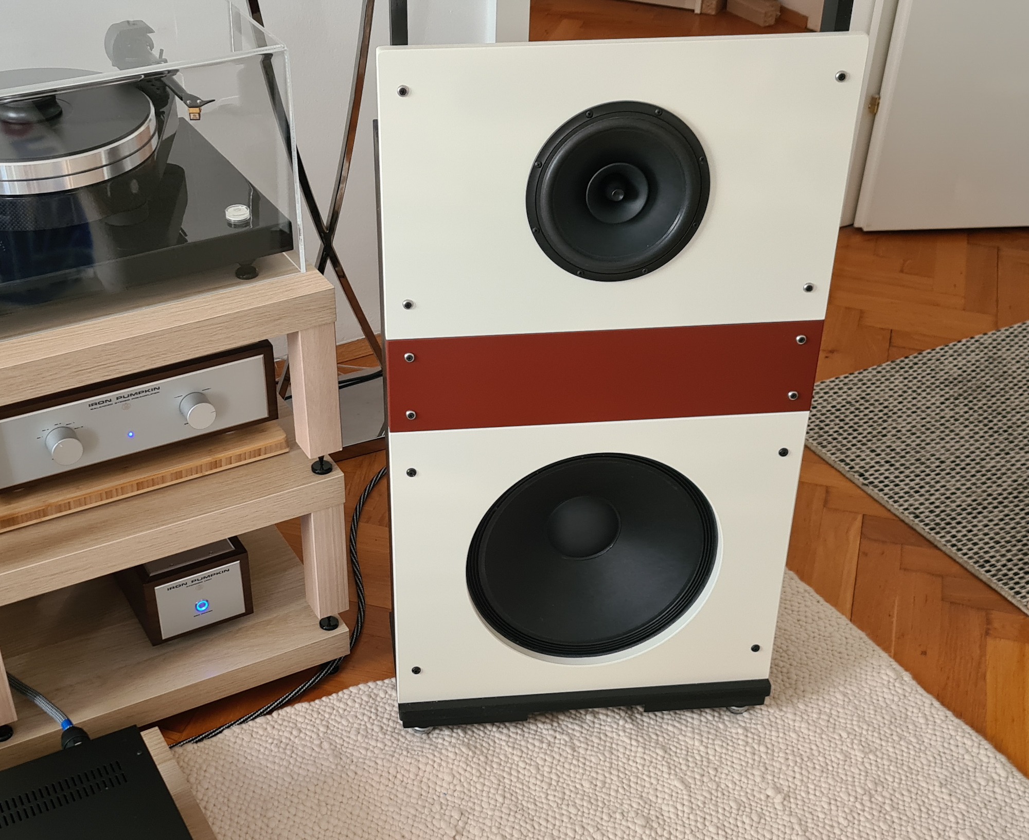

Hi again,
here I have the provisionally final
2-way version with in-phase xo.

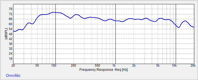

@Scott G , you were right, the previous version sounded really "hot" - not as a first impression, but during long listening sessions. And the measurement has also confirmed this. I've now played with the attenuation of the FR and the result is a lively sound that however isn't tiring or forced. Interesting: I've heard the speaker with both the M2x and Xrk's Warp - and they both require different FR level adjustments. I will still play with the wings and will probably leave it out in the FR area. Regarding the - expected - question about the middle baffle: it is well suited for sound tuning, depending on the distance between the two drivers the sound is more airy or more coherent - I like it more airy.
First measurements show a flat frequency response with some tilt from the left to the right.

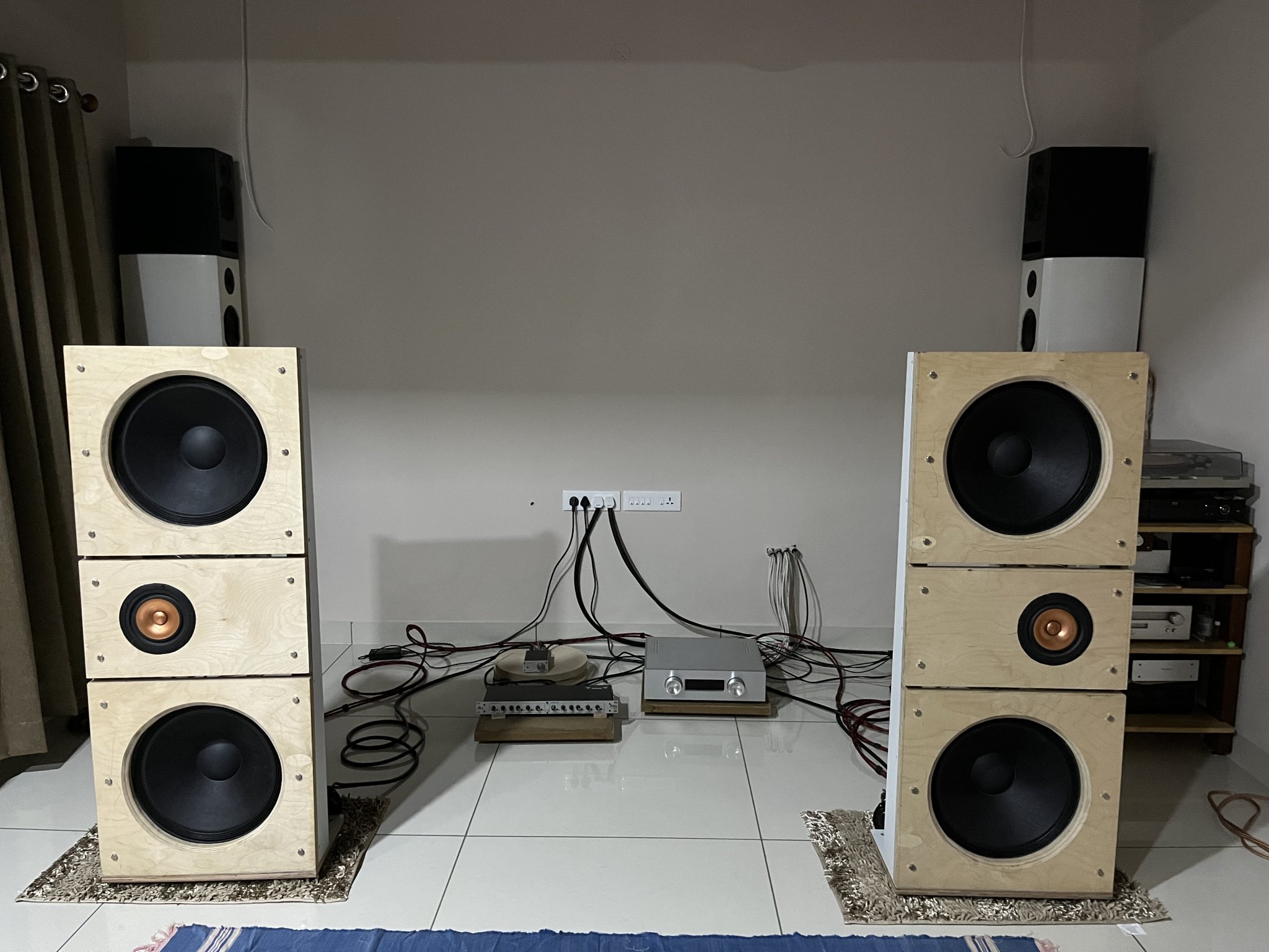

I have been following your thread. And this my 2 cents. I have a 15" Audio Nirvana with 2 x 15" bianco and a Aurum Cantus ribbon tweeter on mine.
OB works best with DSP or at least some sort of active bass boosting circuit. Open baffles roll off after about 100+ Hz, so some form of boosting at the 30 to 50 Hz region will help to equalize it. Bianco is capable of crazy loud bass matching many box speaker if boosted since they are typically less than 8". And the bass is quite clean.
I also have the SB20 FR... I find it a strange animal. When I first played it, wasn't impressed with the sound. Put it away for a month suddenly a major improvement. Maybe it needs time to adjust moisture on the cone.
There are Some drivers you should try, I haven't tried it on my OB yet. But I like the overall sound signature. Faitalpro 3Fe22 or the 4Fe42 I think. Not so much the 4Fe32 unless you have EQ to tame the 8kHz peak. All 91 db sensitivity and plays really loud if there is no bass. And some of those GRS planar speakers found in Part Express. They go very low for ribbons, so worth giving it a shot.

It really depends on your crossover point, width of panel and of course most of all, your taste. If you are happy at 100+ Hz slowly rolling of at 6 db per octave, then, okay... it is really about the backwave shorting the front rather than actual driver. A high qts driver will probably give it more boost until the the Fs of the speaker. But if you are the type who wants flat till 30 Hz, then u would need a boost.

It depends on your measuring distance. The nearer you are the speaker, more nearfield, the more the measurements take the output from the front of driver and is less influenced by the backwave. Also affected by distance to backwall. The further you go away the the backwave becomes more prominent and cancelation increases. The good news is your bass doesn't go to your neighbor's house. So you can play really loud. However room mode comes into play and response goes all over the place. I don't have a good answer how to measure bass response of a open baffle. I think nobody knows for sure yet.
Like I mentioned if YMMV, if you are happy with it, just go with it. I have 2 bianco a side and I put in about 15db of boost. They are driven by a 100W class D. I wanted to be flat as much as possible to 30Hz
Did you measure in stereo or one channel only. I find stereo tends to be more bassy. This due to constructive interference.
There is also the element of expectation. For me this was going to be my main and ultimate speaker not another hifi project. So I was looking for it to do bass like Wilson Audio or one of those big floorstanders. That means frequency response of down to 30 Hz or something to that effect. I could see that yours has a response down to about 50Hz. So that was high expectations. Anyway the Bianco has 1cm worth of X-max.. why not use it. Since I have 2 perside that is a 6db increase in sensitivity. Actually one should be enough, but I was greedy. And the Bianco is relatively cheap.

It was one channel only.
