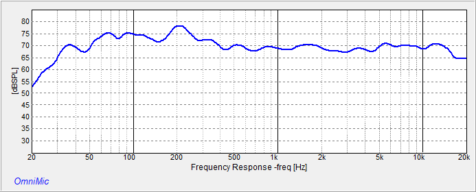

Hi Stan,
many thanks again.
I listen to it now for some hours and it sounds really good. The FR however needs a "brake", I use [3.9 mH II 9 ohms] in order to bring it to civilized behaviour
Here is my OmniMic measurement of the parallel XO, there is no peak at 40 Hz, I think the room eliminates it - just to make a peak at 200 Hz
Otherwise, I like it, the frequency response it slightly tilted to he right. With mounting the woofer to the outside the midrange will be slightly louder, so the response will be even flatter.
The impulse response is... well, could be better, but the room needs to be treated, so it will be better.

That looks very good Istvan.
The 200Hz peak could be some overlap between the drivers, play with xo values to see if it will drop down a bit, but keep an eye on the impedance, that will tell you a lot of stuff.
If you only have a 9 ohm resistor to tame the FR try to create an Lpad with a parallel resistor across the FR and adjust the Rs accordingly to get the best balance.
I think you are getting closer and closer to the final.

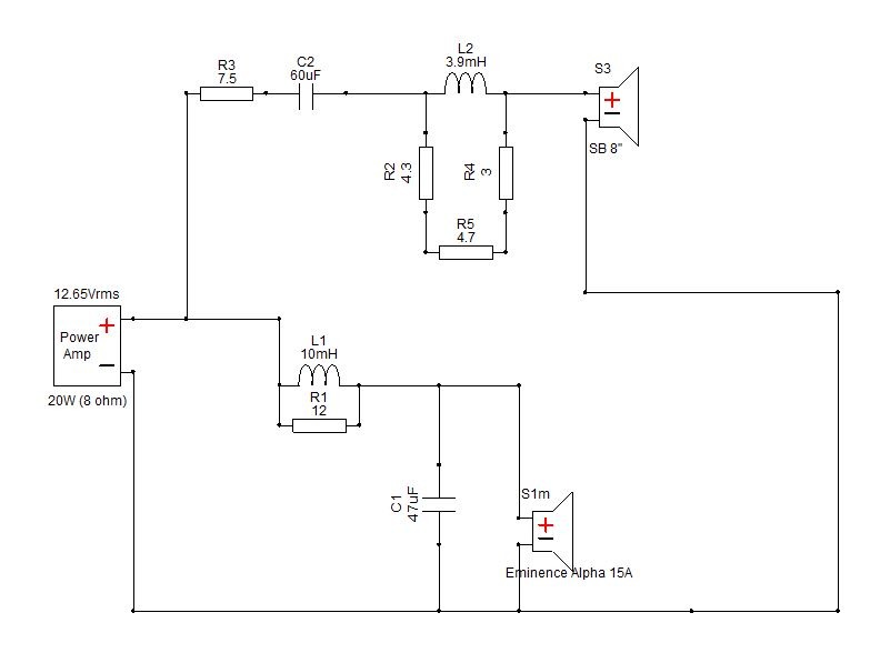

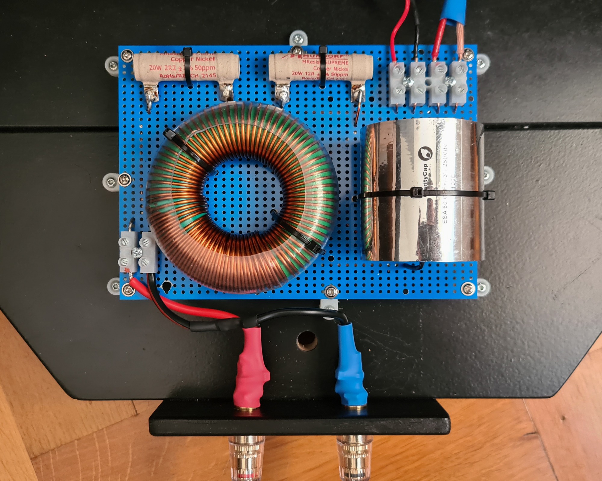

Here´s the XO:
For test purposes I use 3 serial resistors, and now R4 (3 ohms) is shorted, with the full 12 ohms there was no shine in the mids and treble. I could short R2 instead of R4 and go with 7.7 ohms, but I think it´s the absolute minimum, and I fear the mids/treble will be harsh. But it´s easy to try.
Maybe I will play with R3 too, I can imagine to decrease it to 5.1 ohms in order to make the whole mid/treble louder (about 1.5 dB), this causes no significant change in the impedance, and adjust the R in the Lpad again.

Edit: and the same goes for the serial XO
Here´s the XO:
