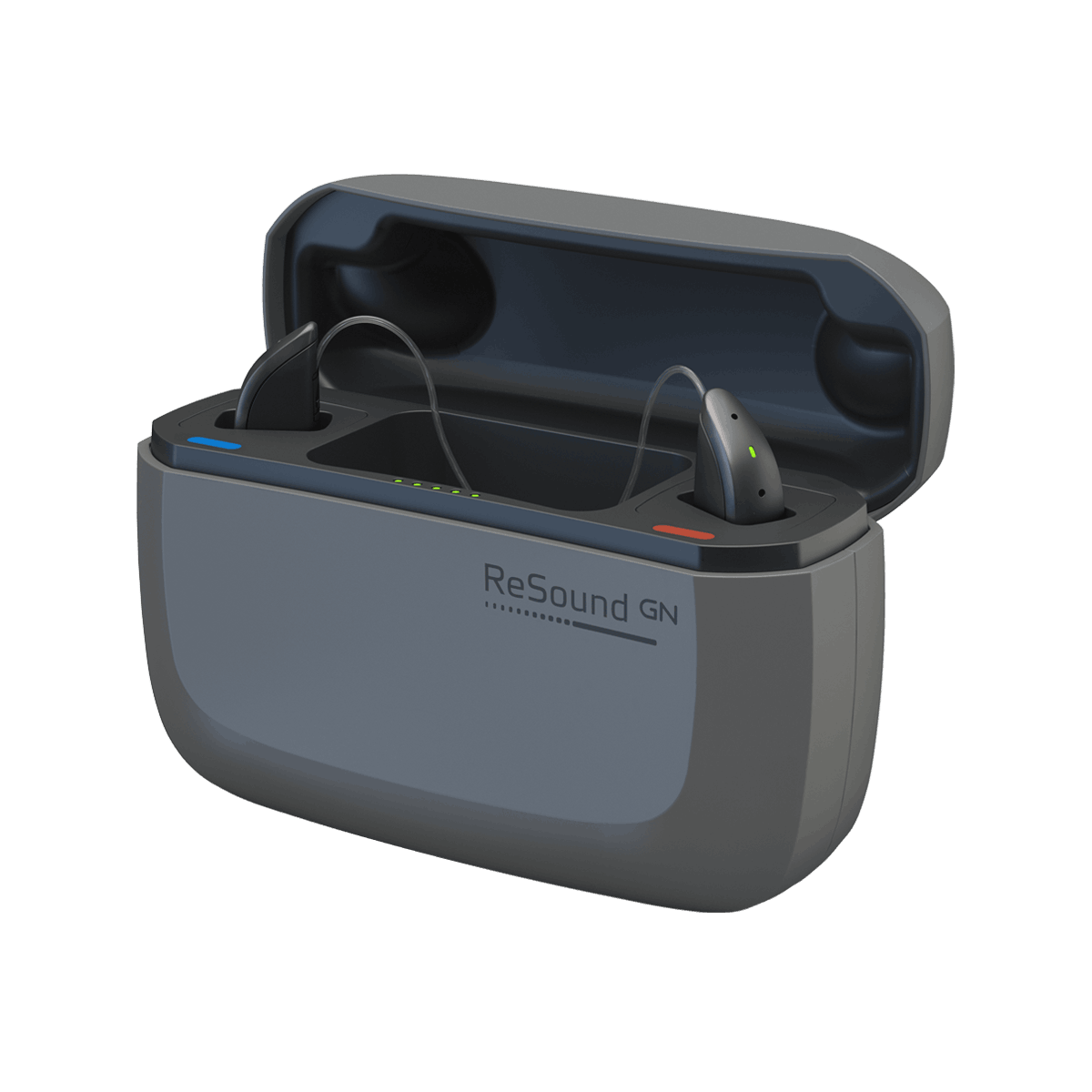

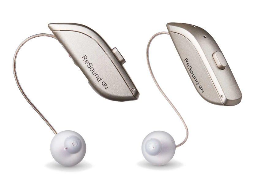

I can't offer any useful advice on your current sound system but I can guarantee that this will be the sound system of your near future:
They come with a convenient charging case and the fidelity isn't too bad...
not like healthy working ears but yours seem destined for a pair of these. I've had them for about a year and they're the best I have tried so far. Based on what you must have spent on your current system I think the price will be well within your comfort zone!
How much for this marvel ? Do you need a pro for the set up ?
I have the good fortune of having a wonderful niece who is an audiologist, if you don't I think they are in the $4K-$5K neighborhood.
