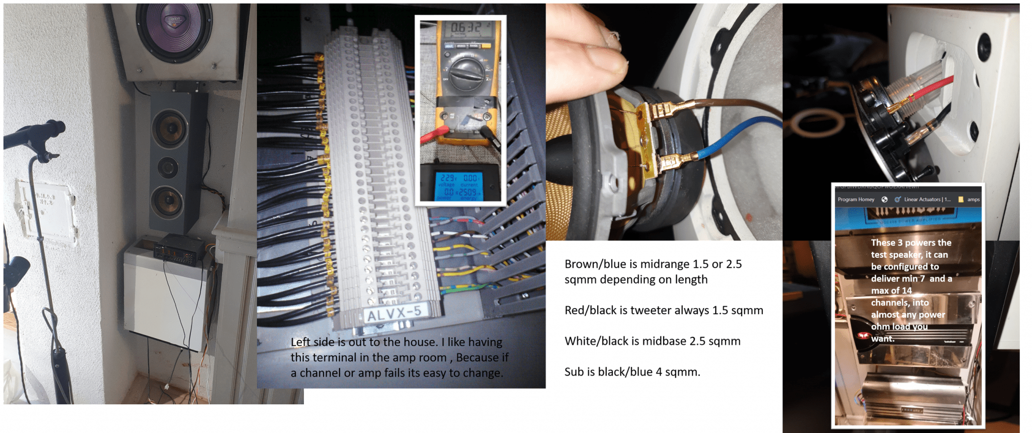

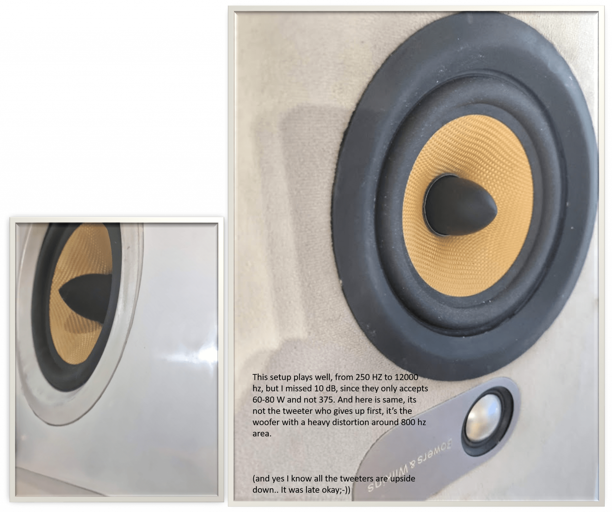

My Tweeters and Midrange keeps burning up and its expensive
Okay so B&W make excellent quality drivers and the same basic approach is used in their lower range models compared to their top line. Some things change, such as magnet material, cone material, basket design etc, so cosmetically they look very different, but in terms of build quality and performance? They are all using similar sized voice coils, built on similar former materials, with similar epoxies and motor/pole geometries.
You can see Goran's measurements from a basic B&W driver at audioexcite. This has class leading harmonic distortion and all basic design featues you'd expect to see on top of the line drive units.
There's nothing inherently wrong with the B&W drivers what's wrong is that you chose the wrong ones.
The midranges that you're using are of course actually mid/bass drivers with low sensitivity. If you'd gone for the neodymium version of the midrange from the 800 series, and crossed them with a steep filter at 400Hz, especially in an MTM, I think your mid range drivers would be fine. They aren't pro drivers but they do have very high sensitivity for hifi drivers. 95+dB. This is as close to pro as you'll get without actually being pro.
The tweeters are another matter entirely. If you're using a dome tweeter you absolutely need a high sensitivity design, like a Bliesma 95dB dome, and it will need to be in a waveguide. This will push the sensitivity up to 100dB around the crossover point, which is usually the region where a tweeter will be handing the most power. Or just put a compression driver in the waveguide and be done with it.
When you were testing your tweeters for SPL and they blew I'm not surprised. You were most likely doing this with sine waves. Dome tweeter voice coils only handle 5-20 watts of continuous power. Where they get their power ratings is because they are rated using noise stimuli and bandwidth limited. A sine wave signal, attempting to push 120+dB out of a dome tweeter, will fry it in seconds. Music peaks of 120dB in the treble are a different matter entirely due to the transient nature of music and the general downward slope of high frequency energy present in music.
Testing power handling of a voice coil, with it hung in free air, is not particularly useful. When the voice coil is in the speaker it is situated very close to the metal within the magnetic gap. This metal wicks the heat out of the voice coil and provides significant cooling. Slowly the metal and magnet heats up. If you're running high power then several things can happen.
First you completely overload the voice coil beyond the ability of the motor to wick the heat away and the driver fails within seconds to a minute. This is what happened to your tweeters when you were SPL testing them.
Second you're driving the system hard but not like the above. The voice coils start getting hot but the motor metal is able to wick the heat away to prevent immediate over heating. As time goes on the metal starts to heat up but due to its thermal mass this takes a while. As the metal starts getting hotter the voice coils also start running hotter and after listening for a while the voice coils get too hot and the drivers fail.
Neodymium drivers fail faster than ferrite ones in the second scenario because they have much less thermal mass.
Drivers that are designed for very high power handling usually have heat sinks to cool the motor metal/magnets and often employ air channels within the motor to force air the speaker moves, during operation, through the channels to improve cooling. Hifi drivers don't tend to come with any of these unless they have tiny neo magnets.
At a minimum you need to use the high sensitivity B&W FST drivers if you want to keep using hifi drivers. And you need to get the tweeters into a waveguide. Preferably use a hifi tweeter with big ferrite magnets to increase the thermal mass and perhaps strap heatsinks to it. The Morel ET338 springs to mind. Although no 25mm dome tweeter has power handling beyond a few tens of watts on anything except very short transients.
Still I'd use a proper pro midrange + compression driver to guarantee anything. The mid is going to be bandwidth limited by it's very design. Don't expect it to go below 400-500Hz if you're using a 6-7" device. It needs to be 95-100dB.

This is just excellent info!!! (Things I was not aware of.. so several "ah ha.. of course, now it make sense") but basically it made me understand why my current design failed and how to prevent it in MkII. I really appreciate that you took the time to make this post. Ref the Morels great yes, but is it enough? Maybe its safest for look for a compression driver /horn in one unit? Something like Visaton TL 16 H but with half the resonance frequency, meant for 2500Hz instead of 6000.
What is your crossover? minidsp? can it do limit/compress?
What ever this speaker need, my current middrives works fine to 5k/96 dB/oct or higher slope, but I need high spl. No (but could as just be): I use APO equalizer to test and it allows for absolutely everything in 8 channels just by writing small script like : Filter 1: ON PK Fc 50 Hz Gain -3.0 dB Q 10.00 and when done with all corrections, you can leave it like that but I like to create the filter in rephase/rew using my measurements of the impulse response, then I use APO or FOOBAR to process the convolution wave format filter. I have done this a long time but not including corrections in the time domain, only frequency, so this is a process of learning at the moment. Yes I can limit and compress and use any plug in from recording equiåment

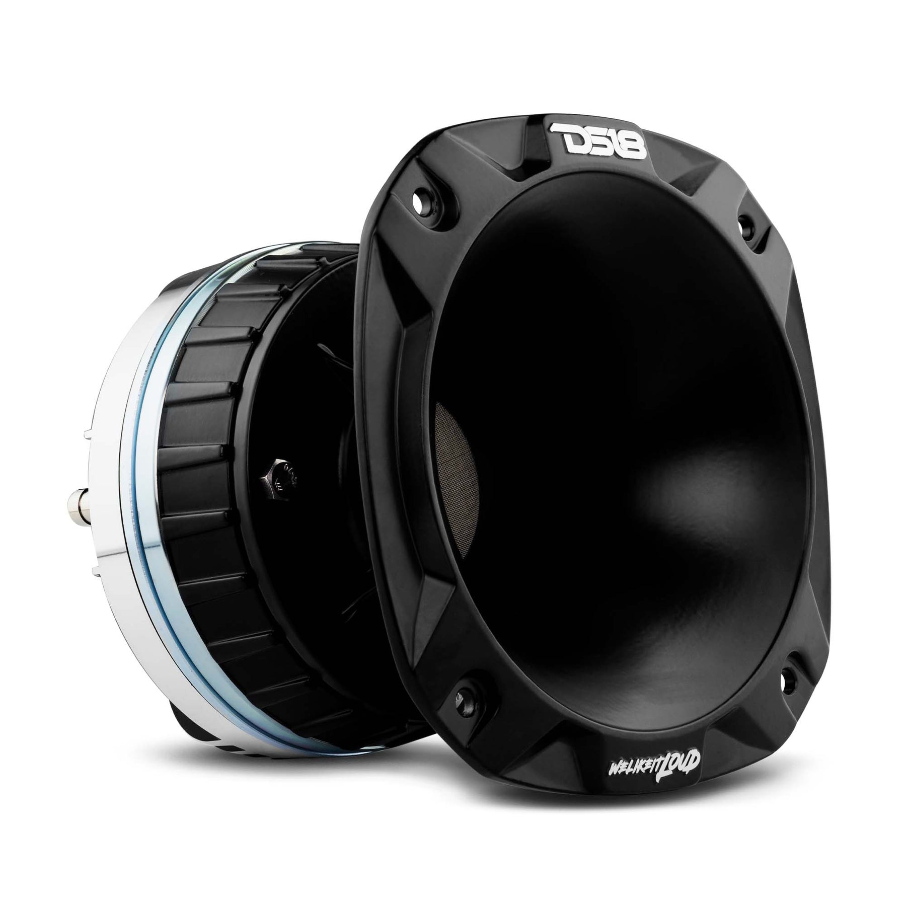

No. No. No.
Do you have any clue what a bullet tweeter is about? And you actually can acquire decent CD (compression drivers) with decent CD (Constant Directivity) horns for about the same as a pair of ‘decent’ (mid to high range) ordinary dome tweeters. If you only ask, a wealth of suggestions is coming your way. Try it.

The big advantage of a separate driver and horn is that one can tune things. Look for the directivity pattern. In home applications you would often pick a rather wide angle, like 90 degrees horizontal and 40 to 70 vertical. You also need to consider the low and high cutoff frequencies and in your case I’d pick a range from 1,5kHz upwards.
After that decide on the driver. Another advantage here: you can experiment. Start with proven combo’s or cheap drivers and see if they fit the bill. Almost all compression drivers from serious brands (B&C, BMS, FaitalPro, 18sound, to name a few) are serviceable or are cheap to replace. There is a reason for that of course.
Mounting drivers on horns is the least of your worries (for now). They either screw on or bolt on. With metal horns the driver mostly doesn’t have to be supported, good ABS or other plastic horns likewise.
Bottom line: start with the horn ;)
