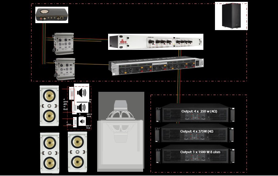

Below is a overview of the first version,when the line drivers and crossovers was placed in Livingroom for adjustments and I did not have midbass. And yes due to active crossovers and the need for different eq curves and also then amps, for all 4 speaker location, there is a lot of wires. I marked some cables wrong, and then it was a nightmare to fault find. But not sure I would call it a hodge podge (had to google that one)
And one comment.. yes I made some miscalculations and had some holes in my driver knowledge, and it could have been done cheaper if planned much better from day 1. But the system, as it plays now, is truly impressive. I have made more sophisticated stereo systems that played better for one person sitting in the correct spot with sound treatments at 1 reflection and so on.. But to be able to play this loud, from a almost completely invisible or hidden system, in all rooms except hallway and sleeping rooms, makes even experienced hifi and sound enthusiasts walking around in the house trying to figure out where the speakers are and how I did it

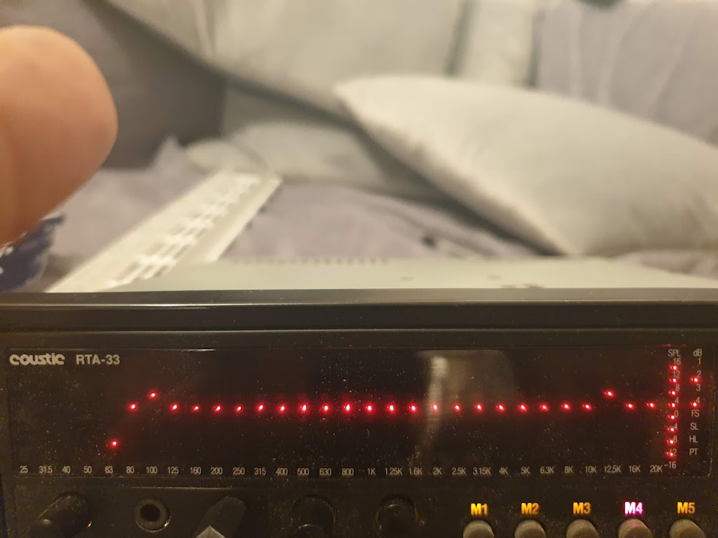

So it has a high "wow" factor for sure. Just have a look at the subwoofer output linearity (design goal was 28-70 hz) and the signal shaping (flancks) in this video, its in Norwegian but the sweep (25-100 hz) is played from 0:45 seconds and at 0:47 til 1 min 5 sec, it gets the job done, but below and above design frequency its almost silence due to brickwall filter design.
The drivers are cheap Kickers at 100 Euro each for the 15" sub and less for the 12" midsbases mounted under the sofas. I made my own modules to the couch, which are hidden midbass. The ASUS soundcard played good, but had only 8 channels and only 4 dBV output, now I use a semi professional interface with balanced or regular output on all 10 (+2 headphone dacs) channels at 18dBV

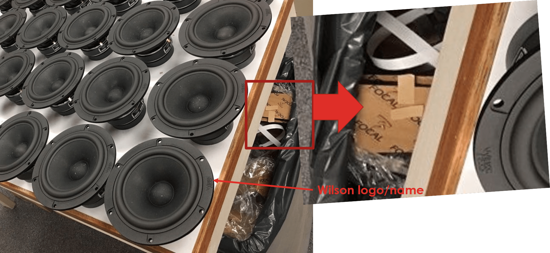

Hello Billshurv & Nashbrd, Yes positive, as the americans say. A quick Google search will tell you, so no need for a long post from me. I left the audio industry about 15 years ago, but even back then the amount of speaker manufacturer who made all their own drivers was rapidly decreasing. I have not investigated this, but based on statistics, which tells that also during the last decade, there has been a significant rise of Asian companies doing all sorts of OEM manufacturing for others. If not already happened, it will not be long before in house manufacturing of drivers is lower in numbers , also for the big well known brands incl high end markets than the amount of own produced drivers.I repeat, are you SURE. Take a look at the proper hairy chested B&W speakers say the 804. Completely different midrange and bass units. People spending €11,000 a pair for speakers expect something a bit different and it would be business suicide to offer a driver from the bottom of the range in top of the range.
What surprises me , after reading some posts here and other websites, is that there seems to be lot of people with opinions like OEM drivers are of lesser quality then a driver made by the "cabinet and crossover maker".. actually I would have thought of it opposite, that a true technology driven driver manufacturer would be better? When you evaluate a speaker, you are by default evaluating the totals, meaning the performance of the cabinet, crossover design and its components and drivers working together, and not one of the drivers.
But this is far outside the post, so I will end it by naming some examples. One of the famous one are when the super high quality brand Wilson Audio, was proudly presenting their new driver line up, and a journalist(?) took this picture: ( I added the magnified part of the trashbin full with Focal paper boxes on the right)
Luckily their reply was the only one which made sense and good enough for this to become a "no news" story, it was also the truth. They replied something like " Wilson Audio is proud of having (some of) our drivers manufactured by Focal, a highly regarded specialist company in the field of audio. Together we have almost 100 years of experience and product development.." or something very similar. Others from the top of my head, Seas are OEM manufacturer for Sonus Faber, Dali, ZTX, Tandberg and many more.. To my knowledge either Vifa/Peerless or Scanspeak have manufactured own speakers with commercial success, Klipch used to buy horns and drivers from Hepneer before they bought their supplier. You might even never heard of one of the largest in the world, Fink Audio, designing complete loudspeaker designs for Tannoy, Mission, Volkswagen/ Audi , Q Acoustics, Naim, and some Mordaunt Short models. Some claim that Totem Audio makes better speaker with Dynaudio drivers than Dynaudio.. Kef makes speaker for Apples Iphone and Polk makes the Google home speaker.. And often you will hear "made after our specifications" a term that is used on everything from different color but also a small change like foam vs rubber suspension. Focal stamps Wilson on the basket, that is a "made after our specs" in the marketing world. I will stop there. But this makes sense, and is good for the consumer, developing new products are expensive, so when B&W, JBL or Harmon Kardon spends millions on developing a speaker, you can be pretty certain they re use in as many applications as possible. Will not touch upon Sony and Clarion Car Audio, since they both are former employers, but you can probably imagine how proud we where at Clarion when they bought US based McIntosh. I use amplifiers with powerguard from both Clarion and McIntosh in my system still. The mac has been running since iy was given to me in 1998, never broken down. But the same is true for a couple of Rockford Fosgate, A/D/S and Cadence amps, still running flawlessly with more than 100000 hours in "ON" state. Amazing build quality.

If you are positive then you will have no problem giving some examples of top of the line speakers from a company that use same drive units as bottom of the line.
BTW I've known Wilson Audio use Focal drivers since about 1987 as the Watt Series 1 used them. no 'news' there at all and never a secret (read any review of wilson speakers other than the WAMM).

According to your posted pictures, you're using 12 - 15 cm mid drivers with 25mm VCs (System was designed using the 2x G17REX or G17RE from 80Hz and up, in each speaker, it had super specs when I bought them (in 1995), with a 39mm voicecoil, p-p conetravel of 20 mm, Power handling max/avar.cont. was 250/100 W). running from 200 on up, which will maybe cope with 50-75 watts each for longer peri
Thanks lots of good points and you are probably correct on most of it and I agree with all. I summed it up like this somewhere:
a) I have had too much faith in high-end/good quality hifi drivers ability to dispatch all that heat, created by excessive power.
b) I have not paid attention to excursion limits and sensitivity when choosing drivers vs SPl.
Luckily only a) needs real fixing, I think that I can accept 120 dB as a overall max spl, the last 10 seems to demand too much work in midrange area. The B&W woofer was chosen because of its almost flawless reproduction of 200-2000 hz, good looks and decent power handling. Now I just need to find something similar capable of 6-9 db more power.
brg Simen
ods of time until power compression takes over and the volume goes down. That will happen at about 105 dB (I measured spl of one pair to approx 100 dB given 15W each and close to 115-117 given 500W) sheet says 88.5 dB SPL 1W,1M) I use a limiter but not compressor, should I?) , drop within about 30 min or so from that level to about 100 dB. I would at least add a midbass to make this a 4 way system to distribute the power more away from the smaller mids. 200 Hz mid crossover point is reasonable for a small 3 way in an average home audio setting, but not for those volume levels with that small, of a driver, VC and that output level. The tweeter crossover of 2.5k is also too low for that small of a VC at those levels. /Yes 2 of them are made 4 ways so far, the other will come. And since at my 12 pc of G17R 6.5" are now dead, after nearly 27 years of use!! I changed to the B&W for mid)
The typical 25mm dome can only handle 15 to 20 watts over a longer period of time before burning up. Realistically speaking, it will do roughly 103 dB for a while until it gives up... maybe a little longer if it has ferrofluid, but not by much. You need ro raise the crossover point to about 3.5k and use a steeper HP slope along with a limiter and maybe a poly switch for safe measure. (Crossovers are what ever you like, but some limitations in the GUI for APO, but not in the program, and it accepts plug ins and convolution filters. Originally tweeter settings for the Seas was 3500 with 24 db/oct slopes, this was changed to 2500 with 196 dB slopes, because it made the crossover function much better no bumps, .there was some good suggestion for better suited tweeters earlier. )
Those kevlar B&Ws are tough mids. They use good materials in the VC and have very high temp capable windings. They won't defy the laws of physics though if you cross them too low and play them too loud for too long. They can handle about 100 watts each for a while above 400hz, maybe for an hour or two, but again here power compression becomes an issue. The rule here is simple. If you hear any distortion, you're abusing the driver and the rest is obvious. (and that was exactly what happened, I was missing 6-9 db midrange, and turned the gain up too much on the amp, accepting some distortion, feeding the speaker too much power.
The VC diameter has alot to do with thermal power handling. Thats why pro drivers have larger diameter coils with better venting. Midbass drivers have a very large concentration of power to deal with and very little VC movement (unlike a sub driver), so the coil relies mainly on convection and heat radiation into the motor and basket to shed heat. A subwoofer has alot of VC excursion at higher power levels which help direct alot of air around the VC and cool it effectively. (for tweeters I use 2x Fs as a rule of thumb, but added almost an octav to that here. . Seas promises short term power handling at 200W when using min 2500hz 12 dB/oct). I will try 400, but to me that sound very high, but used to cas audio. Thanks again for you help brg Simen

I have posted that I probably can do SPL max measurements , if somebody please tells me how!!!, or where I can find it?. But I tried just using " common sense" and no weighting, mic set up and placement is very easy to see in the picture or videos. I am used to making room measurements, not nearfield speaker measurement But answer is 80 cm for mid/twee and 150 cm for sub??? I guessed on a really close distance so you would measure the speaker and not also the room. But should i measure max?, a sinus? a burst? a sweep? how long do I need to play the test? which distortion is okay? I do not know these, and can therefore not produce a correct measurements. Any help here is very appreciated, thanksOne things for sure - your dB SPL ideas, aspirations and estimations are .... wrong. And silly. And amateurish.
