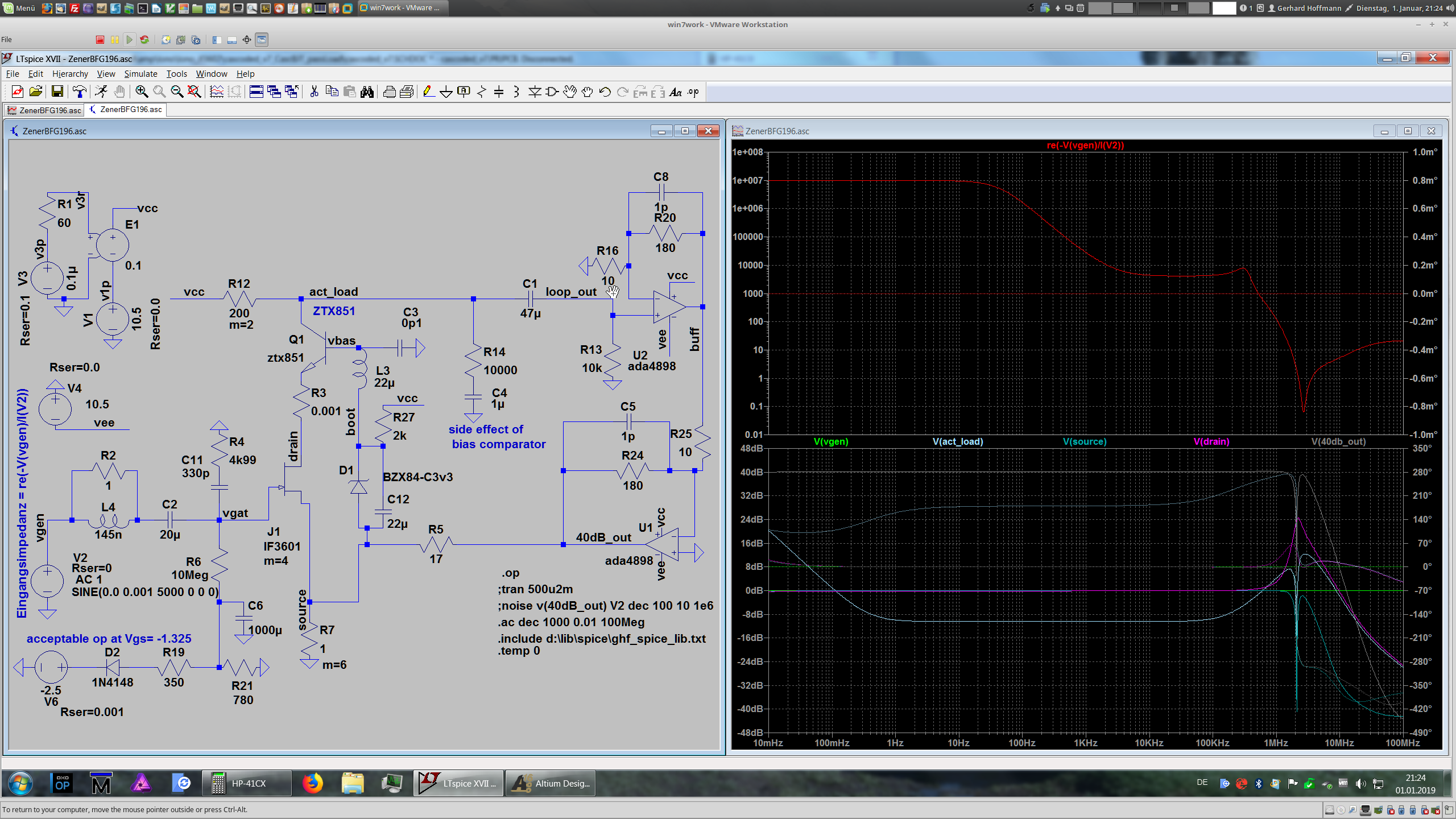

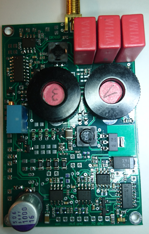

I have made a respin of the IF3602 amplifier with bipolar cascode.
The cascode is bootstrapped to effectively remove Cgd.
Cgs is taken care of by the usual feedback to the source.
It is somehow funny that gate, source and drain voltage wiggle in unison.
But the signal out of the FET is a current into the cascode emitter, so
this is not a show stopper.
My problem is that I really want at least 1 MHz bandwidth for my
phase noise measurements. Slightly above 1 MHz the bootstrapping
collapses and that results in a notch above the passband.
The inductor in the base of the cascode is essential. It must not be
anything lossy, both parallel and serial Rs make the input impedance
of the amplifier go negative somewhere.
I dropped the bias servo. The amplifiers input capacitor must be much
bigger for noise reasons than for BW. That creates an unneeded lower
corner frequency. The bias servo would have to be even slower than this
or it would interact with the amplifier.
So I went for a fixed gate bias. Between 0 and 60°C the drain current would
double. I did not like that and implemented some temp compensation consisting
of -2.5V from a TL431 and a BAV99 diode. That does the correction to the
first order, as far as simulation goes.
In the simulation, you can see that the generator voltage, source and drain
are the same in value and phase up to at least 700 KHz.
The top red line in the simulation is the input impedance. The phase would
jump from 0 to 180° if the impedance would turn negative.
That is not hard to accomplish. Part values interact quite heavily.
In the top left corner of the board there is also a JFET buffer from DC with
very little gain. I need that to measure the sensitivity of my phase comparator.
There is also a transmission gate to lower the 10Meg bias resistor to speed up
finding the operation point when we are far off. The window comparator is
at the bottom right.
Noise density is < 160 pV/rtHz over most of the frequency range.
Drain current is 55 mA for the 4 FETs together. The coolers are there
only to provide thermal mass.

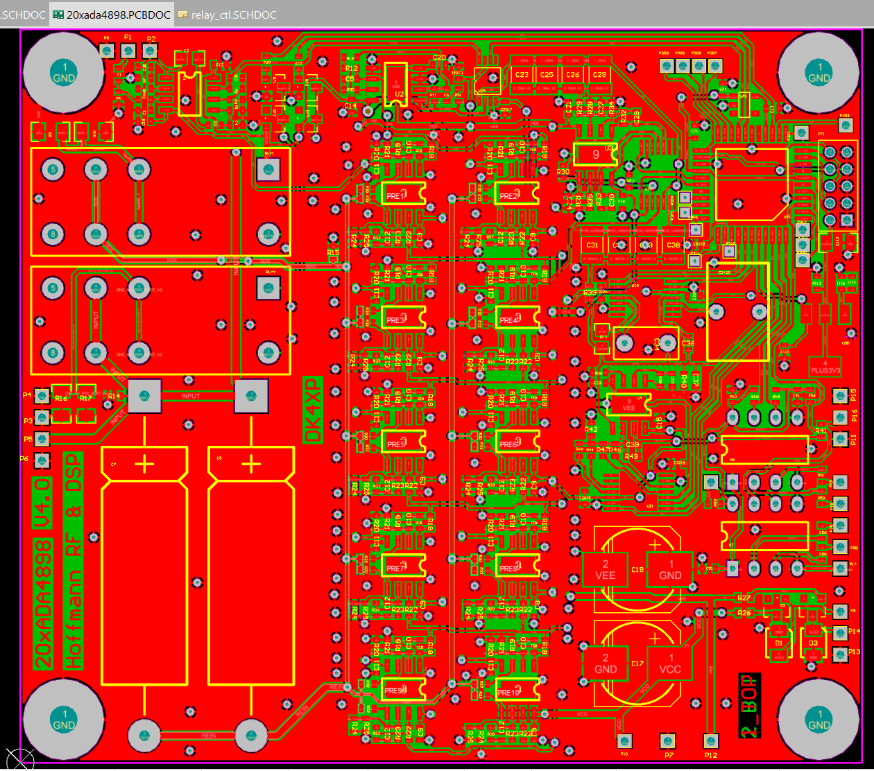

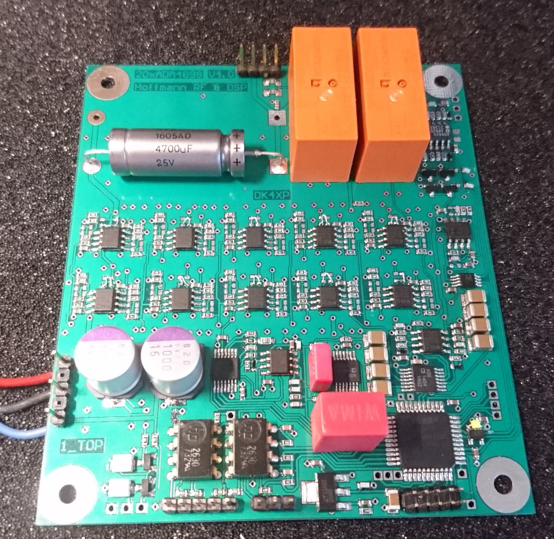

I have also made a new version of my 20xADA4898 preamp. It has now
the wet slug tantalum on the board and some protection circuits with
relays. On the op amp side, the stress is divided over 20 shoulders,
but with the patched old version, I managed to vaporize a LED whose
noise I wanted to measure.
Closing & opening the relays requires some discipline, best handled by
a computer. Gain and bandwidth can now be cold switched by transmission
gates. The small CPLD implements an SPI receiver and decodes the
control lines for the relays and analog switches. There are opto couplers
for the SPI interface. It is also possible to use mechanical switches instead
of SPI.

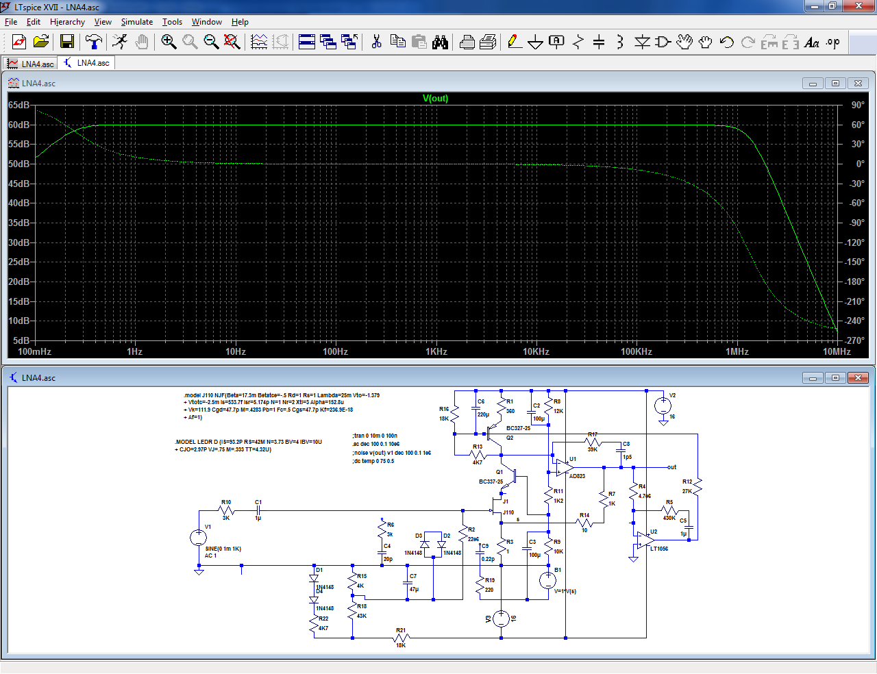

Funnily enough, the fix I have found and that seems to work is exactly opposite: reverse-boostrapping the cascode transistor: it neutralizes the Cgs capacitance by the equal Cgd.
It works in spice, but real world could be different due to phase-shift of a real opamp. And with my circuit, I will need one more opamp, because I don't have an inverting output available, but since it only exist in sim at the present time, it doesn't matter much

Thank you for this. What is the capacitor C12 parallel to D1 good for ?
I have no idea how the Zener behaves at RF. And since even small resistors in series
to the base inductor have a bad influence on the stability, I included it as a forward defense.
A much smaller value does not seem to make a difference.
I'm just beginning to test the amplifier. It is not yet proved in any way.

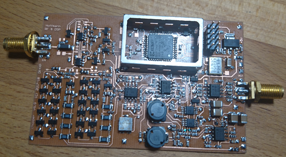

This summer, I have also built the preamp proposal from Horowitz/Hill,
Art Of Electronics V3.
< DSC_0467 | Gerhard Hoffmann | Flickr >
plus pics to the left/right.
It really does the 70 pV/rt Hz, but input impedance is quite low.
I only built the single sided half with 16 transistors, the differential
version with 64 transistors for the same noise would not help me
to avoid the input capacitors when the signal source is not centered
around 0V.
That was a test balloon for my chopper with SMD versions of the transistors;
there the coupling caps are not much of a problem because of the higher
chopping frequency.

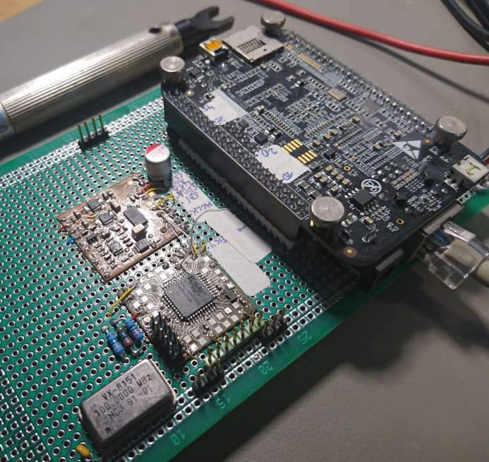

I have a LTC2500-32 coupled to the PRU of a Beaglebone Black, and the PRU
talks to the BBB's ARM CPU, and the ARM talks to my laptop over LAN. I also could
install FFTW on the ARM; that was easy since the ARM runs standard Debian Linux.
It is not much more than "apt-get install fftw."
There is not much self-invented to it, it is more of a software problem. The PRU is
a 200 MHz RISC without pipelining and thus with predictable timing, there is a
C compiler for it but the programs run somewhere deep in the guts of that TI system chip.
But you can toggle port bits at a 5nsec rate.
It is hard to talk to it until one has understood the shared buffers to the ARM and one
knows what variable ends up where etc. It did not help that they did a major operating
system cleanup at this time and most help from the internet was outdated.
The interface to user land is easy. Just open port 5025 on 192.168.178.66
and dump GPIB-like commands or read the time series in ASCII.
No secret USB drivers or things like that.
I could build there on a previous project. It is like talking to the 89441A.
The stamp sized board in the back is the LTC2500-32 ADC.
it has 2 LTC3042 regulators and a negative one for the supplies,
a LT6655 reference and a fully differential input buffer like proposed
in the data sheet.
The stamp with the CPLD collects some random logic and converts the
100 MHz SPI to parallel bytes. (required for the full 1 Msps at "32" bits.)

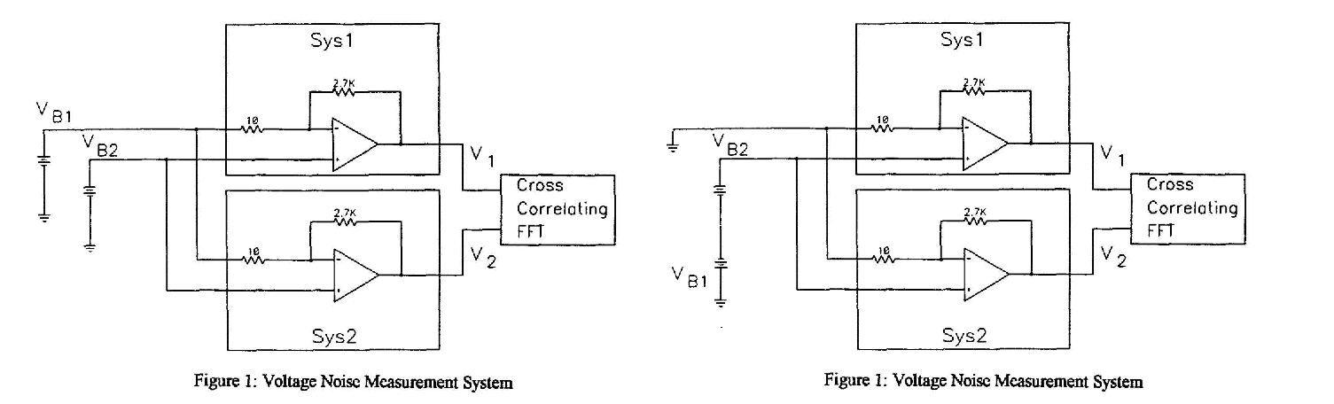

Am I missing something by rearranging the NIST battery noise test as shown?
I would assume an expected common mode output of 0 is a good thing.
Did YOU photoshop the alternative circuit? I can't see it in the original paper.
I think they are equivalent and that the common mode of 0 is nice to have.
