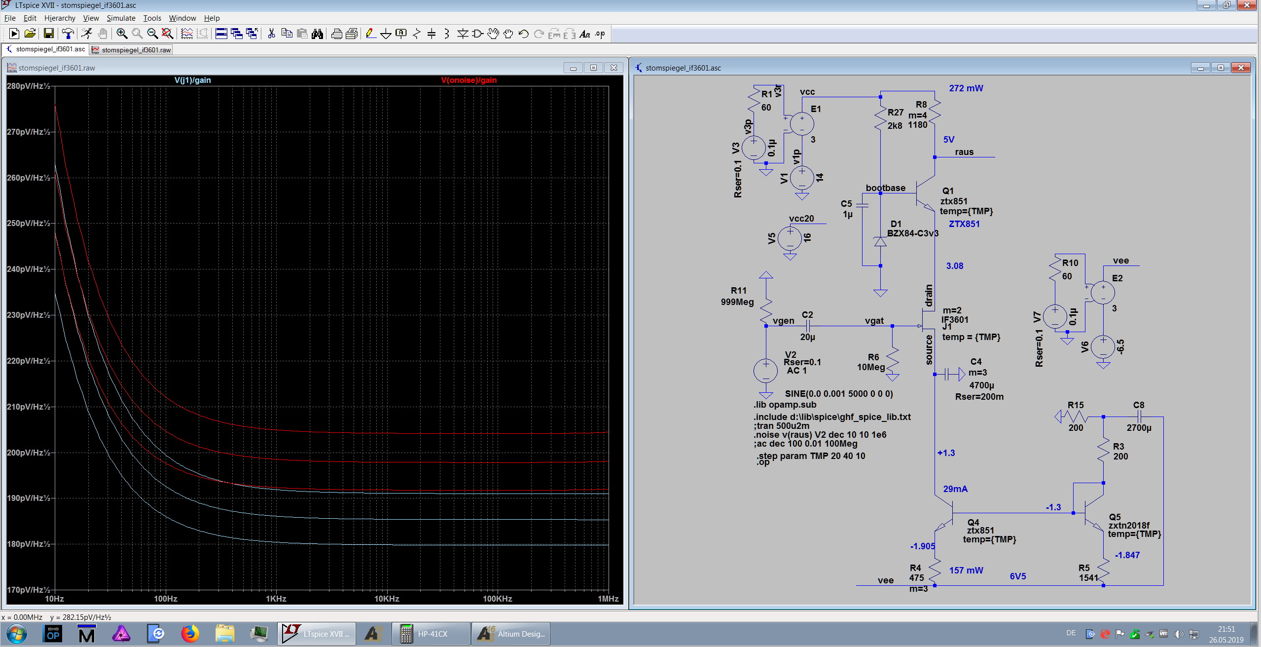

I have made a new amplifier based on FETs. With the standard architecture I had continuously stability problems. That is: common source FET, cascode, active or passive load, opamp for loopgain and feedback via divider into the source, which makes the FET no more common source at all.
Somewhat frustrated I simulated some other published amplifiers that claimed to be stable, but plotting real part of (Zin = input voltage/input current) revealed negative input impedance around 100 KHz. Tinkering with gate inductors and ferrite beads just moved the unstable region around but it did not remove it.
Remember that if it does not oscillate in a certain setup, that does not mean it is stable.
I found no way short of slowing everything down or killing the low noise property. But I want 1 MHz BW at least and no noise, as far as it gets.
I sacrificed the feedback. The signals to be measured are very small, so distortion is not a problem. But now evertyhing is temperature dependent and I cannot use an active load because the gain then is not well-defined. ---> less gain, less PSSR.

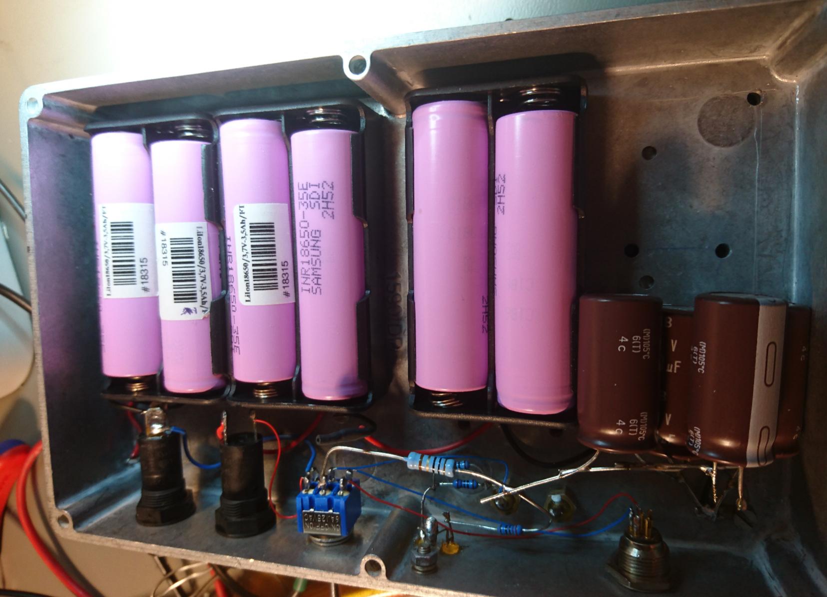

Now I have a fixed load resistor. PSSR is less of a problem since I use Lithium batteries anyway and 4 cells deliver +16V, just so enough for enough gain. Nevertheless, 10 Ohms
and 20000 uF reduce the injected noise from the battery a little bit.

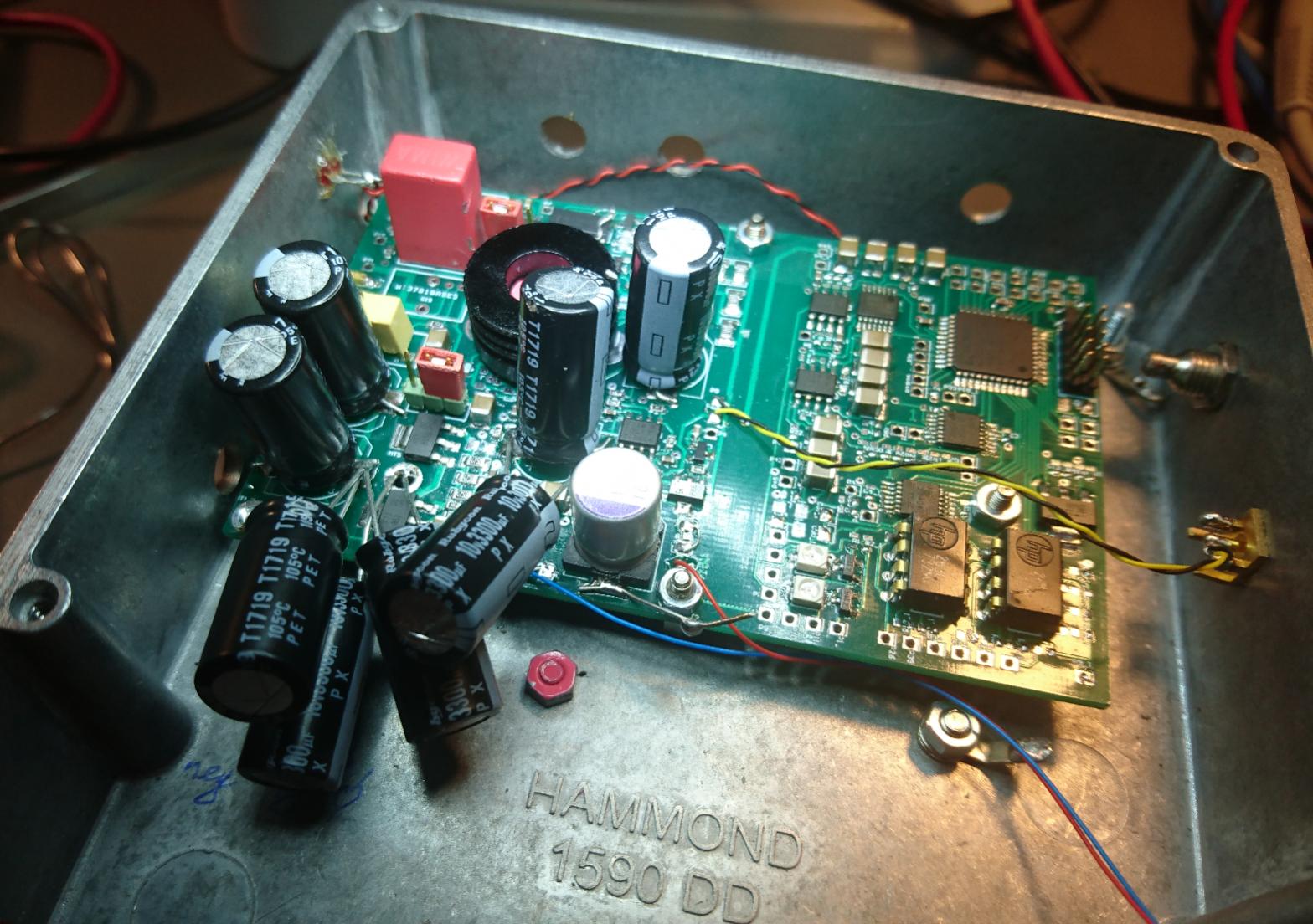

For fixed gain, I need to keep the drain current constant. I do that with a simple current mirror. It is heavily degenerated with many VTs. That brings the next ugly thing: the source must be decoupled for low frequencies, too. High frequencies are cheap.
DC at the source is only a few 100 mV. I used 3 pcs. 4700uF / 2V6 in addition to the RF stuff. That was BAD. Digikey 493-4582-1-nd Nichicon.

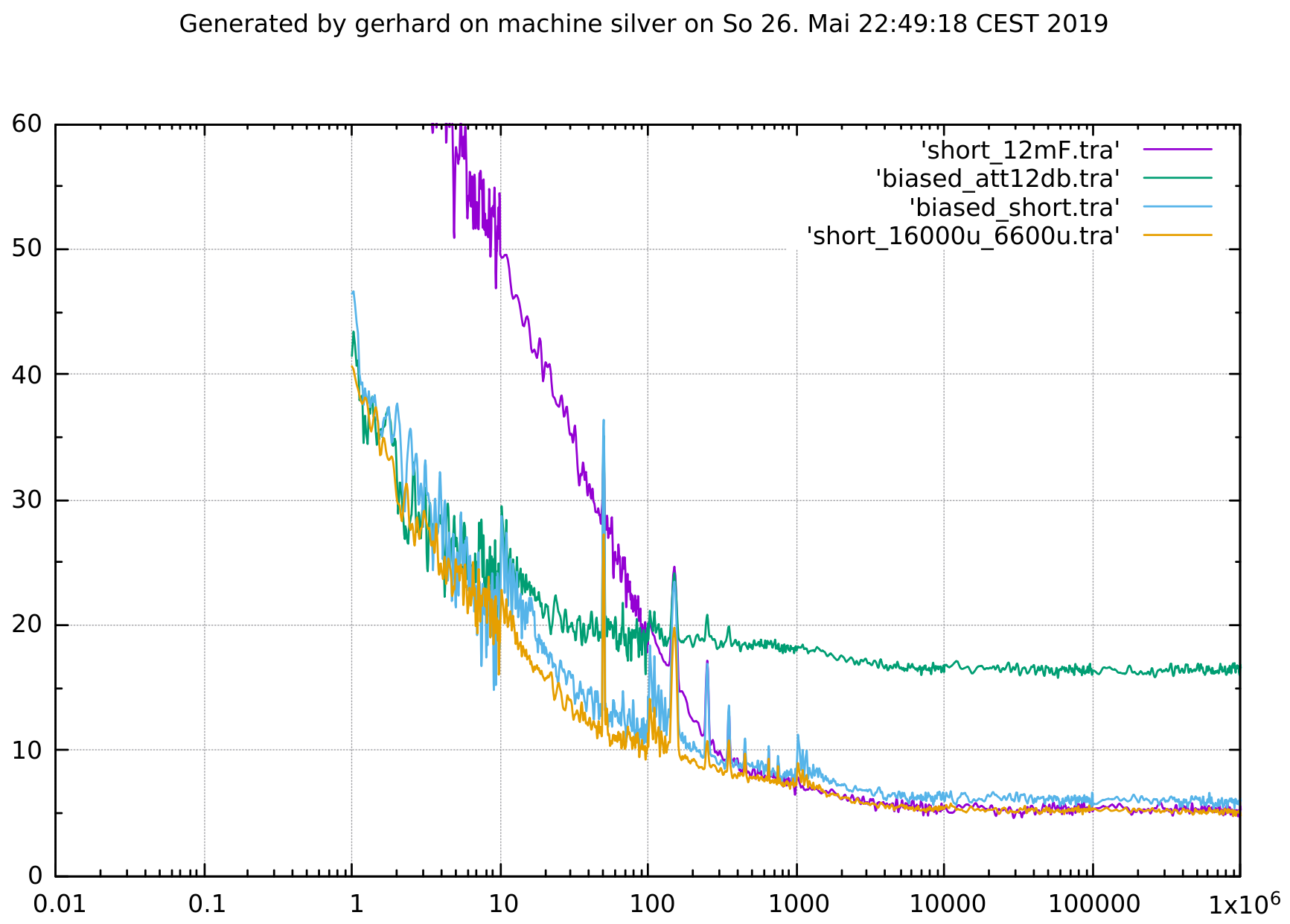

It brought the purple measurement: 1/f corner at 800 Hz, rise 30 dB/decade. That's not 1/f !!11!! And it is not in the simulation. It took some work to exclude the possible causes one by one.
Using 5*3300uF/10V for the source and 2*3300uF for the reference current decoupling healed that. (Rubycon 105° probably not organic polymer). I can reconfigure the amplifier with jumpers to -650mV to the gate and GND to the source. That really helped debugging.
The result is 250-300 pV/rt Hz for 1 IF3602 pair at 29 mA.
Not breathtaking, 300pV is typ. for a single transistor at 5 mA according to the "data sheet".
Probably I'll use only 1 FET; this amplifier is intended for 2 channels and cross correlation.
That's easier in the end.
Alternatively I could use up to 16 BF862 or similar, but will test that on the next board revision only. I have a LT3094 to stabilize the Vee because that sets the drain current.
The decal was 25% too small. Soldering that was an adventure with this thermal pad in the middle.
Gain vs. temperature is about 0.8 dB for 10°C. If that turns out to annoy, I'll stabilize the temperature at 35°C. The Controller for that is done already, at least in Spice.
short_12mF = input shorted, source = 3*4700uF 2V5 (purple)
biased_att12dB = gate bias -666mV, source at GND, a 12 dB attenuator with the other side open looks like 60 Ohm, i.e. 1nV/rt Hz thermal.
biased_short = gate bias -666mV, input ac-shorted
short_16000u_6600u = 5*3300uF at the source, 2*3300uF for bias string
I have no idea where this rise just above 10, 100 and 100 Hz comes from. Maybe a programming error of mine.
Does anyone know how to model the noisy leakage of the electrolytics?
Wet tantalum 4700u/25 was not better than the 10V ALU.
