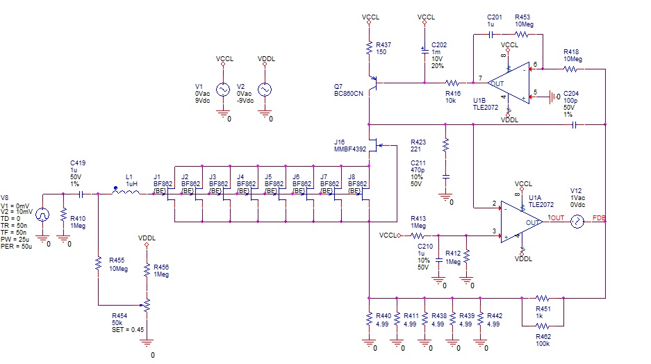

I think the circuit is very clever--- my complements to the designer. I do see one minor concerning issue in the schematic posted in #570: I believe the U1B stage is susceptible to local oscillation because R453/R418 and the opamp input capacitance will present a low frequency pole (~4 kHz) and very poor damping of this stage. I believe 10pF shunting R453 would be an easy remedy.
At low frequencies, R418 and C201 (and of course the opamp) form the integrator you alluded to earlier; integrator gain drops with increasing frequency until C201 reactance equals R543's 10M; at this "corner frequency" (~0.032Hz), the opamp gain becomes flat with increasing frequency.
At this same corner frequency, low-pass filter R416 and C202 begin to attenuate increasing frequencies. The net result is that between R418 input and Q7 base, the gain drops smoothly at 6dB/octave--- an integrator! Said in fancy talk, the C201/R543 "zero" cancels the C202/R416 "pole."

Without R453 the response will badly overshoot at low frequencies, it can even motorboat. R453 creates a zero in the servo loop gain (at low frequency) which exactly compensates/cancels the extra pole.
A more interesting question is why is the extra pole at the servo output required? Since a resistor at the servo output is needed (to provide the current source base current), and the opamp has it's own noise, the combined noise would be injected in the current source and amplified at the second gain stage input. C202 makes sure this noise source is bypassed.
For those concerned about the pole resulting by 10Meg and the U1B input capacitance, a back of envelope calculation (or Spice simulation) shows it is of no concern. Assume 10pF with 10Meg renders a pole (zero in the servo feedback loop) at 1.6KHz. That's way over the LP servo bandwidth (between 1-2Hz), at 1.6KHz the servo loop gain is already 0dB, so the effect of this pole can safely be ignored. Experimentally, there's no observed effect.
