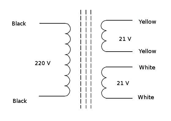

But how to find out which end goes to AC and which to NAC? Advice is needed, please!
Don't worry it will work in either way, it's AC and each secondary have his diode bridge.
Let's say yellow AC1, NAC1 and white AC2, NAC2.

Start from basics, disconnect transformers and check that secondaries outputs 24V (in reality you shoud measure around 26V)
Thanks a lot! This being an audiophile amp with oriented resistors, I suspected nuances could be present

Are you measuring AC or DC? 23,5 looks too much like 35 V DC measured in AC mode. Just in case.
So 35 on 10000uf caps , then what can be wrong ?
Fine so main PS is OK, then measure voltage on C102/C202 pads, it should be +14.6V and -14.6V

Yes, it is 14.6 ..just a bit off that value.
I powered off that board for now. I LM317 might be overheating now, it was very hot then I touched it.
So both values are around 14.6 plus and minus, LM317s are hot, is normal.
DC offset, how it measure? Relay clicks normally?
Pardon, but what is dc offset ?
It is DC voltage you measure on amp's output.
It should be as low as possible, less than 7-8 mV is optimal.
Relay clicked on and off few times, lm317 was so hot I almost burned my finger.
So you have relay chatter... so assuming that other transistors (BC546) are still good you could have DC on output.
To measure DC offset bypassing DC protection circuitry you can measure it on OUT (red probe) and PGND (black probe).
If you'll measure high DC offset probably the LM318 is gone and you'll have to replace it, otherwise the amp is fine and you should replace ALL DC protection transistors.
