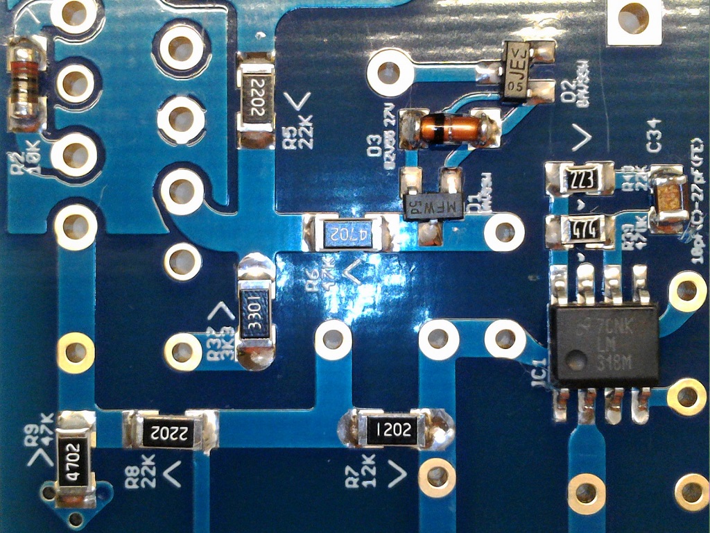

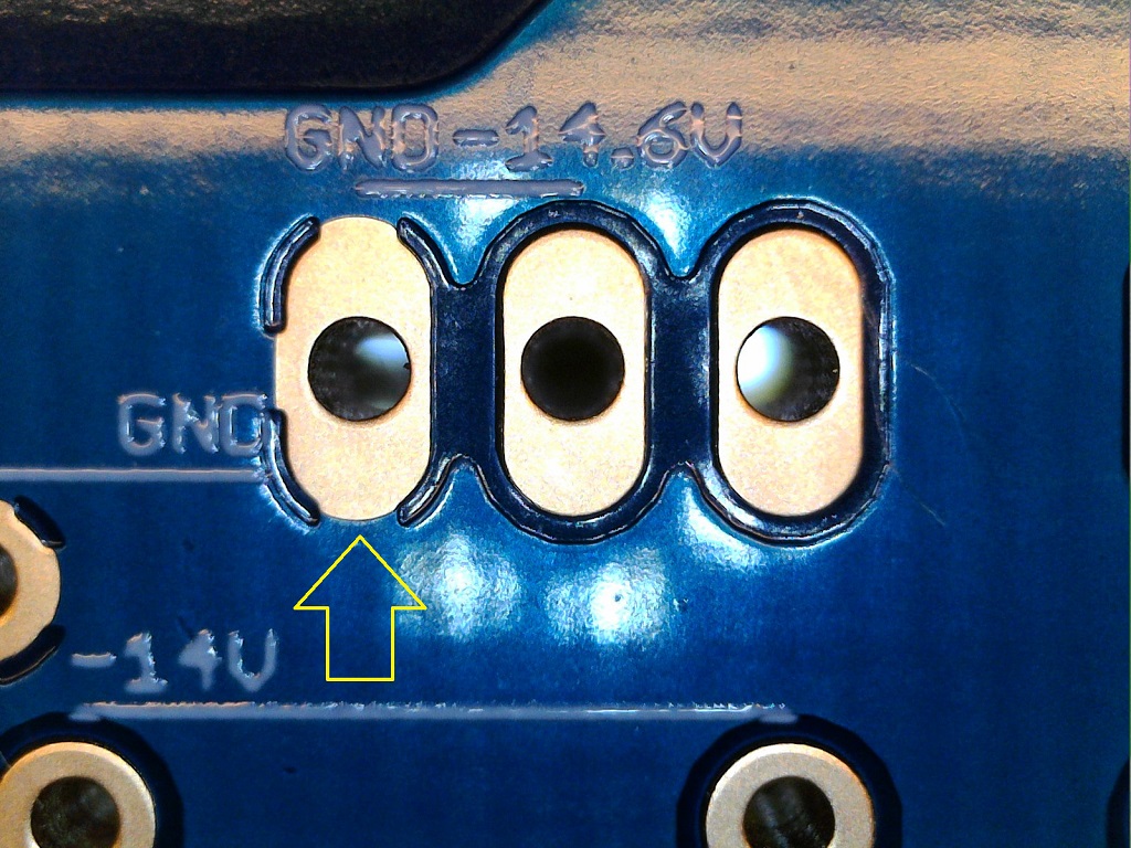

Hi Giacinto,
a pad in italian, in this context, is a 'piazzola'.
When you have a pad on a copper pour, as a ground plane, soldering to it is pretty difficult because you have to apply a big amount of heat since the pour acts as a heatsink.
A solution is to remove a bit of copper around the pad so that heat conductivity between pad and pour is lower.
This is a thermal (relief) pad.

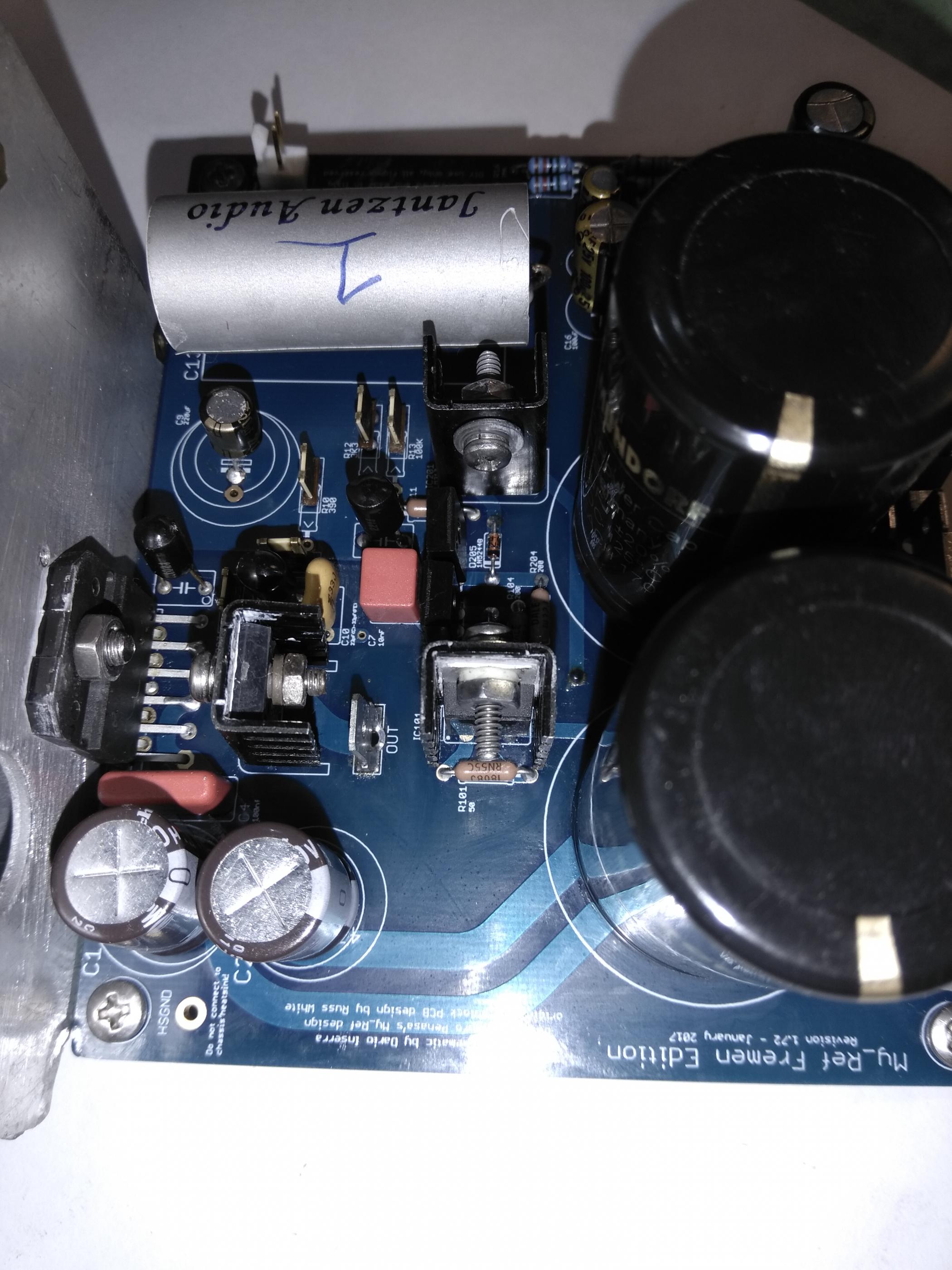

Fresh build and DC offset
I finished my build yesterday and after the first power on, the relay closed, but the board number 1 showed a DC offset around 90mV with input shorted, that didn't look right.. AC with input shorted was around 0.1 mV, which I think is OK. Given time, the DC values were going down, slowly but steadily.
For comparison, I removed board 1 and hooked up the board number 2 and it measured 8mV DC, but the AC readings were jumping up to 1mV occasionally. Which also wasn't right. I measured the reference voltages on both boards as depicted on the PCB and I think there were no big differences.
I'm only using a single 2x24VAC transformer, when measurements were taken, only a single board was connected at a time. The test points showed

I do not have one hooked up to measure. Less than 10 me should be fine. The output relay will open up if it sees either dc or other faults.

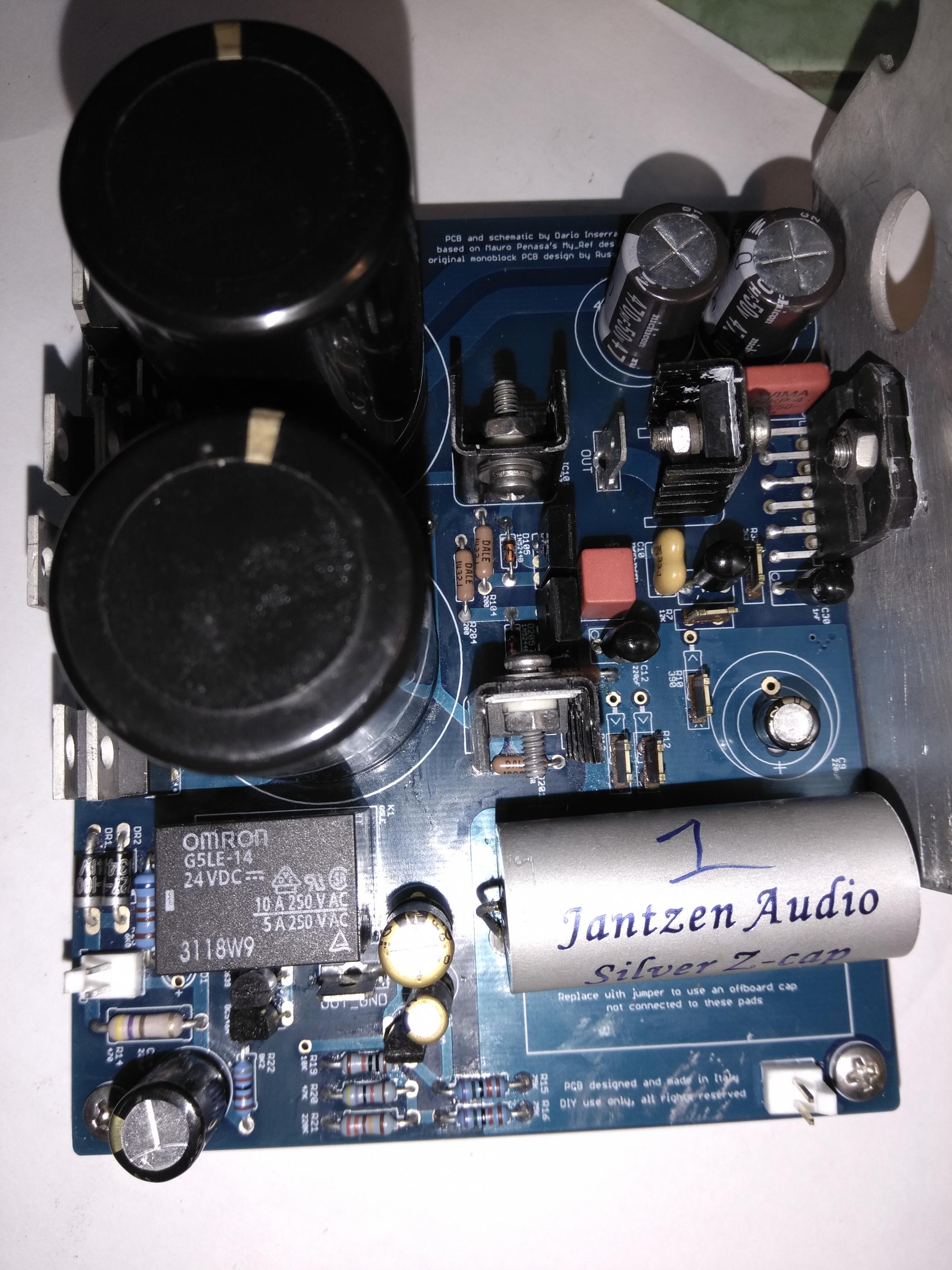

I got busy last year and put my build away. I had completed both boards, but never tested them.
I have two Antek AN-3222 transformers with steel shields. I soldered tabs on the blue and green wires in preparation for testing, and that's where I left off. I have some switched IEC sockets and I'd like to get started again.
A few questions: Where do I go from here? What kinds of chassis are you guys running? Did yours come with heatsinks? If not, what heatsinks are you running? Does anyone have a chassis code or eBay link for something that would work for my setup?

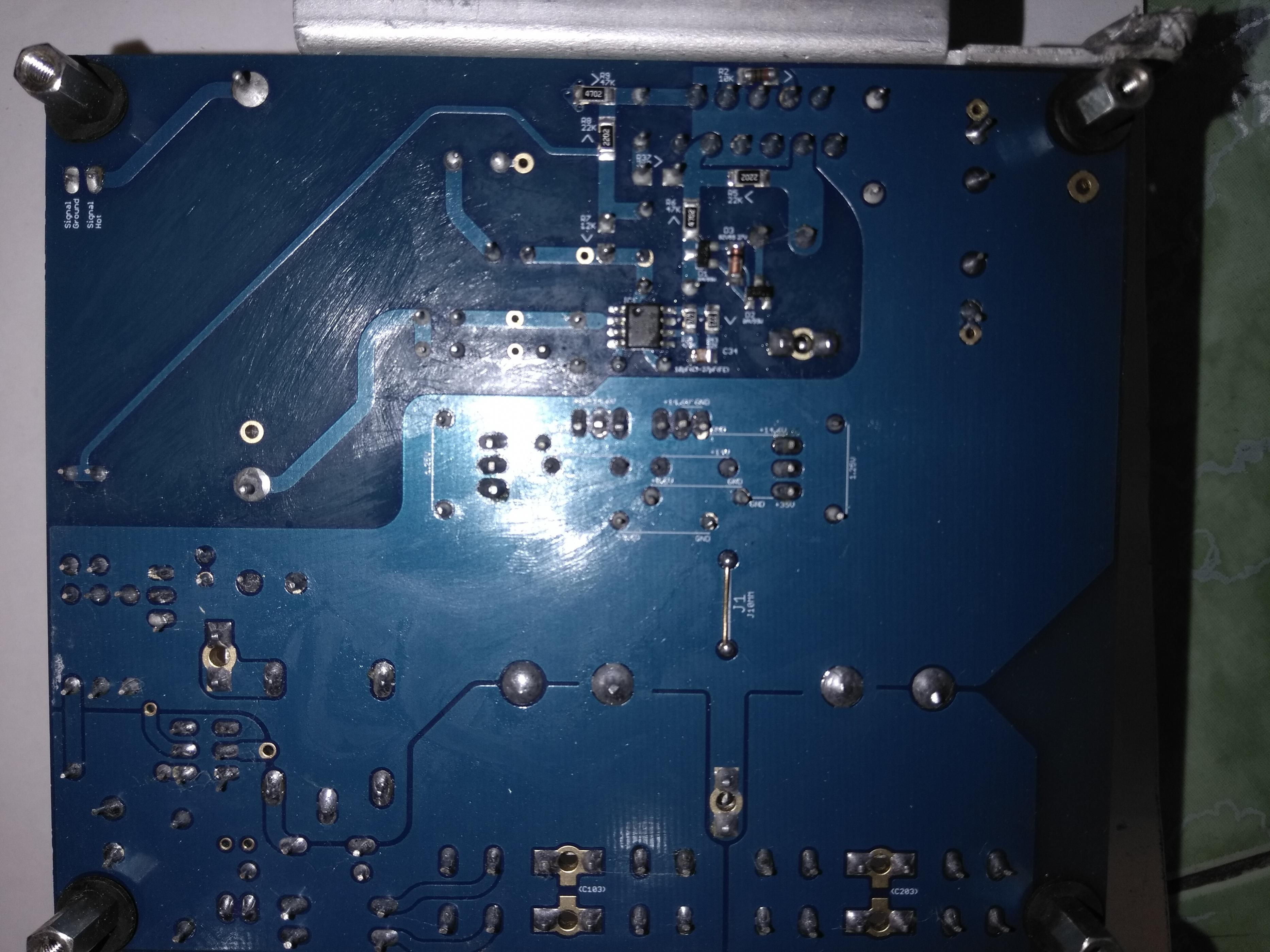

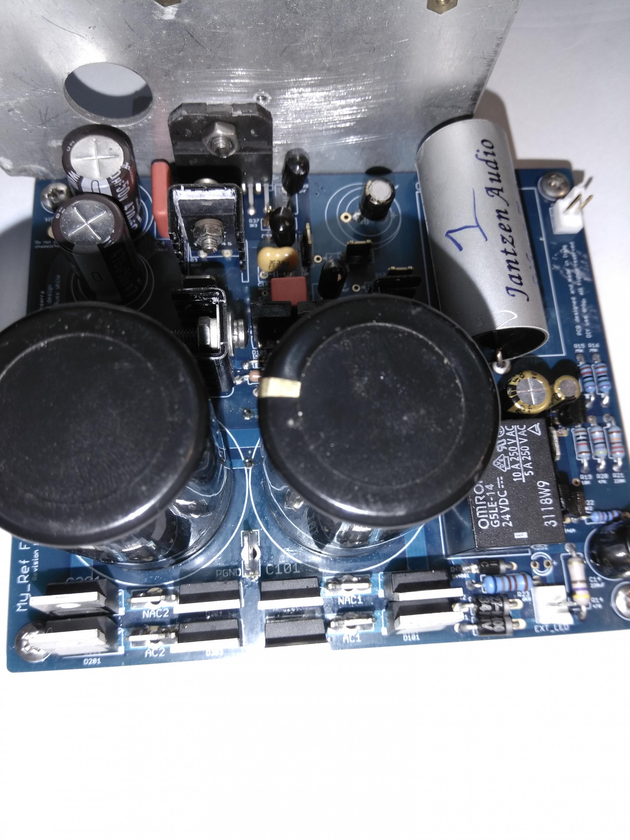

Help please!
I ve just built 1 board and have a bad result.
The first in one minute, i have a good result, the second measurement (+) values are ok, but (-). Then, everything messing up!.
DC offset: 16.8V
+ 32.8/35V
+ 1.25/1.25 V
+ 3.0/14.6 V
- 32.9V/-35V
- 0.51V/- 14.6 V
-1.25V/-1.25V
No Led, no click but when i switch off, led flash and click sound.
I changed another LM317 but received the same value.
Please help me what should i check now, step by step because i am newbie

Post hi-res pics of your boards (top and bottom sides).
BTW... did you populate J1?
Here are my board pics
I can't see obvious faults.
Board seems somewhat dirty, with a lot of residues, did you clean it well?
Voltage readings
If you can explain the readings you have posted.
