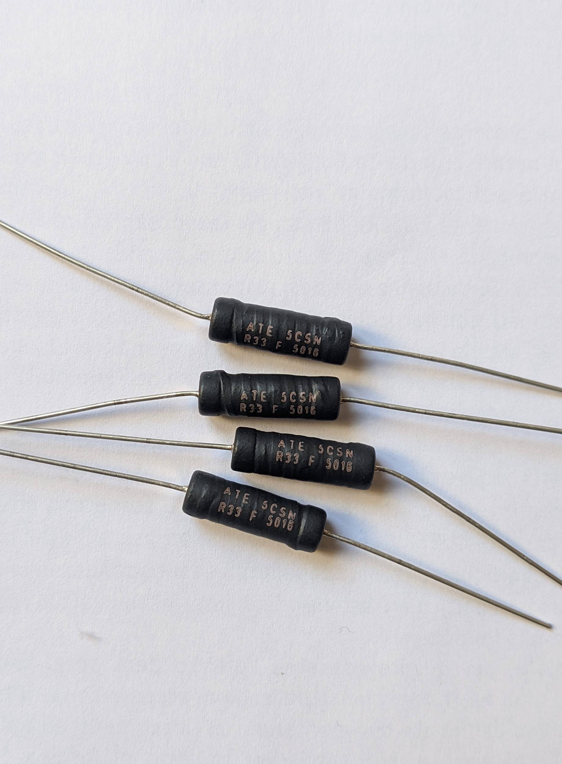

A question for those of you who have played around with the Isabellenhutte resistor in R3.
I am also curious if the Mundorf's show something similar. After all, they are quite similar in construction and use the same resistance material.
While we are talking about R3, there was some early discussion about non-inductive wirewound resistors for R3, but no following comments. Can we assume that they didn't turn out to be as good a sounding choice as the Mundorf's?
Hi Jac,
sorry for the very late answer.
Are you sure you did not hear the normal warming behaviour of the My_Ref? It' pretty normal what you describe when powering up a cold amp.
In this regard I did not notice any difference between IB and Mundorf.
The wirewound I've tried (Dale RS-5) are very good and musical, a big step-up from Caddocks but IB and Mundorf are way better.
I wanted to know if anyone has tried wirewound resistors of the non-inductive type (Ayrton-Perry winding) which have no inductive reactance and signal loss compared to normal winding.
Resistors such as Vishay Dale NS, ATE scsn / ATE cs or Vishay Mills MRA.
Personally I have the ATE scsn that I will try ...
Ciao!
Giacinto
Ciao!
Giacinto
I quote myself:
Dale RS5 are in the same datasheet of NS5.The wirewound I've tried (Dale RS-5) are very good and musical, a big step-up from Caddocks but IB and Mundorf are way better.

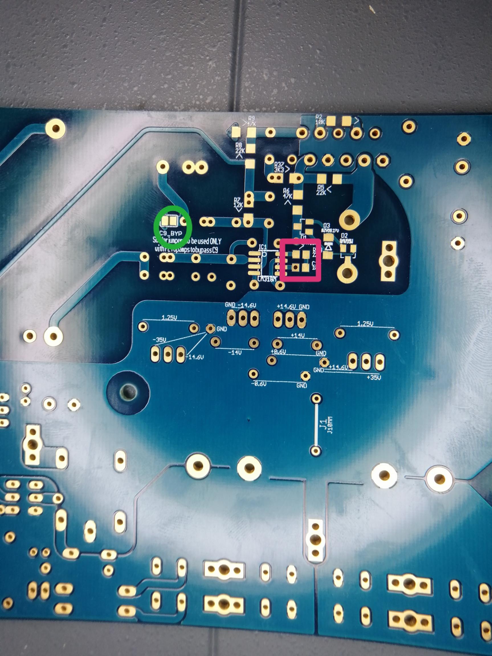

instructions for alternative Opamp substitutes
Attention: Only Valid for 14th Group buy boards!
So, here it is a small quick effort to explain. In the photos in attach we see the two faces of the board. Red always means what NOT to be implemented, green what MUST be implemented, yellow means a variable parameter (in function of different opamp models)
What NOT to be implemented: R43 (22k); C34(27pF); C9 (220uF 35V)
What MUST be implemented: C9_byp solder jumper; C33(5pF);
What is changed depending on opamp implemented:
C32(150pF standard)
Possible choices:
C33 C32
ADA4627 5pF 150pF
OPA827 5pF 100pF
OPA828 5pF 68-75pF
Additional note: many of You will notice the C33 now suggested in all cases. It is a "safety" suggestion: as many of You know it, one can use ADA4627, OPA827 even without it.
With OPA828, it is obbligatory.

Thank you very much George, after making two FE evo A I want to try an alternative Opamp to explore all the capabilities of this amazing amp.
Now I have to figure out and choose which Opamp to try ...
Any experience and suggestions would be very helpful.
