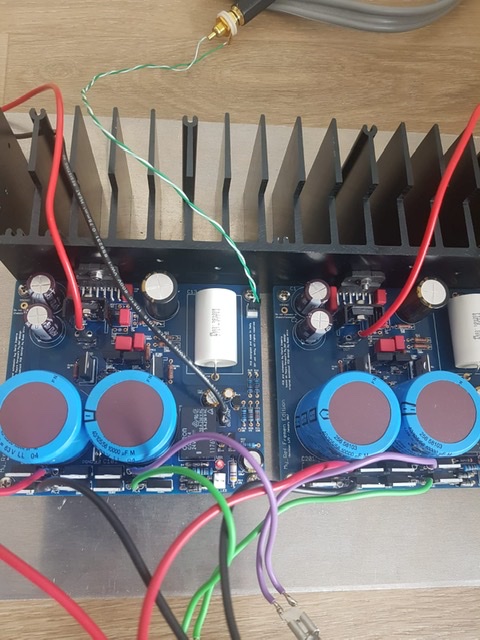

So I had the opportunity to buy two sets locally, both ver1.72.
I build one set with the standard components, for the other set I ordered the better stuff from Hificollective. At the moment waiting them to arrive.
Already build the standard edition and running it since this morning as a test. One word, awesome! Builded LM3886 amps before but this one.. the best. Detailed, great soundstage.

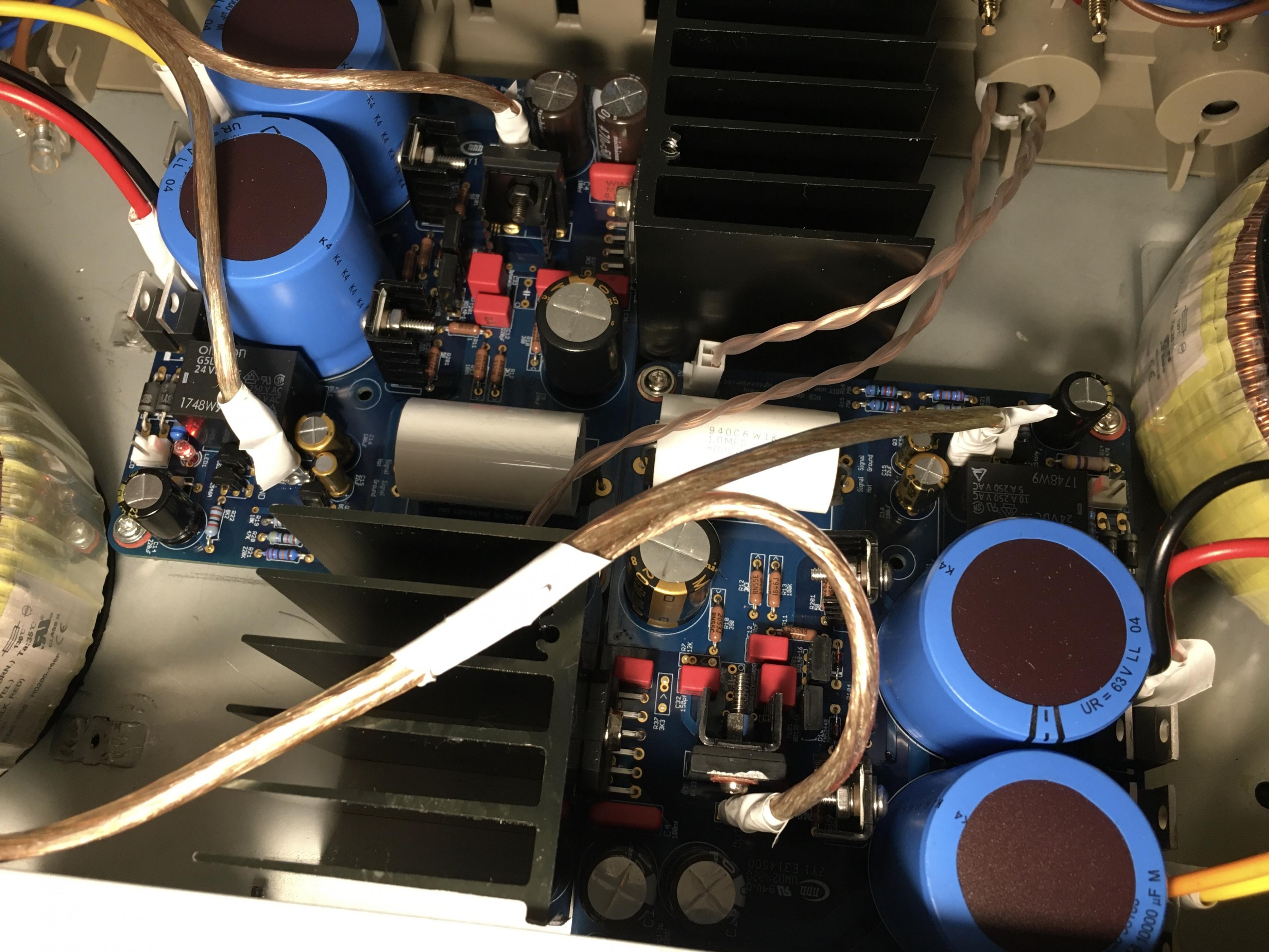

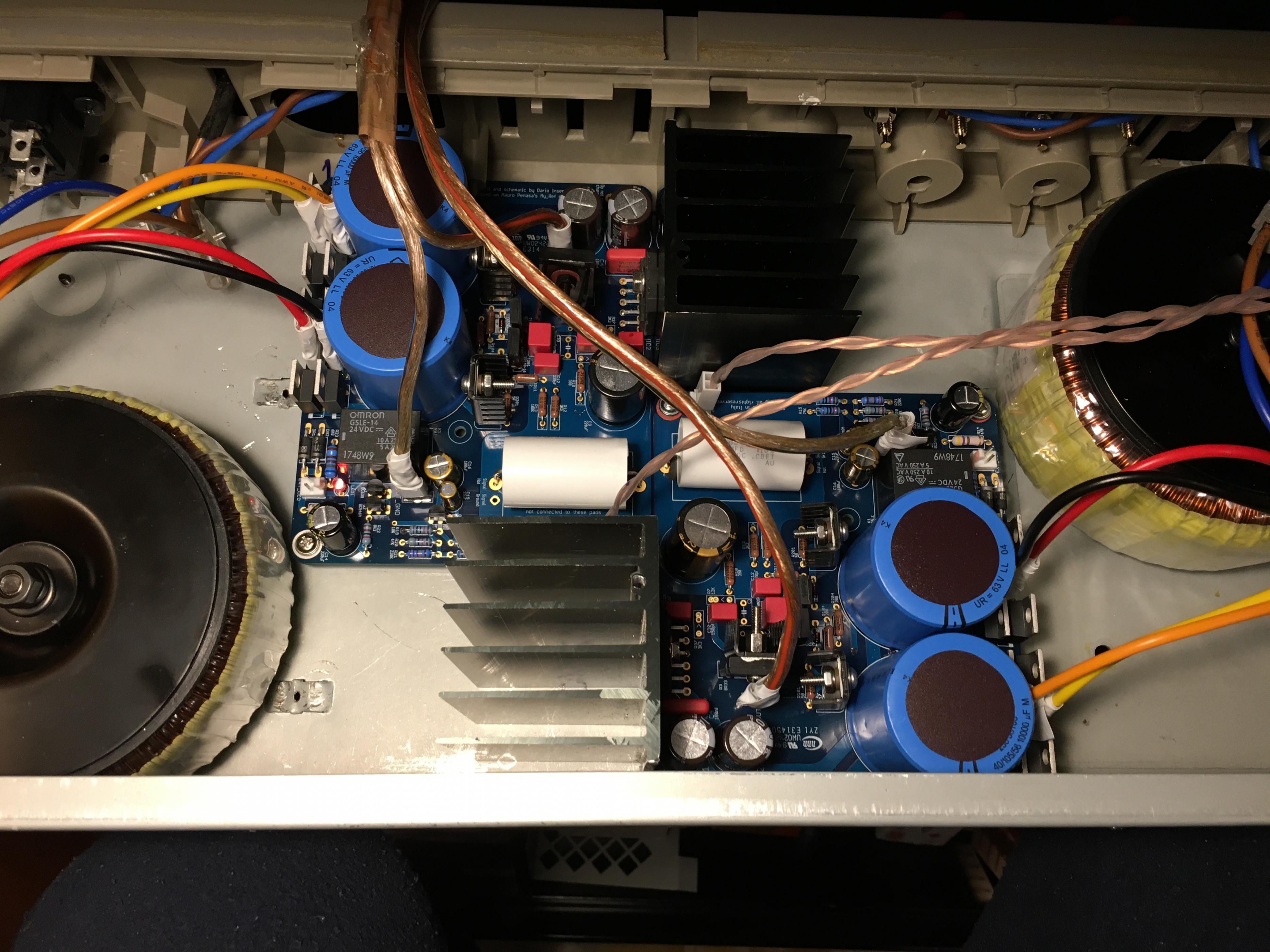

Completed my 14th GB build (1.8 pcb's) today - delayed a little as I had to wait for some more Dale resitors to arrive from Mouser so I could finish off .... Superb boards I must say, well done and thanks to Dario for all his efforts.
Went all out for the full 'audiophile' upgrade items as Dario recommends, and built in dual mono form (thinking that would help minimise any interference, etc. between channels) - any help in a storm, and all that!
Anyway, all good, 'light bulb' tester showed I wasn't going to blow the house up or burn it down, voltages near enough spot on as expected, O/P dc around 2.7mV on first turn on.
Naturally, I was eager to get them powered up and 'soak tested', but once connected up to speakers and turned on there was a very loud 'hum' from both channels before I'd had chance to do anything at all. As mentioned, they're separate units, but both had the same level of hum.
So, start to investigate - inputs disconnected off board, still the same .... moved tranny's away from pcb's, still the same.... made sure all cables were well and truly moved away from sensitive areas, AC not running parallel to signals and so on, still the same ..... checked for any ground or other shorts (none found), still the same ....
So, I naturally dived straight into this Forum to seek out a possible cause and solution, and stumbled across OlegSh's 'problem' and resolution way back in July 2014. And, sure enough, I also found that the ONLY way I could remove this loud hum was to link PGND to PE earth, as he seemed to have needed to do as well.
That sorted it - now both channels are stone silent, and playing a brief selection of my favourite and well-known music this evening I have to say that even at this early stage of 'breaking in' it sounds terrific!
Now, I realise that under normal circumstances it should not be necessary to use this PGND connection, presuming the heatsink itself is suitably earthed - which they definitely are (measured and confirmed with digital Avo meter). Both heatsinks (actually, using side panel of HiFi2000 enclosure) are correctly earthed and I could see no other obvious errors or omissions on my part (I think!). Incoming PE is connected to enclosure base, then also linked to side panels (i.e. 'heatsink') via hard wire link.
So does anyone have any ideas what might have been going on and why I've needed to employ PGND against normal advice? Have I missed something obvious here? I'm making a presumption about a ground loop being the culprit, but where from (no input connected, remember?).
That said, I'm a happy bunny at the moment because both channels are now sounding wonderful, and I'm sure they'll continue to improve over the days and weeks to come.

Hi Richard,
that loud hum was present with input disconnected (as it seems)?
If so it's perfectly normal since it's a floating design, it's the input signal ground that 'grounds' the entire amp...
It was so with input connected?
Maybe you inverted signal hot with signal ground
It's a band-aid, check input connection first.
Thanks again to all involved in developing and fine-tuning this great project!
You' re welcome, I'm happy you're enjoying it 🙂
Well, that was interesting!
... PE connection, presuming the heatsink itself is suitably earthed - which they definitely are (measured and confirmed with digital Avo meter). Both heatsinks (actually, using side panel of HiFi2000 enclosure) are correctly earthed and I could see no other obvious errors or omissions on my part (I think!). Incoming PE is connected to enclosure base, then also linked to side panels (i.e. 'heatsink') via hard wire link.
Hmm.. Do I understand well, that Before the PGND was not connected anywhere, neither the HS points..?
So that the heat sinks + case were connected Only to the PE of the power line input?
If that is the case, I'm afraid that You have misunderstood the situation: naturally the amplifier PGND 'must' be connected to the case & heatsinks!!
Than it will be connected also to the PE, for safety reasons. But exactly because of that hum, noise pickup, the case must be directly, low inductance way connected to the amp PGND point.. Always!
Dario,
Thanks for the advice - I'm sure I/P connection polarity is correct, but I'll check again to make sure. And yes, very loud hum is present, and at same level, whether I/P is connected or disconnected, no difference.
Joseph,
Thanks for your confirmation - I followed the build guide which clearly states "The My_Ref and so the My_Ref Fremen Edition are floating designs so they’re not supposed to be grounded."
I took this as being a literal advice, and so yes I did not connect PGND or HSGND to anything, so looks like my bad and my misunderstanding in that case!
Circuit diagram shows both of these points connect through to GND, so I (wrongly it seems) presumed this GND would be picked up somewhere else in circuit; but now thinking about it, it must be fed from somewhere of course - which I guess is indeed the PGND connection!!! Doh!
Thanks both - all now working OK in the end, which is the main thing.

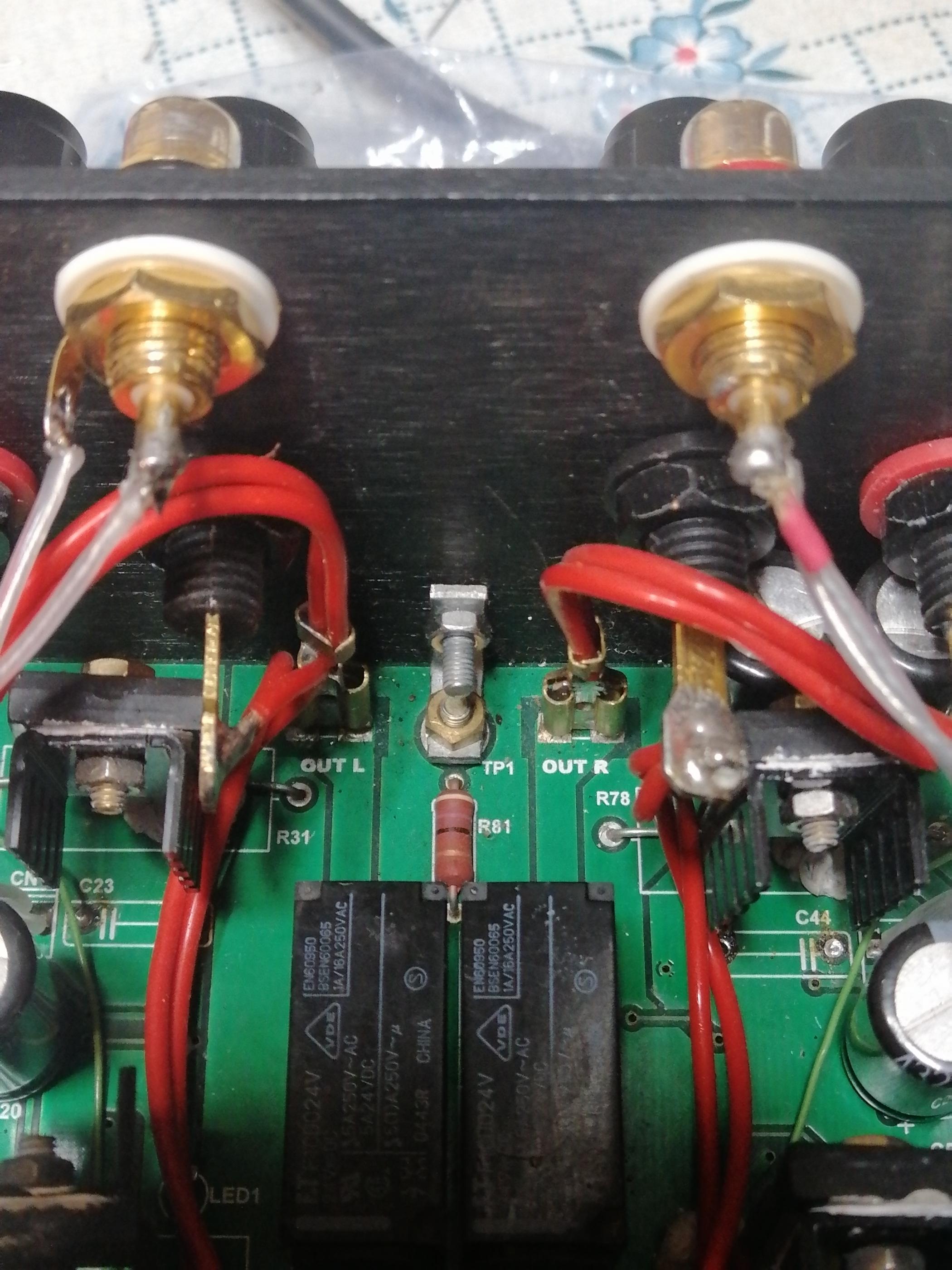

Ciao Peppe,
you're welcome 🙂
From the pics I would say that you reversed the output resistor.
Thanks Dario for the suggestion of R3, I have reversed it, but what do you say who knows if he will have suffered damage playing for a week? now, however, the sound has remained very beautiful, warm and transparent. I'm enjoying listening to all my favorite records, it feels like listening to a nipva version. a pleasant surprise. I'm happy. thank you
