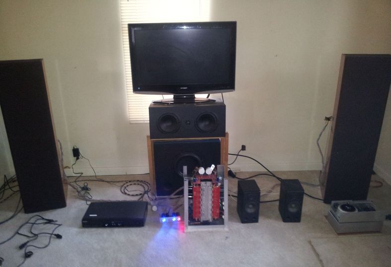

lol, the missis would not have this lot in the middle of the floor.
I tried changing inters and setting it all up in another room, no good.
I even tried a mains filter/surge protector socket block and plugged everything into it, no change.
Funny thing is the lead I used to test them with is not even screened, it's about 14" long with a cheap rca phono plug on one end and a jack plug connected for mono (right channel) on the other. I used it to test the amps one at a time. With the portable player plugged in I get loud hum until I switch the portable on, then silence when nothings playing.

Do you have the covers on the enclosures when doing all this hum detection? One of my amps picks up low level hum from the power supply of the nearby subwoofer plate amp if not covered. Telephones can also cause noise if the amps are bare. Who knows what else? I can still hear my furnace motor clicking on, but it is reduced somewhat with the FE regulated supply, and that is line noise, not ground noise.

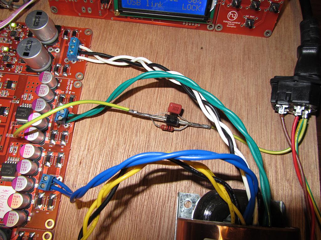

I've been trying to reduce my FE's hum a bit further and have had no luck. Since I connected their power grounds to their chassis, I cant hear it from my chair anymore which is a big improvement. However if I put my head close to my speakers, I can still hear it. Is there anything which can be done to improve this or do I just have to put up with it?
If I short the signal in at the phono sockets to ground, they are almost silent. I just wish I could get them that quiet with something/anything actually plugged into them.
The layout is so simple I just cant see what else I can try, I tried soldering the signal in wires direct to the molex pin's and managed to get one twist in them before they reach the phono socket. That made no difference at all.
Any ideas folks?
EDIT - I almost forgot, there is one thing I can plug into them which does not increase the hum, my portable mp3 player. Anything else causes hum.
Hi Davy
any chance of a photo of the internals of your passive pre?
have you tried connecting just one channel at a time?
seems like a grounding issue to me as you report that connecting up your MP3 (without a ground connection ?) cures the problem.
IMHO it may be better to try to sort out the above before spending cash on extra's which you may not need.
it's going to be something simple so worth having another look at.🙂

I may be going in circles - but, last week I was checking for efficiency with a discrete amp. There I could connect a self contained CD/DVD player directly to the power amp 2 V line output RCA connectors. I did the same with the FEs, but with a bare pot between for safety - not knowing what the higher FEs gain would produce. Do you have unit for that trial?
(excuse ugly bare walls - new coat of paint and some audio room treatments in progress)
