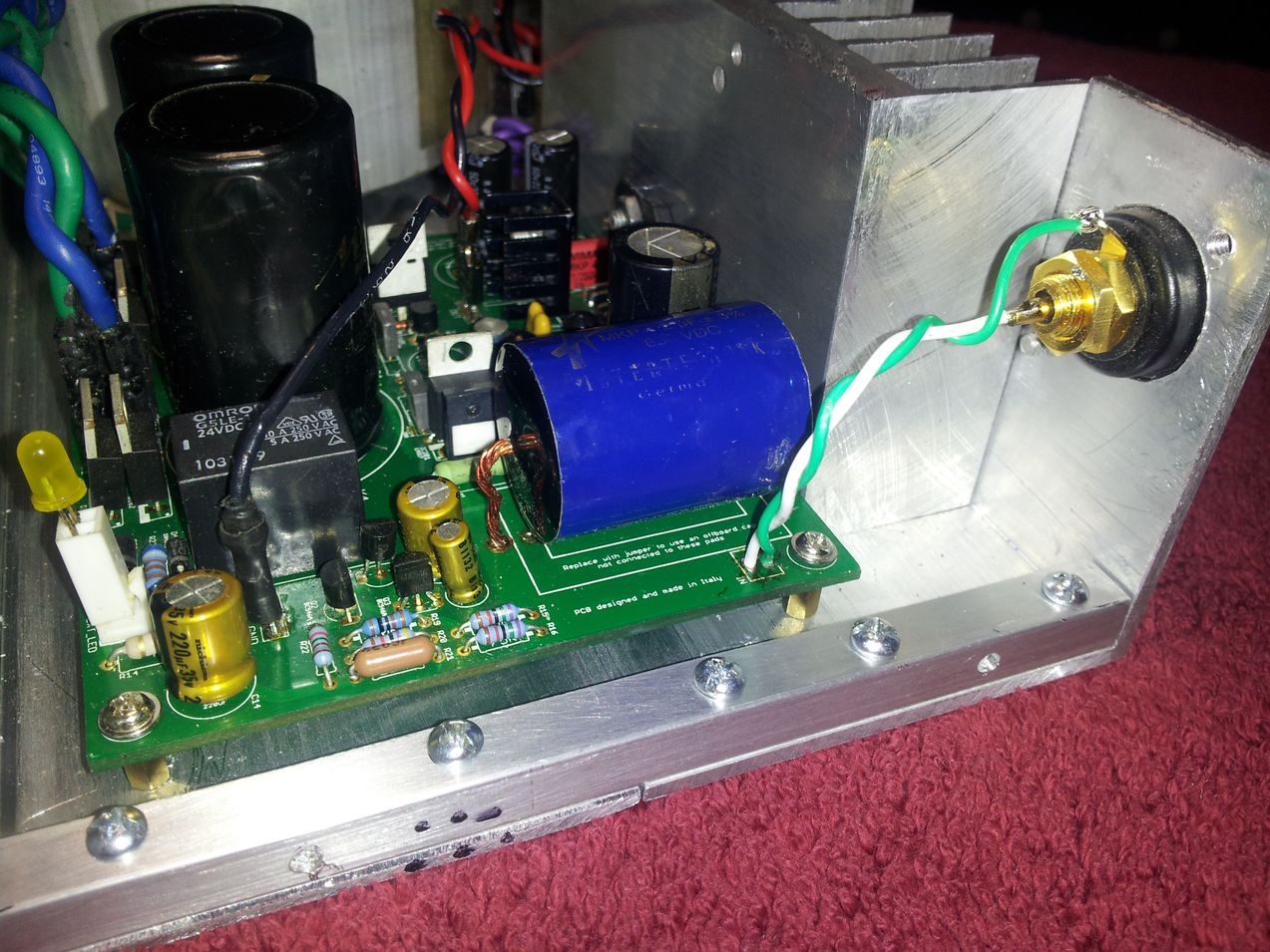

Are we talking about the same cap. No support needed here. A dab of hot melt glue or silicone could be added but wasn't necessary.
Bob, Ivan has the much larger new ones.
No. I did not try DC coupling yet. Would be good reference though. What requirement for a source would be ?
source/pre DC offset less than 7mV.
