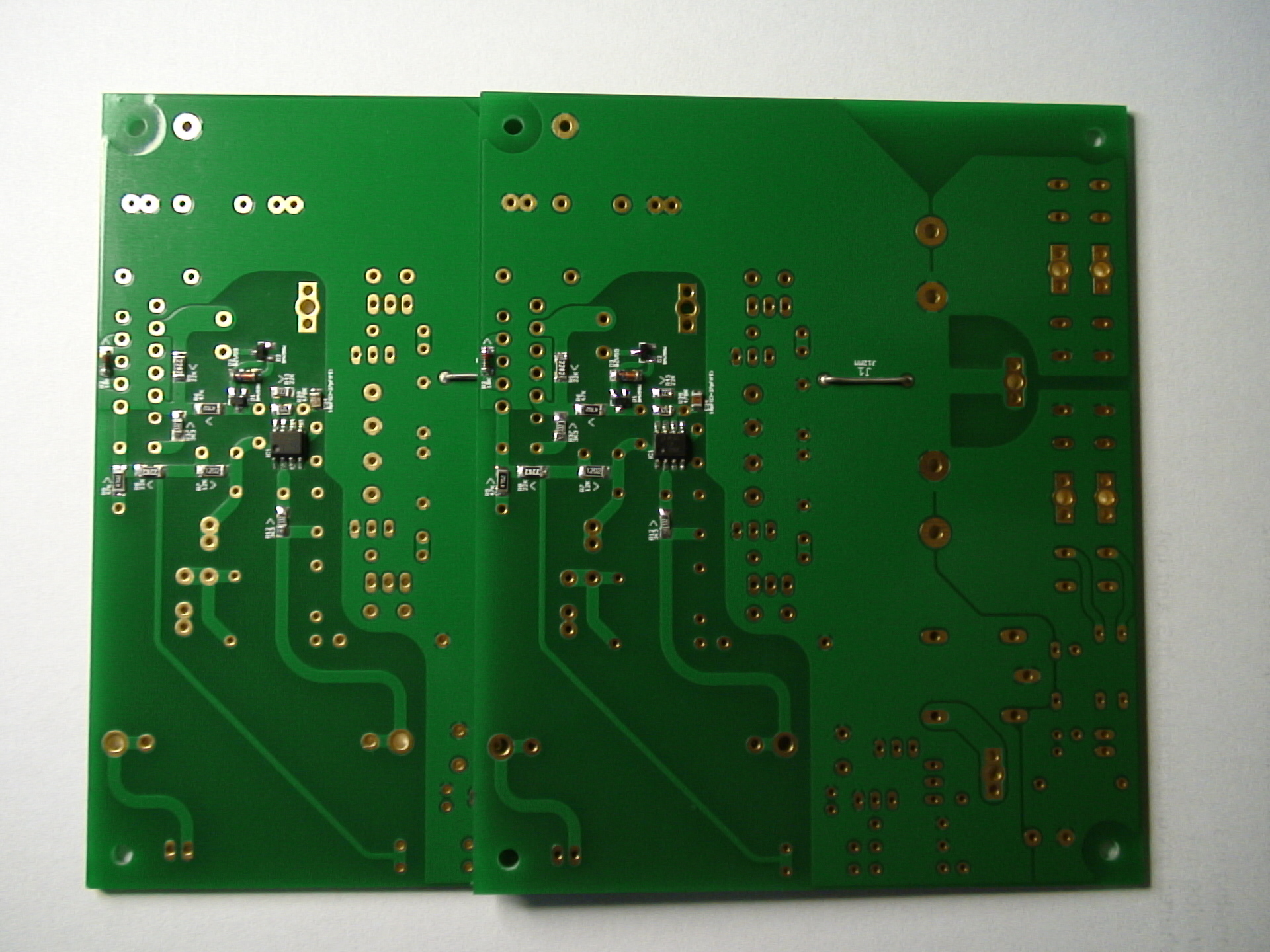

Got a late start, but I'm catching up. Went green to match the color of some other boards that might be in the final build.

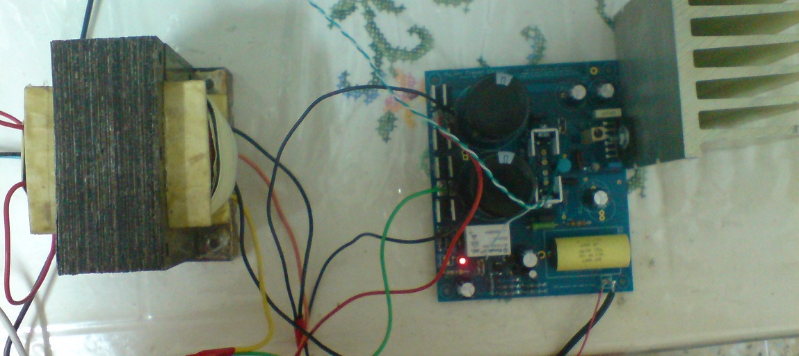

Relays and LEDs on first power up.
DC offset < 2 mV both sides.
14.55, -14.5 @ C102,C202
Early impression, very detailed, dynamic, very clear.
Before you guys try to politely explain the correct direction for a heatsink, let me explain that my final application of these boards will be mounted vertically on the back of each speaker. In this photo, the test board is tilted about 45 degrees and they seem to run cool enough.
